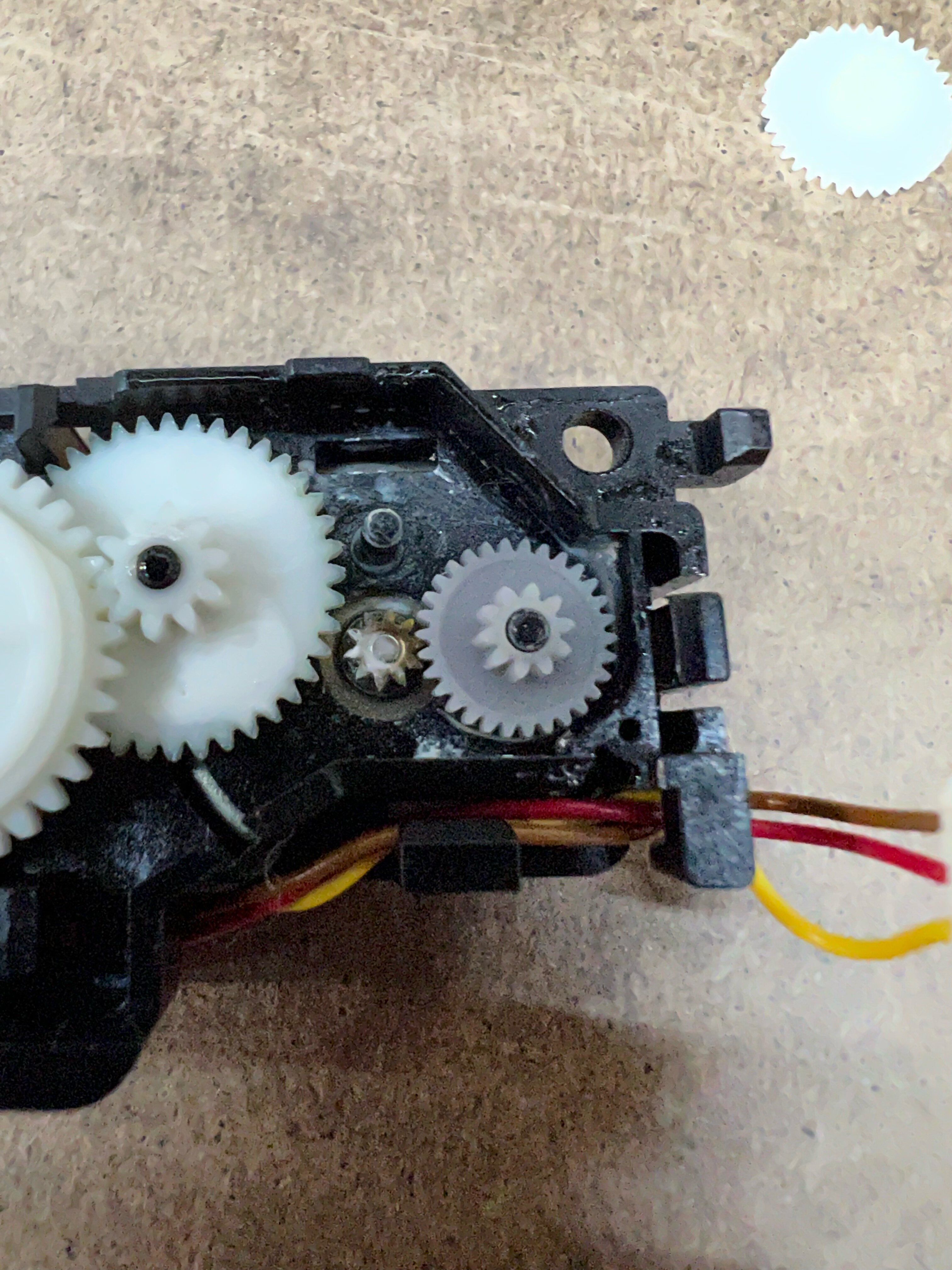

Is there a file to print my own for the 2mb floppy? The Sony MP-F75W-12G. There seems to be a 1mm difference for the main gear diameter and the upper smaller gear. The shaft is also smaller at 1mm. I guess could scale this one down to fit? Sorry I am asking as i am new to 3D printing.

I am hunting for the file to print the 2mb floppy version which is a bit smaller. The main gear, the top smaller gear and the shaft opening all need to be 1mm smaller. For the other floppy drives this works great and I already printed and using a bunch of them. @Drake are you able to assist any maybe to produce a smaller gear file?
I don't have anything done for another size, if the internal measurement changes it's likely to have more teeth or different spacing.

Thanks I want to add a picture of the 2. On left is the 800K one printed from the file here. On right is the 2mb drive version.
