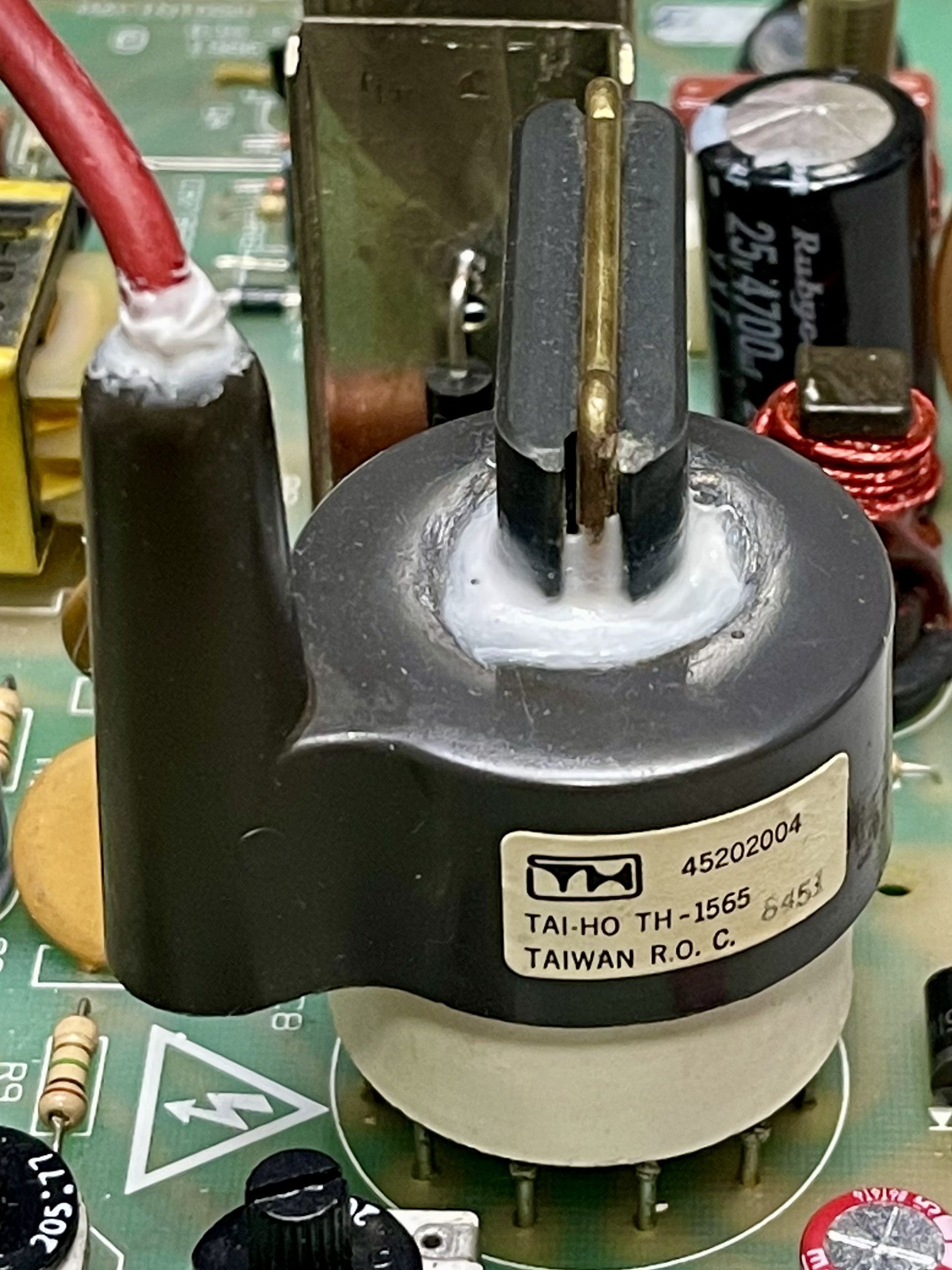

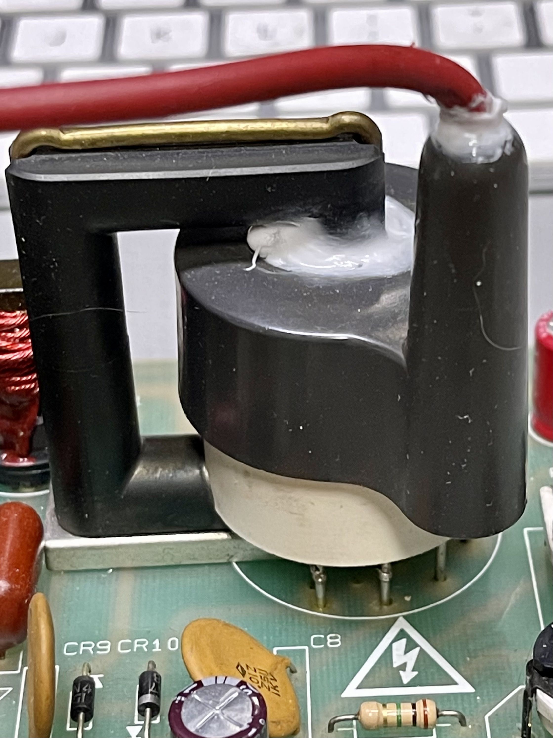

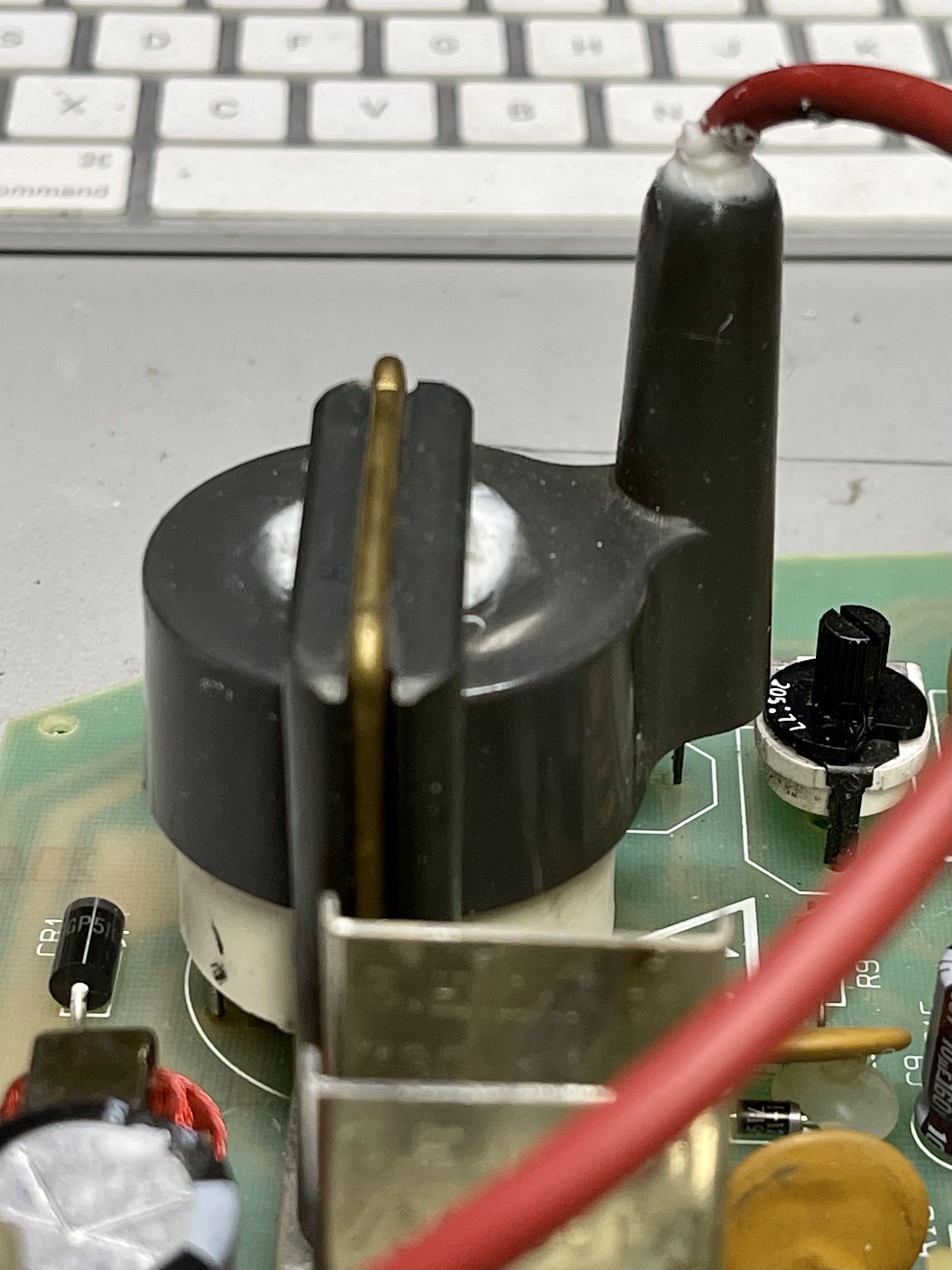

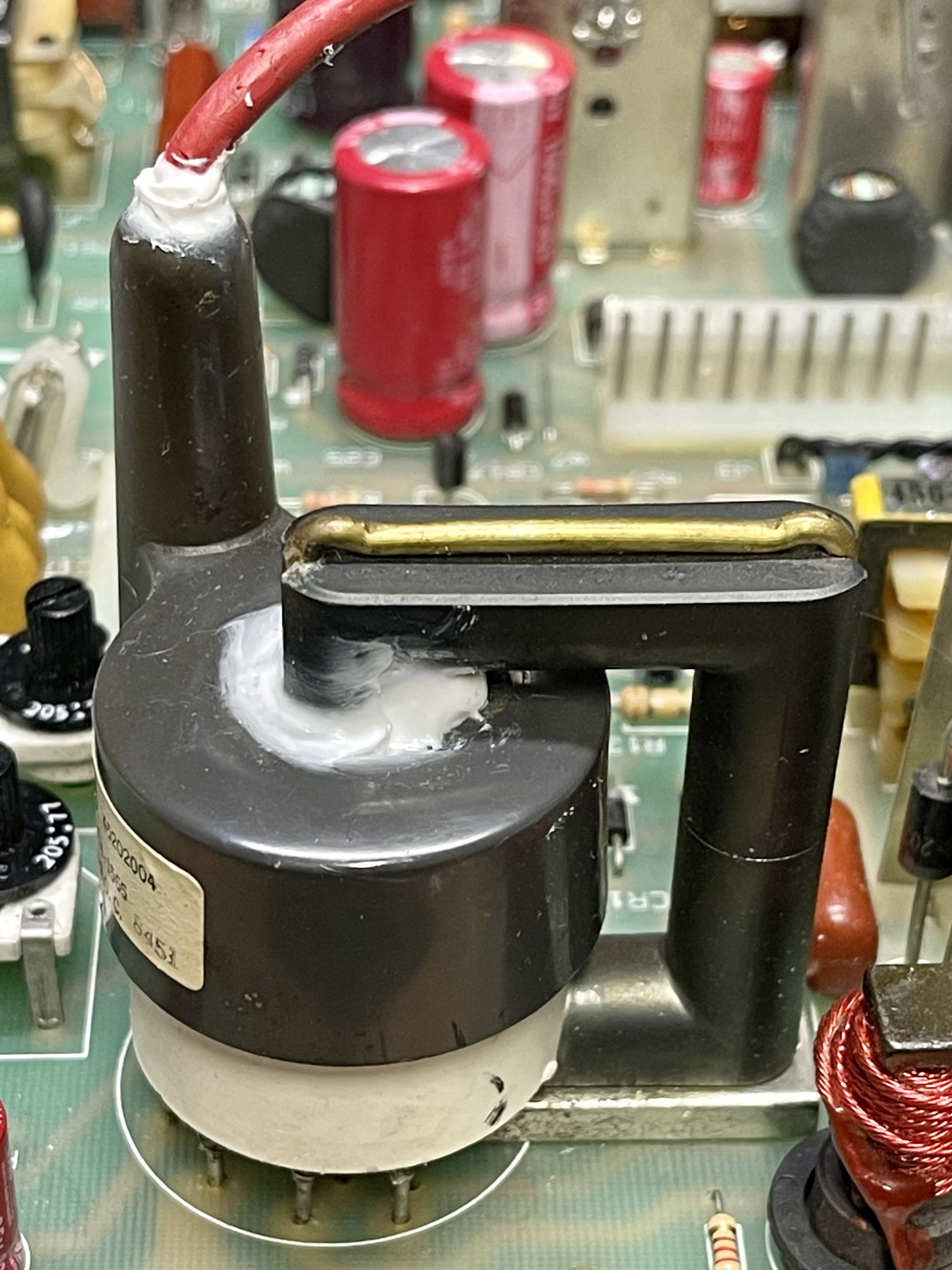

I don't think there's anything particularly special about this brand, but I picked up American Sealant, Inc.'s 502 "High Performance" RTV Silicone locally (Amazon) (Datasheet).
In order to prepare the flyback I carefully cleaned every last speck of yellow glue from the housing and then carefully applied this RTV silicone neatly around where flyback lead connects to the main body of the flyback. I'll try to snap photos later today.
