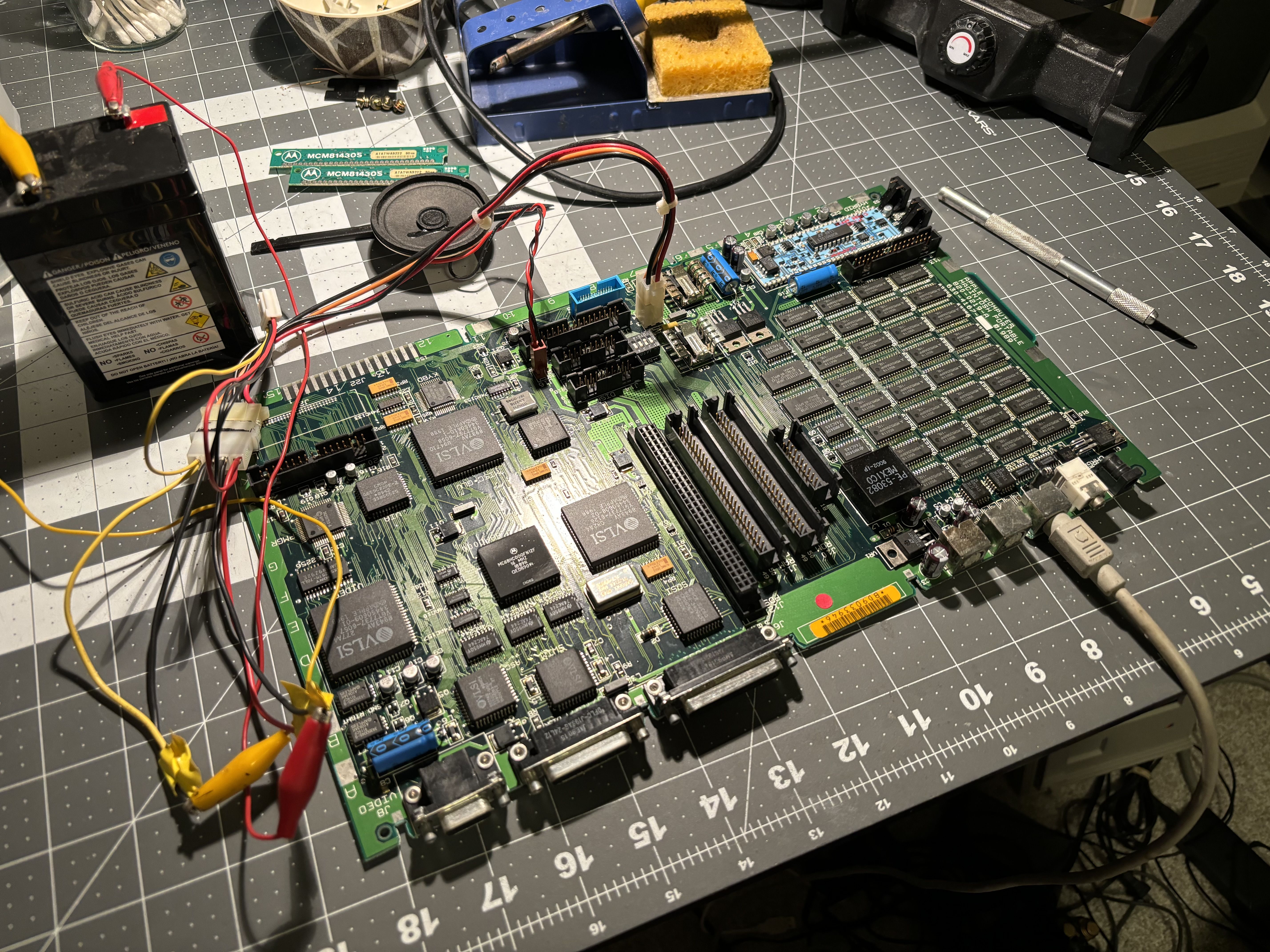

I’ve been sitting on one too many Portables needing a recap. Yesterday I decided to get moving and actually complete one. Apart from these boards sucking a TON of heat from my iron, the job was straightforward.
Keep in mind I did not test this board before the recap as to not cause damage to the sensitive Hybrid board. When it came time to power up, I found my power supply and connected the leads directly to the battery terminals. Booted right up, but oh no- death chimes!
![IMG_0548.jpeg IMG_0548.jpeg](https://tinkerdifferent.com/data/attachments/14/14483-3948d4c5fe0b18c0d61b4f15a5b2d268.jpg)

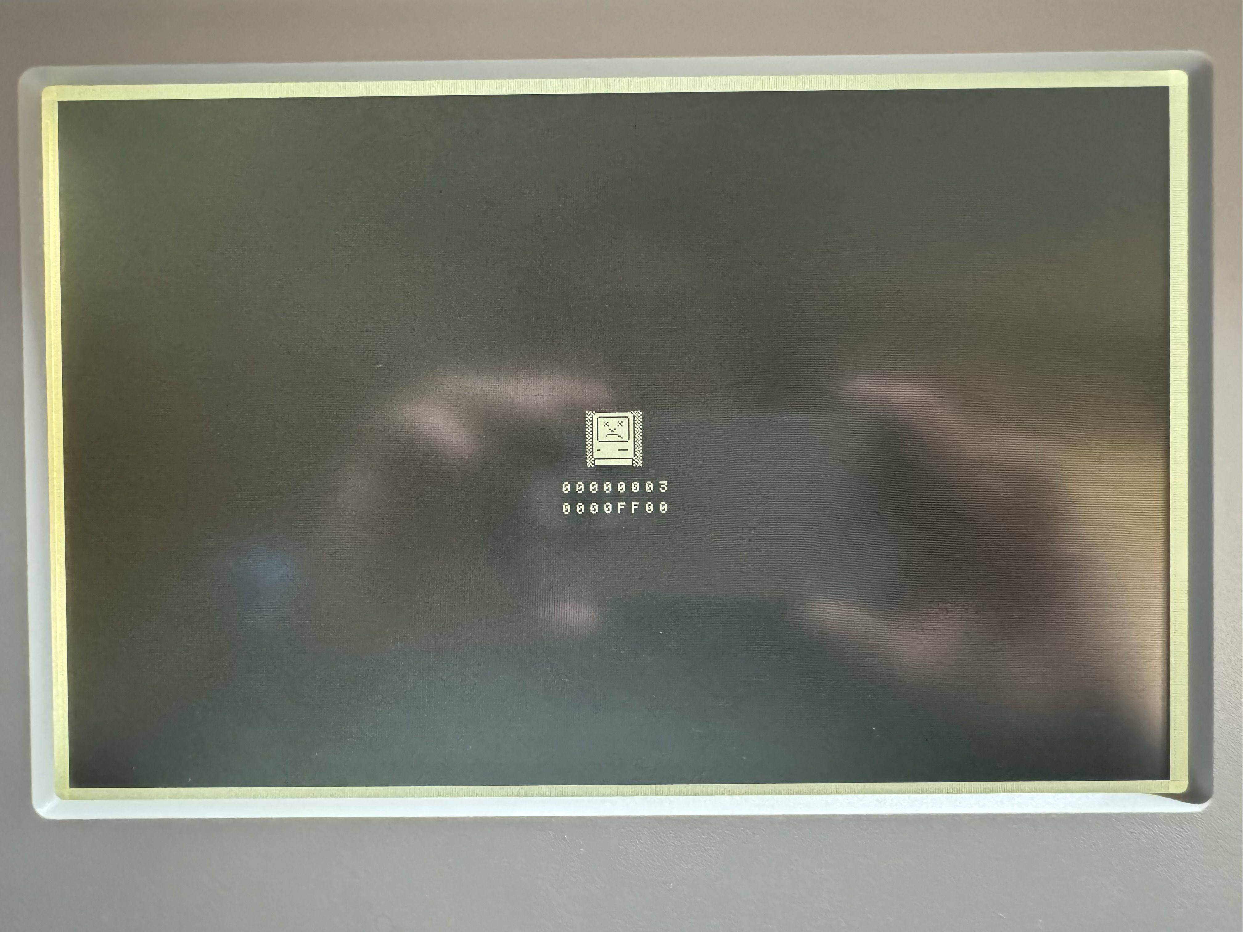

![IMG_0549.jpeg IMG_0549.jpeg](https://tinkerdifferent.com/data/attachments/14/14484-86f1ace15caa242ed93effbb3a844898.jpg)
00000003
00000010
According to “Troubleshooting Your Macintosh” it looks like a major error of 03, indicating a RAM fault. Minor error is 10, which I assume is RAM data bit 4?
I broke out the multimeter and tested for continuity between pin 16 of each RAM chip, which should correspond to RAM data 4, and found no breaks. Looks like one or more chips may be defective. The traces I can see look fine. Obviously I haven’t removed any chips yet to look under for breaks.
Seems like the only real option I have is to start replacing chips one by one (after I find replacements of course). It’s not a total loss though- the LCD is in great shape, and the speaker is nice and loud!
