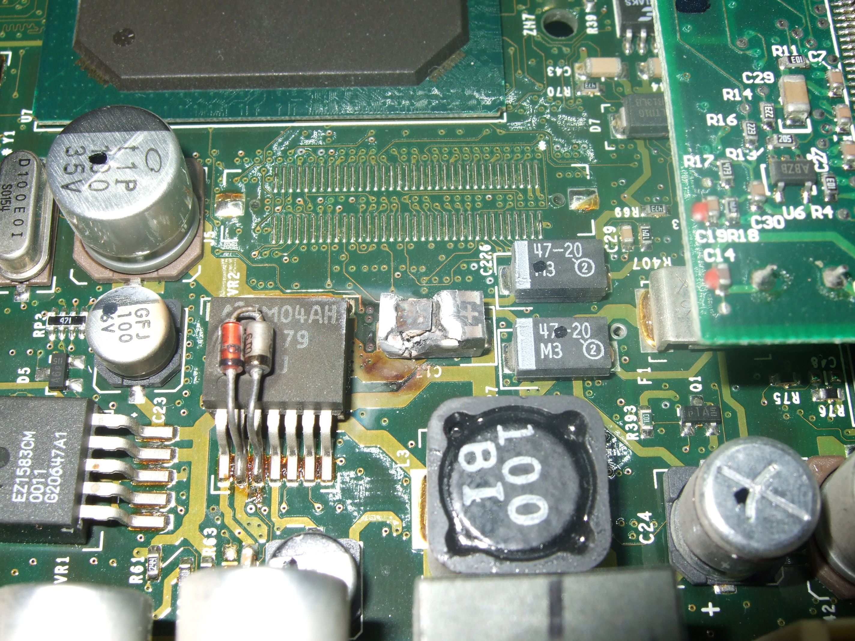

I have a Cube that was given to me with the same problem. One of the symptoms was that the Cube took a very long time to boot. But looking at the Cube logic board, the damage was obvious:
I replaced the blown capacitor, but that was not enough to repair the logic board. I think the chip to the left of the blown capacitor has overheated and need to be replaced. (at the time, something like 10 years ago, I found it was easier to just buy a replacement logic board on eBay: they were easy to find and relatively cheap)
