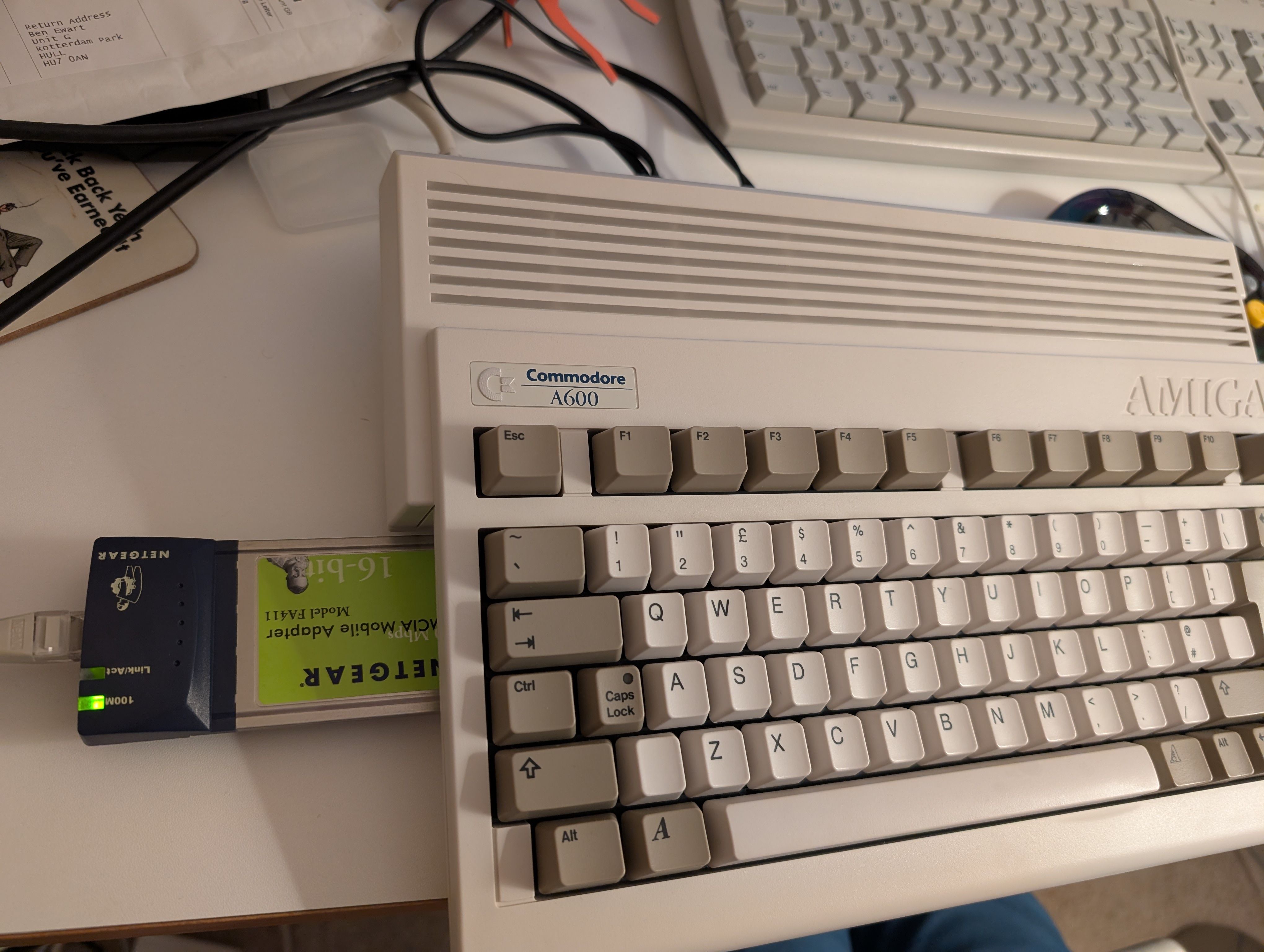

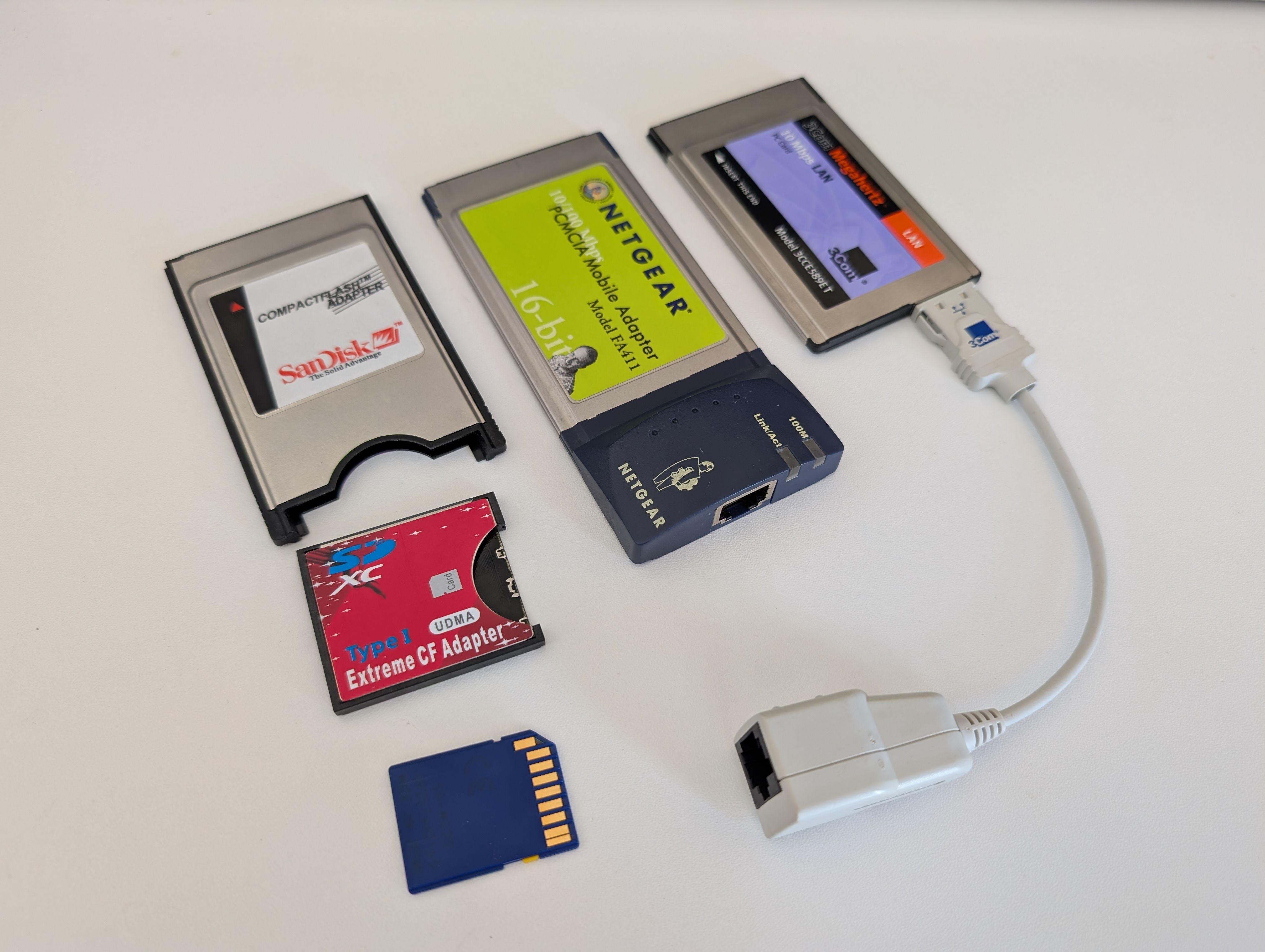

The next big problem is that even once you've found a cheap supported 16-bit PCMCIA card, the odds are that it will be missing its dongle. One strategy is to pick a slightly bulkier card from the cnet.device compatibility list that includes a moulded RJ45 connector (e.g. a Netgear FA411 which I was lucky enough to find for around £10). Another option is to find a 3Com 3C589 card with an XJACK flip-out RJ45 connector, but these tend to be expensive (£40-50).
The proprietary dongles will be almost impossible to find, but the 3Com ones were manufactured and sold separately in sufficient numbers that you may get lucky. There are some caveats though. The dongles are not all interchangeable. Despite sharing a common card connector, the pinouts are divided into two categories: the 10Mb-only 3C589/562/563 design (single link LED), and the Fast Ethernet 10/100Mb 3C572/574/575 design (dual 10/100 link LEDs) which are not Amiga compatible cards.
I bought a cheap bare 3Com card which I suspected had an XJACK connector because the backside label featured an XJACK trademark, but it turned out to be a regular 3CCE589ET requiring a dongle. However, I was able to acquire this separately (for around another £10) by carefully searching for these part numbers below, which I gathered from many sources including auction photos. I've listed them all out here to help others...

10Mb RJ45 dongle for 3C589/562/563:
  • 07-0276-000 3C-PC-TP-CBL (original more angular card connector)
  • Foxconn 07-0405-000 3C-PC-TPS-CBL (newer, curved card connector)
  • 3rd party CPN-3C10T-SP (svideo.com, now discontinued)

Additional additional confusion: Be aware that the link light on these 3C589 cards can mislead. Since I now have both Netgear and 3Com PCMCIA NICs, I noticed that the Netgear will report its link status from the moment the card is inserted and powered. The 3Com on the other hand only reports its link status via the LED when the driver successfully initialises. When I was flapping around trying to get a working TCP/IP stack (more on that in a subsequent post) I had started to suspect it might be broken, or that a 10Mb link is now so old a spec that my switch was refusing to negotiate, but this is the normal behaviour for these 3Com cards it seems.

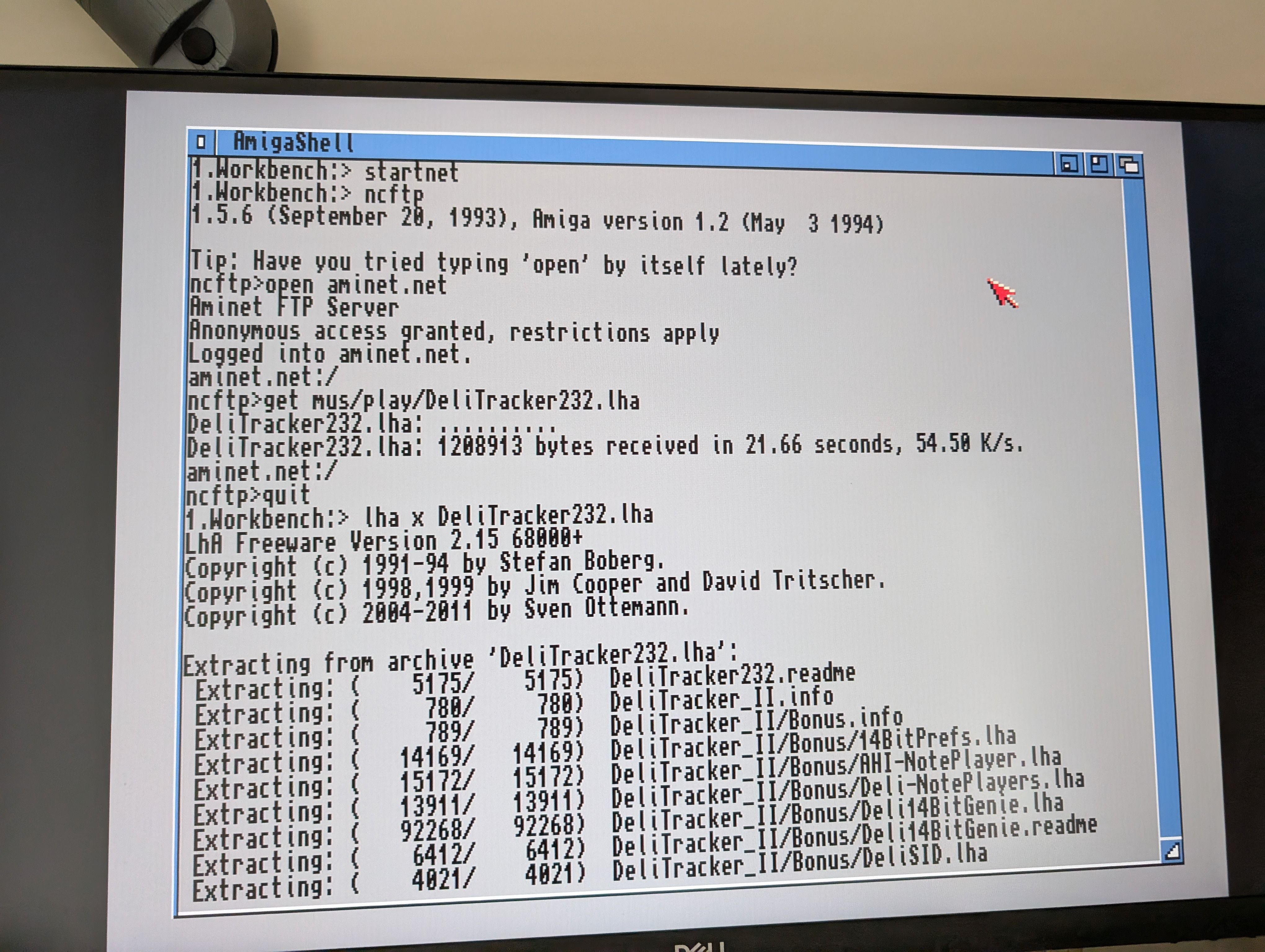

We Have Lift-Off! 🚀
I didn't at first notice that AmiTCP already includes an older version of ncftp which doesn't need the ixemul library, unlike the standalone version on Aminet. This means that a standard AmiTCP install enables all I wanted to be able to do: to use the Amiga to download its own software!
As I do with Macintosh Garden, I can use my phone to browse Aminet, and once I know the URL of the file I want, I can FTP get it using the Amiga.

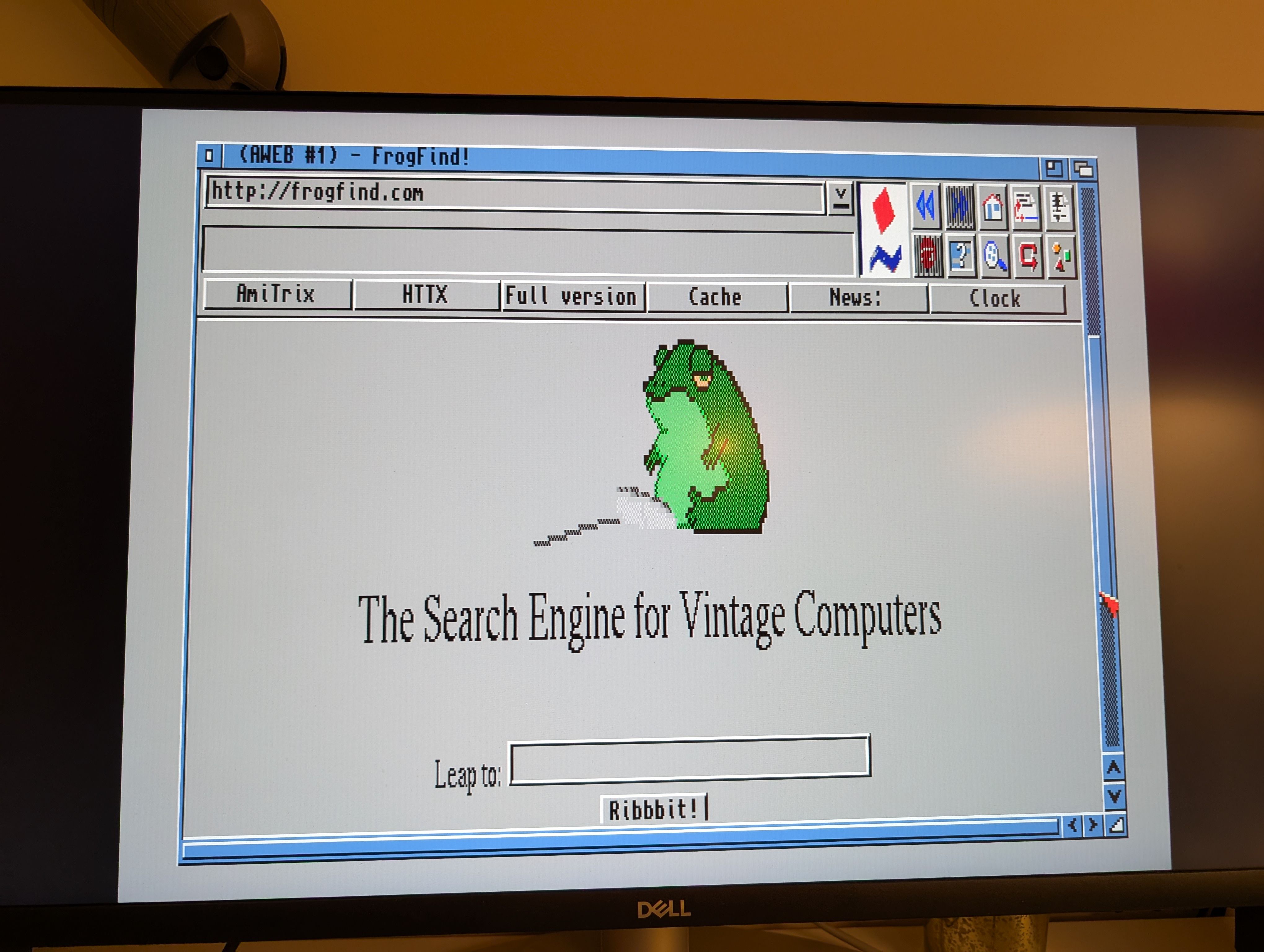

I scratched around looking for 68000 builds of browsers and although a 68000 build of AWeb Lite 3.5 exists, it's reckoned to be very slow. Apparently you copy these binaries over the top of a regular install of AWeb 3.5.
I tried out the AWeb 3.2 demo instead which is leaner, compiled for 68000, and seems to run ok even without the stated requirement of ClassAct. The newer Web standards support which v3.5 offered has long since become irrelevant.
I mean it's cool to have got the browser up, but I'll probably just stick to command-line FTP transfers in future. Still, tinkering is what this hobby is all about.
