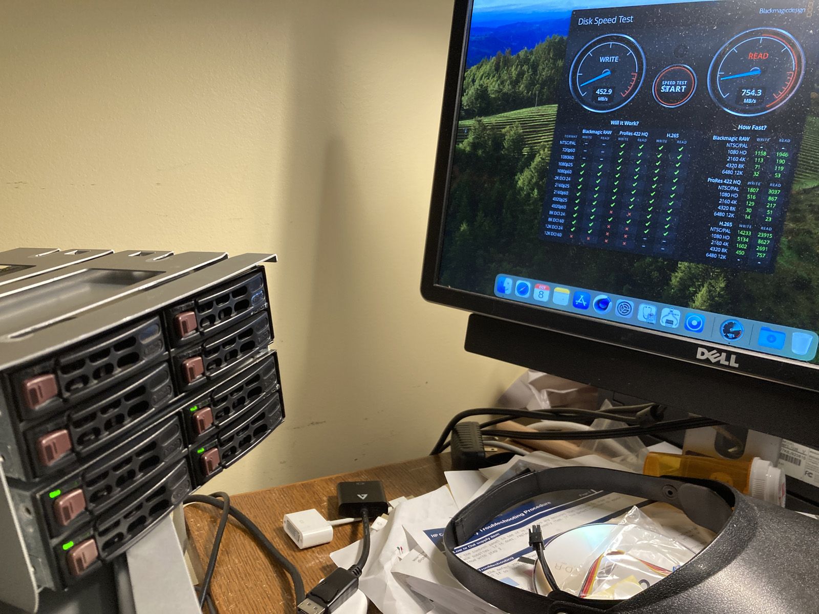

Latest CMP SAS'y update:

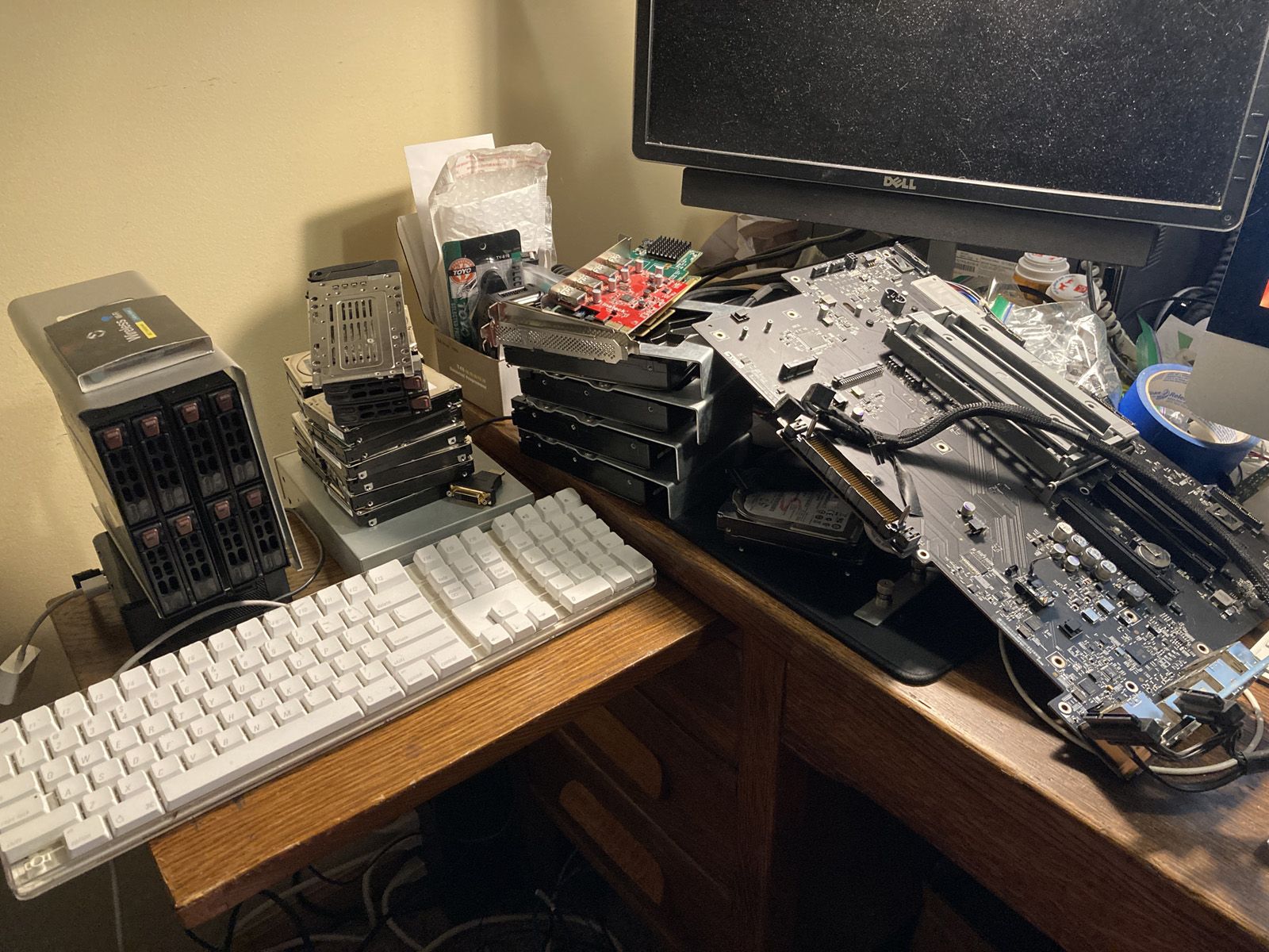

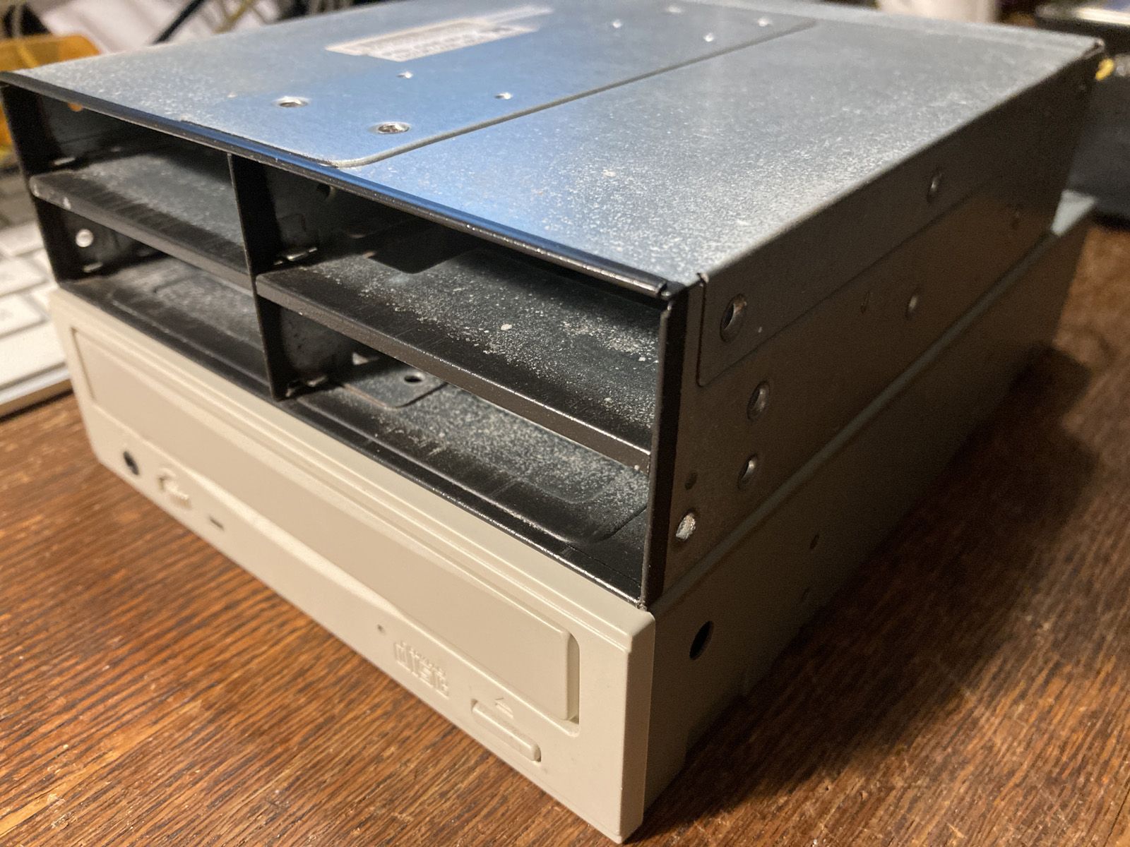

I added a couple MacPro4,1 upgraded to 5,1 to my collection. Both are single CPU boards. I was at Free Geek Minneapolis and found an SuperMicro server with 12x300GB SAS drives with trays. It turns out it was 3 groups of 4. The size is the same as a 5.25 Optical drive, SuperMicro model CSE-M14.

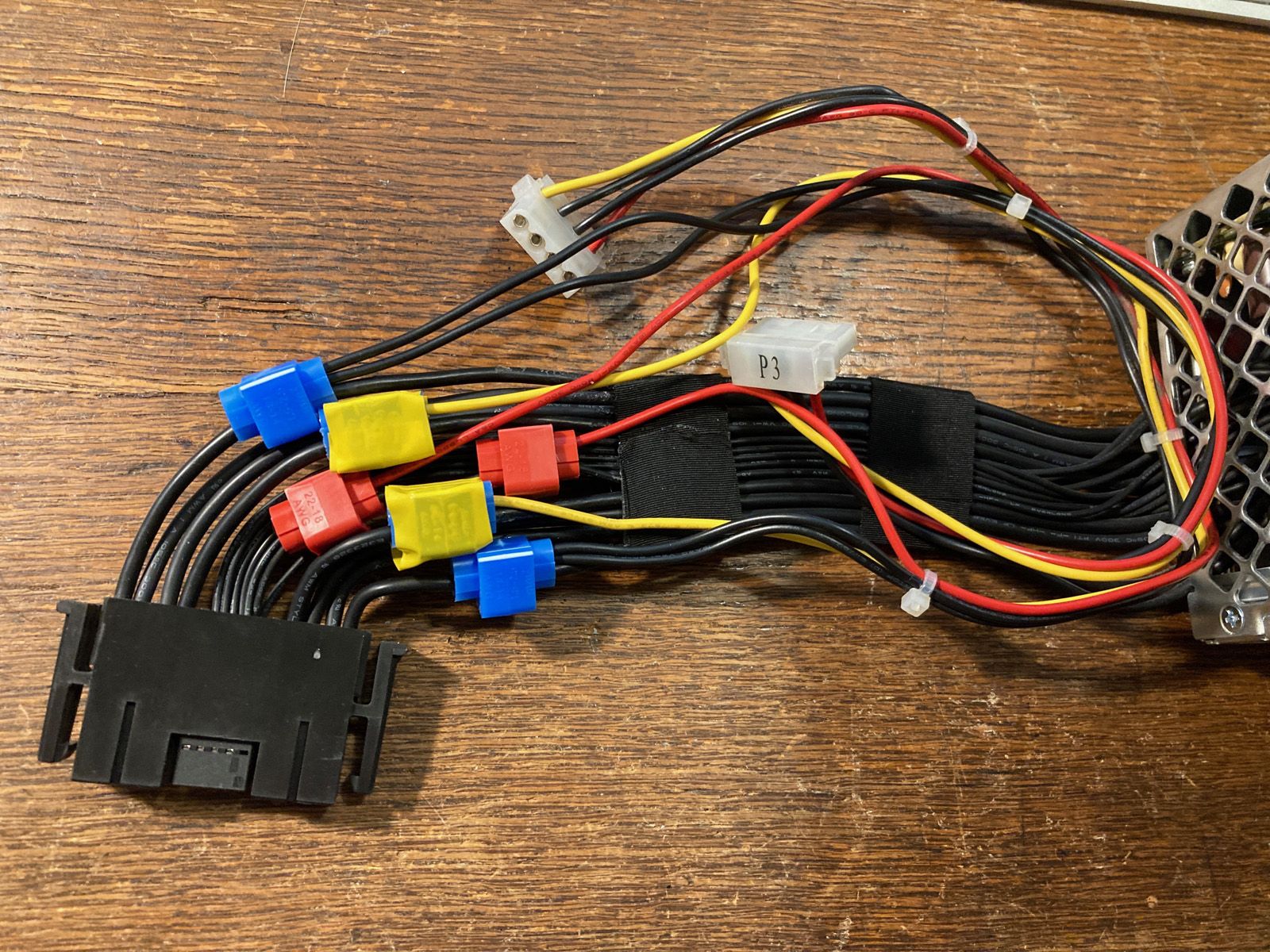

The Seagate 1.8TB drives I would be putting into the bays list 5v and 12v, so I did a modified Pixlas power mod to add two Molex power cords instead of the GPU power taps.

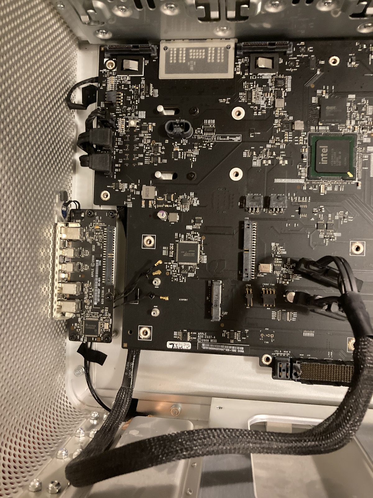

Since I would no longer be using the dual SATA ports in the top optical bays, I instead decided to reroute the cable to bottom CPU location since this was a single CPU tray. This required complete disassembly of the entire computer.
And routing the dual optical SATA connectors below the bottom of the motherboard towards the bottom of the computer.

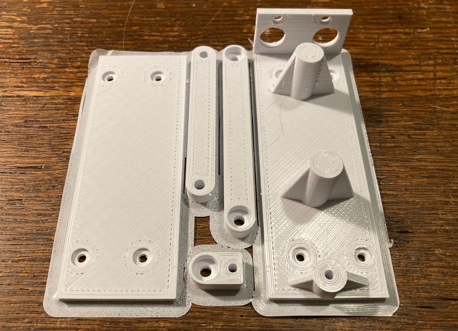

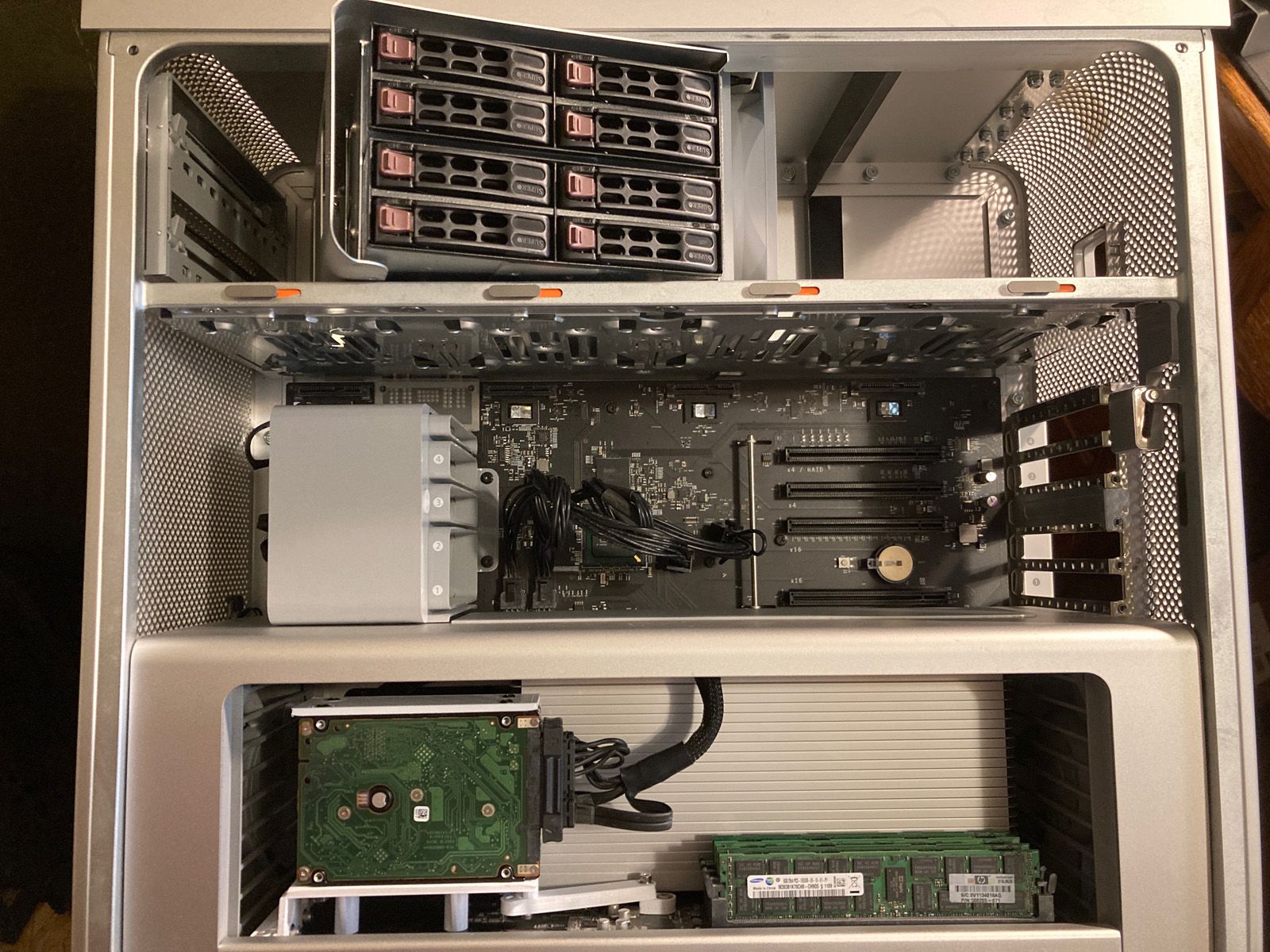

I then designed and 3D printed a dual 2.5" drive mount to add to the single CPU tray.
Which resulted in this look:
I then reinstalled the PSU and routed the SAS cables down to the Areca-1222 card (moved from the 3,1). Preliminary Raid-0 (striping) test before final mounting.

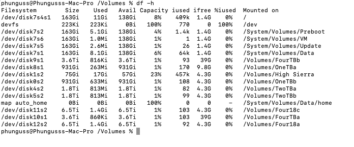

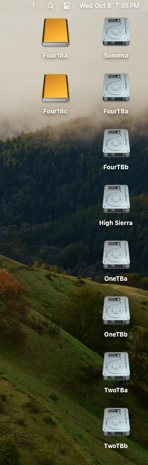

Total power draw on this machine with all 15 drives installed (8 raid, 6 SATA, 1 NVME in PCIE slot) = 290 Watts max... idle around 210W. I am sure it will kick up a little when all drives are busy. This will just be a secondary backup to my TrueNAS/Jellyfin server.
That is two 4TB 3.5 SATA drives, two 2TB 3.5 SATA drives, two 1TB 2.5 SATA drives, eight 1.8TB SAS drives, and one 256GB NVME on PCIE.

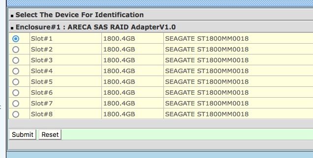

Areca Raid card interface via web with 8x1.8TB SAS Seagate drives.

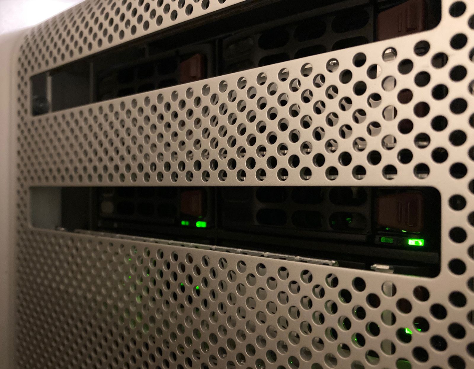

I had to remove the down-slide optical covers to get the drive trays installed. I will be designing a replacement to cover the holes.
