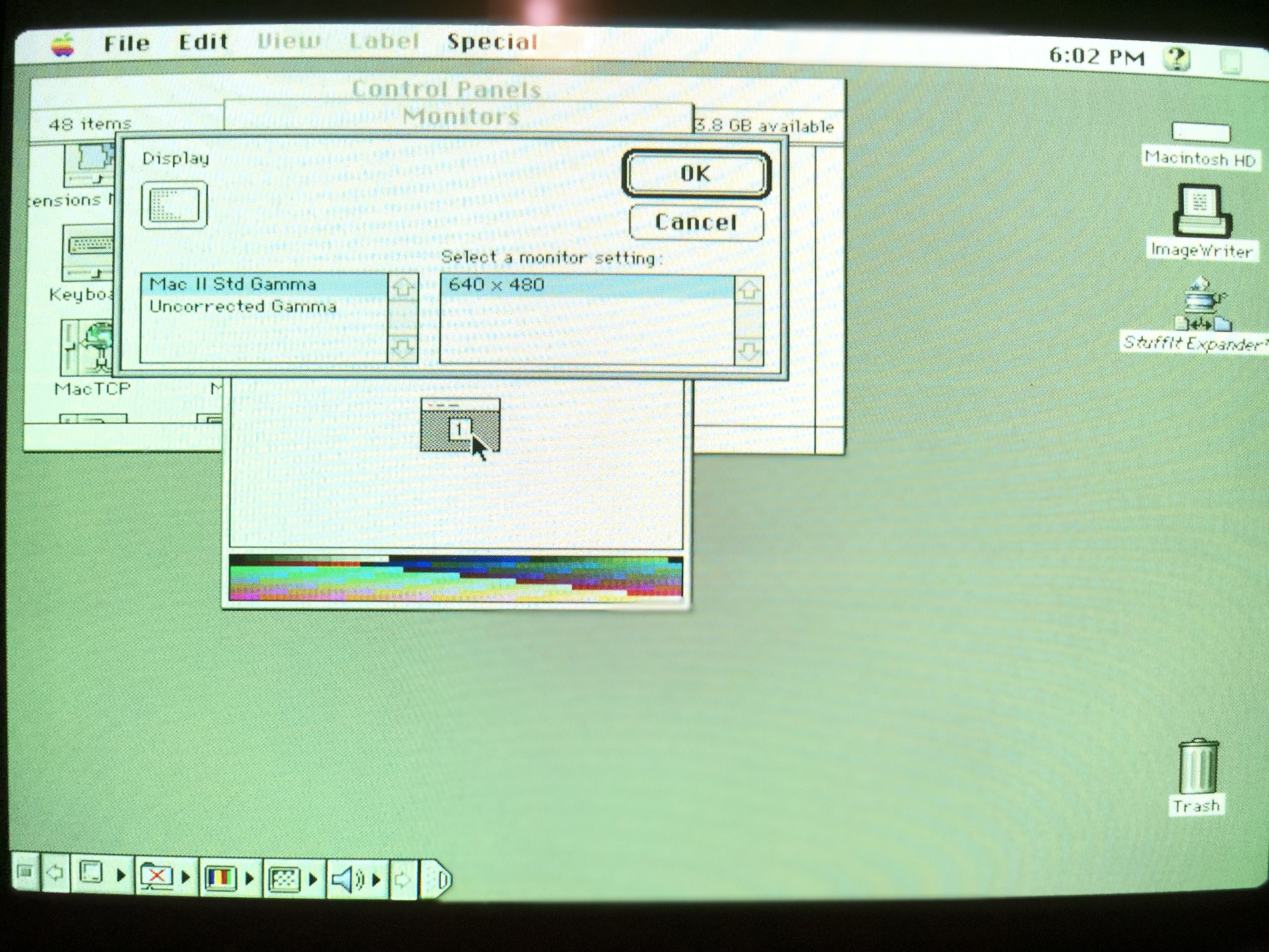

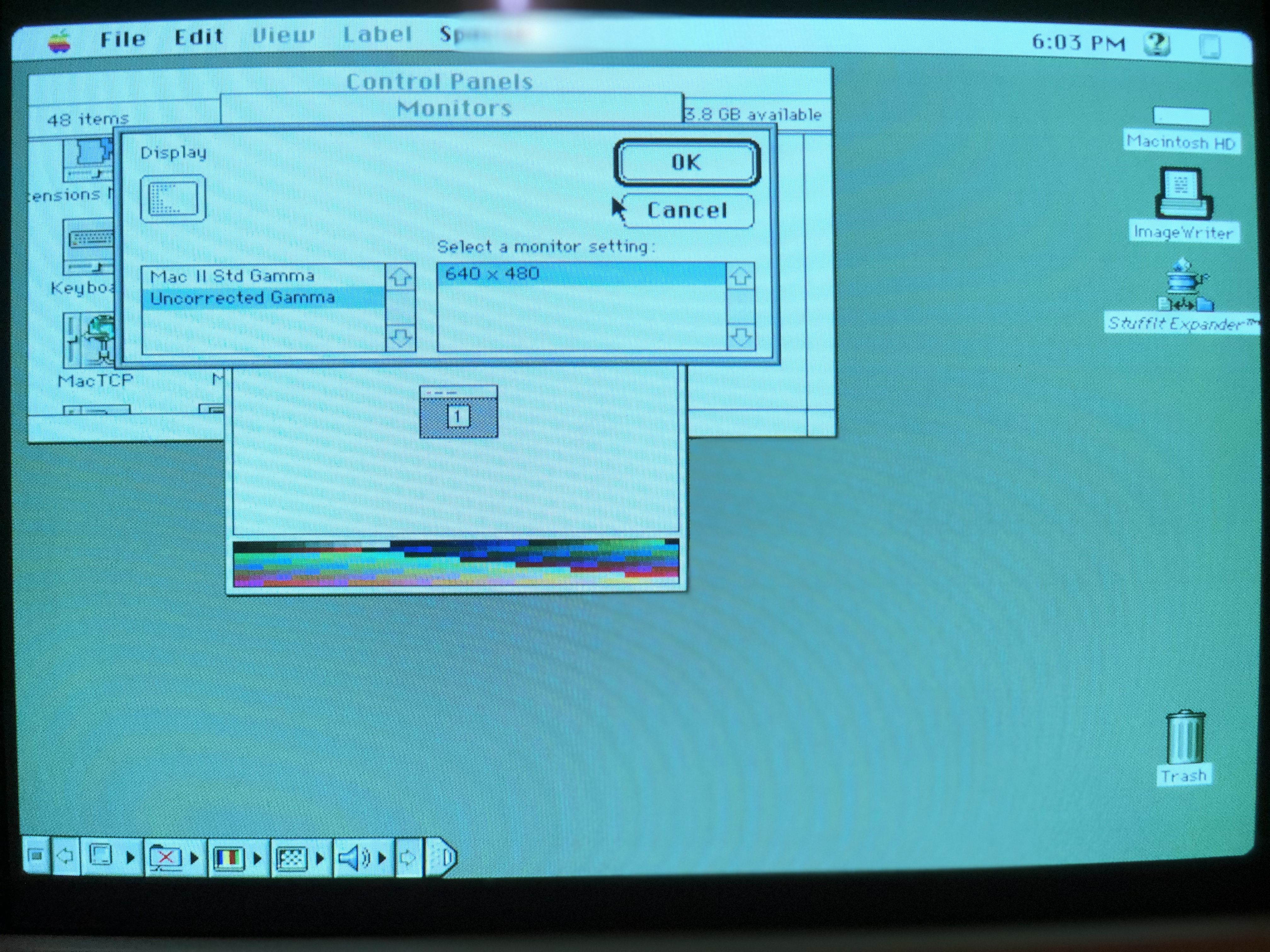

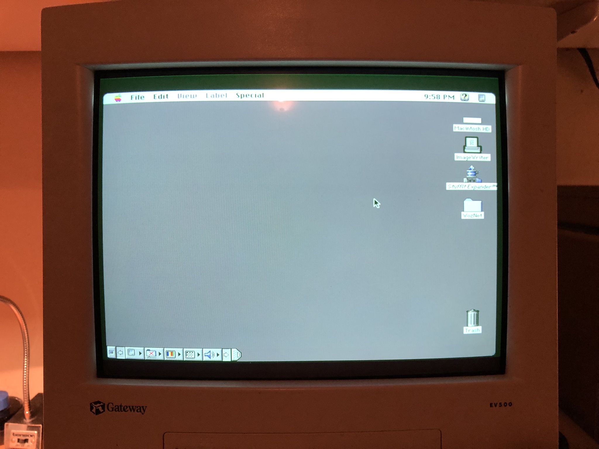

However, the remaining issue is with a green tint on the picture when the monitor is connected to my IIx. I have an Apple DB-15 to VGA adapter that worked with a flatscreen Dell

This sounds like a sync-on-green signal which your monitor doesn't know how to filter. There are circuits that will remove this. Myself I use an active sync-on-green converter that turns it into more typical composite sync, though these are not cheap.
Alternatively, you could try fiddling with the adapter if it has DIP switches, or you could use a different Mac video card that doesn't emit (or solely emit) S-o-G if you have one.

Unfortunately, my adapter doesn't have any DIP switches. Do you have any recommendations for a specific sync-on-green converter?

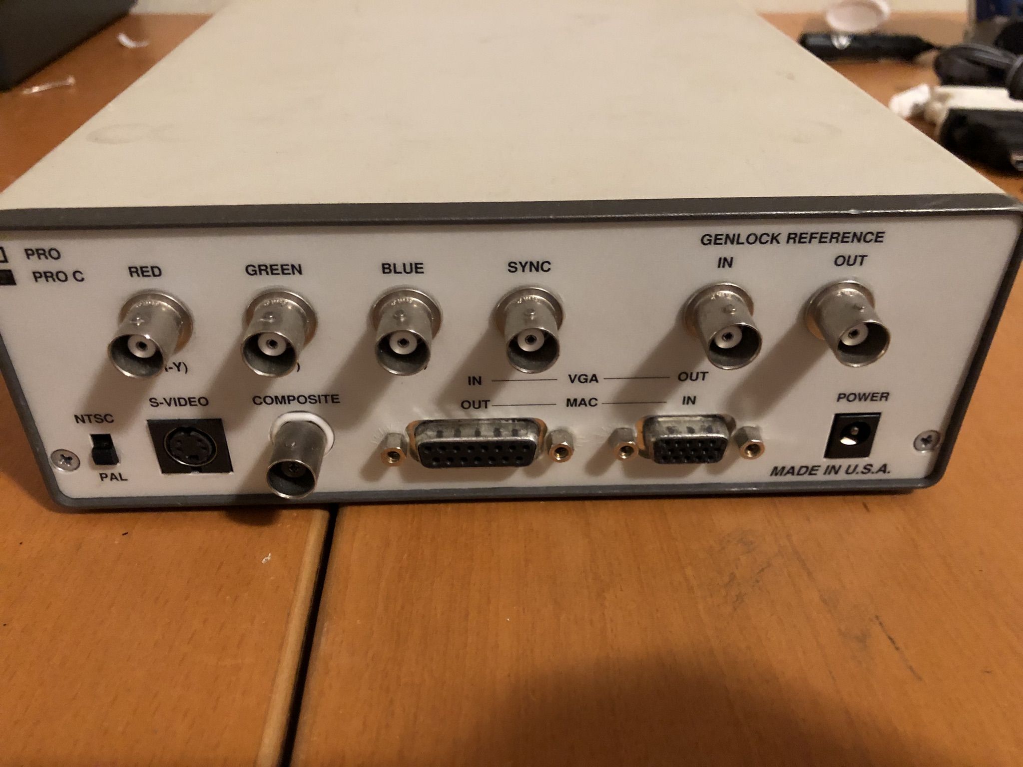

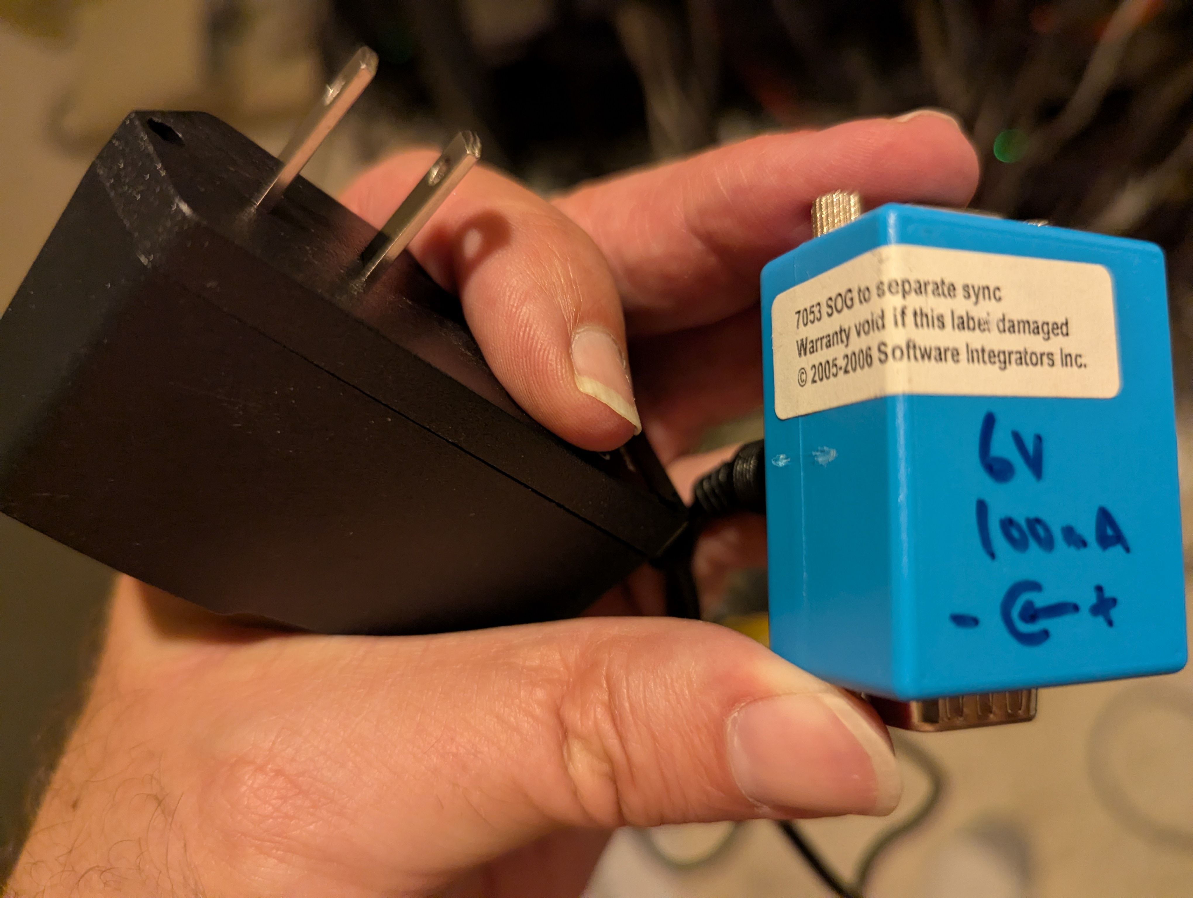

The one I use is a Software Integrators #7053. They still sell these, but they are not cheap, about $140 ( https://si87.com/Shops/3738123e-8b74-40b2-bd96-ddff0f19d352/Products/7053 ). They require an active 6V power supply which is included, and work for most systems and monitors. You plug the output of your Mac adapter into the input and your monitor into the output.
