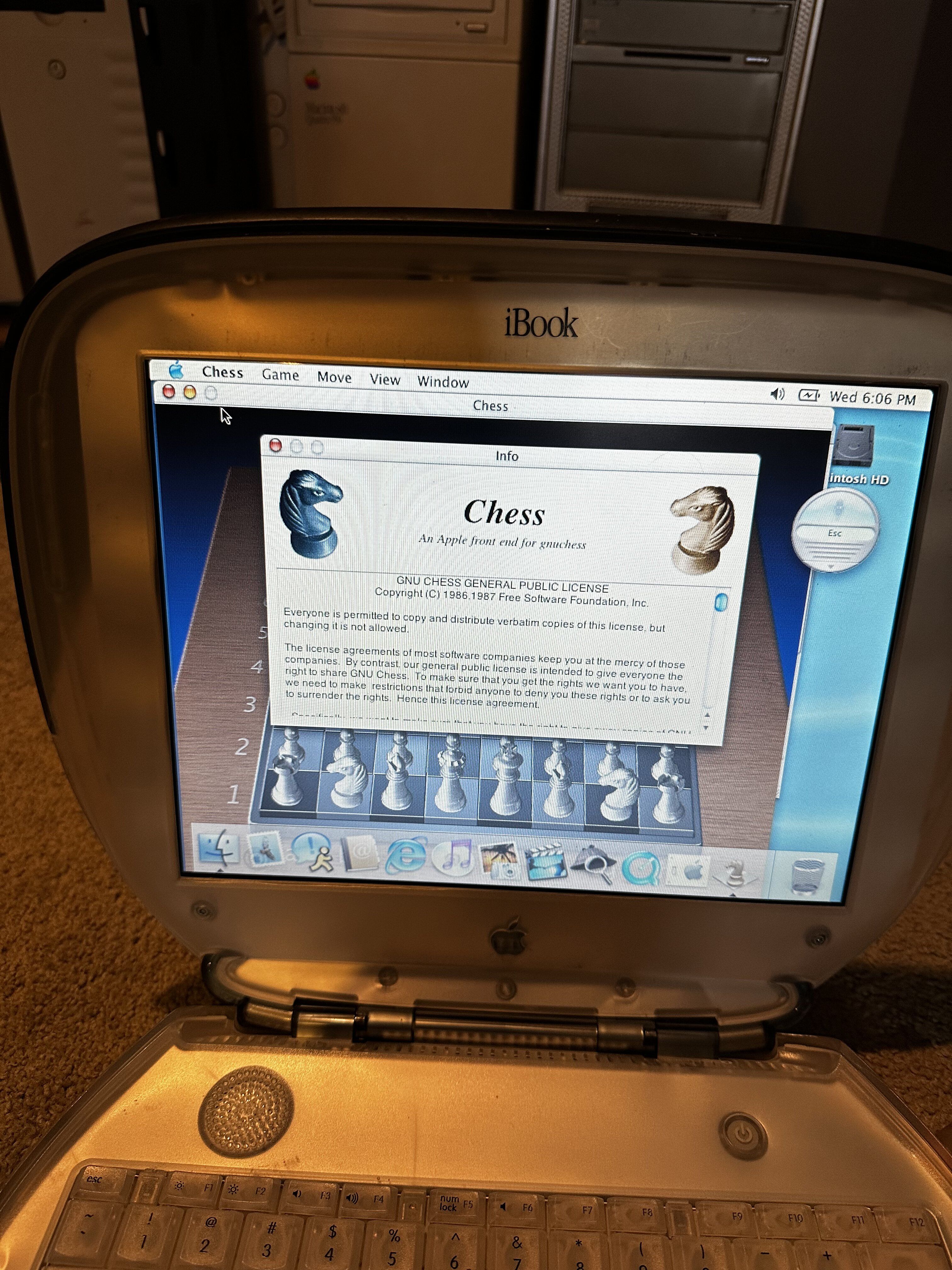

Got a gray clamshell in the mail and though packed very carefully and lots of bubble wrap, something must have hit it just right to flex the LCD:
It seems like these are fairly common parts - any caveats or suggestions for a replacement as I start looking?

Apple used multiple different LCD manufacturers, and to my knowledge none of the cables are cross-compatible. If you do find one that is of a different brand than the one inside it now, you'll need to make sure it comes with the cable as well.

Instead of searching for keywords like "iBook LCD," you'll have better luck disassembling the display housing and searching for the part number off of the LCD panel itself. There seems to be a cottage industry in China that refurbishes older-model LCD panels -- I suspect it's primarily to serve the industrial controls market (CNC machines, etc) but I was able to find a replacement panel for my Duo 270c this way.

I think the LCD panels from several other iBook G3 and G4s from this era should be suitable replacements, but the challenge is making sure that you have the right cables to connect them to the logic board.
Something to note is that these iBook LCD panels can be upgraded with higher resolution parts than were originally installed. If you need to replace the LCD already, this XGA mod might be something worth looking into. See here for some more info:
