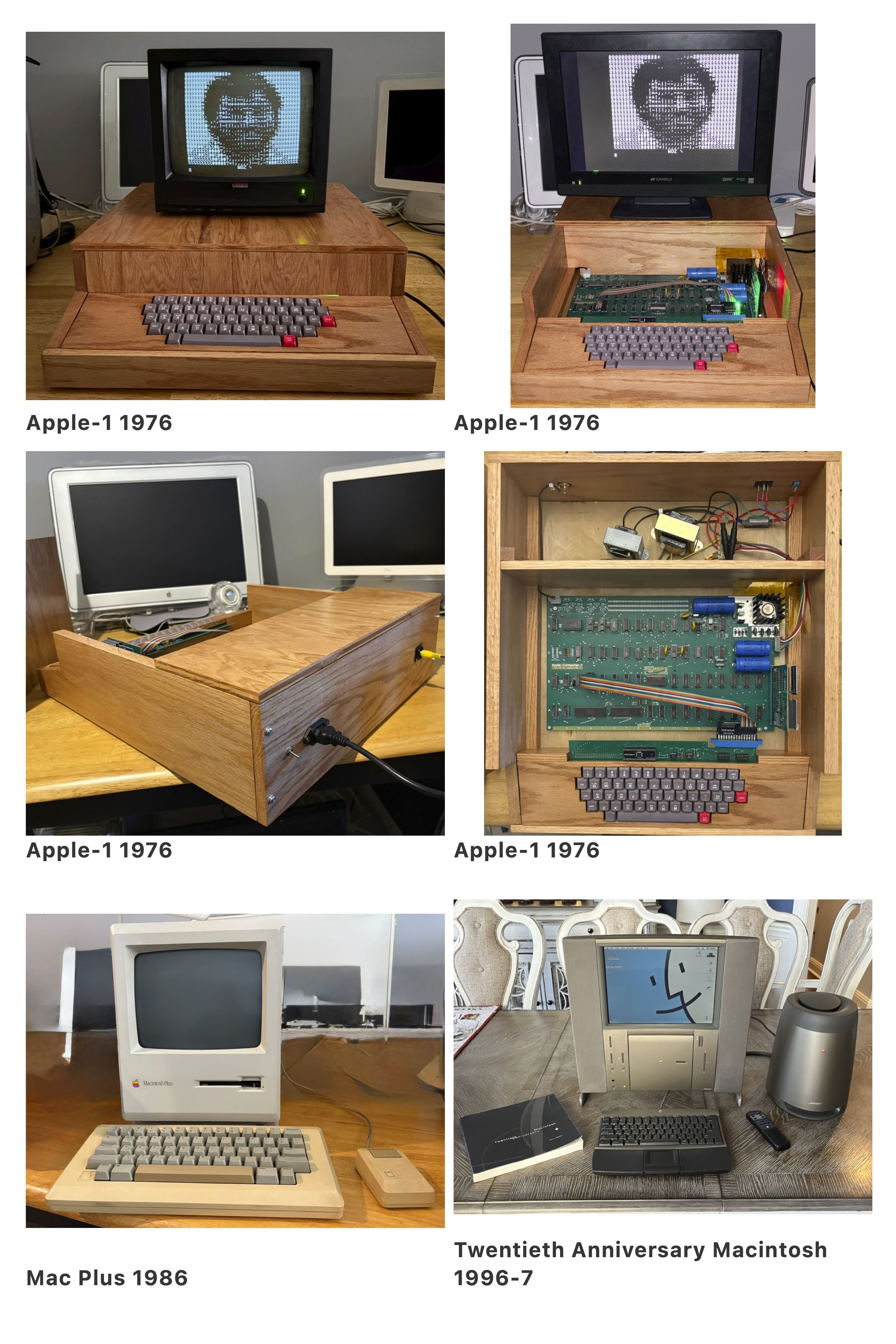

New Apple-1 Replica on time for Apple 50th anniversary.
Just finished the case a couple of weeks ago. I started this project in July 2025.
Some other computers from my collection.

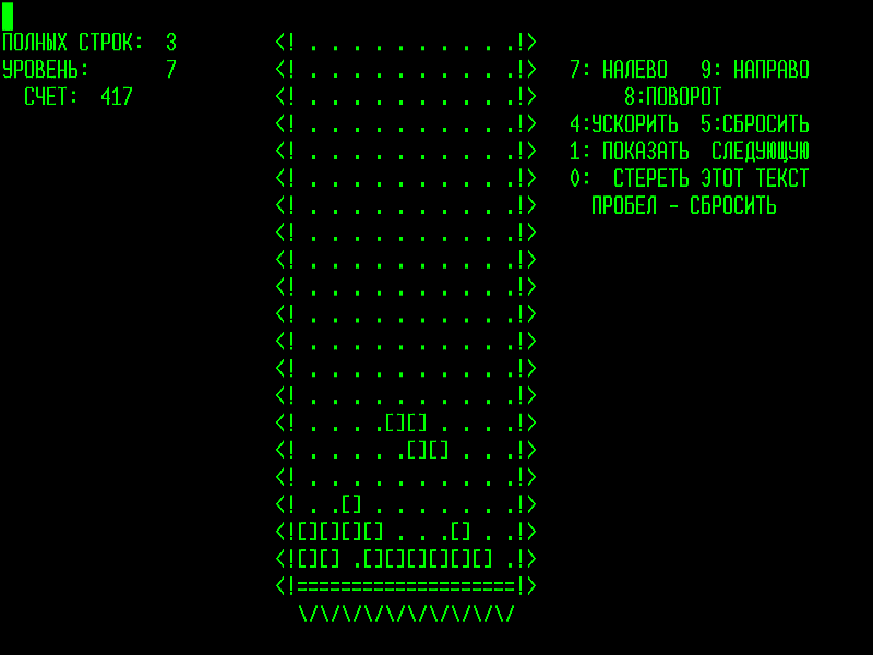

For example, I was watching the Tetris movie last week and saw that the original Tetris was actually character based.
Could it be that someone could make a similar port to work on a character based Apple I? That would be pretty awesome and make the Apple I more than just a proof of concept programming machine.

Difficult. The Apple-1 does not have addressable video memory, just two ports to get a key and print a character. It can't even backspace, and clearing the screen is actually done with a hardwired circuit. Additionally, because of the way the shift registers used to generate the screen are maintained, it is only possible to add one character to the screen per frame (approximately 60fps, so 60cps).
An Apple-1 Tetris would have to be constantly printing a new screen and scrolling off the old one, and it would take a few seconds to redraw. You could play that way but I suspect it would be very distracting.
