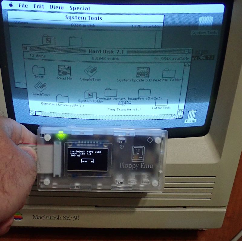

Fast forward to this week (2025), @SuperPete suggested the unnamed init is "MacIIHD20" (attached) from the Developer CD Series 1990: Night of the Living Disc.
Guess what? It works:
I have confirmed that a factory System 6.0.3 floppy disk with the MacIIHD20 init permits mounting a Floppy EMU HD20 on a Macintosh II, IIx, IIcx, and SE/30. This is particularly nice when servicing cap-goo Macintosh II computers, as they do not have ROMinator-style replacement ROMs.
