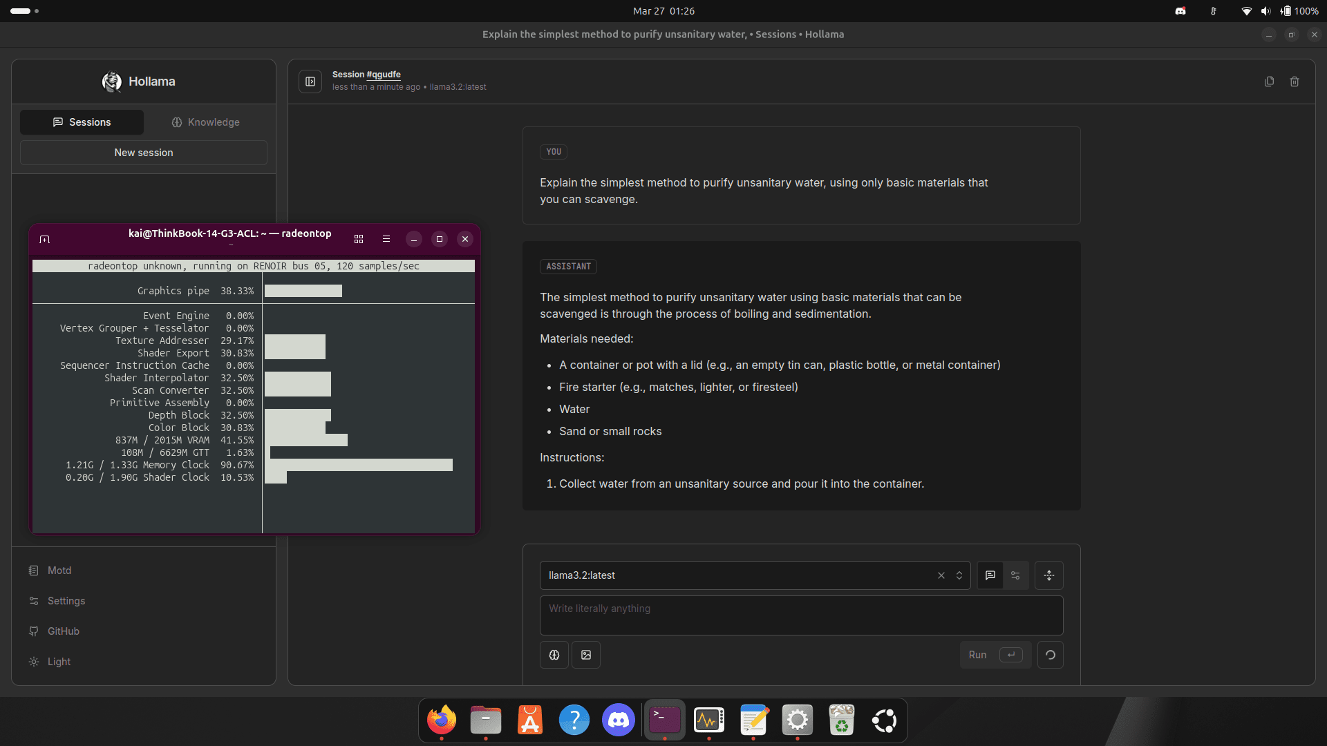

Before launching into anything else, I wanted to monitor the GPU. I tried several times to install amdgpu_top but the compile always, always fails, so I defaulted to radeontop instead, to monitor if the GPU was actually being used. Bit more basic, but did the job.
So with everything in place, I asked llama3.2 a question: "Explain the simplest method to purify unsanitary water, using only basic materials that you can scavenge."
After all, this is supposed to be a tool for if the SHTF... ;)
Ta-da!
OK so the Graphics pipeline isn't being 100% saturated, but that result got spat out in about 3 seconds, tops, and kept going for about 15 more seconds before I had about two pages of information.
Seeing the result felt like this:
:ROFLMAO:
Not quite 88 tokens/second, but around 50 or so, compared to the CPU which managed 16.
