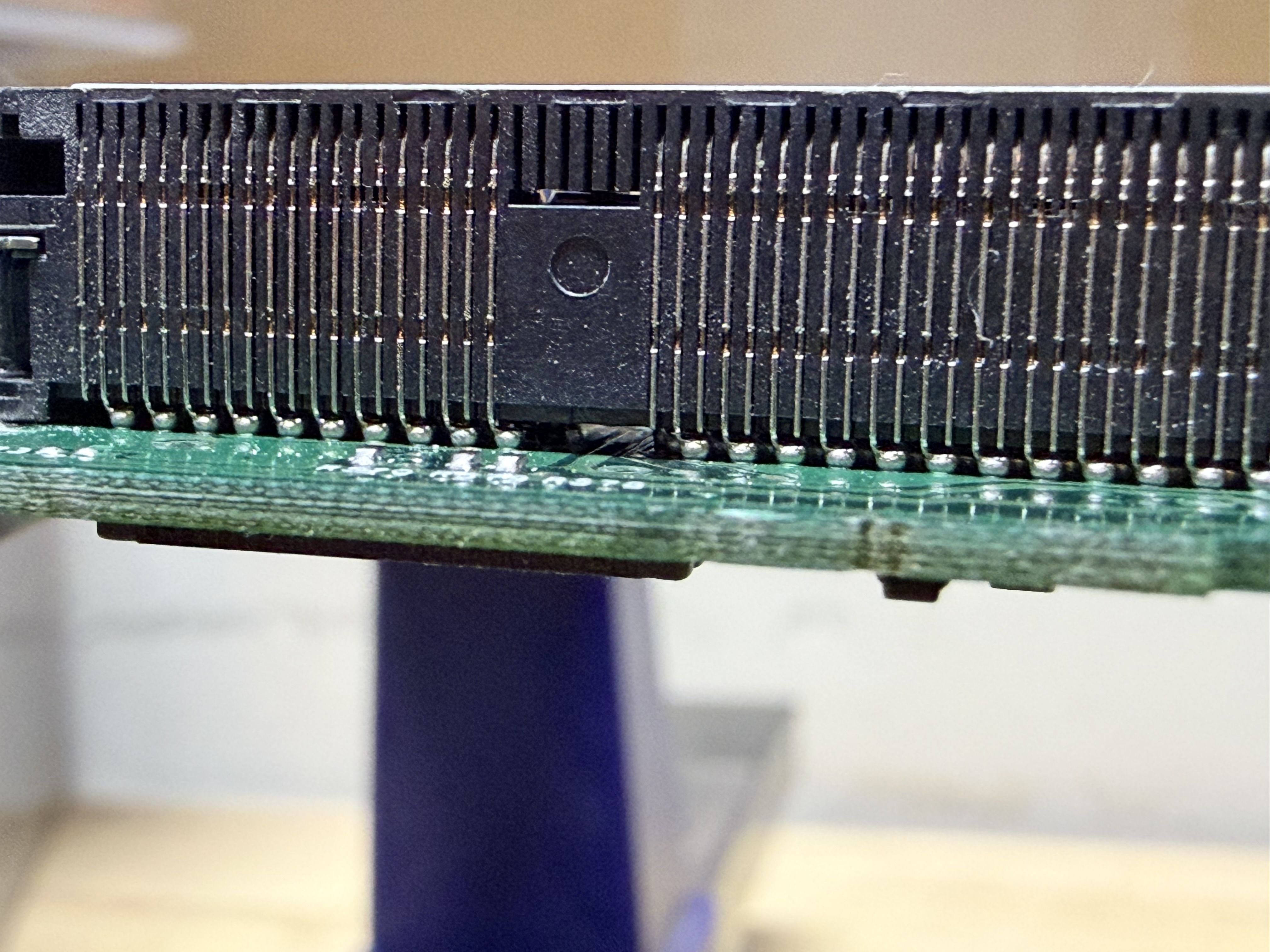

Well, I gave it a shot! Long story short no luck. Even if it worked, I'm not sure I would recommend it, that tear down was a little brutal. The keyboard comes off easy enough but since the RAM is on the backside of the motherboard, it requires removing the whole logic board (which means reapplying thermal paste on the processor & GPU).
Once it's out, the RAM slots are surface mounted, so there's definitely no soldering iron shenanigans that can be done.
I tried with the heat gun for a little bit, but the issue is the lower slot's connections are behind the upper slot connections that you can see in the picture. It's going to be super difficult to get enough heat under there with a heat gun without melting the surrounding plastic. This is probably a reflow oven situation, and that's assuming the issue even is the solder connections (which I'm not sure is actually confirmed, it just sounds plausible).
