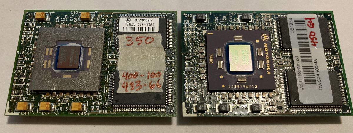

Possible dead CPU? So I threw in a spare 350MHz G3 and changed the speed to 350. I got a quiet chime with a tiny bit of garble, but still no video. Something strange about the CPU I pulled out... Appears to be an OWC Zif 500MHz G4!!!! Made for beige G3 up to 533MHz and B&W to 500MHz. Something to play with this weekend.

I got it to boot, originally thought it was IDE bus, but it was a bad ram. I cannot get the G4 to boot, but I had a spare G3-350MHz ZIF, so that boots fine at 350 and 400. I checked for the G4 enabler (OWC/NewerTech), and it is active. No variation of jumpers on CPU speed will boot the G4. I have been googling and I see that some of the faster CPUs will slow the bus speed down to 66MHz vs the 100MHz standard. I am wondering if there is a way to manually change the bus to 66 to see if it will boot the G4? I can't find anything regarding B&W bus speed changes with jumpers.
Mobo and Video card tested good, so possible dead G4-500MHz ZIF.

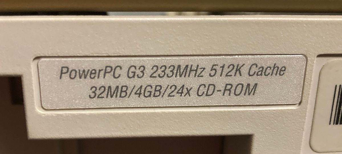

I finally got my hands on a desktop Beige G3-233 (overpaid on eBay for local pickup, because pics showed it powered on). Since this mystery G4 ZIF was not booting in either B&W G3 I had, I wanted to test it out in an actual Beige machine.
First, I installed a spare G3-350 and took it up to 400MHz.

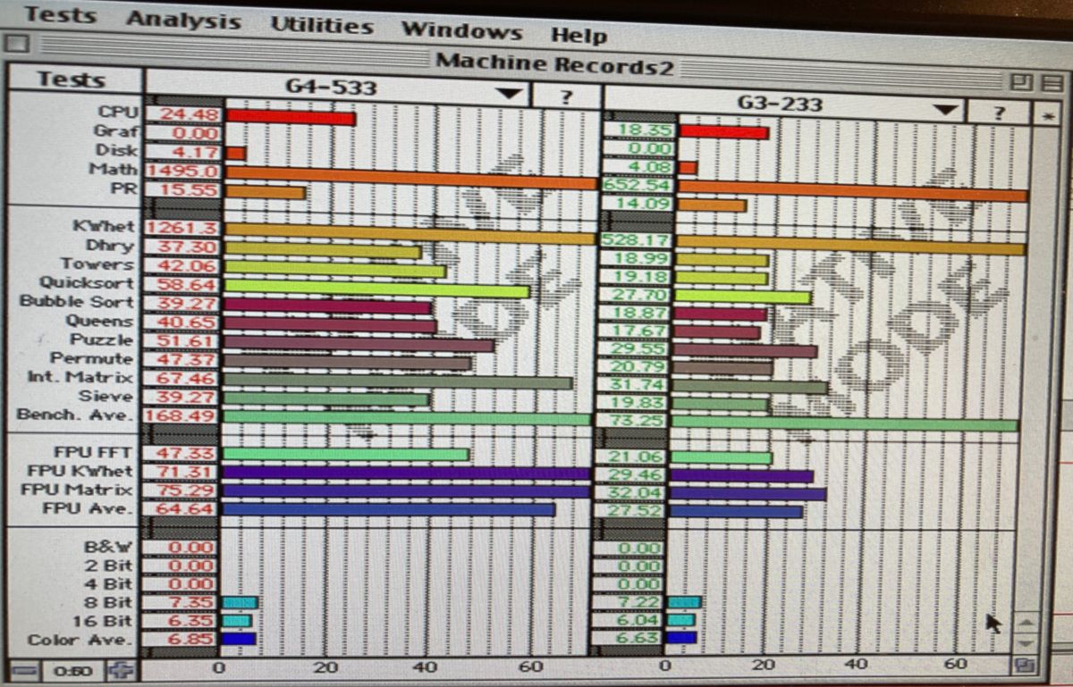

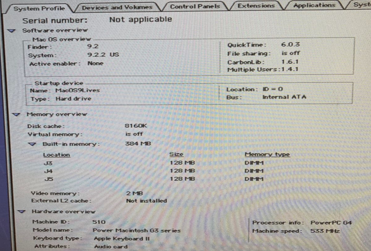

Then, I started slow with the G4 ZIF at 400, then 500, then 533MHz!
Speedometer 4.0. Maybe I will play with the 66MHz bus and take it up to 85 and then see if I can get near 600MHz on the G4.

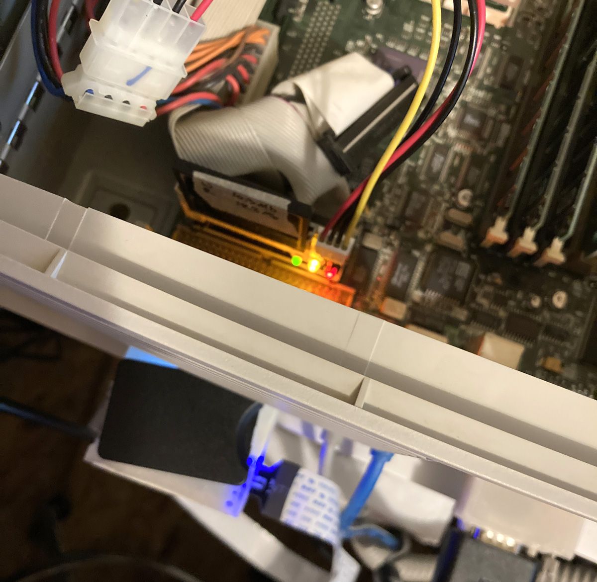

Testing more options... OSX 10.2 install from cd looks like 2+hours... I will eventually try XPostFacto for 10.4 later.

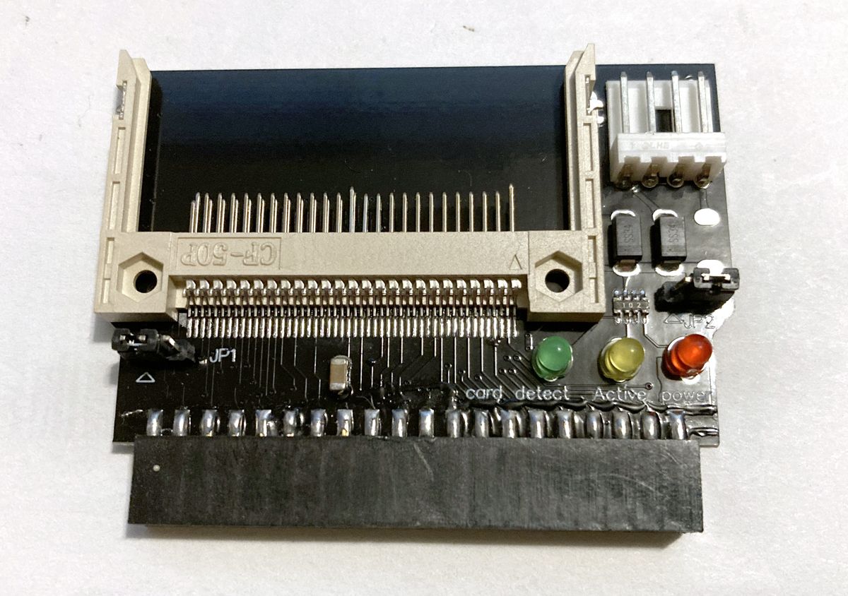

I used a CF to IDE insert directly to the motherboard on the internal hard drive bus.
Since it is vertical, I can't close the case... this is just for testing. External BlueSCSI with a MicroSD to SD adapter and a 32GB SD card.

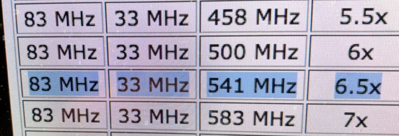

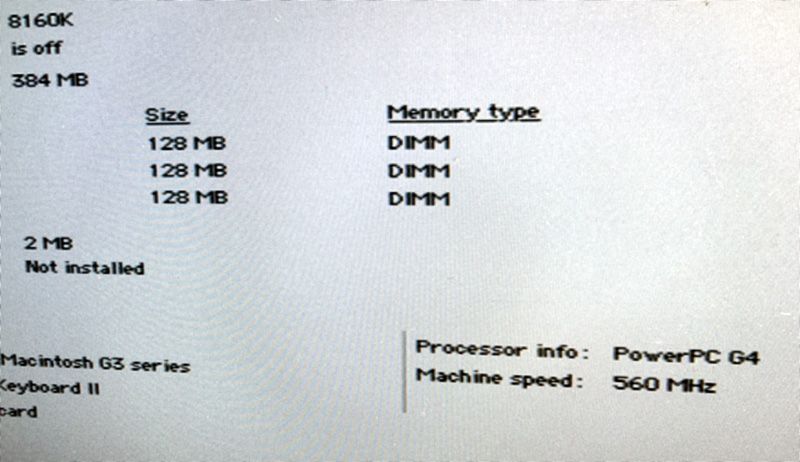

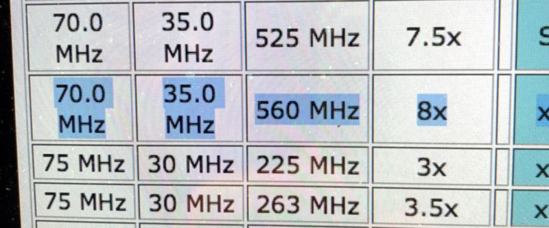

Jumper settings: 84MHz base, 541MHz CPU, does not chime at all... Boo
But 70MHz base and 560MHz CPU works just fine!

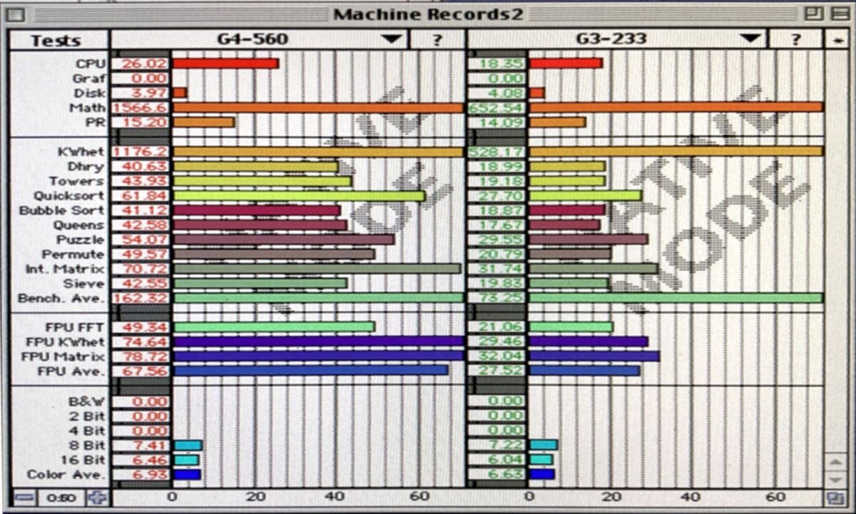

Compared to stock 233MHz G3.
In the end, I rolled it back to 533MHz so the base was the normal 66MHz.
