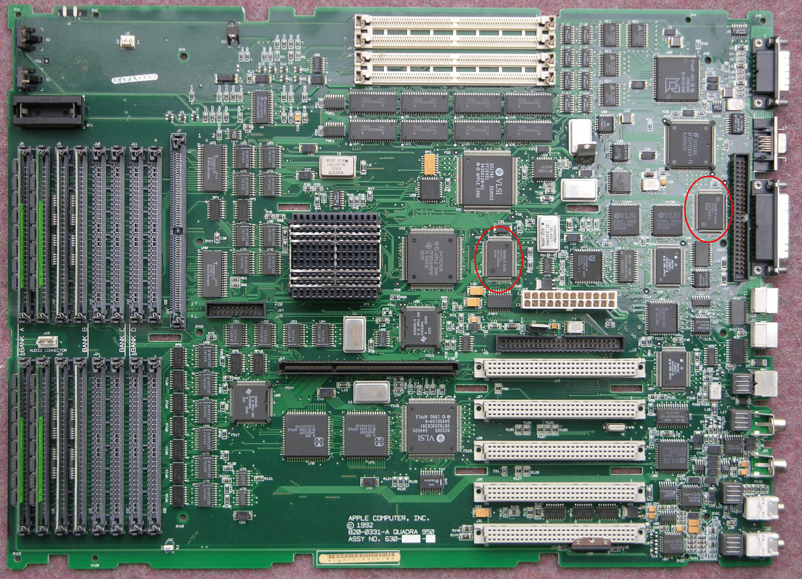

I am therefore assuming that my SCSI bus, if not my entire IO stack is busted. Does anyone know where the SCSI controller is on the logic board, and how to diagnose this any further?

I believe Mac OS internally treats both SCSI controllers as a single bus - Despite two SCSI busses, for Mac OS to work every device on BOTH busses must have unique IDs. You cannot have a device #5 on both busses, despite the physical hardware supporting this.
I think A/UX does not have this limitation and Apple's service guide says that it would be possible to have up to 30 SCSI devices, but that Mac OS "folds" them into one virtual bus.
