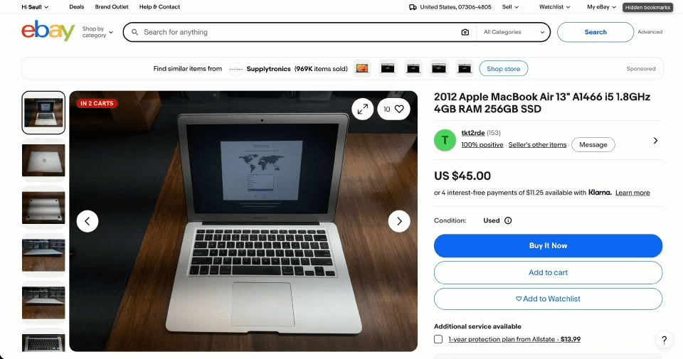

Hey folks...it looks like there is a problem with installing Linux Mint on a 2012 MacBook Air I want to buy...
You need to have an Ethernet connection to get the proper packets to get onto the internet via wi-fi. For me, that's impossible, because my internet connection is through my apartment building's wi-fi. That's how I connect to the internet. I'm watching this video now, where this gentleman talks about that.
What can I do to get around this problem?

I may order the MacBook Air Friday. Will keep you posted.

MacBook Air ordered. I should get it 11/5. I'm driving to northern New Jersey tomorrow; I'll stop by MicroCenter to pick up a flash drive.
