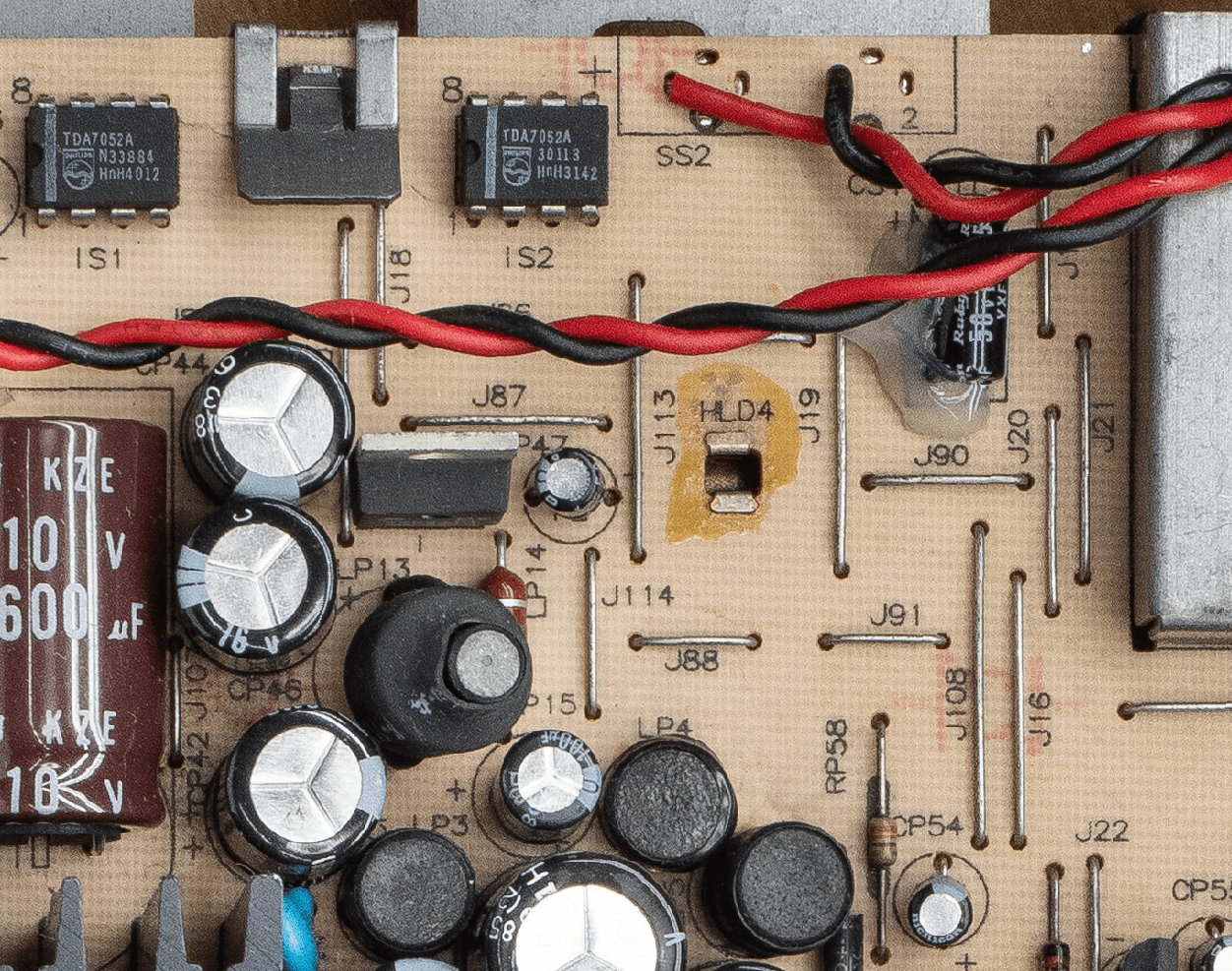

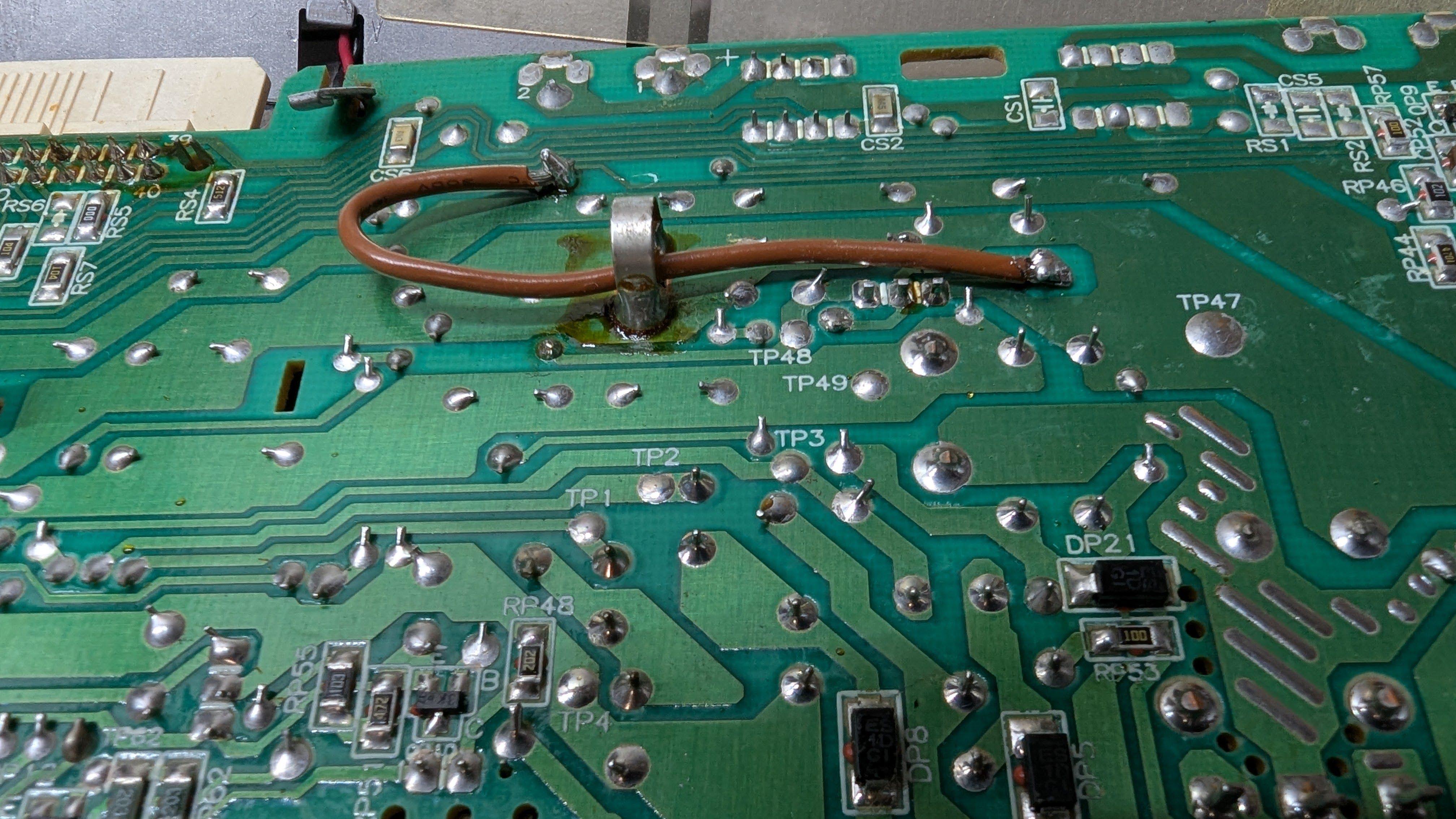

Hey Folks,
Craig and I found one analog board in our Color Classic lot that we think is modded for 640x480 but in a weird way.
Instead of modding the sense lines they removed Jumper 19 from the top of the board and added a bodge wire from one point on j19 to capacitor cp44 on a rev D analog board.
The board isn't working atm so we can't test that this mod is for 640x480 until we get the board going again but based on the bodge to the Horizontal Deflection Voltage it seems to make the most sense that this would be what its for.
Has anyone seen this mod done before? Thanks!
2,551
1,998
The YELLOW wire in your photo shows it is the standard 68.4V VGA Mod (not the 84V 13" Hi-Rez Mod), and that is also shown below...
I've never see anything like your BROWN wire though. Maybe @Kay K.M.Mods has seen it before?

Well I got the analog board working again. A color classic logic board works fine although a bit distorted with the voltage change. A 575 board on the other hand just gives the standard bus error when you try it on a unmodified analog board. So not sure what that brown bodge is meant to do but It doesn't seem to work for me.

So to clarify im aware the voltage change isn't needed for the color classic board. I was just testing the board as it was after recapping
it to see if i would get video. Given this weird unidentified brown bodge wire.
I tested first with a color classic board then again with a 575 board. I was curious if this brown wire was some alternative way to change the sense line but given the results id say it is not or it wasnt complete.
The fun of buying a random board off ebay never know whats been done to them.

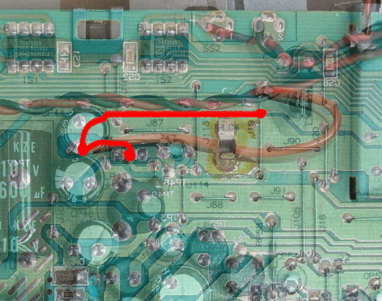

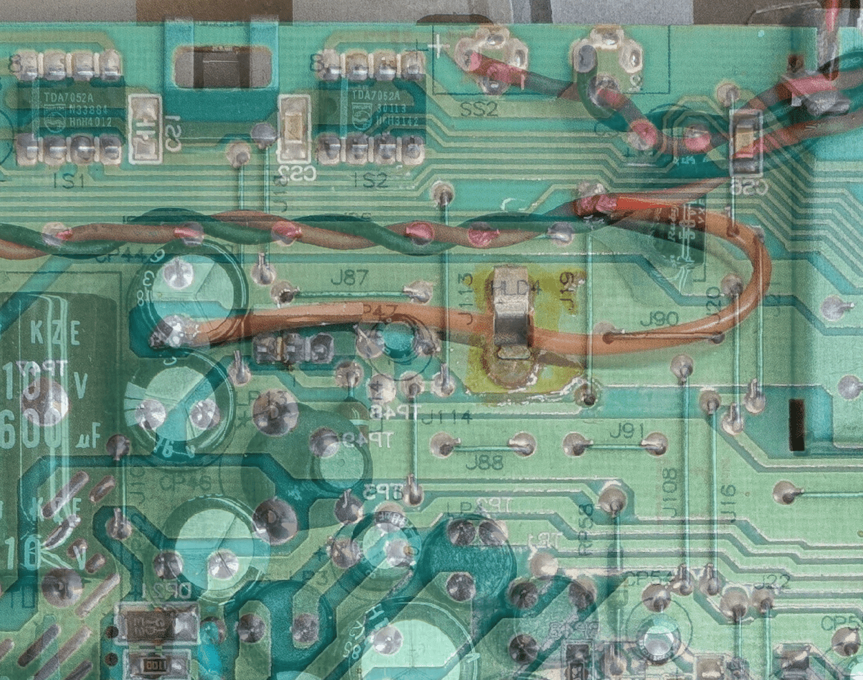

Here is the horizontally flipped version of your BROWN WIRE photo...
And here is the component side (not flipped), perfectly matched to the above photo...

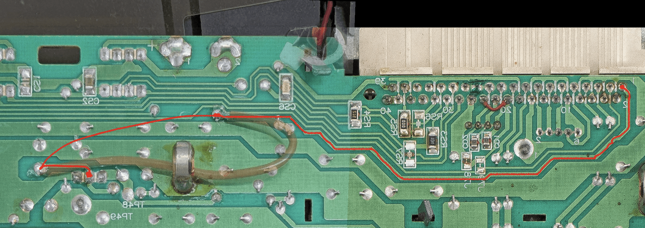

Here are the two photos overlaid atop each other with the brown wire photo partially transparent so we can see the connections...

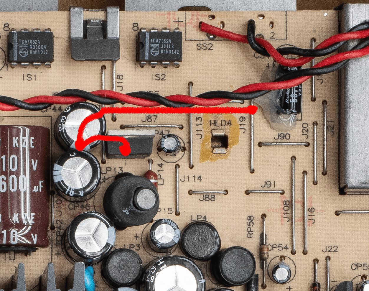

Here is my red line drawn to better illustrate that jumper J19 is being tied to the GROUND side of the capacitor at left, which in turn leads to the middle of 3 pins of that transistor....
Here is a clearer view of the same...
And here is the final result, which is the mystery question I will leave you to resolve because I cannot answer the question you see me ask below...
I only have top-down photos and my CC is not handy. I cannot read the markings on that 3 pin transistor, and I am just ASSUMING it is a transistor. You will need to read the markings and get a data sheet for that 3 pin component.
If it is a transistor, maybe the previous owner determined it was dead and decided to permanently tie the Collector and Emitter of the transistor (assuming it is an NPN BJT transistor) together, assuming that it's OK if the transistor stays "permanently switched"?
Again, this is the mystery you will need to investigate.
LOL but that's the part I can't figure out! ;)
Oh btw J19 was cut in half on the top of the board so the brown wire only attaches at one half and isn't connected to the other half.
When we received this board it had this bodge on it along with the voltage change so you would think it would have something to do with the 640 resolution but apparently it doesn't at least it doesn't seem to from my limited testing. I'll probably just take it off now and finish the conversion for 640x480 by changing the sense lines. It's just so strange...what did the person who did this mod think they were going to accomplish? There was a reason for this -- flawed reason or not.

OK. J19 is cut in half, as you say. That only means the two pins on that part (transistor? something else? You'd need to read its P/N to find out) are NOT tied together. Fine and well. But it means this is true...
Ignore that little red wire connected to pin20 at right because that's a photo of my board with sense line mods. What you must look at in the above is the fact that PIN-1 at the upper right is being tied to the middle pin of that transistor (or whatever it is — you've not checked its part no. yet) via the BROWN WIRE. But PIN-1 (upper right in the above) is not part of the sense lines, I don't think. What does it lead to?
In other words, is the BROWN wire really a SENSE LINE mod like you are guessing it is, or is the BROWN wire instead trying to fix something broken, which would result in Analog Board malfunction if the BROWN WIRE is blindly removed without knowing what it does?
My view of the component side is blocked by the metal shield so I cannot trace out PIN-1 to know what it is...

That's for the Power Color Classic (Takky mod), and it's understandable that @JDW doesn't know about this wiring, but this is a jumper that allows you to input -12 volts to the S1 pin of the 630 series logic board by removing jumper wire J19 on the analog board and connecting the regulator input terminal. This is not a perfect -12 volts, but it is -10 volts.
I may not have the full picture of this thread, but if the owner of this board does not plan to use it with the Power Color Classic, they need to put J19 back on the front and remove this jumper. Good Luck!
By the way, reasons why it doesn't need to be a perfect -12 volt... it seems that the -12 volts are not used as is, but are instead made -5 volts by a regulator on the logic board. I've been pretty busy lately, so I may not be able to post any more on this thread, but please keep trying.
This makes sense to me. The board was purchased off ebay for use in one of the (many) color classics Craig and i are restoring so we dont have the full history.
I could see someone starting a takky mod and then stopping without completing it.
