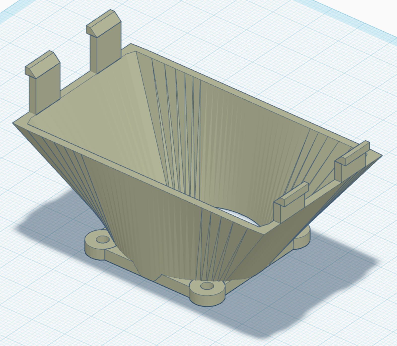

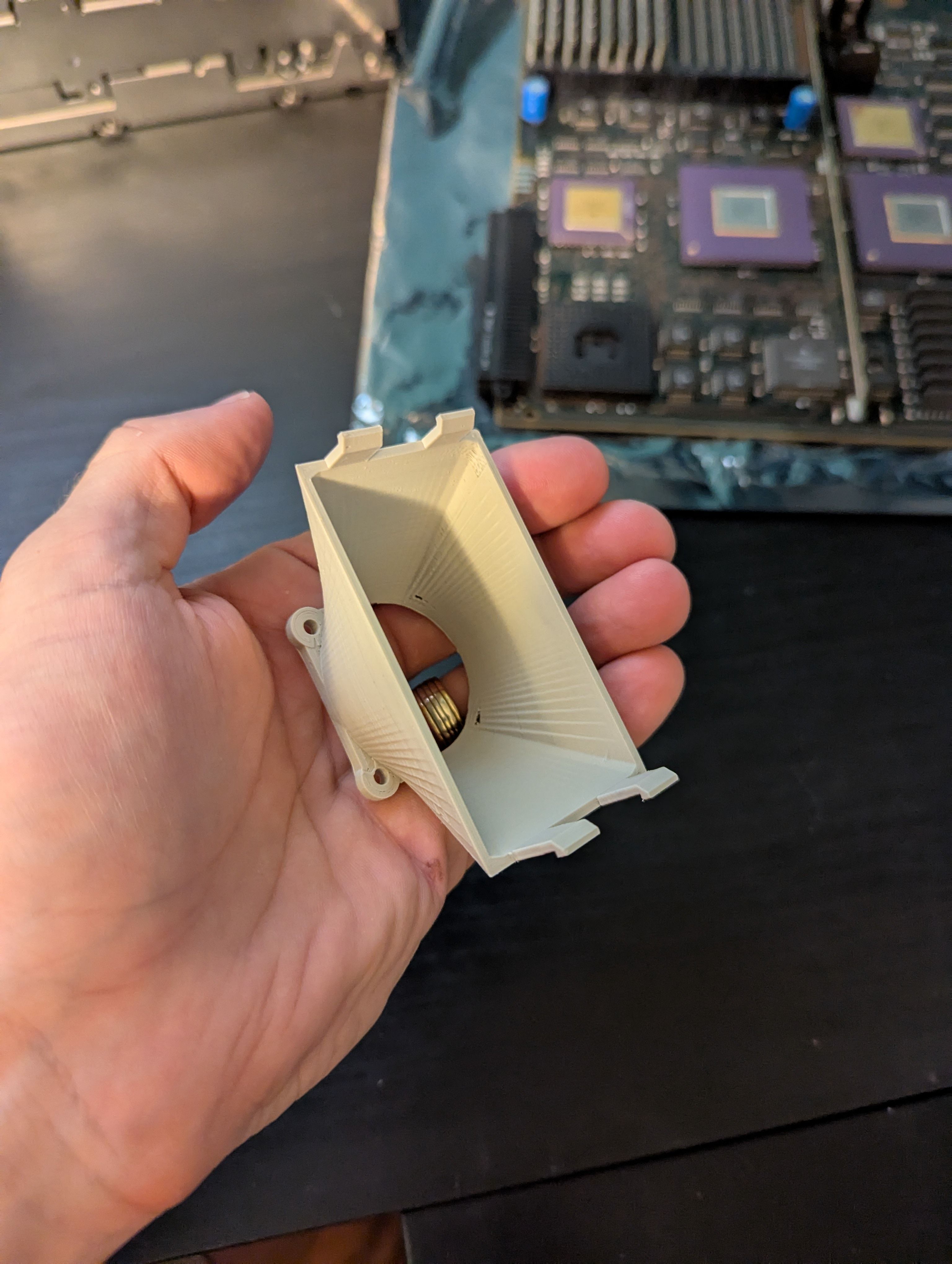

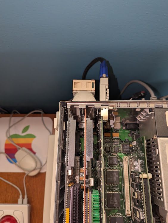

I don't know how useful this'll be for others since it's a pretty specific use-case, but I have a couple extra toasty full-length cards in my IIci, and I was trying to come up with a way to get some air moving through that walled-off part of the case. Since these particular cards don't require mounting brackets, I removed them and came up with this little snap-on duct thing for a 40mm fan that spans two adjacent NuBus slots:
-8132048643815677397.jpg PXL_20250821_133922804.jpg PXL_20250821_222317101.jpg PXL_20250821_222400977.jpg
It's not perfect, but what I found neat is that this model was almost entirely generated by ChatGPT 5. I took some measurements, and then told it roughly what I wanted and gave it the measurements, and it spit out a downloadable STL (along with some configurable Python code to create that STL). It took a couple back-and-forths and some minor manual tweaks to arrive at the final model. I particularly had to help it with the snap-on mounting tabs, but everything else is completely LLM-generated. One tiny step closer to a Star Trek replicator :LOL:
It does seem to work pretty well too. A sheet of paper is now pulled against the vents at the front and top of the case, so I know fresh air is now being drawn in to that area of the case and spit out the back. The fan wires can be tucked under the duct and routed into the case, or the fan can just be powered externally.

In this case probably not. Flipping the fan would likely conflict with the power supply's fan. By having the fan set to pull and exhaust, you're building a wind tunnel effect via negative pressure in the case, a lot like how server chassis are setup.

That was my thinking. With the particular cards I have installed, the section of the case exhausted by the 40mm fan is mostly walled-off from the rest of the case interior, so the PSU fan probably wasn't that involved in ventilating that area. There are slits in the case lid above the NuBus cards and slits in the case front in front of them. After adding the fan, a strip of paper is now drawn against both of those vents. I suspect that this is getting more heat away from the cards than just the heat supposedly rising out of the vents in the case lid. I could never feel any appreciable heat when placing my hand over the lid vents without the fan, but the temperature of the air expelled by the fan is noticeably above ambient.
