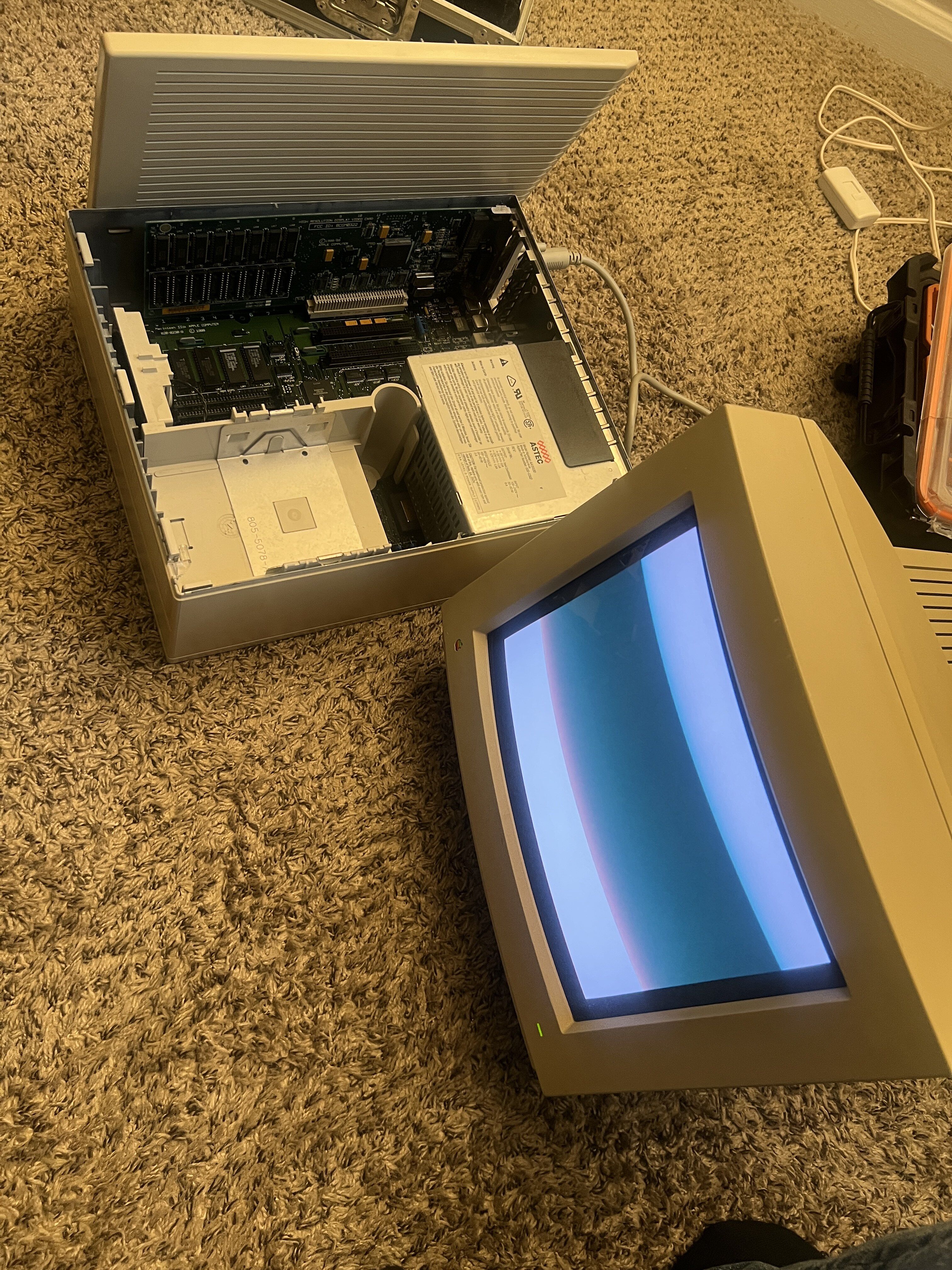

I recently got a IICX DOA from eBay. Recapped the logic board, graphics card, power supply and floppy drive. Cleaned it up, put it all back together and thankfully got a nice boot chime with no issues other than the fact that I'm just getting a blank white screen on the monitor. I noticed when I plug the monitor in NOT connected to the graphics card I don't even get the white screen (just a black screen) so my assumptions at this point are the logic board is OK and the issue is on the graphics card. My instinct says it could be bad VRAM chips? In other words it's trying to do something but it can't even get itself to 4bit/16 colors. Am I thinking the wrong way here? Anybody know of anything obvious with a BCGM0322 high resolution display video card? is it at all possible there could be something on the logic board causing this instead of the graphics board?

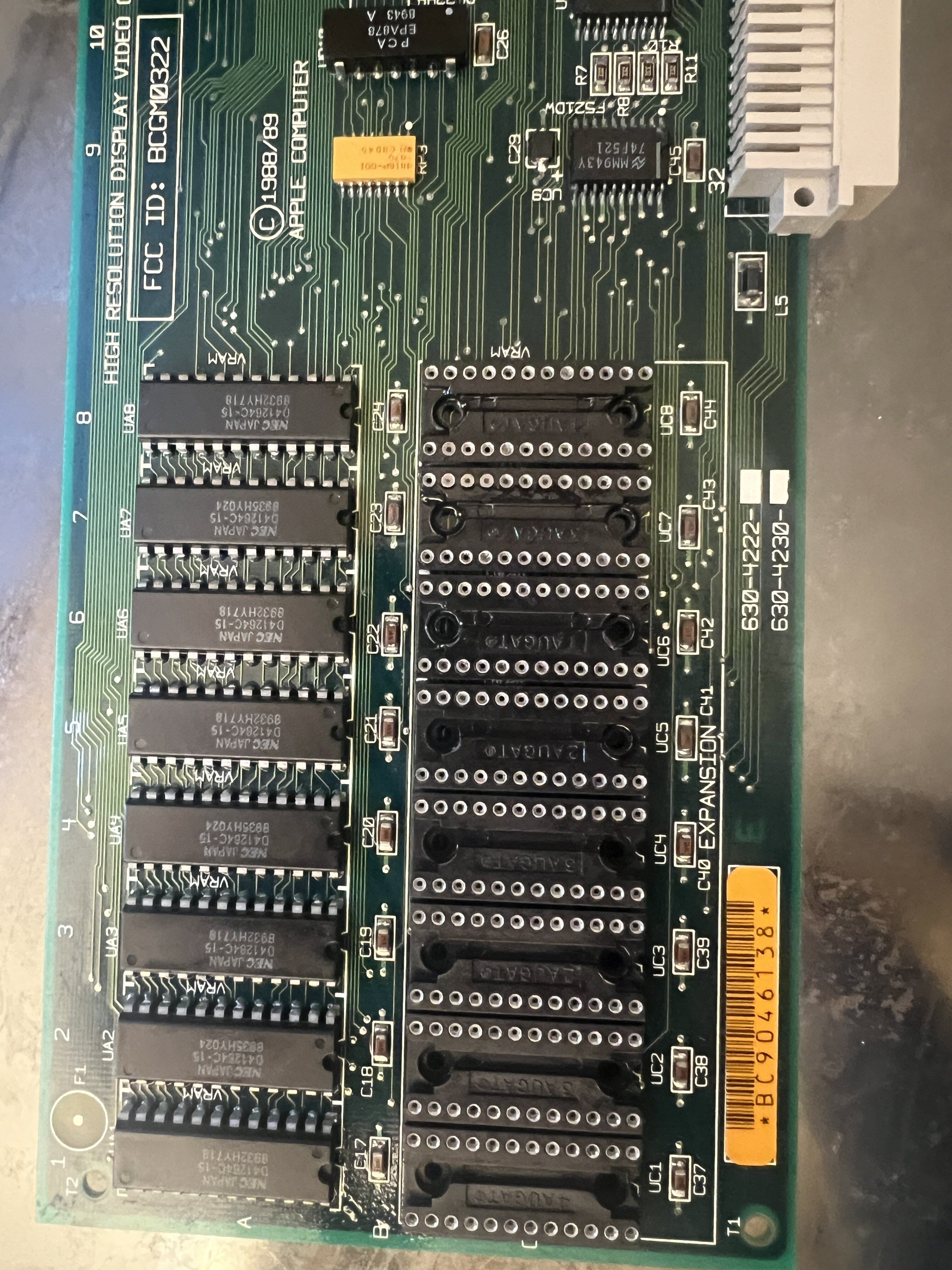

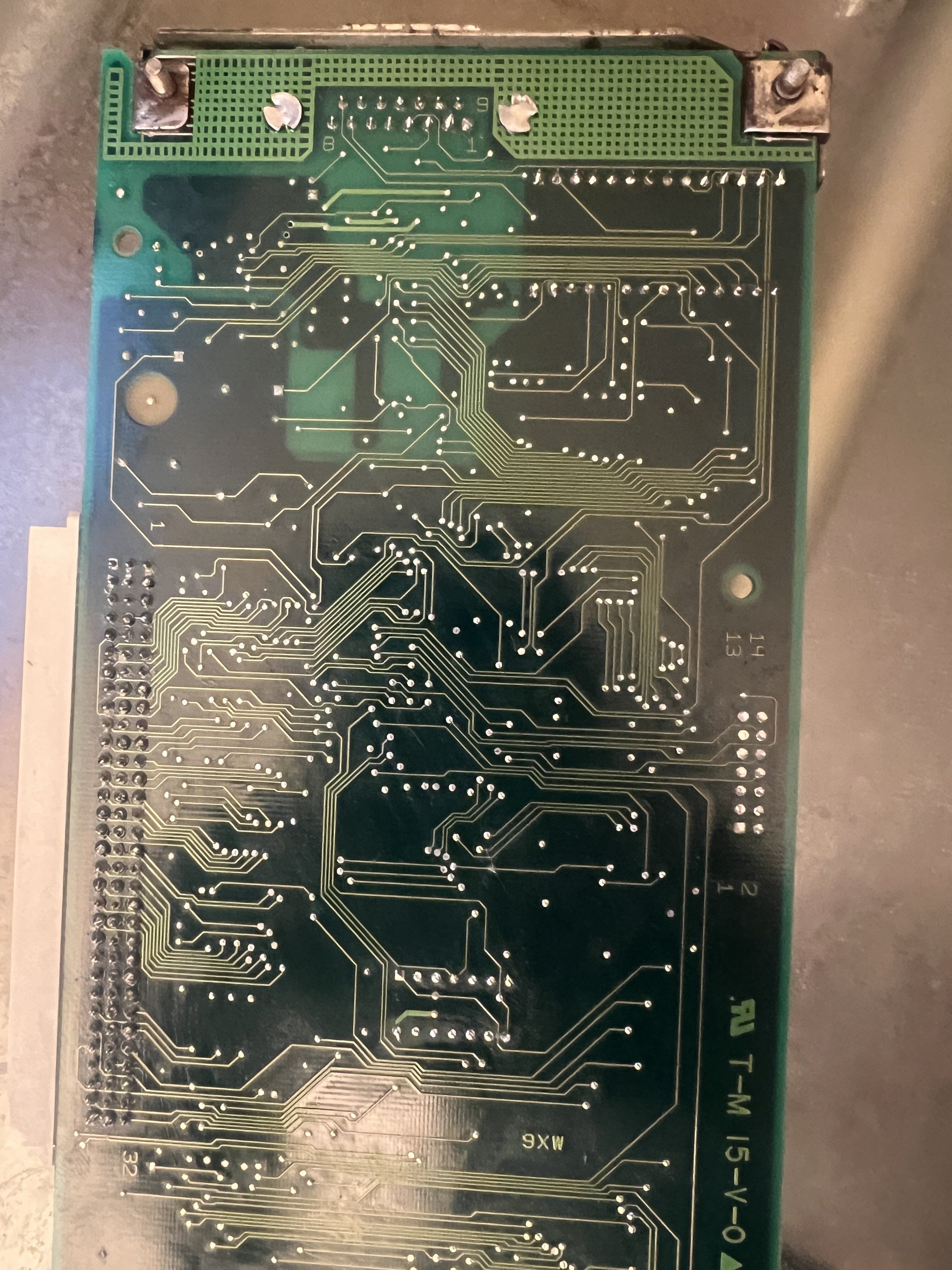

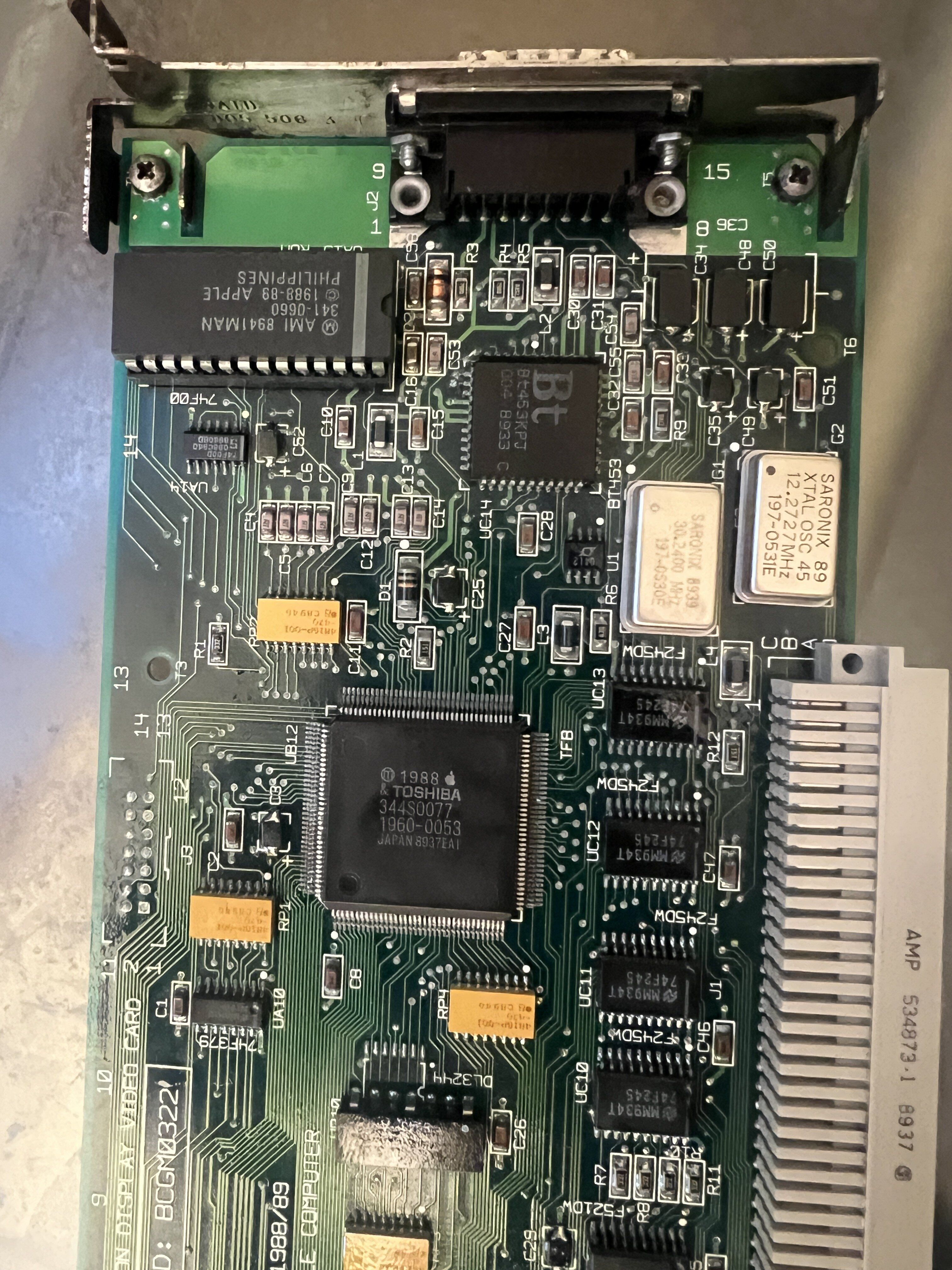

Has that video card been inspected after the capacitors were replaced? They leak in a terrible way and prevent proper functionality. You likely have a few broken traces which are preventing proper video output. Please post a picture of the card itself to help in diagnosing.
Reactions: Steve Rieck
Steve Rieck
Mar 24, 2023
Good point. it looks ok at a glance but I'll check it under the microscope. Will upload pictures this evening. Thanks.
Steve Rieck
Mar 24, 2023
not seeing anything obvious. At least for me.

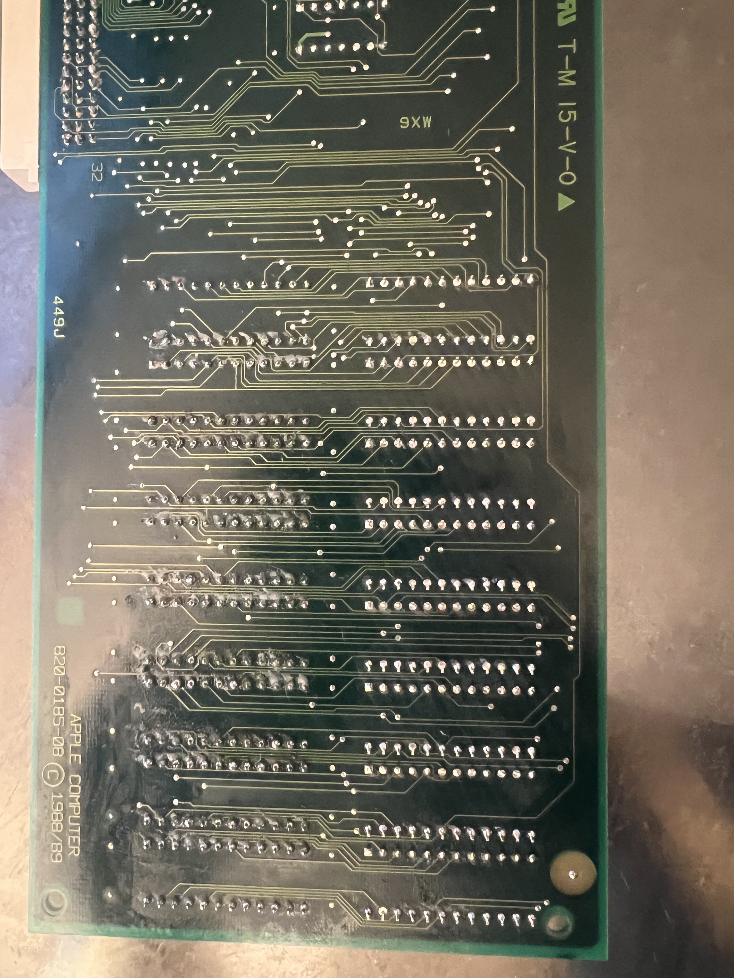

Seems like a lot of flux on the back of that board (namely the back of the sockets). Please clean with some IPA, as flux can be corrosive and attract dust/dirt/debris that could impact electrical signals.
