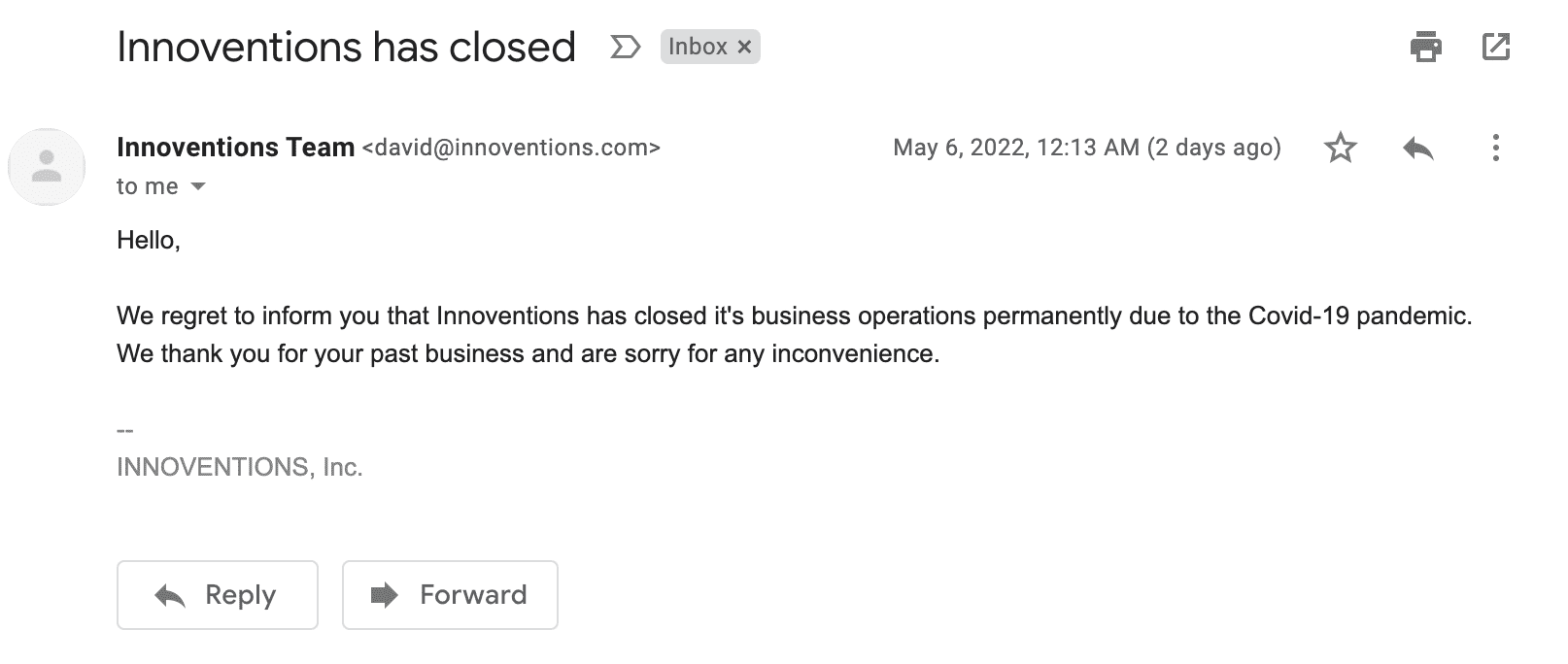

I've reached out to Innovations earlier this week to check the price of a memory tester for testing 30-pin Mac SIMMs. To my surprise, I got a reply that they've permanently closing due to COVID.
