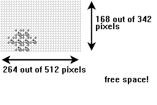

AFAIK the tile area is 11x7 tiles², each tile being 24x24. If you went pixel perfect, it'd only use 264x168 pixels of the 512x342 of the B&W screen real estate. If you go for doubled chunky pixels and/or highest res patterns where it mattered, you use 528x338, overflowing on the width and leaving only a piddly 6 pixels in height for all the interface.

Made a pixel perfect mock full screen test with the regular 24x24 tiles:
As you can see, there's way too much room, but not enough room that you can just pixel double your way to a solution. I'm wondering if they encountered this problem in other ports and went with 32x32 tiles (occupying 45% of the real estate instead of 22.5%)

The bottom would be enough room for the console/action text and you could make a slim stats gui for the right side, and you also have to consider 512X384, 640X480, and 800X600 (I know the actual resolution of that last one is slightly bigger) for later 68k macs
