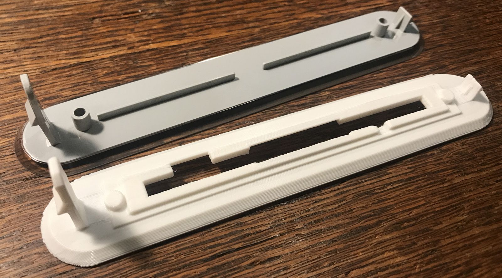

Those don't look like USB floppy drives, those look like standard half-hight internal drives. As I said before, there is no controller/adapter for these types of drives. I was under the assumption you would use your USB floppy in the drive bay and connect to the internal USB port on your PCI card.

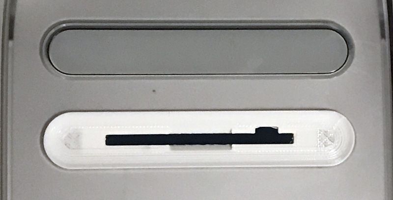

First try on the faceplate, test print in white, will make the final in Gray.
MacManiac
Sep 24, 2024
24
6
Oh so you meant USB drives. I found AliExpress an adapter for a standard ide drive to USB maybe I can buy one of those. Do you have the file for the floppy drive door?
427
370

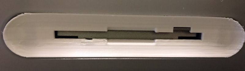

Here is my 3D bezel for a USB-floppy. STL files linked here
I am not sure if a standard 3.5 floppy will fit in the small hole available with the eject button being so far from the slot. Remove the blank bezel and see how narrow the slot is.

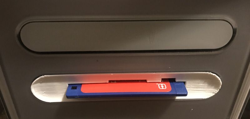

Here is the USB faceplate snapped in, with disk. Drive mounts are currently printing to bring the drive forwards 0.225 inches. I have some issues with filament and stinging... but going down the road 60mph you will never see that.

427
370

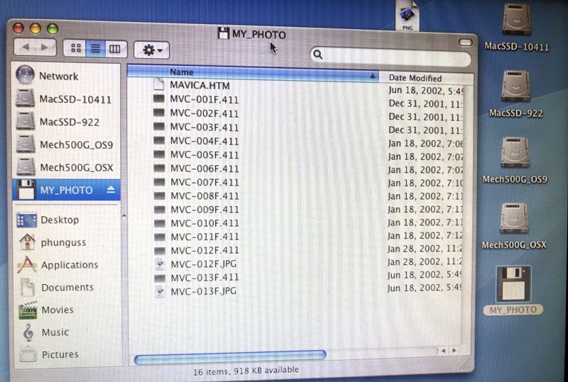

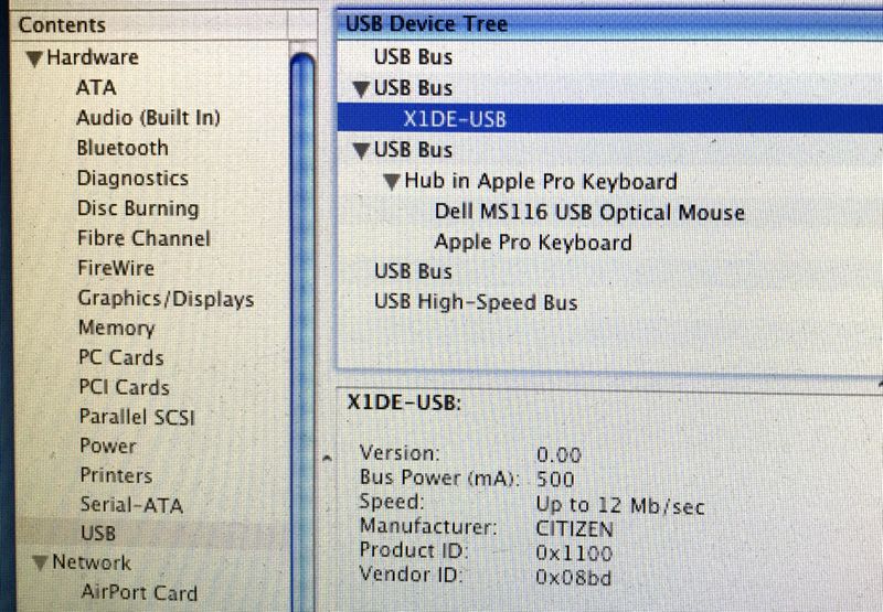

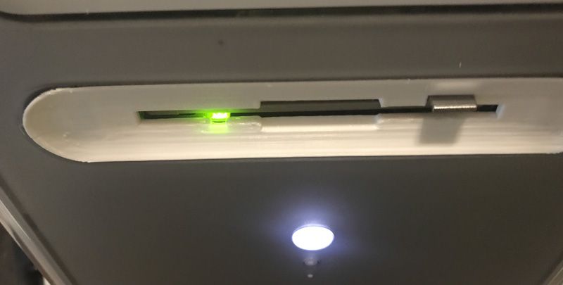

Works on OSX, not on OS9. Tried both versions of USB floppy drives I have, neither works on os9. But, success for mounting a 3.5 floppy 1.44MB internal on a QuickSilver machine!!!
No floppy in drive:
Floppy reading:
From my Mavica Floppy camera 1.44MB disk:
In OSX 10.4.11
