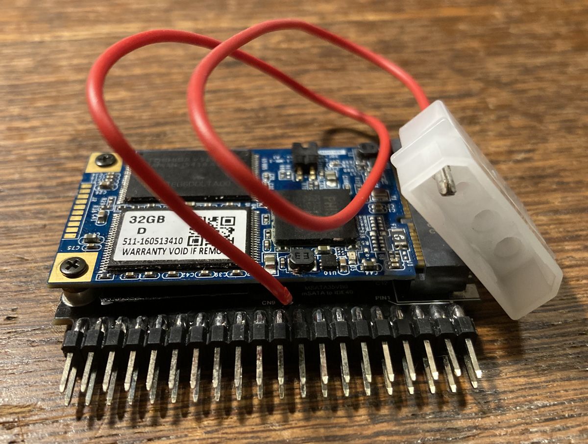

Well, you inspired me to pull out my MDD and work on it. I did have a SSD in there that failed so was wasting too much time sticking random HDD solutions in there seeing what failures I could create lol. Besides finding another one of my Apple 40gb drives in my junk box kicked the bucket, I found this little pata/sata gem. I picked this thing up about a year or so ago for $3 shipped from PRC off eBay. Knowing how picky PPC Macs are with these, I had zero expectation of this funky thing working but lo and behold, I fired up an old PMG5 sata Leopard spinner I had without issue with it.
Here’s the auction for those interested.
Reactions: ak-78 and phunguss
Very nice! That'll work indeed. I ended up sticking a 128GB mSATA SSD with one of the red StarTech PATA adapters into mine and that seems to be working well. Cheers to happy MDDs!

That Red China Board was documented in our B&W G3 discussion as one of the only reliable ones I found.

My 867Mhz MDD was purchased from Free Geek Minneapolis for a few bucks as a project because it did not power on. I tried the PSU cable mod with a standard, and I get power, but nothing more... it was set aside. Today at Free Geek there was a Dual 1.25GHz with 2GB ram for just over a Ben Franklin, so I brought it home. I received this 3.5" IDE to mSATA adapter from China for $9 and will try it in the MDD tomorrow. If it works, I may try it in the Cube as well, since there are multiple adapters in that beast and the power plug is upside down. This one comes on a cable, so you can orient it any way you like.
I have another otherwise functioning single 1.42ghz MDD that needs a capacitor to be replaced that was knocked off w/ one lifted pad. It also needs a recap on the psu. It might be a cool ATX psu conversion but I’d rather recap it first and if that failed, then wire up a harness and proceed to the conversion. Anyways, too many projects and not enough time lol 😂
