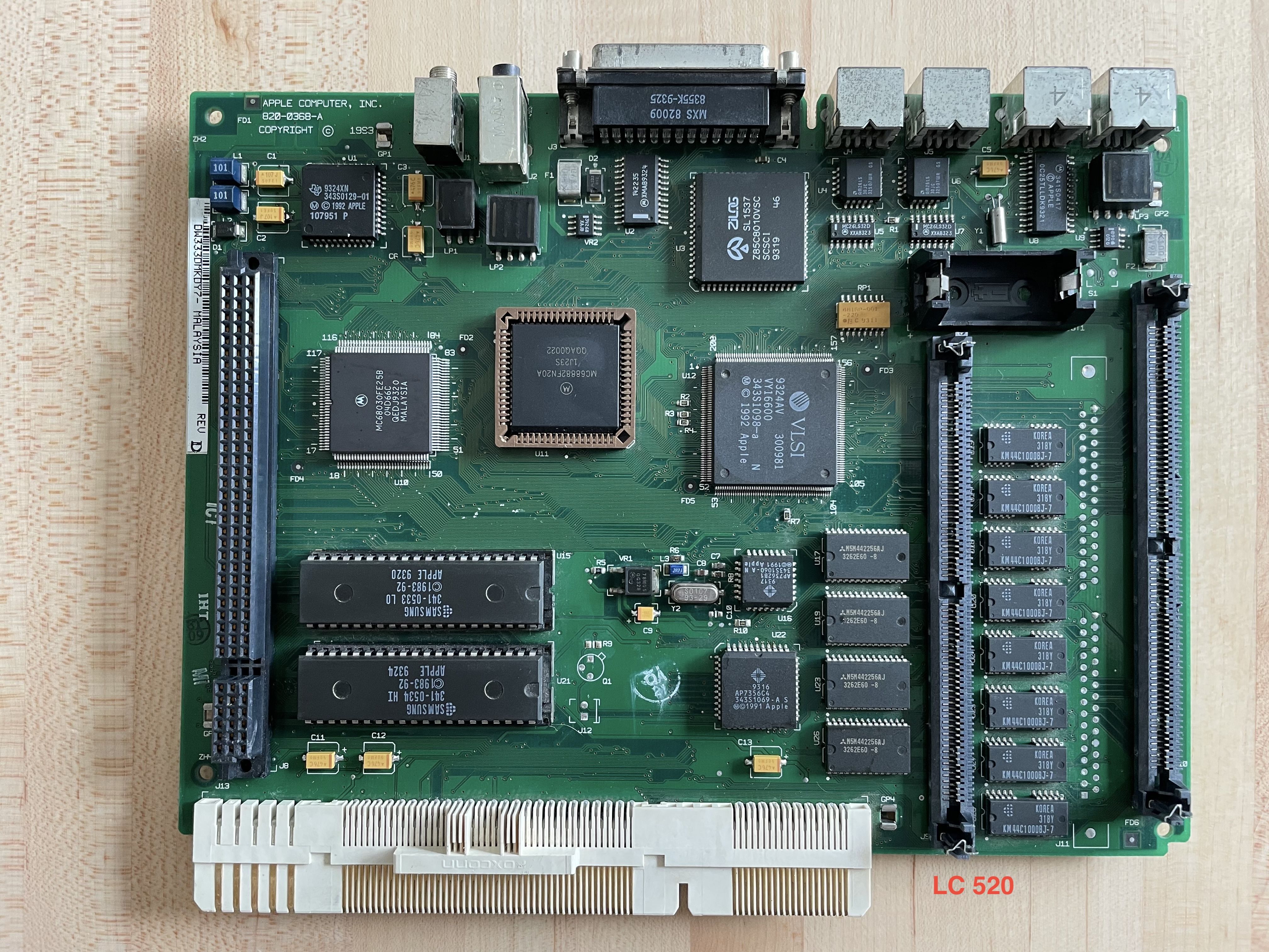

In regards to the LC520 (68030 @25mhz) it can often be overlooked in favor of the LC575 (68040 @33mhz).
For those unaware these motherboards are a convenient direct swap-in replacement for the sluggish Color Classic motherboard (68030 @16mhz).
*While I am not in favor of cabalistic practices, I do happen to have the models mentioned above and will swap them for fun.*
The following is a simple, quick and easily reversible mod to bump the LC520 from 25mhz to 33mhz (likely what should have been done in factory) but we won't get into Apples intentional sand bagging of systems.

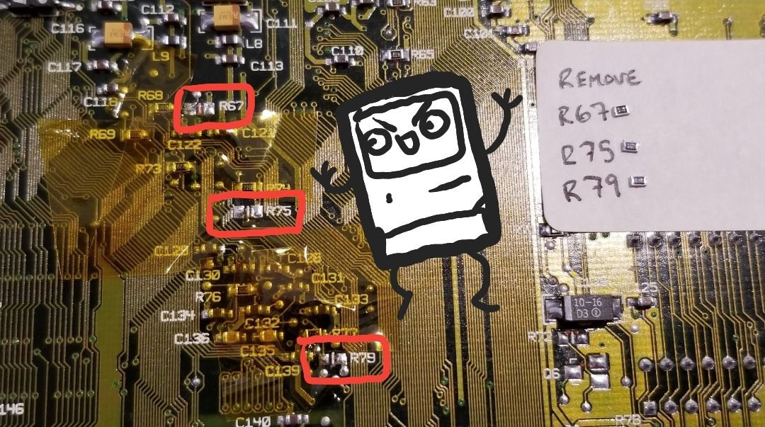

The above resistors are all that stand in the way from unleashing your blazingly fast 33mhz!
simply remove R67, R75, R79.
Once completed your LC520 board may have an identity crisis and wish to be addressed as a "Color Classic II" with a 33mhz 68030!
Congratulations Speed Racer, you're at the front of the pack now!

No ill effects on serial port communication after those resistors are removed?
Amazing info, @Drake!
Nope! If we look at the actual performa 275 (Color Classic 2) these resistors aren't installed from factory. Further evidence that the LC520 was just the Color Classic 2's big slow brother!

I'm quite curious as to what the removal of those 3 resistors is doing in the circuit. Do you have a schematic?

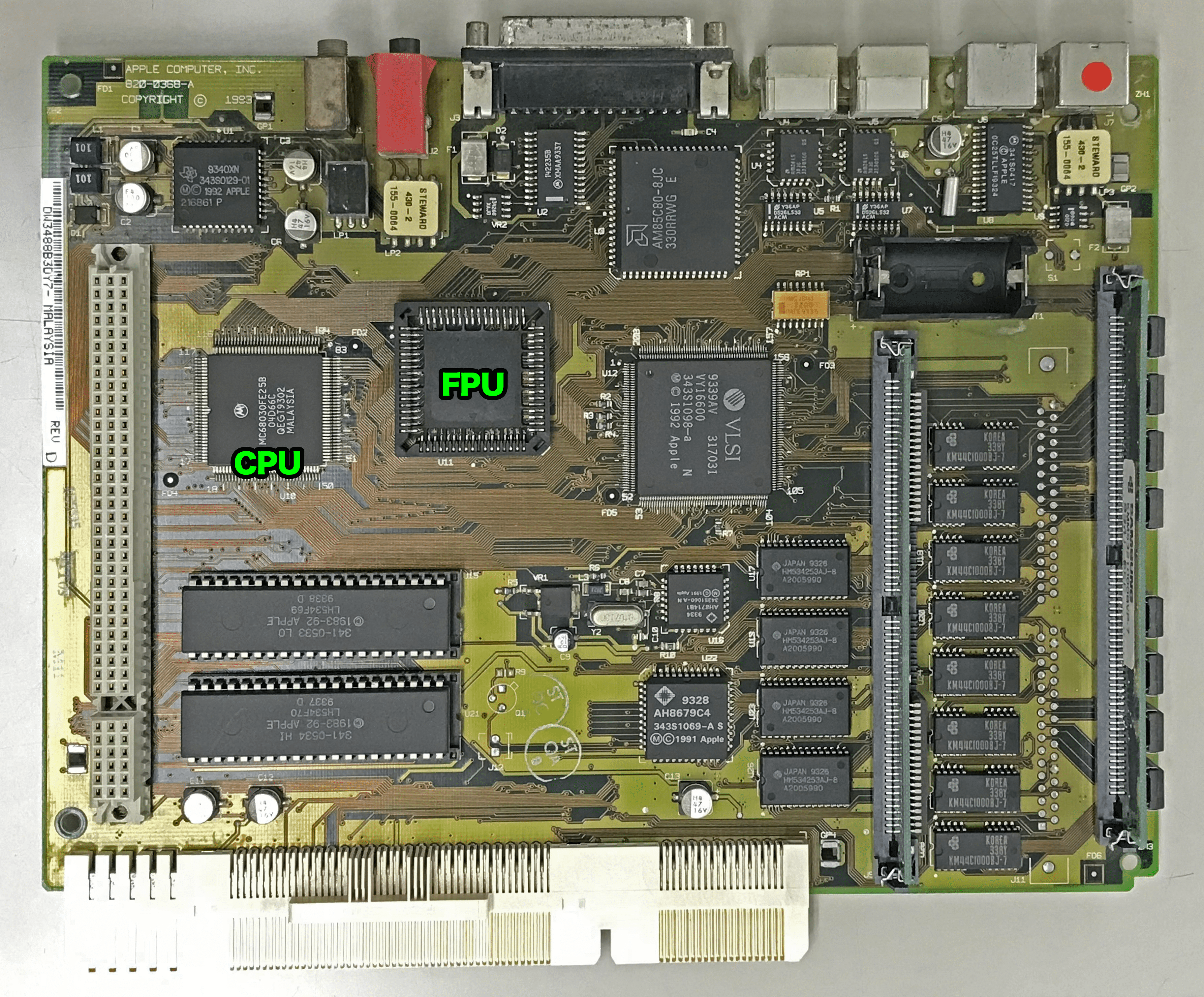

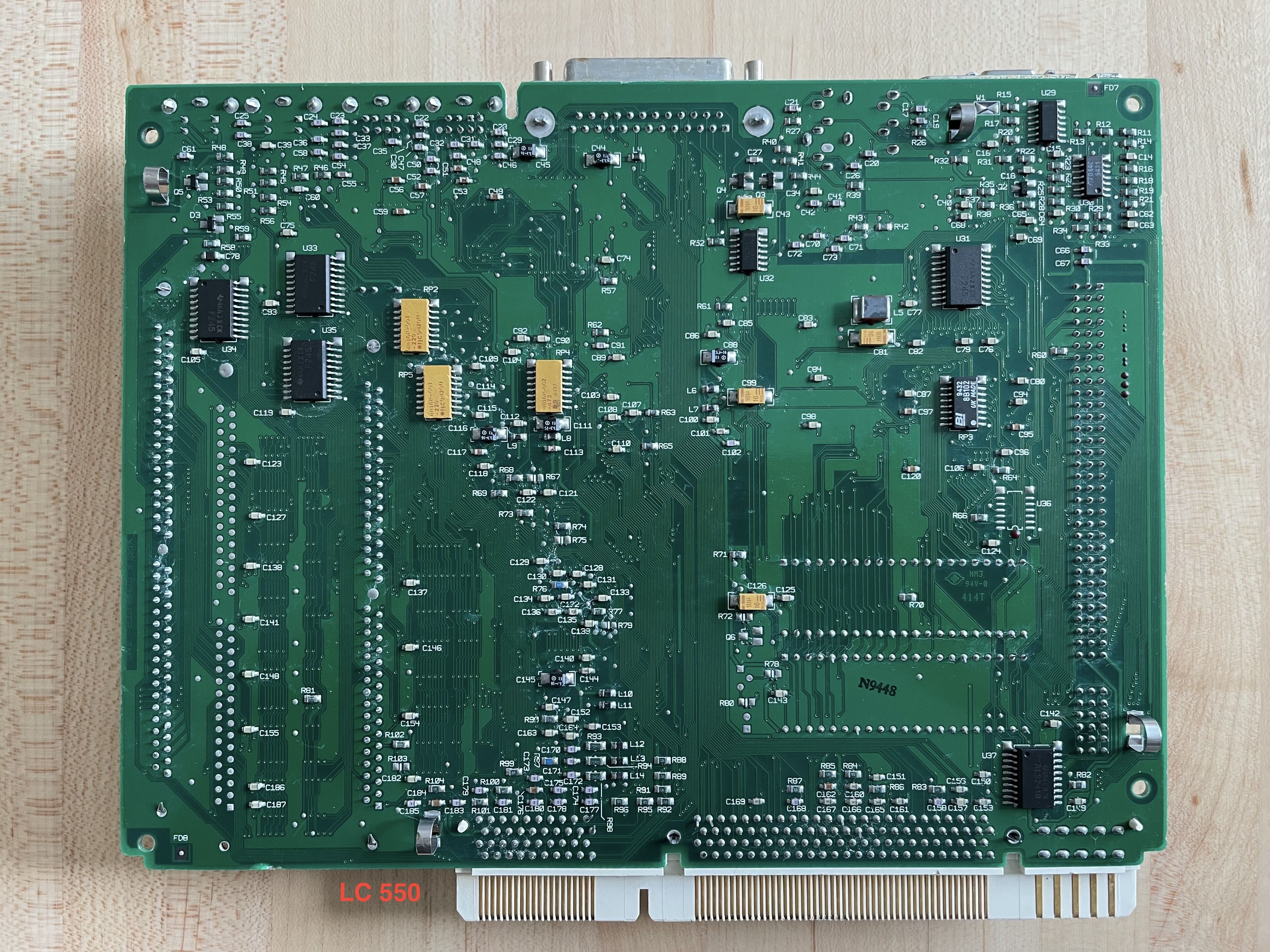

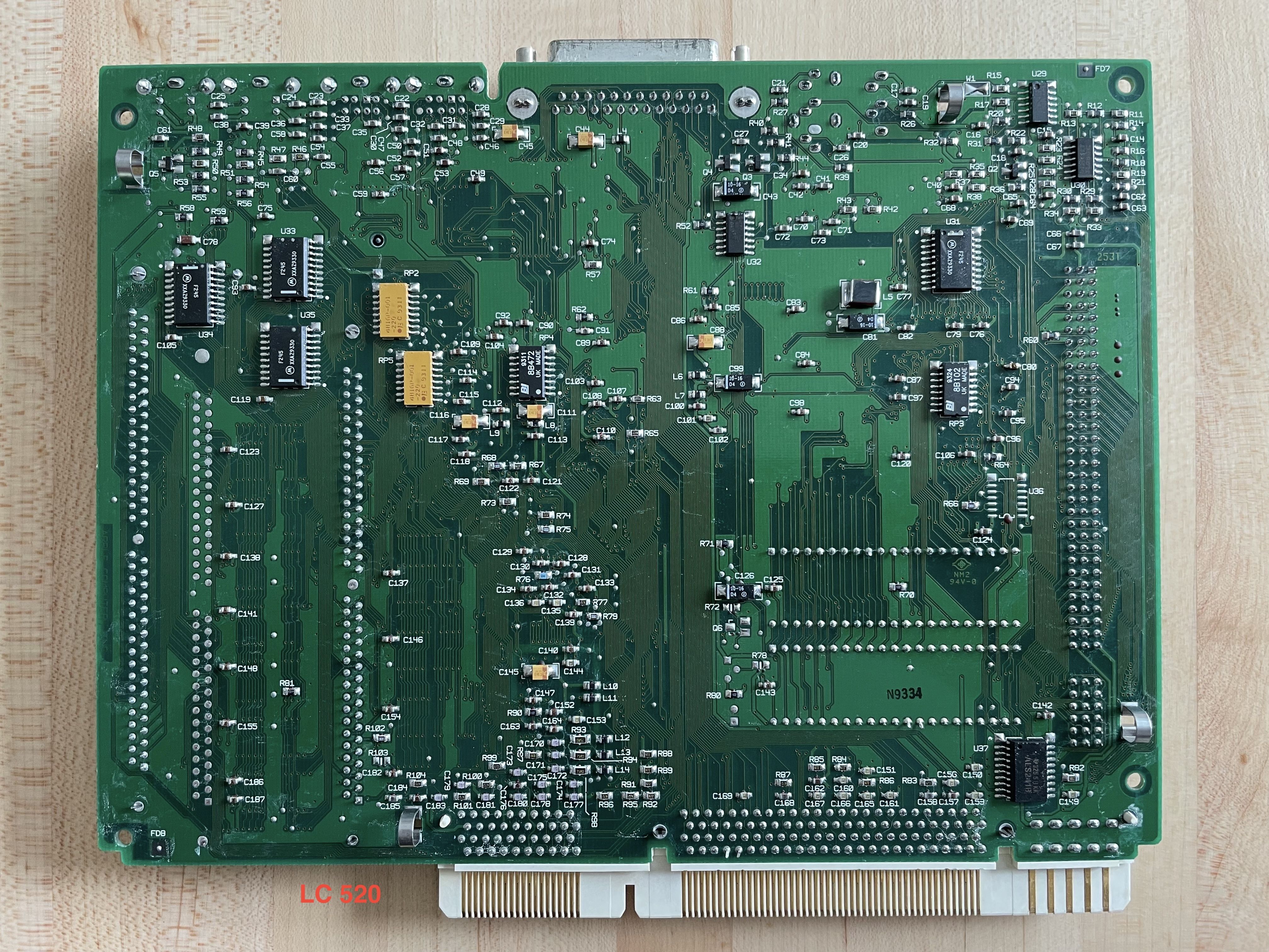

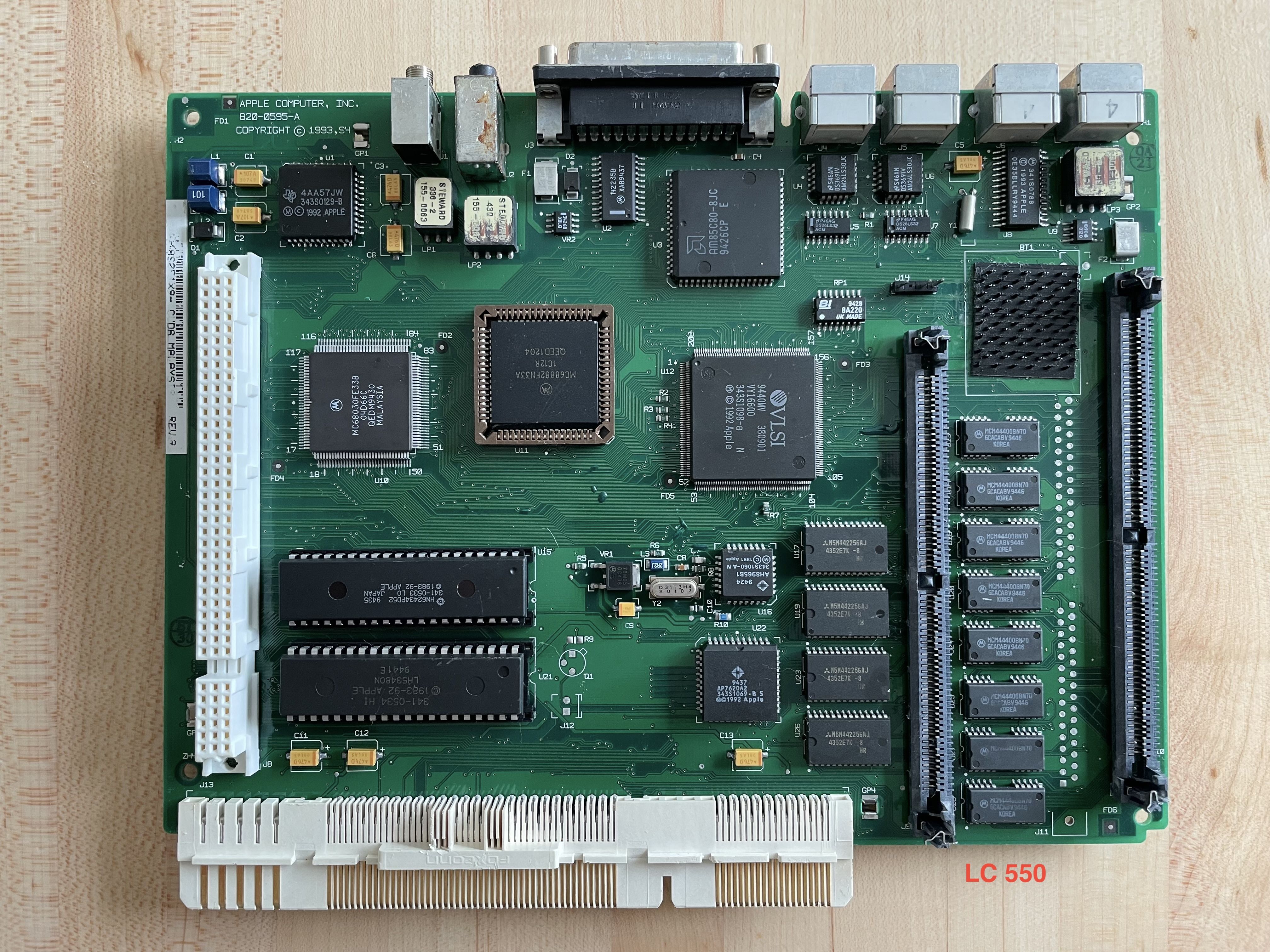

Awesome, I had been thinking about whether this might be possible after noticing how similar (seemingly identical) the LC520 (25MHz) logic board is to the LC 550 (33Mhz) and Color Classic II (33Mhz) logic boards (which seem identical themselves except built in VRAM?).
The similarity reminded be of the LC III (25MHz) and LC III+ (33MHz) boards where you just need to move a resistor to turn a III into a III+ and the base LC520/LCIII architectures appear closely related looking at the apple dev notes.
I got a LC520 board in a trade a while back and while it works in the Color Classic (I call it a Color Classic+ :) I definitely will try this out!

That would be nice, unfortunately you are correct, the Color Classic board's base architecture is from the LC/LC II. The LC III architecture used in the LC 520/550 and CC II, is quite different/improved (32 bit bus, 72-pin SIMM RAM with no 10MB limit, etc.).
One thing that the LC520/550 (and 575 and up) boards have over the LCIII is support for stereo sound, I'm pretty sure I saw a mod for the Color Classic analog board where you can "fill-in" missing components and add second internal speaker to get a Stereo Color Classic!

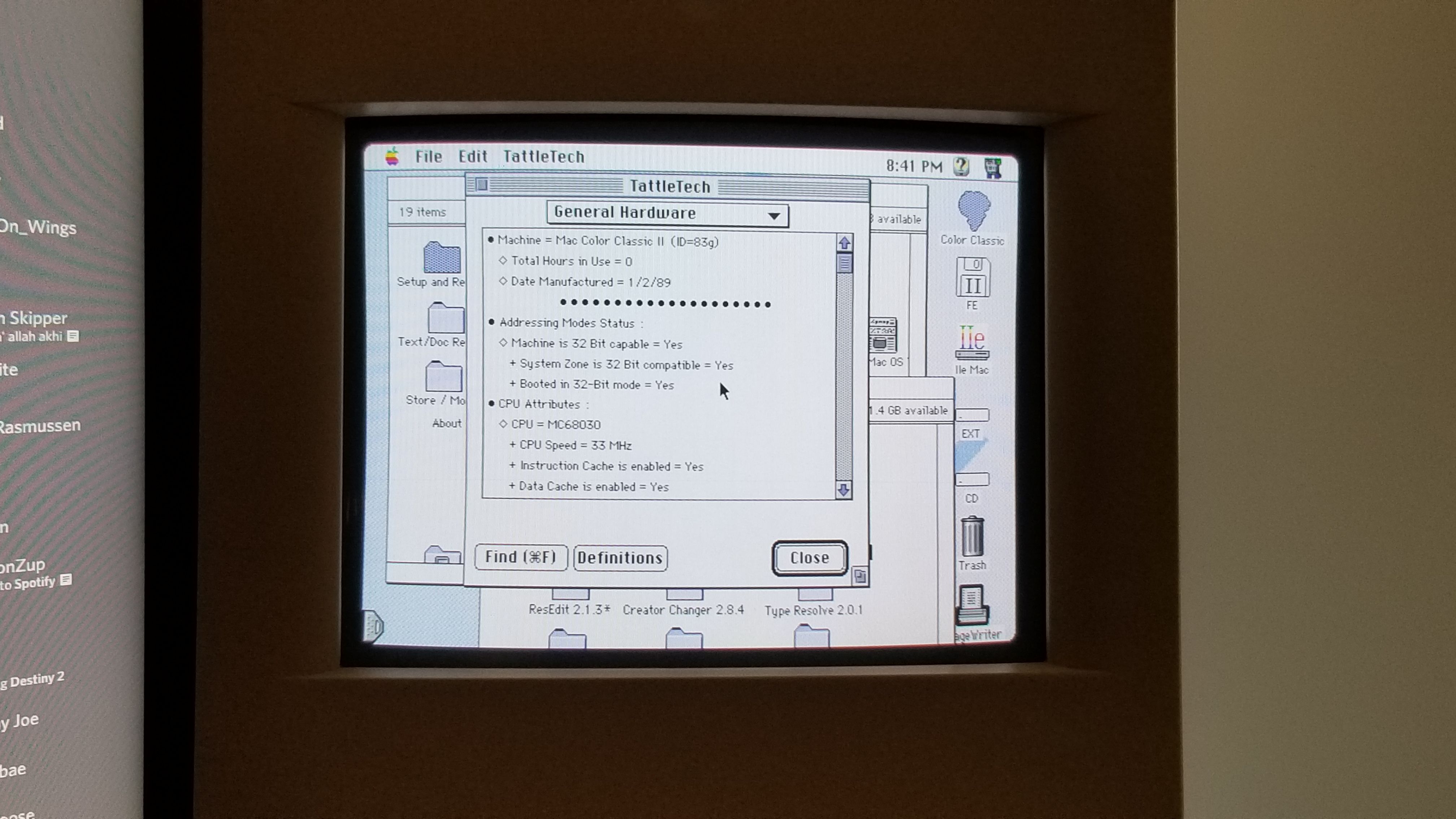

Actually, the Stereo Mod is on the agenda for my Color Classic video series, and I've already acquired the second speaker. But I intend to do the 640x480 and overclocking videos first. Stay tuned! :)
