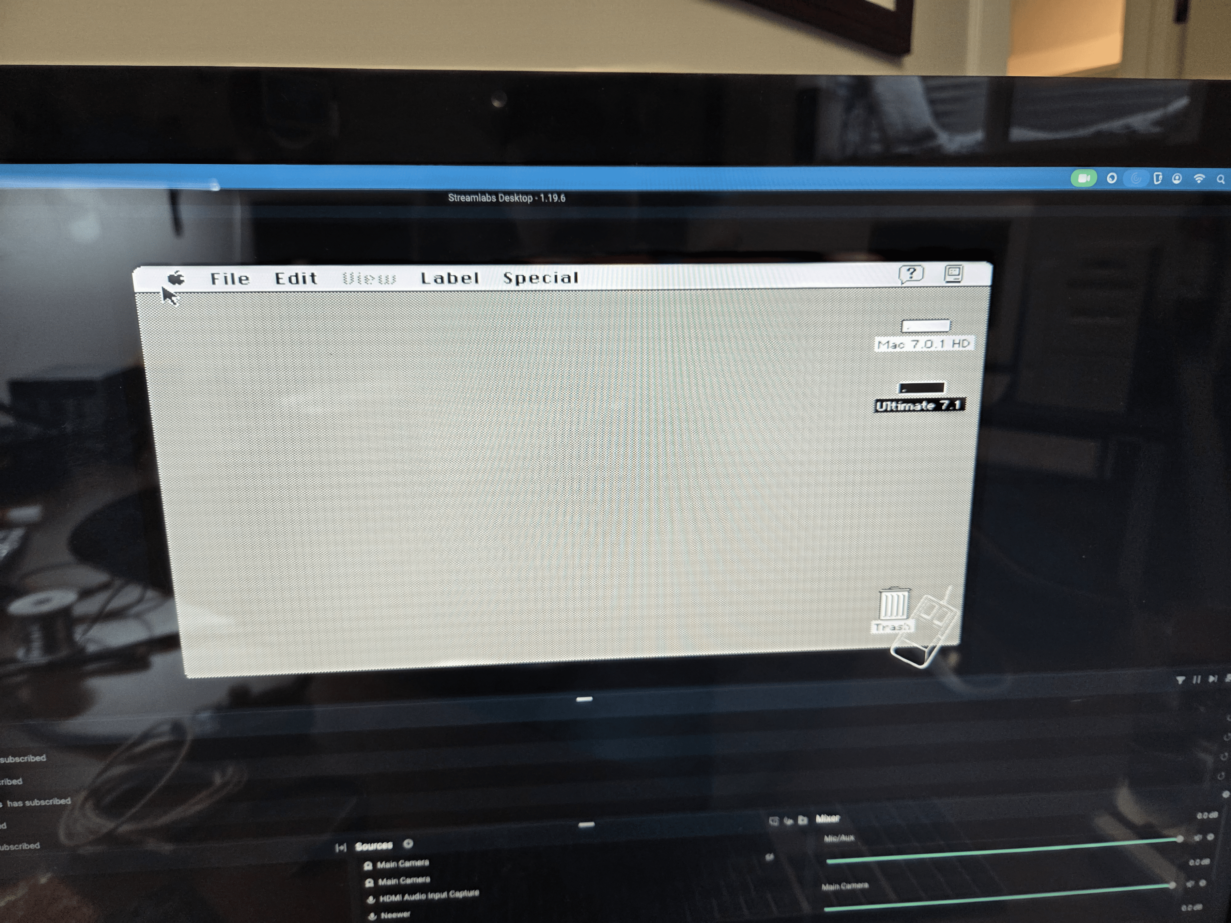

Finally have some free time again and figured out what was happening!
Turns out that when I was trying to program the ATF16V8BQL there was an option to Encrypt that was checked on. When I read about the purpose of this check box it came back as
By checking this box the programmer automatically blows the security bit after programming the JEDEC file thus:
  • The chip can never be read back again
  • Any read/verify operation returns all 0s (by design — that’s the whole point of the security feature)
  • The only way to use the chip again is to fully erase it (which also clears the security bit)
So yeah soon as I found that out I turned the stupid check box off and I was able to verify that the chip was successfully programmed :)
SE30 booted right up soon as I put the freshly programmed chip on
