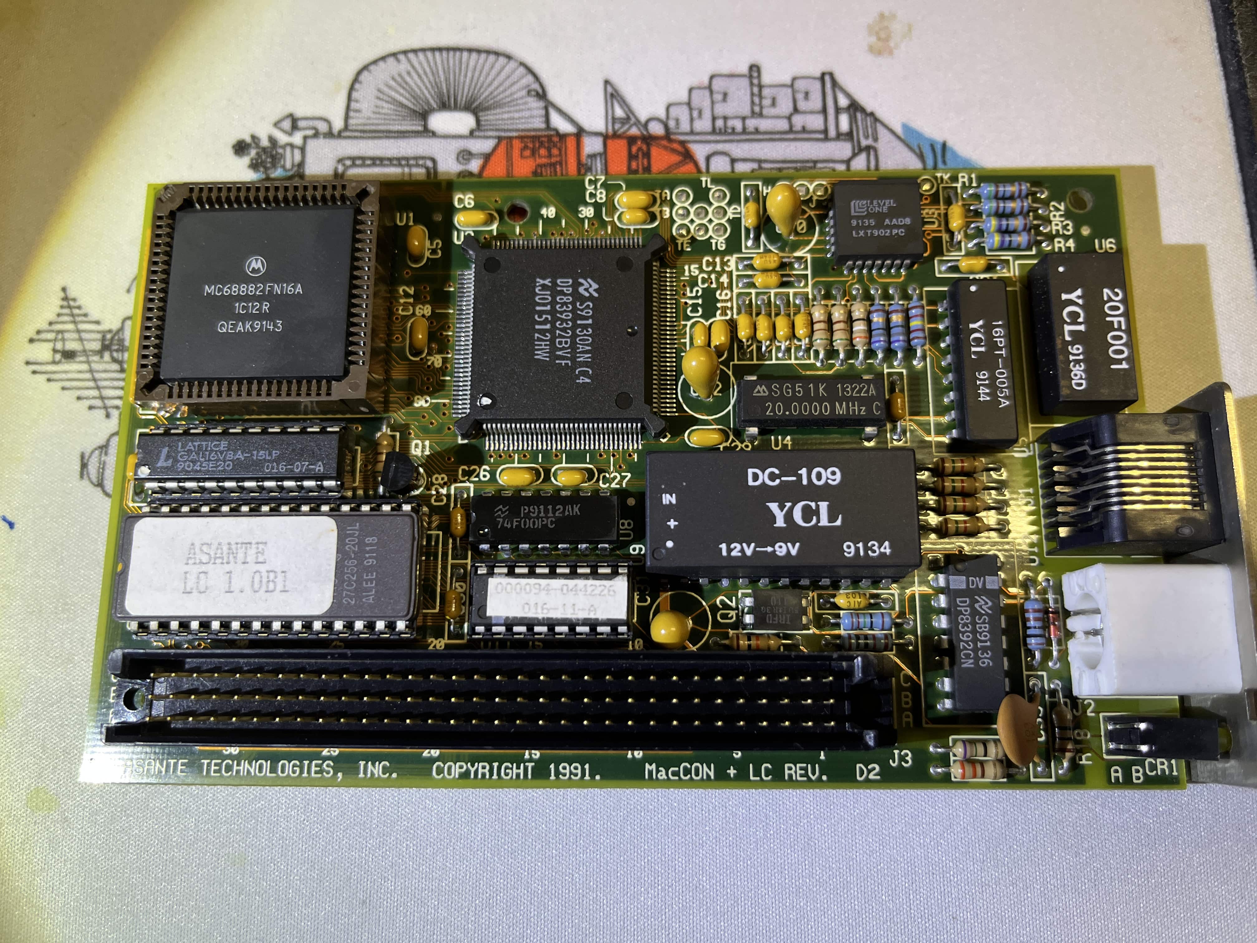

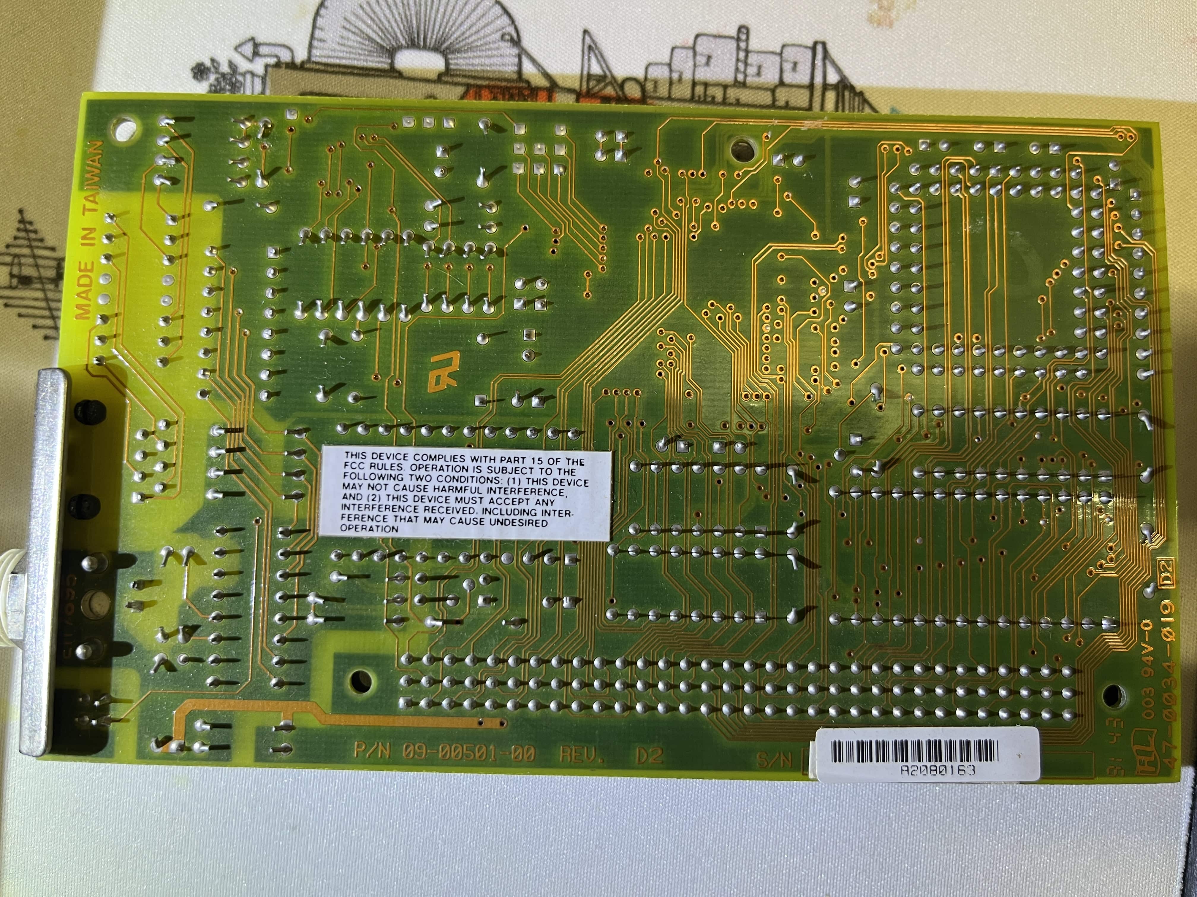

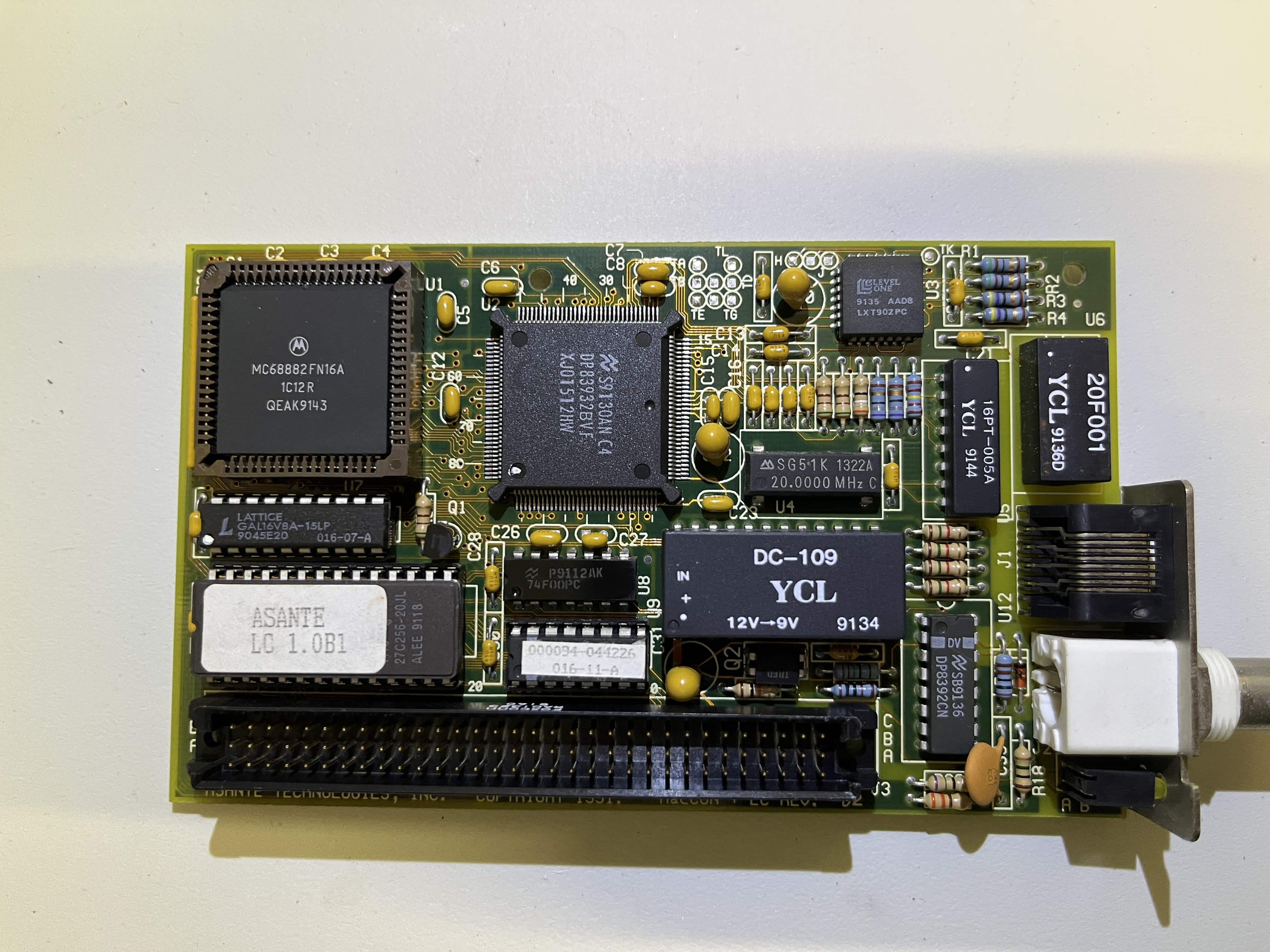

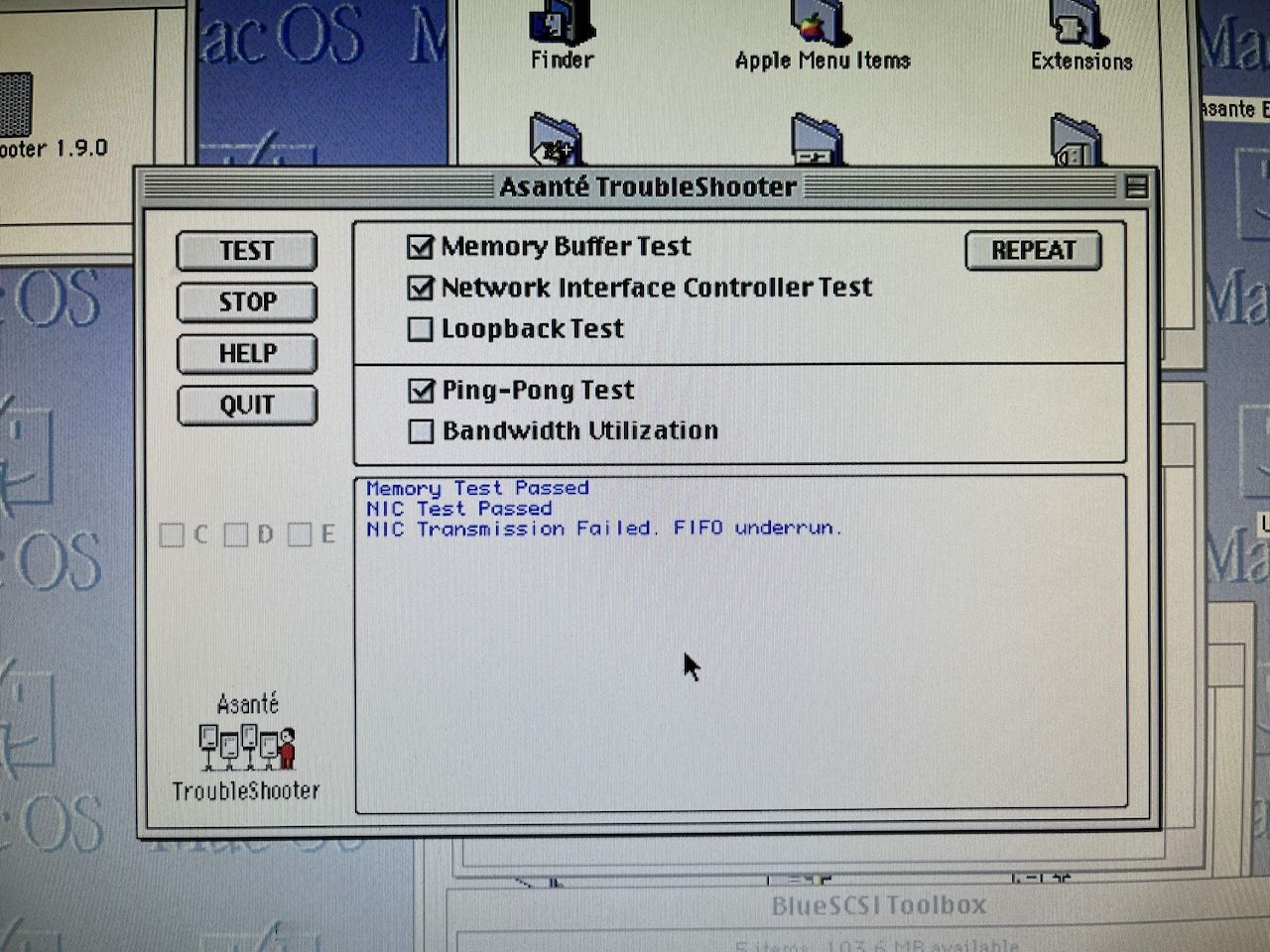

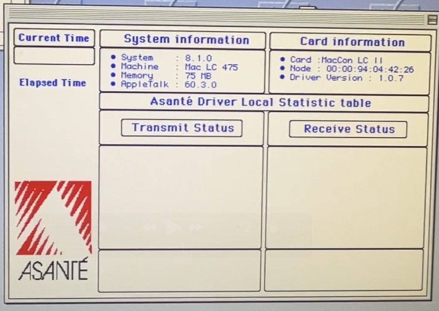

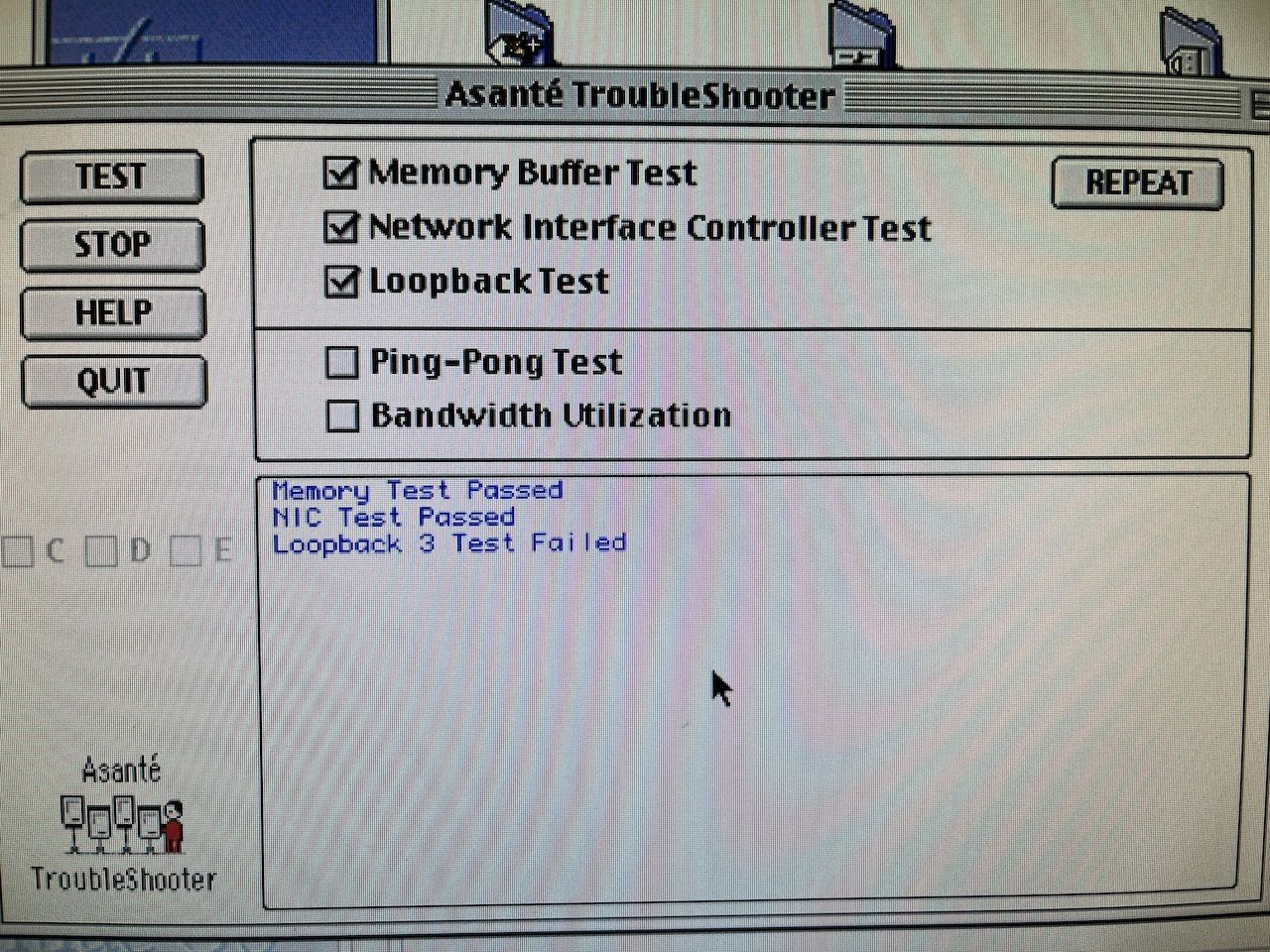

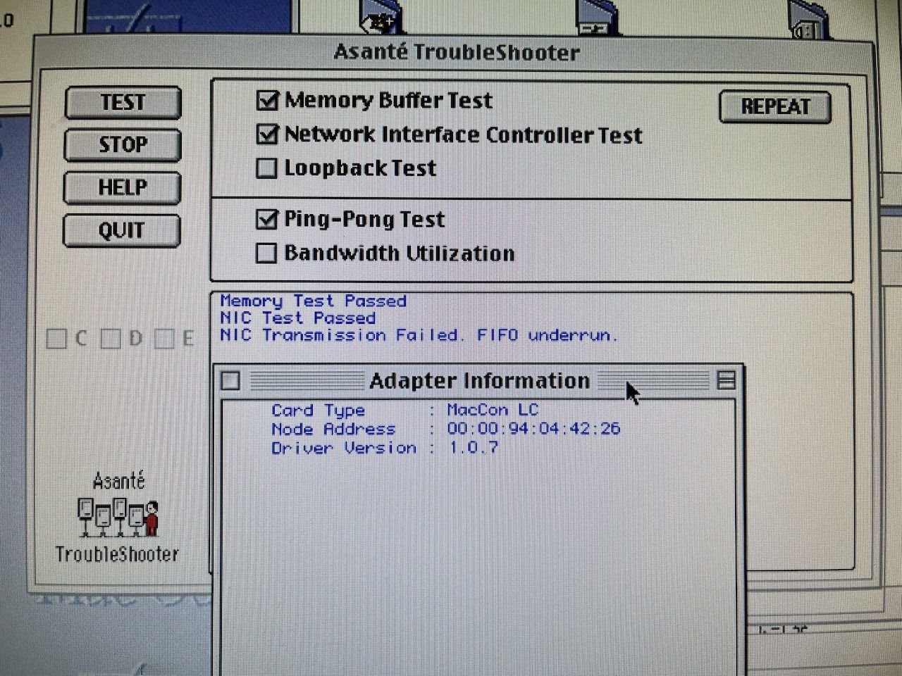

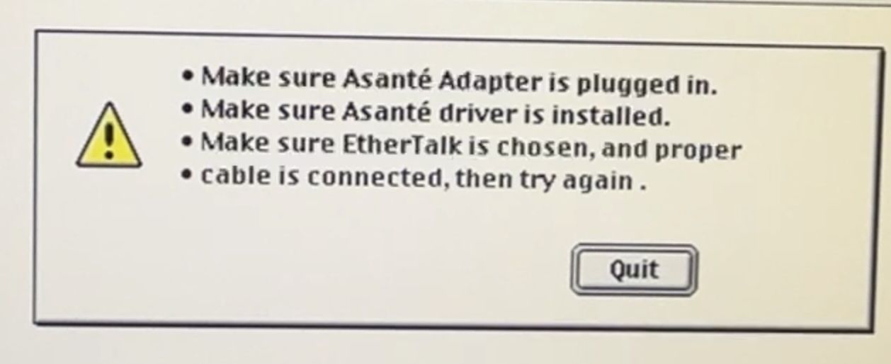

Hello everyone, first time poster here.
I am looking for help in getting an Asante MacCON+ LC NIC to work with my LC475.
I have connected through an RJ45 cable and tried a 10/100 Switch assuming that the link negotiation would be an issue. I don't know if it is.
Only the green LED comes on. I am running System 8.1. The adapter is detected. Some of the diagnostics pass, others fail. Assigning static & DHCP IP address does not work.
Here are some screenshots and photos of the adapter in question.
Has anyone experienced anything like this before? Is there any hope in recovering?
The model name is : Asante MacCON+ LC rev. D (09-00501-00 rev. D)
Thank you
Michael

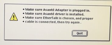

Hi Fizzbinn, no worries, I’m learning as I go. I think I did this but I just checked again on a new install of System 7.6. Those are good suggestions.
TCP/IP set to Ethernet with a static IP
AppleTalk gives me “An error occurred attempting to use Ethernet.
Make sure your network connections are correct.”
any more ideas?

Bumping this to share an update that I have tried with an old Ethernet 10Base-T hub and I was still not able to get it to work.
My next step is to attempt in reflashing the EPROM. I have not yet tried to run the card without the EPROM and see if the same error persists. I will try that.
In the meantime I wanted to ask if anybody else has the same card and has attempted in dumping the EPROM.
