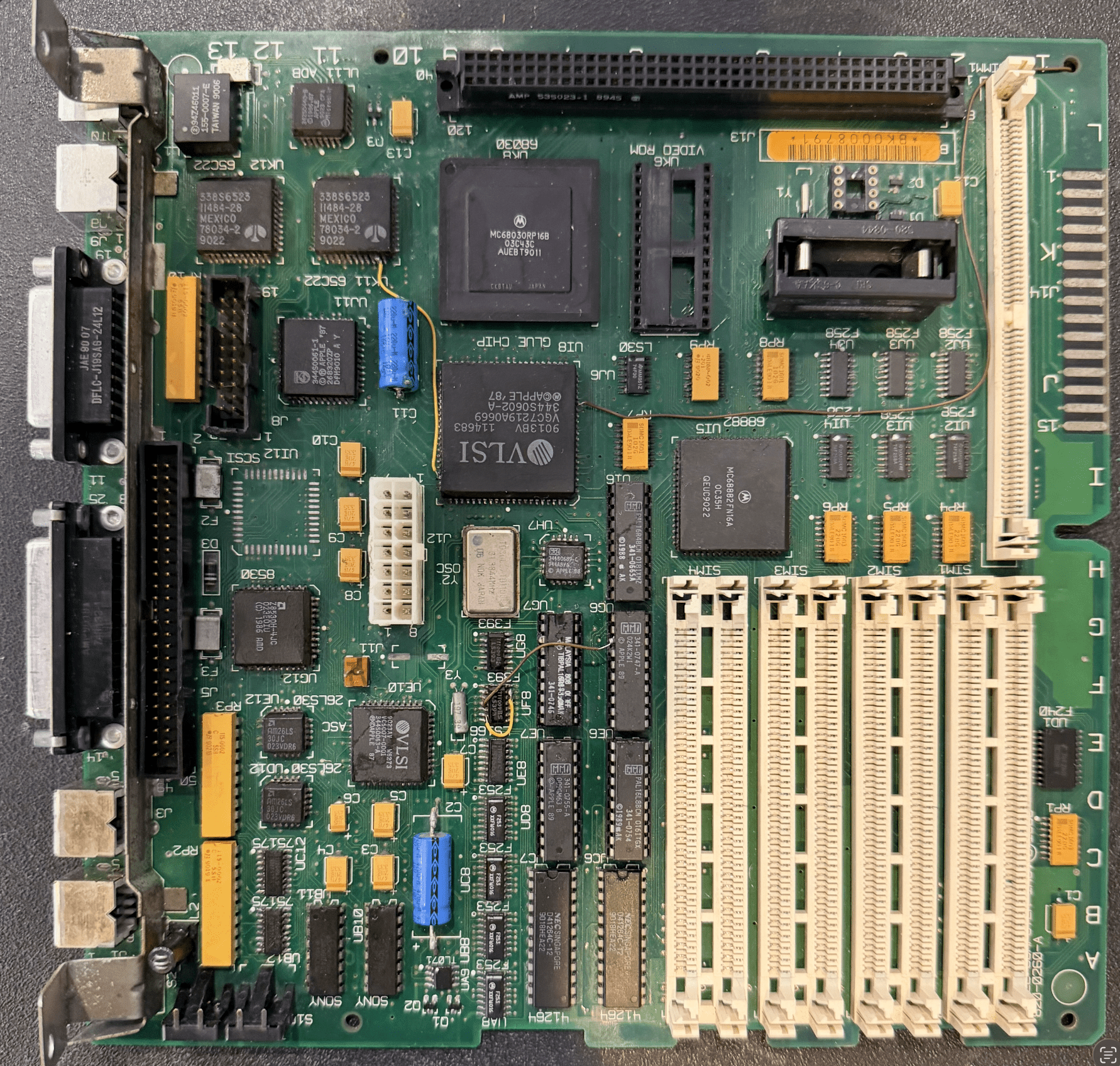

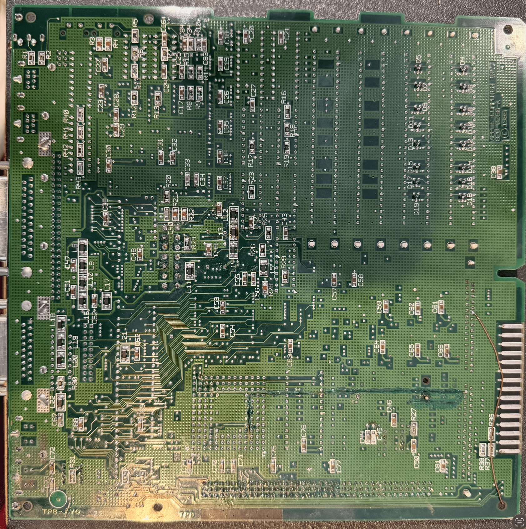

I'm attaching photos of the board in case there's anything glaringly obvious that I have missed. Unfortunately, it's a mix of my own work and the work of the previous owner, which further complicates things, and it's tough to clearly capture much in the photos. Obviously I am aware of the missing chips, all my testing and probing so far was done with them installed :)

That board looks repairable - to me, I would remove the battery holder though and look under there, if there was a leak and damage.
The secret to getting rid of bridged pins, imo, is good flux, it makes the solder cling to the legs/pads and not bridge as badly.

Also, checking under the battery holder was a good call, it is a bit of a mess down there. It seems like the necessary bodges there were done already but I'll have to take some more time going through that (photo attached).

Sounds like a good idea to send the worst SE/30 board out to be Reloaded and do the work yourself on the board shown above, I think that one is repairable, especially after seeing what's under the battery holder.
If the CPU was never removed from the board, there shouldn't be anything under there to bridge the pins; some leaked electrolyte can be flushed out from under there if that's necessary.

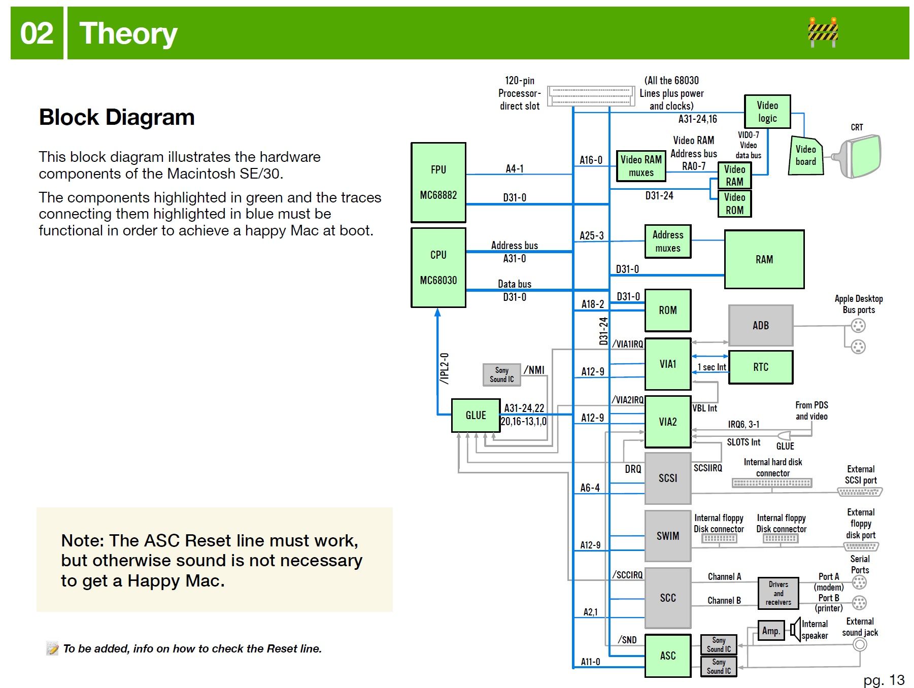

This page in the Simasima Repair Guide lists the bare minimum chips that are necessary to boot, in the Green Boxes:
The attached SE/30 Redrawn Schematics were absolutely crucial to me in this repair process, you probably already have them but incluided them in case anyone else find their way here and needs them also.

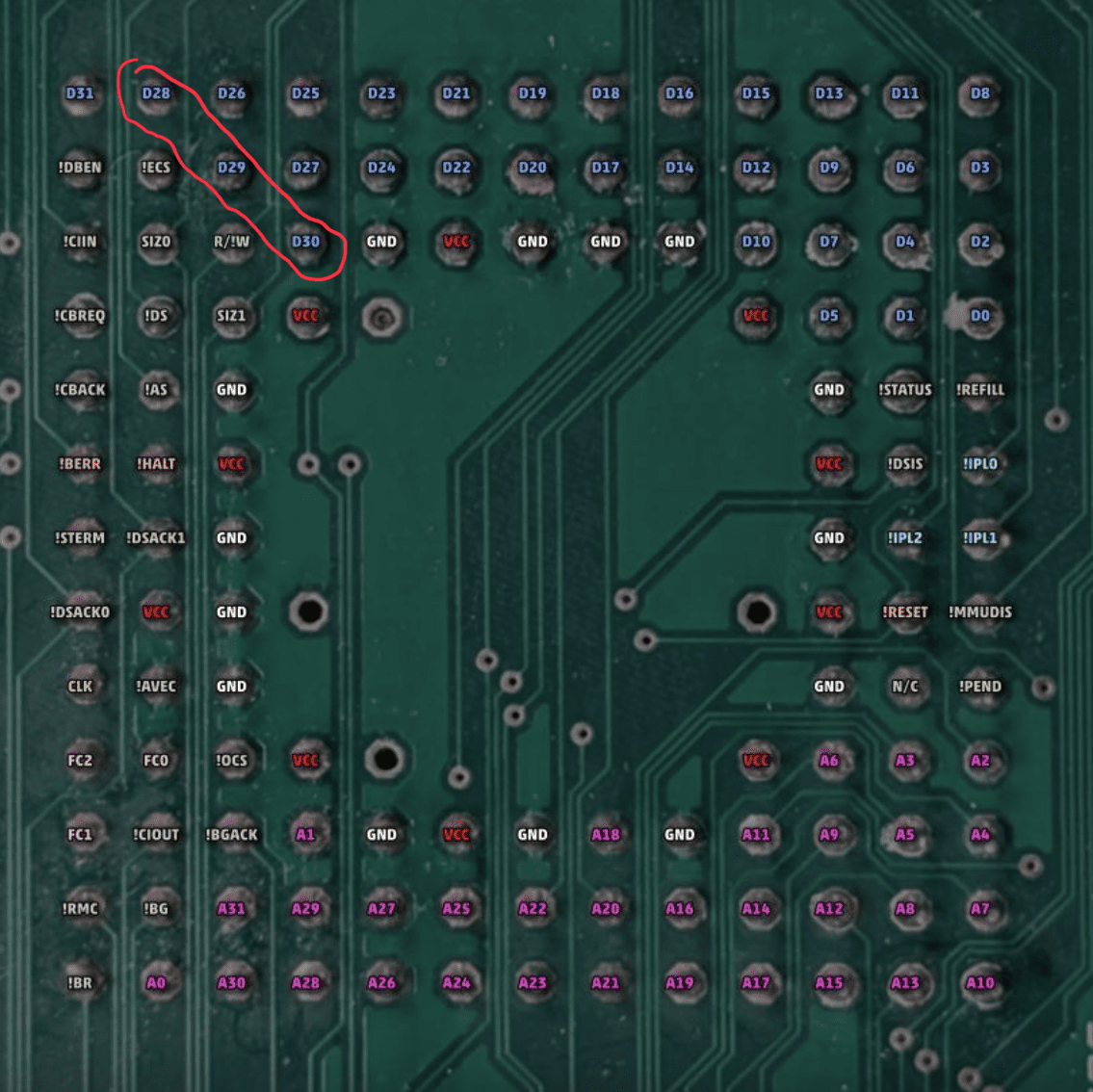

The short is reading close to 0 ohms between the pins for data lines 28, 29 and 30 at the CPU (interestingly all in a line in the diagram attached), which is why I suspected it was around here. It reads closer to 0.8 ohms at UG12 where I originally noticed the short. I tried flushing out under the CPU using some alcohol, as well as scrubbing with a brush under there but that didn't help at all. I also removed UG12 again to make sure that had nothing to do with it, since it seems it's not necessary to boot the machine, but that had no effect.

Could it be possible that the short is not actually at the CPU, but somewhere else that D28, 29 and 30 meet?
The Data Pin Matrix lists a few places where those Data lines are closely located to each other on the legs of chips, might be worth checking in these locations for a bridge, or errant blob of solder:
