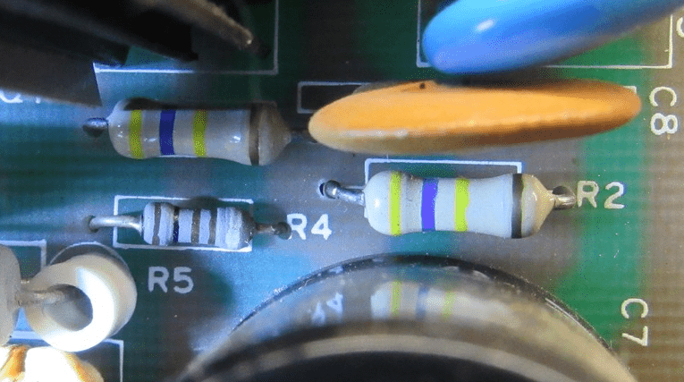

Hi @Elemenoh, just got myself a MacCrate as well. The power supply of mine came dead, with a blown resistor at R4 and a dead fuse. I'm going to try and fix it, hopefully it was just those two elements. Hopefully I can find a photo of a functional PSU to read the resistor value...
PS. Mine came with a full-width hard drive, Seagate ST-296N, so the mounting holes do line up correctly for the faceplate (which was damaged in transit; fortunately all the pieces were recovered).
And thank you for the photo of the SCSI ID alignment, mine was disconnected on arrival!
