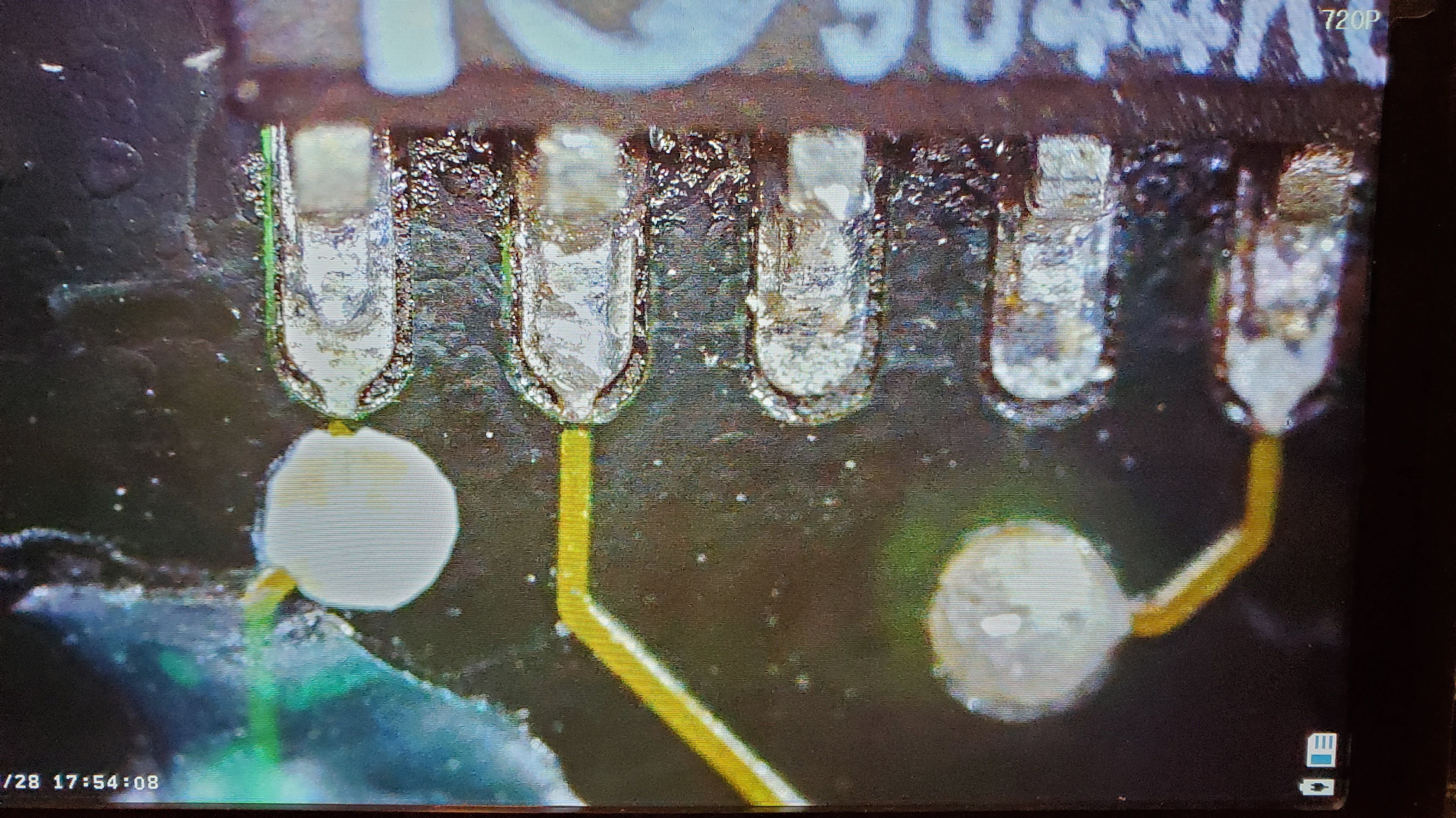

I spoke too soon. after 19 minutes of running it went back into the reboot cycle booting over and over.
I noticed there was a wonky via on the negative side of C14. I desoldered it and cleaned it up until I could see the metal pipe that makes up the via. I'm getting continuity between the negative and positive via on C14. Is that normal? If not, why does it run for a while until it's warm and then start rebooting? The negative side just goes down into the board and I can't see any traces coming from it.
I'm gonna go get a another 470µF 16v cap and replace the one that's there but I don't think that'll fix it. I have no idea what do or what to look for at this point.
In the pics you can see where I'm referencing. The gunky looking stuff is solder mask.

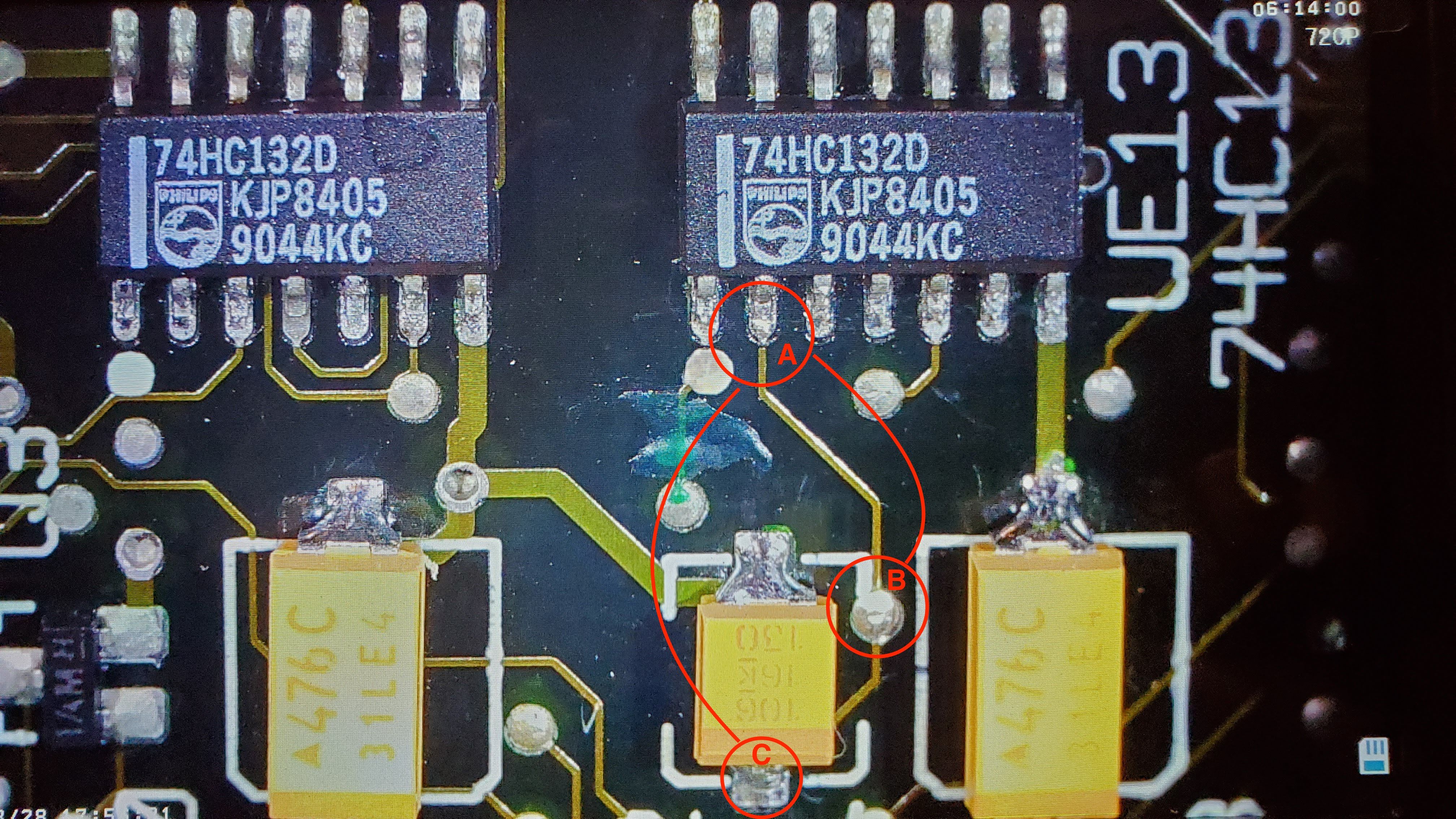

I reflowed the solder on UB13, UD13, and UE13 and started checking continuity. In the attached pic on UE13, I have no continuity between points A and B or points A and C. Does this trace look broken to you? Is there supposed to be continuity here? I looked at the schematics but I have no idea what I'm looking at. It doesn't look any different than the first leg or the 5th leg.

To my eye it looks like the pad at point A does not connect to the trace going to point B, based on the black gap between the pad and the trace. I had several similar instances on an SE/30 which I repaired by scraping the trace adjacent to the pad and either bridging via solder or adding a wire to make continuity. Does B to C give you continuity?

B to C does give a continuity beep. What puzzles me is the IIci runs fine for about 10 minutes before it starts the rebooting loop.
I have another instance of this on my SE/30 that I'm repairing as well.
I'm guessing in ALL instances of a trace coming up to a pad there should be a connection? Is there any instance where it looks like the trace belongs to a pad but is NOT supposed to be connected?
If that's the case I can run a solder bridge between all the pads and traces that aren't registering continuity on the IIci and the SE/30.

You can see that Pin 2 of UE13, goes to the positive side of C12, and to the resistors R44 and R43, that most likely are in the backside of the PCB and are connected to the pad you marked as "B", so, maybe this can help you to interpret the connections, but in general, if you see a trace that goes to a pin then you should always get connectivity between all ends of that trace, and if you don't, something needs to be fixed.
Heat can make things that work marginally to stop working. It could be a trace that has a very faint connectivity, it could be some cap goo under a chip that makes things go worse when it's hot...
