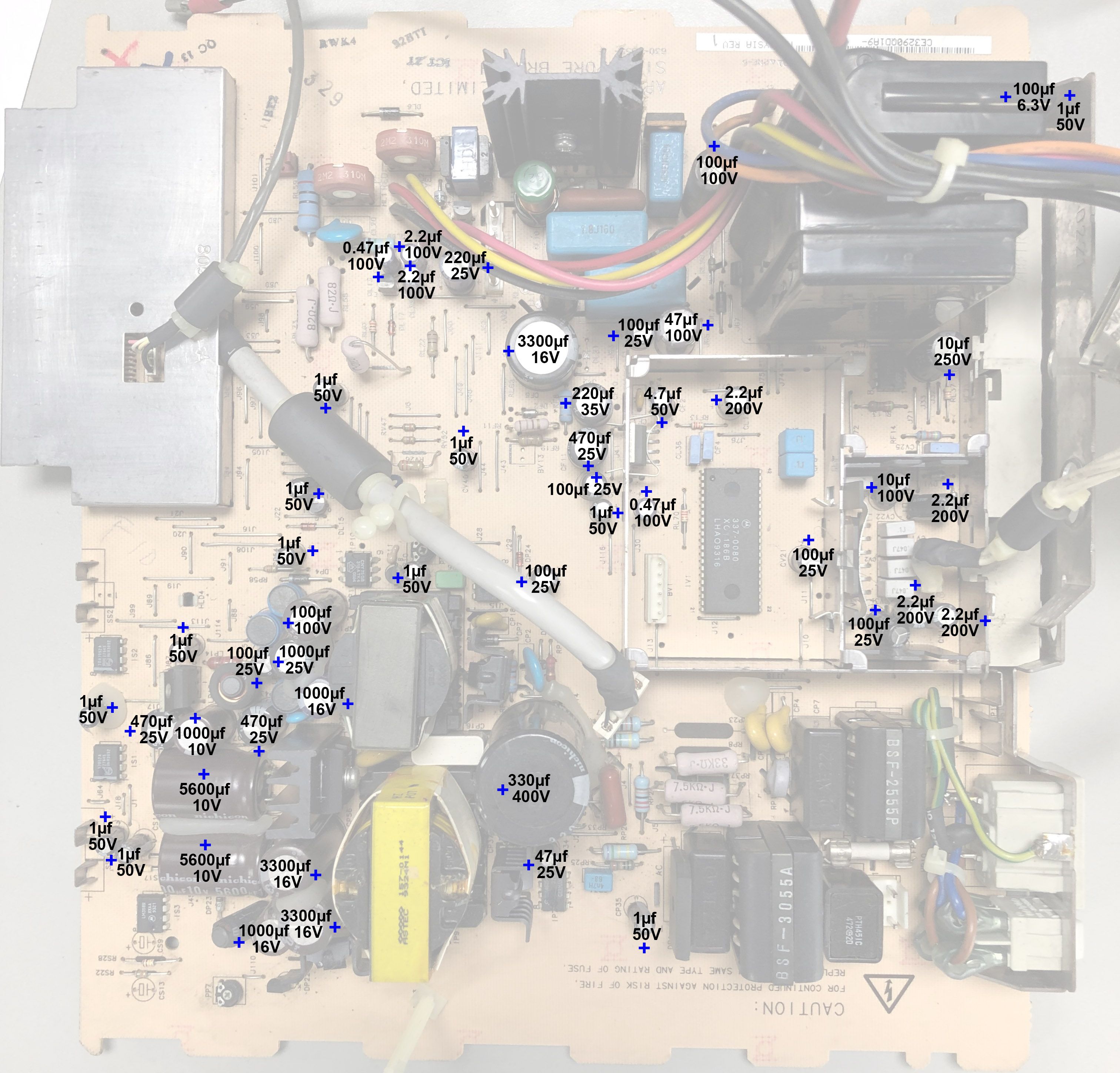

I needed to recap my LC 575 analog board, and couldn't find a guide for it, so I decided to make one, similar looking to what Branchus Creations has created for the Color Classic analog board.
LC 575 AB is very similar in layout and uses very similar capacitors as the Color Classic AB. The differences in capacitors needed are minimal, and I have worked with the Console5 owner to update his Color Classic Analog kit to include what was missing for the LC 575 board, so all their kits sold from now on will be LC 575 compatible.
This board's model number is 630-0355:
