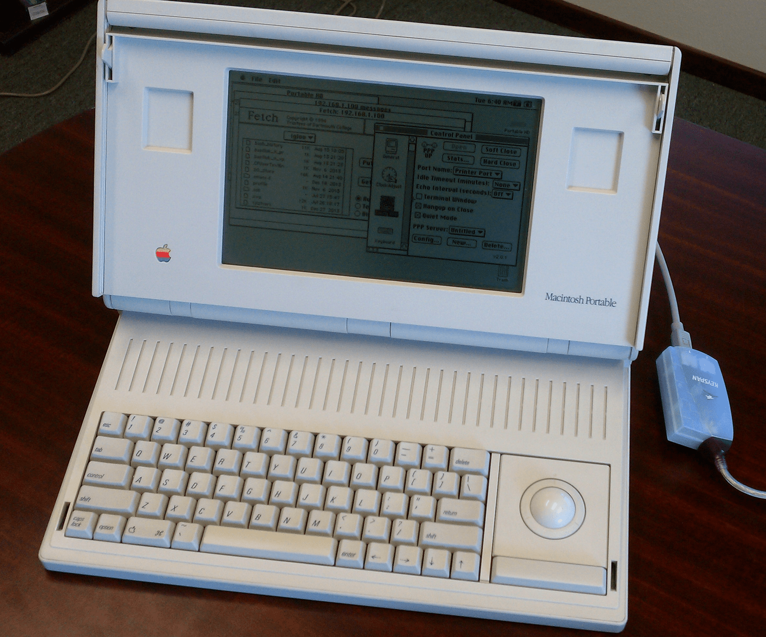

With that amount of lighting it should be pretty clear. I only have one image of a Portable, and it looked almost identically to this in real life. It's actually kind of surprising how crisp it looks like, probably because it's only 1 bit.
That was with window shades pulled up to the right. If it's a little hard to read, you just tinker with the contrast a bit. Problem is you can't adjust contrast on a 5126.

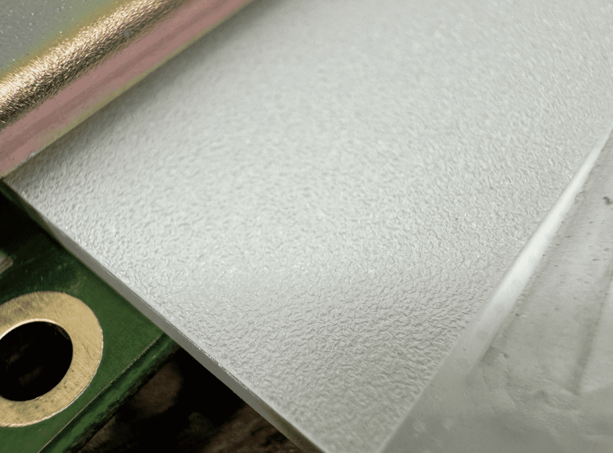

I'm going to answer my own question with this photo of the backlight diffuser behind the LCD on my M5126 Portable...
That textured top makes it diffuse light from the CCFL tube on the left side, but it will also diffuse light hitting the screen when the backlight is off. Because of that, the visibility of the 5126 without backlight off will be much lower than the visibility of the 5120, which I believe has a smooth and highly reflective surface just behind the LCD.
So people with the backlit Portable really do need a good backlight to even see the screen. And if your CCFL tube is dim like mine, it becomes an altogether bad visibility situation.
