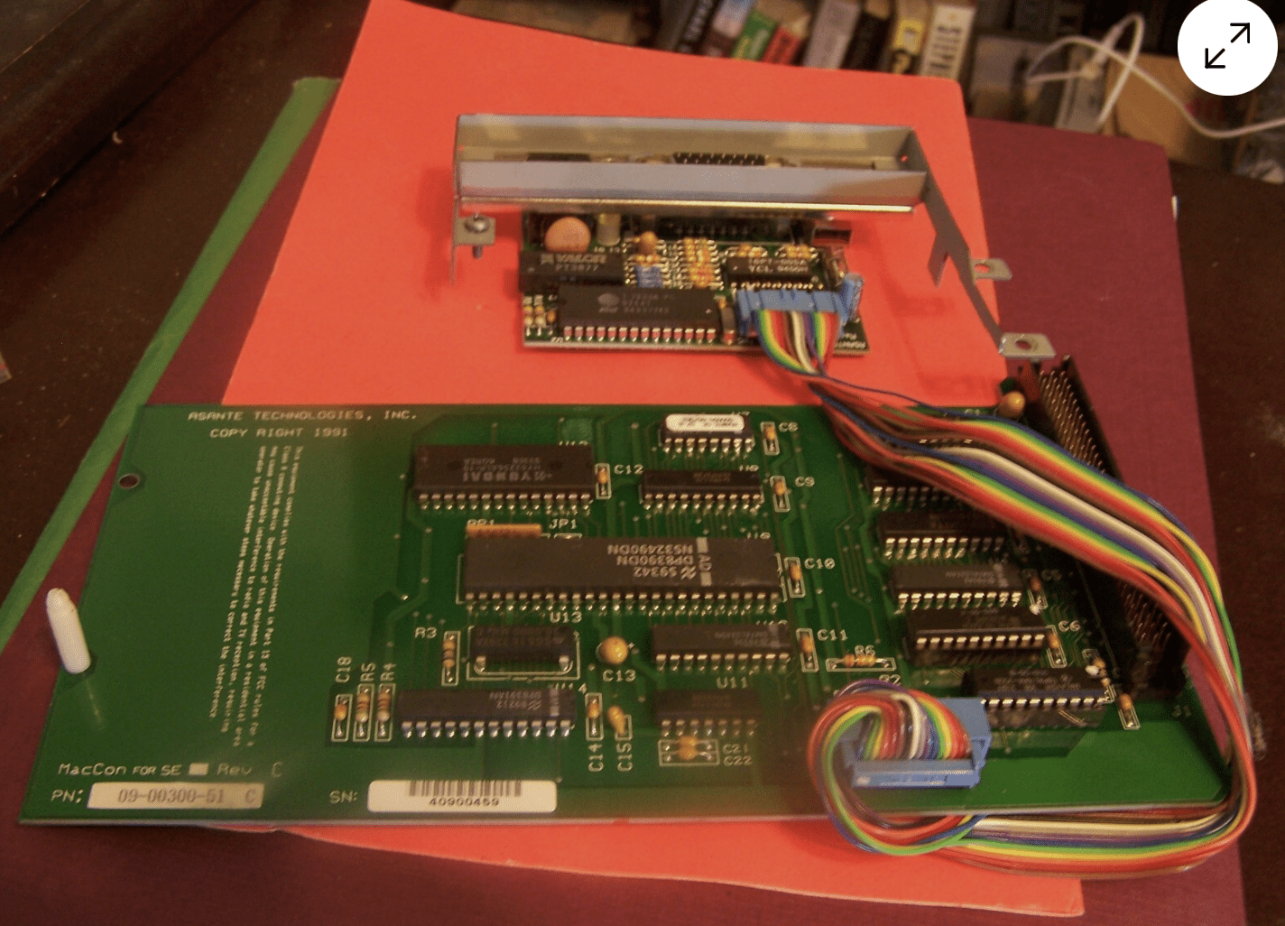

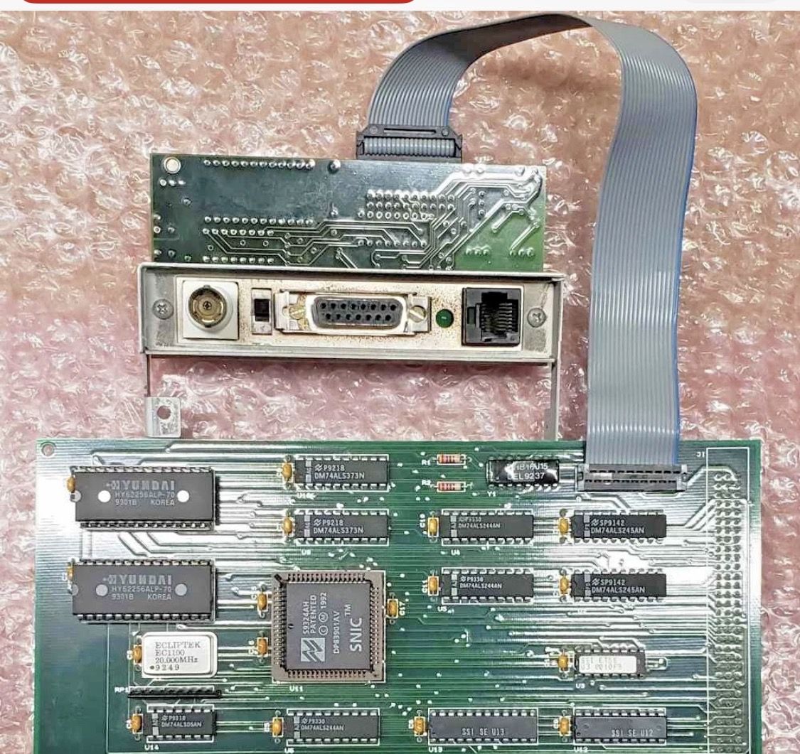

The MacCon is going to be a better choice. The DP83902 family of chipsets works with NSI software right out of the box, works with System 7's installer without even doing anything, works with A/UX, and just plain works.

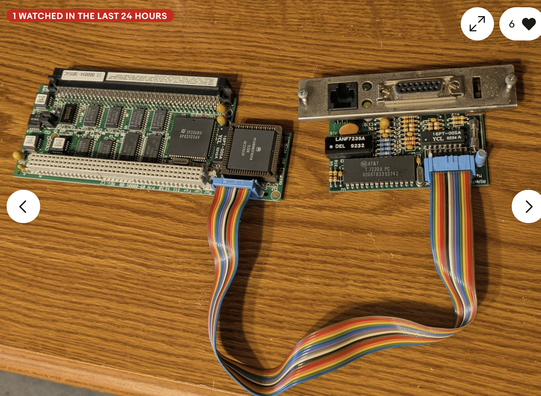

Based on those two images, the left one (DaynaPORT) will not work in a SE/30, the bus interconnect is different. The one on the right should work perfectly fine, if you remove the FPU though. Bet the 20MHz oscillator is about ready to clock out though. For the 30Video card, it should work fine, but remember any kind of external video like that puts a noticeable performance penalty on a poor 16MHz '030.
See the link below for more, and even more.
Now I get it. It didn’t sink in until I started reading the documentation. I’ll pry out that socketed 68882 do before I install.
