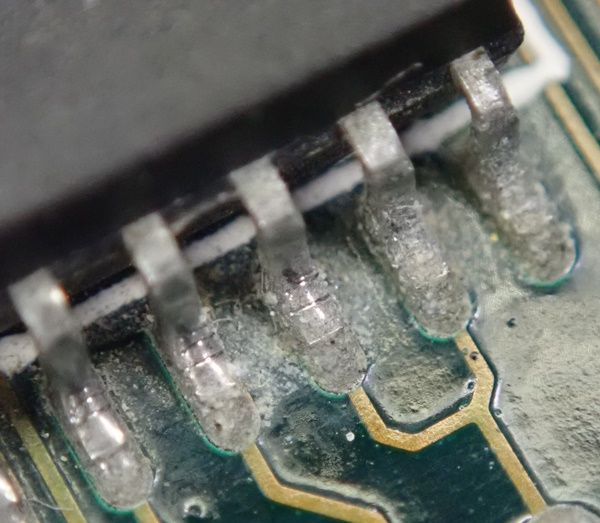

Almost all Macintosh II motherboards suffer from power-on issues, due to the batteries constantly applying power to long traces. In the presence of moisture or leaked electrolyte, this results in electrolysis, which corrodes metals more rapidly.
It is assumed that you’ve already corrected broken traces leading from the power switch and batteries, as well as likely replaced UB2. Before proceeding, your Macintosh should power on (fan turns on) and the +5 and +12V voltages should test as good.
Recap, Obvious Trace Repair, and Cleanup
It is assumed you’ve recapped the motherboard, repaired any obvious broken traces, and cleaned residue. This is always your first step in getting an old Macintosh working.

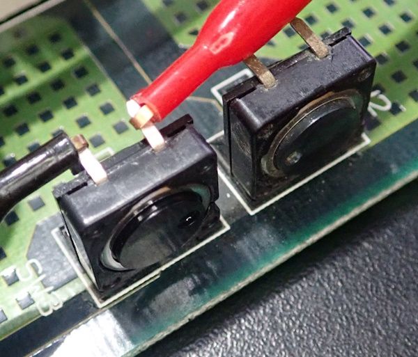

  • Test the Reset and Interrupt Switches. Measure across the top of each switch with a multimeter. On the board, they should be 1 kilohm (interrupt) 140 ohm (reset) or more when released, and less than 10 ohm when pressed. If you aren’t seeing a wide swing between pressed and released, the switch is corroded internally and needs to be removed or replaced.

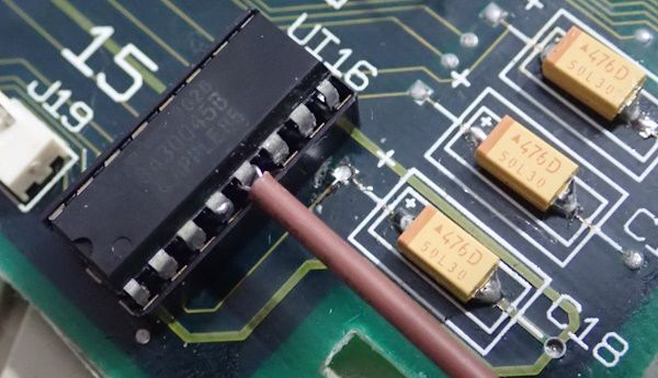

Test ~ARST, which is nicely available on pin 5 of the sound chip. This is the reset line and flows throughout the board. It should be high (5V) when the computer is allowed to run. Pressing the reset button causes the line to go low and then high.
(In the image above, my UI15 is socketed because I had to replace a bad sound chip.)
If the reset line is never going high, or is repeatedly and immediately going low again, then check the reset switch, sound chip, and the traces, capacitors, and resistors connected to them. Below is an image of an oscilloscope trace of the reset line (yellow trace) immediately resetting due to a bad sound chip. This chip is near three of four leaky capacitors.

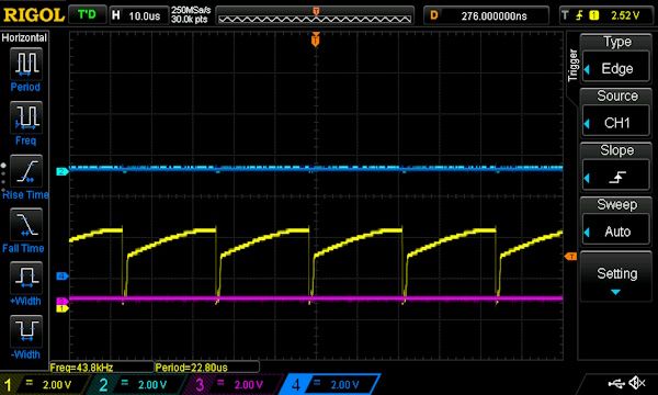

On the other hand, if there is a decent time gap between going high and then low (briefly), then the CPU is likely running and having trouble reading the ROMs (more details later). To verify that, you should watch the bus error pin 19 on the GLU chip. Reset should go high, bus error should go high, and then if bus error goes low, the CPU is correctly supposed to assert a reset.
When diagnosing a problem, I like to use the reset line as the trigger on my oscilloscope. I can press the reset button and capture a trace of the initial behavior anywhere on the board.

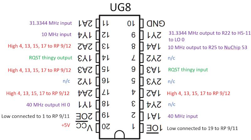

Check the 40 MHz clock by measuring pin 18 on UG8. Check the 31.3344 MHz clock by measuring pin 9 on UG8 (and optionally pin 11 on H5 and on the CLK pin on CPU socket). I have had to replace 31.3344 MHz oscillators on two of my dead boards. This could be due to my ultrasonic cleaner. Or, it could be these were poorly manufactured.

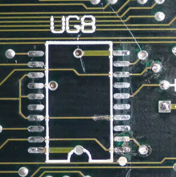

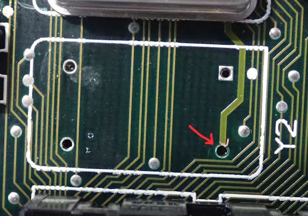

Removing the oscillator can be challenging due to the metal can. Check your work carefully, as I broke the ground pad on mine. It would have been really difficult to find this fault had I not checked before soldering a new oscillator on top of it.

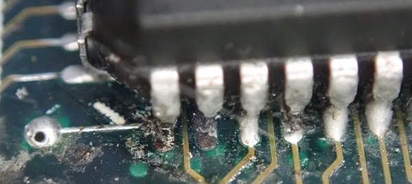

Actually --- before removing the oscillator, test the pins directly underneath with power turned on. If you’re getting a good frequency there, it may be that UG8 itself is compromised. Capacitor goo from C11 may be preventing contact with the pads, may have broken traces leading to the pads, or may have damaged UG8.
Here are the traces underneath.

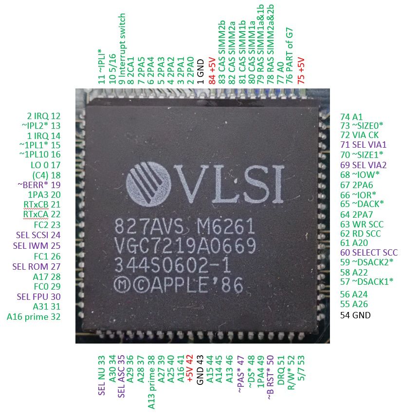

Wonderful GLU
At this point, power is good, reset is going high for at least a while, and a good clock signal is being generated. The CPU should now be running. Its first step is to try to read from the ROMs.
The GLU chip watches the address lines and lets all the other support chips know when it is time to listen or talk. It does this by enabling (low signal) a trace that goes only to a specific chip when their address is selected. As such, the GLU is a great place to watch the start up process and to see where something gets stuck. (Image below: Just look at all of those select lines.)

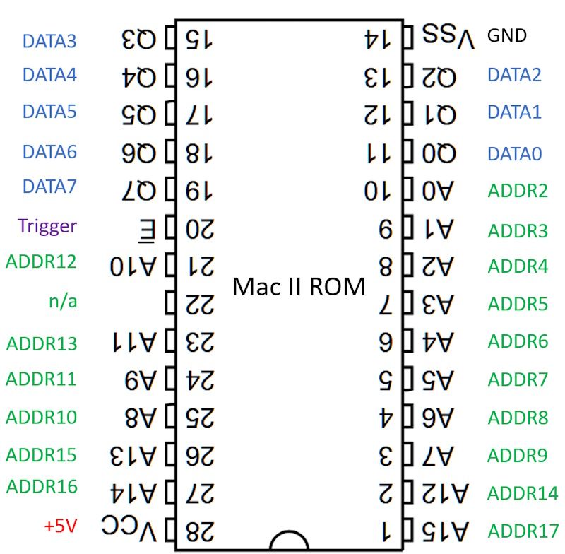

As stated earlier, the first step after coming out of reset is to read the first four bytes out of the ROMs. Each ROM chip supplies one byte simultaneously. Put a low trigger on pin 20 of UF11. That’s the enable pin. In normal operation at startup, you should see a continuous or repeated low signal as the CPU executes ROM code (read, execute, read, execute) and sometimes high for a short time (reading RAM or another chip).
If you see two enables or a long enabled followed by a bus error (pin 19 GLU) and a reset, then the ROM is not being read correctly. Swap them with known working ROMs if you can. Check continuity on each trace. You can even pretend to be Adrian from Adrian’s Digital Basement and watch each ROM line on an oscilloscope to see if it is showing activity and strong highs and lows.
Worst case, you can flip the board over, set the scope to trigger on reset (single shot capture), and then one by one manually read the data line values (move to the next data pin, rearm the scope, pressing the reset button on the Mac II). Do that 32 times and you should have what the CPU is seeing as the first four bytes of ROM.
You might think this is a crazy approach. But, if there is a bad chip (or shorted trace) somewhere on the board, it can interfere (talk over) with the signals coming back from the ROM. This is how I found a bad SWIM chip on the Macintosh Portable. It was talking on the data lines even when it wasn’t that chip’s turn.

For one bad Mac II, I noticed pin 60 on the GLU was enabling (low signal) the SCC (serial chip) repeatedly. It struck me that the Mac was sitting and listening on the serial port. Oh! That’s a good thing. Serial diagnostic!

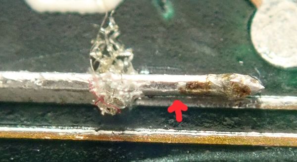

Oh no! For me, it responded with 01000000*M. Is RAM not writing? Looking over my trace repairs, I noticed a questionable fix near UG8. Without touching the bodge wire, but instead toning farther away points on the trace revealed the bodge wire was floating above the trace, not soldered to it on one end. Wouldn’t you know? That’s the ‘write’ signal.
Soldering it properly fixed this Mac. Thank you Serial ROM Diagnostic.
