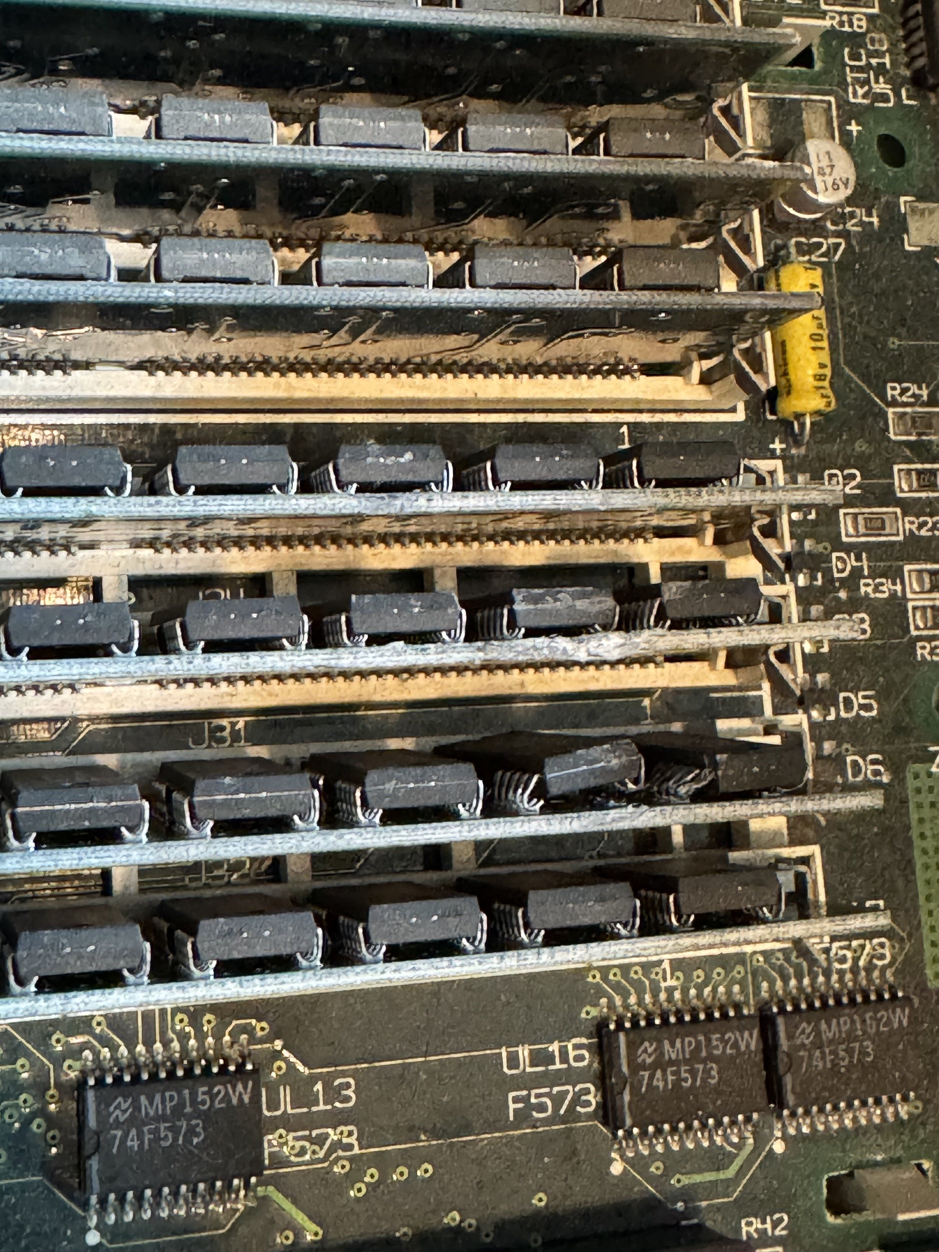

Hey everyone! This is my first post here on these forums. Exciting to see a non-Discord method of interest and hobby sharing in 2026.
Anyways - this is my project for however long it takes me.
I bought this Macintosh IIfx on eBay for ~$400.
Here are a couple of first thoughts:

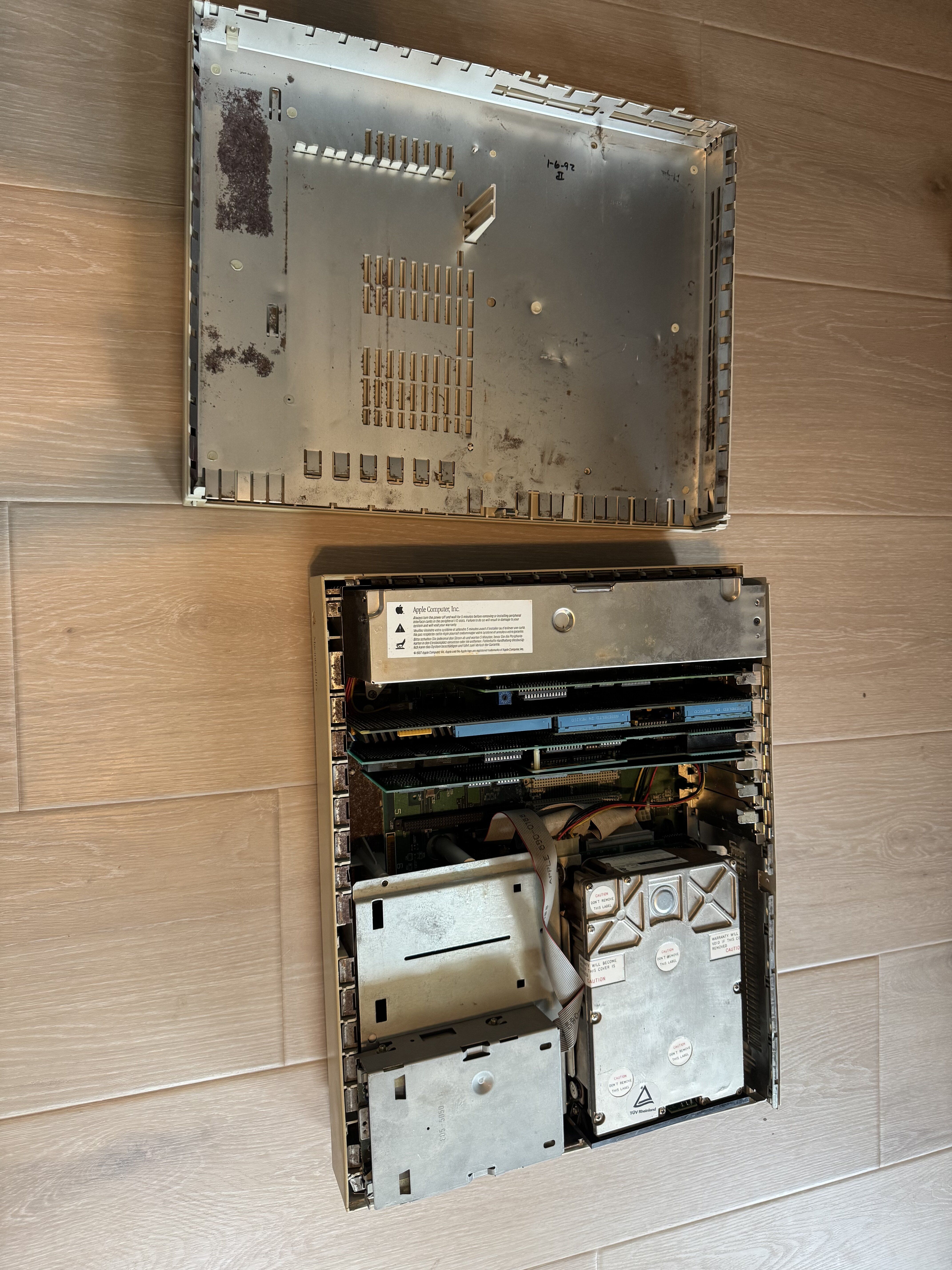

  • Case seems to be in fairly bad shape - multiple cracks + broken clips + the inside metal shroud is rusty af.

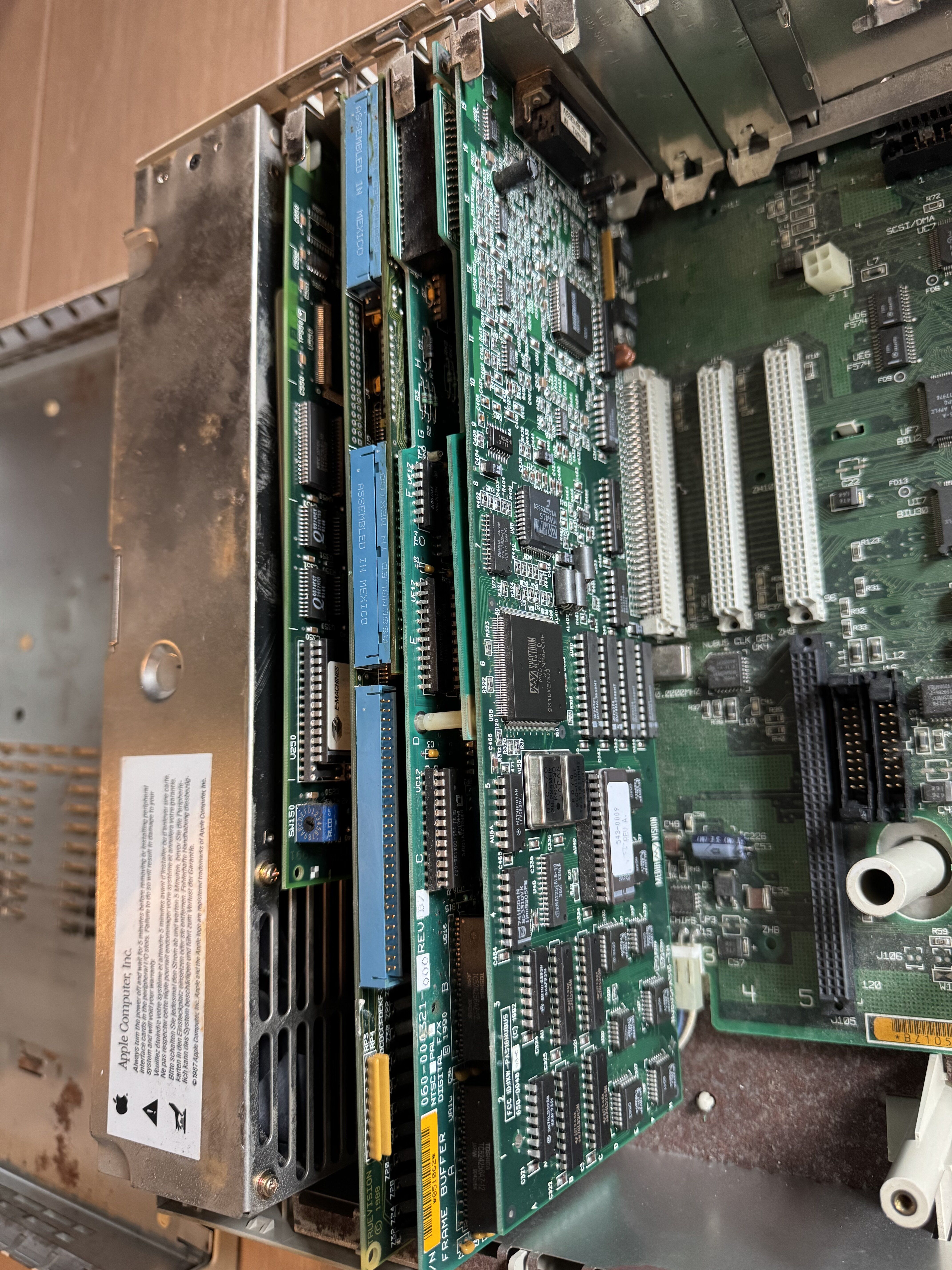

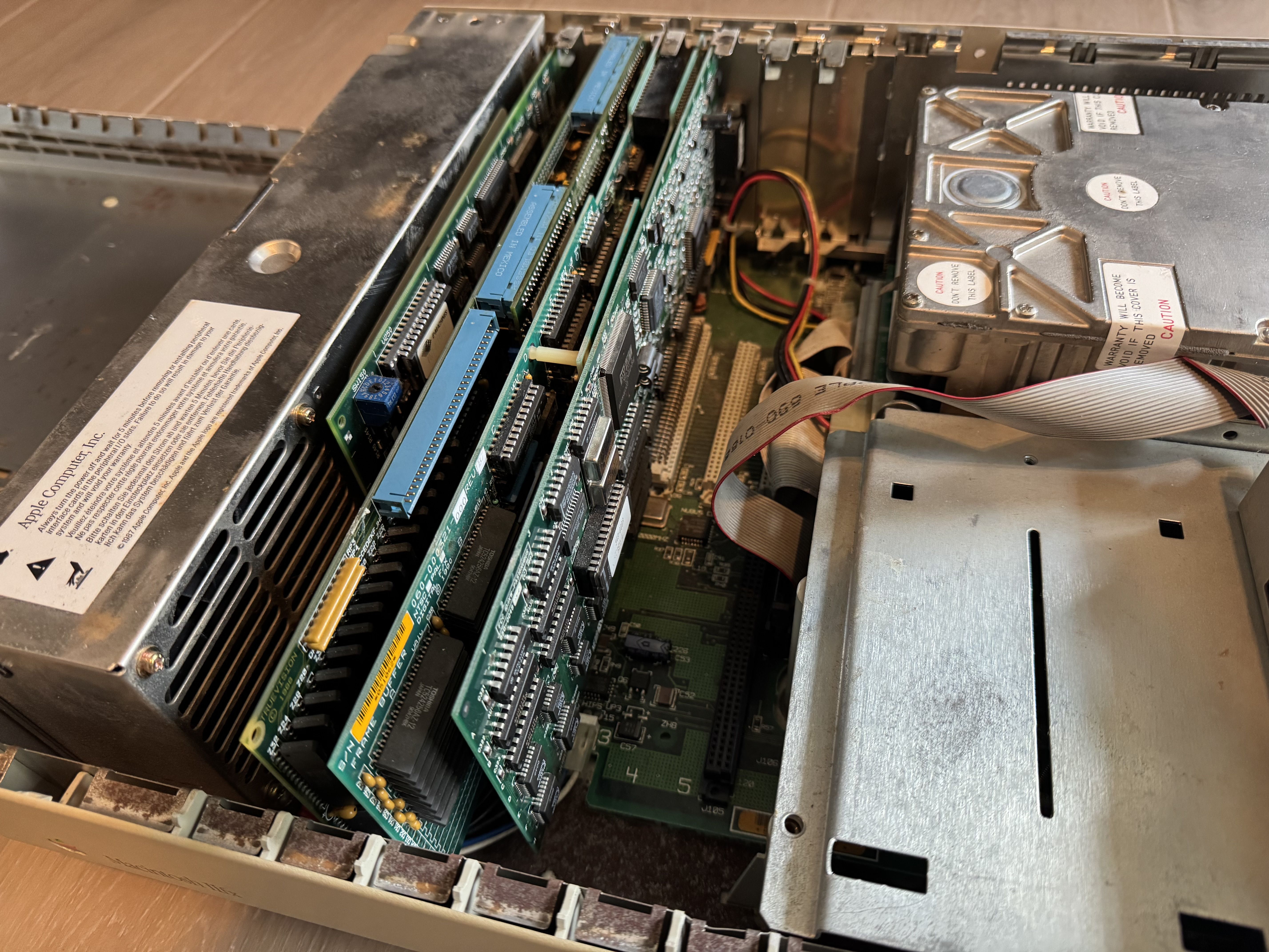

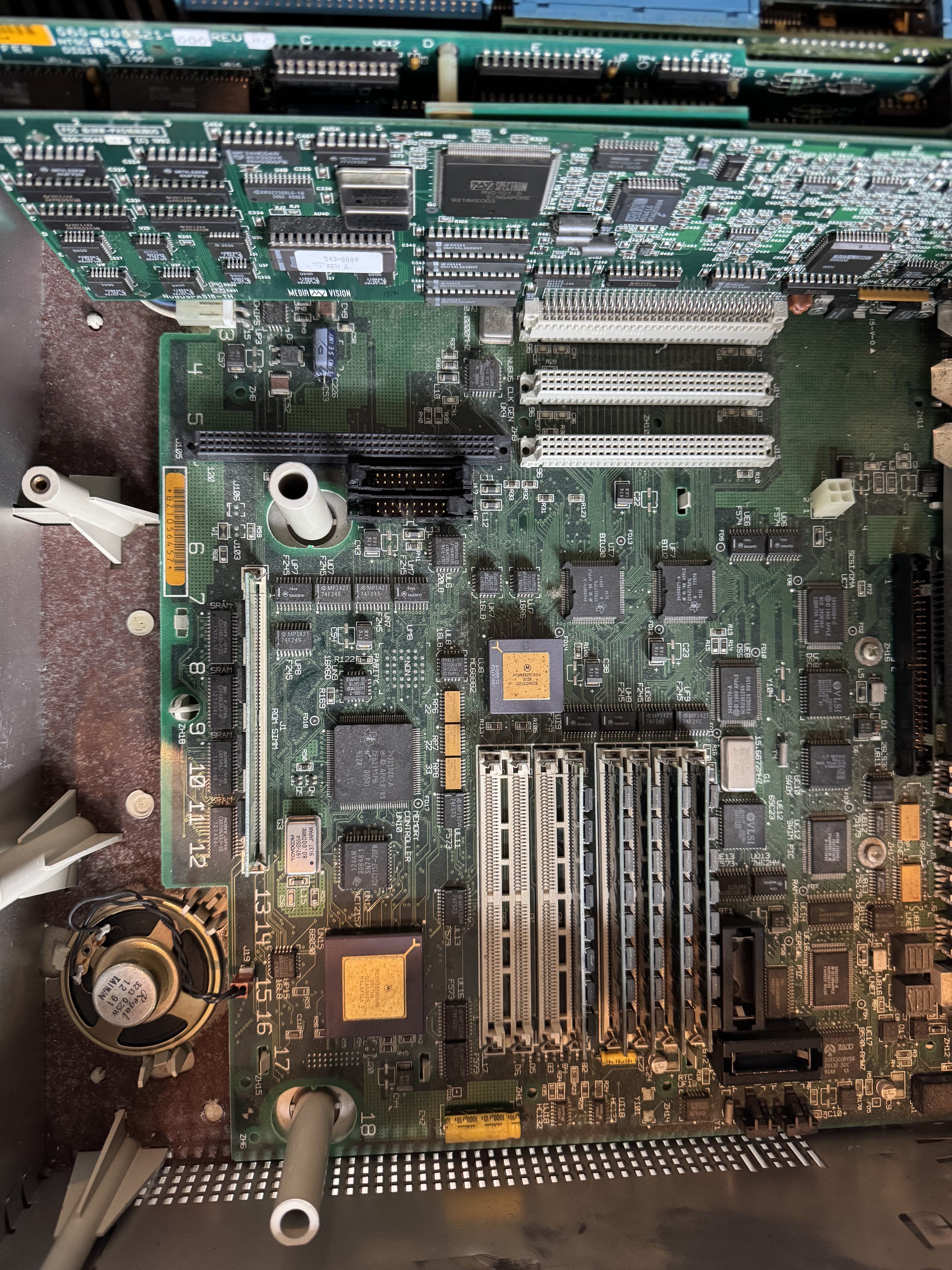

  • Motherboard luckily seems to be in near perfect condition, with the exception of a few broken component clips for (what I think is) the HDD enclosure.

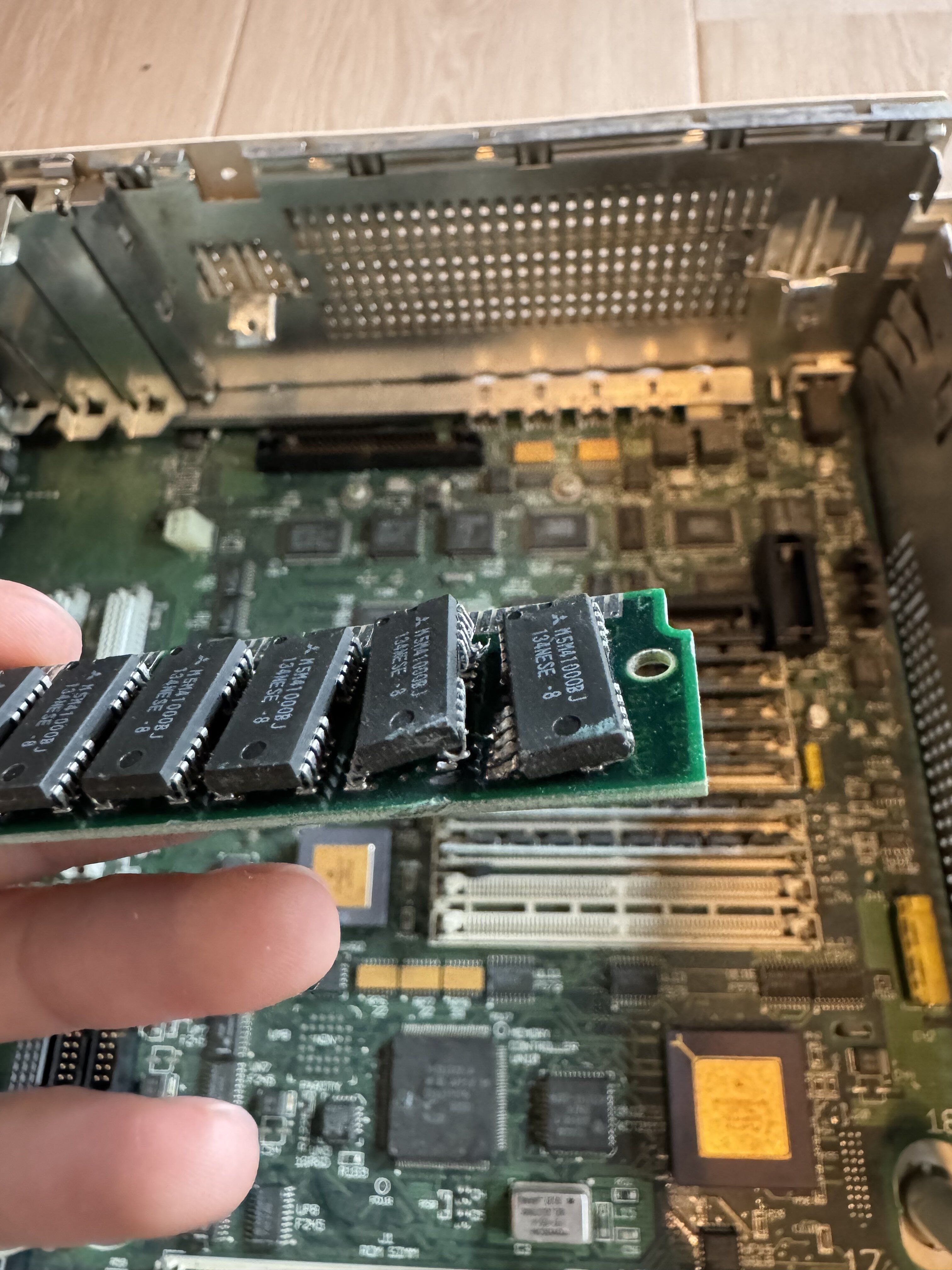

  • There are OBVIOUSLY damaged RAM SIMMs in this machine.
I bought this listing in particular: https://www.ebay.com/itm/407183257267
The description mentioned the hard drive enclosure was loose in the case, which may have caused damage to the components inside. However, from the listing pictures there didn't seem to be any obvious component damage... yet! That changed when it was mailed to me, it seems.
As I said, luckily the board itself didn't seem to take any damage, but I have at least 3 RAM SIMMs that need to be replaced. No obvious capacitor leakage, and also it looks like all batteries have been removed.
I'd love y'all's initial thoughts on this project. Where should I start, and where should I watch to score replacement components? I know the RAM for this particular model tends to be difficult to come across...
Any help/direction/thoughts in general y'all can offer would be greatly appreciated.

The capacitors need to be replaced. Even if they appear fine, you’ll know when you remove them because you’ll smell the fishy odor. Those 16V 47uF cans always leak. And the photo is blurry but it does look like you have trace wear near the power button — the dark spots on the trace that run there. I’ve seen that on numerous Mac IIfx’s (and II/IIx). So you definitely need to replace those.
You also need to replace the C1 tantalum capacitor. Apple shipped those rated at 16V and it’s known now that for these tantalum’s, they need to be rated 2x the voltage.. that C1 cap is on 12V and so you need at least a 25V tantalum to replace it. That C1 is notorious for blowing up and leaving a crater on the logic board as well as taking out some of the nearby components.
Lastly, it looks like you might be able to repair the RAM. At least from the picture, I don’t see any pads completely gone. You may be able to use flux and hot air to remove the chips that got hit, bend the pins back, fix any pads or add bodge wires for the pads that are lifted, and then resolder the chips. Given these are harder to replace, I‘d try to fix those. I wouldn’t give up on them yet.
The power supply I have found to usually be good in the IIfx but they will need a recap at some point as well. But definitely be careful in there if you haven’t messed around inside PSUs before.
Goodluck!

YOWCH! It looks like whatever kinda cage rattling around loose in there was for a 3.5" drive and kept caged under the peripherals tray by its supports? The cards look to be in great shape and an interesting lot, especially if you're into music.
If you watched the photo of the logic board closely, you see that this board has also a lot 16V 47uF black tantalum caps. These don't leak over time. Apple used different kind of caps for the IIfx for the 16V 47uF, including black and yellow tantalum caps. My IIfx has the yellow tantalum caps.
I was referring to your C24 and C9 in the picture which are electrolytic and leak. As well as your axials like C42.
