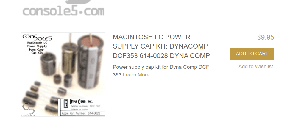

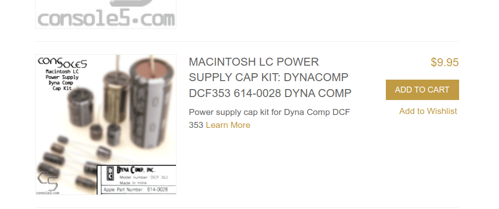

The out-of-focus photo is intended to be representative of the parts you might find in the kit. With the number of different devices they support it would be impractical in the extreme to provide photos of the exact kit.
