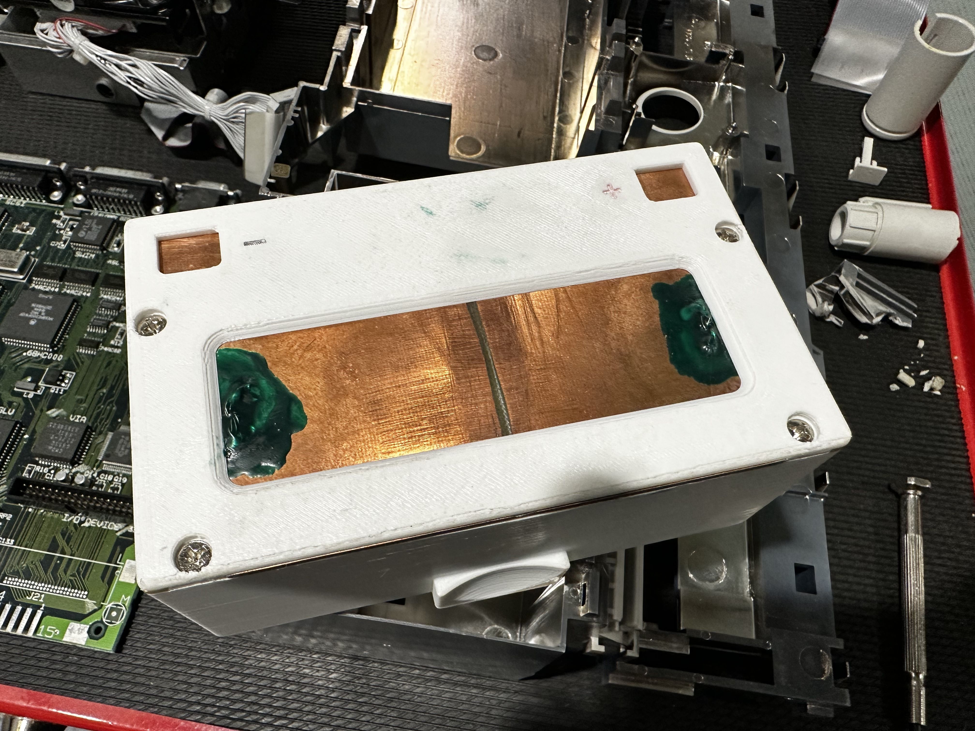

There’s a replica stl of the original battery pack online. It’s very acurate. I think it’s a 3d scan. I used it to make my battery. I cut some strips of copper sheet and made some 3d printed fasteners to lock them into place. Worked perfect but I’m not sure how well the copper pads wil hold up over time.

How'd the printing of that case go?
One reason I didn't go with the original Macintosh Portable battery case design for my battery adapter is because it would take a lot of support material or compromise the surface finish of one of the sides to print on an FDM printer.
The main reason though is that I didn't want to require printing the whole case. Only the spacer is really needed with some padding so the battery contacts won't be bent.
It went well. Yeah lots of support material inside but I needed to test my new replacement printer out anyway and I have support pla which is really nice. It falls right off the part.
