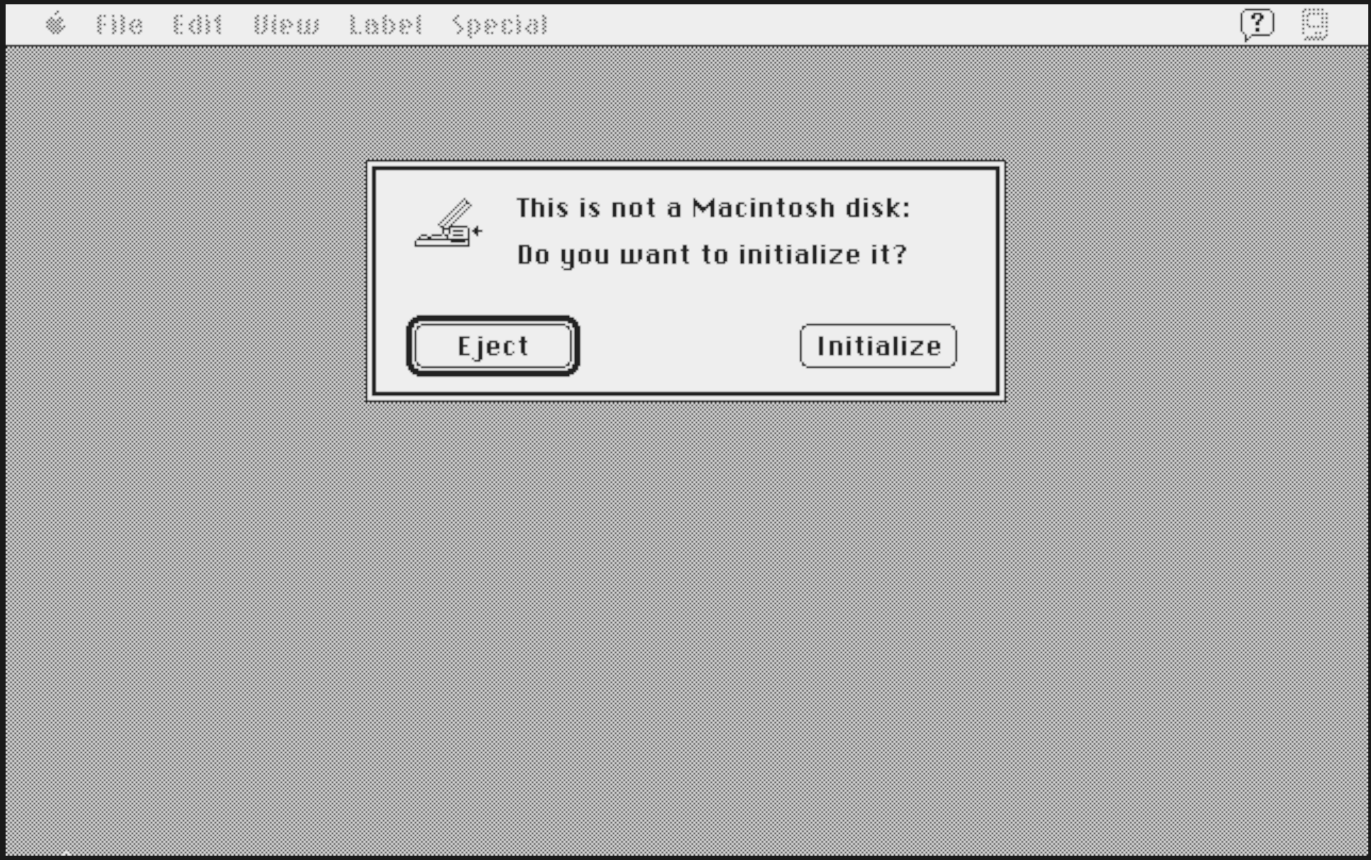

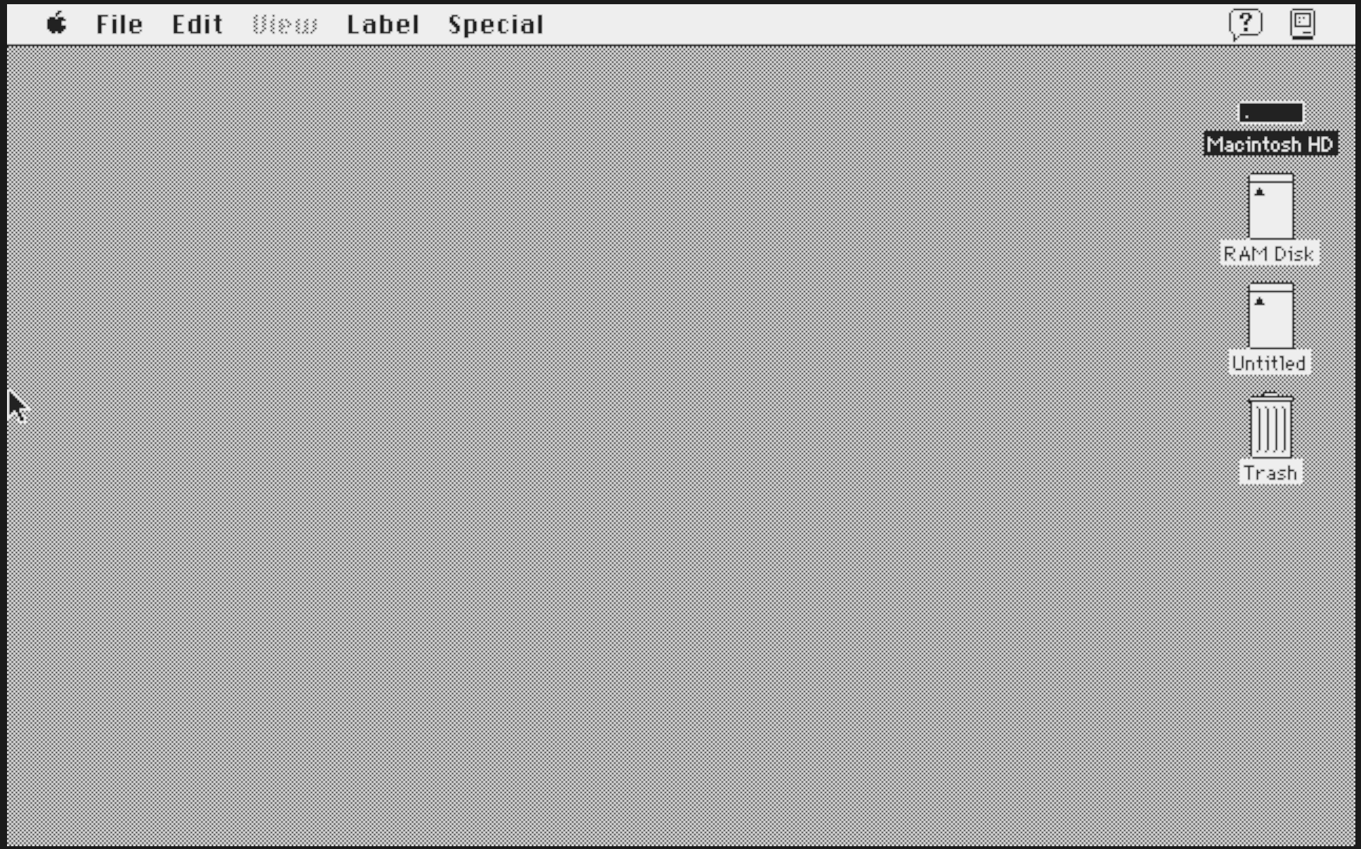

They do work just fine since the entire driver is in ROM:
Getting it in the Powerbook 100 would be tricky, since you need both access to the bus as well as the signals from the CPU GLU, at least to implement it the way Apple intended.
