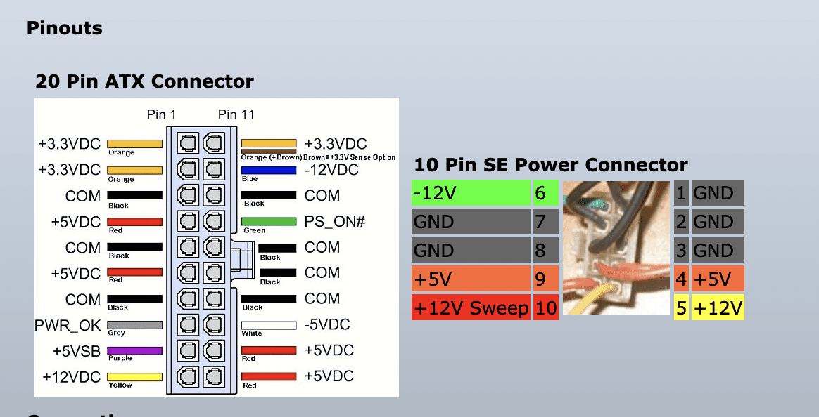

Hi I am in process of restoring my Macintosh SE/30 and thanks to JDW’s awesome video I am going to replace the stock unit I have with a seasonic. The only issue I’m worried about is that I couldn’t find the same model for anywhere near the price range it was once at, but I did find and purchase a similar seasonic model.
“Seasonic SS-250SU 80 Plus 250w Server Power Supply”
From the limited looking I did I think this unit will work, I was just wondering if anyone here can chime in with some insight if possible.
Also while on the subject, I noticed when searching for a capacitor list to replace the ones in my stock psu that my unit isn’t really listed anywhere. I’ve included pictures here of the apple psu part #: 631 - 5105 - A it’s apple branded and says manufactured in Singapore.
