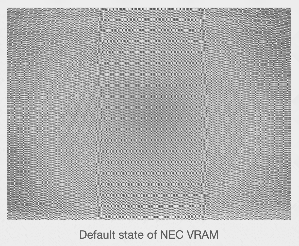

@Mac84 , you're a star! 🌟
Many years ago, one of my SE/30 boards showed the exact pattern shown below, and at the time I posted in another forum to ask if anyone had seen that instead of the regular horizontal stripes, but no one replied back to say they did. Thanks to your Repair Guide, I see it is simply another variant of the horizontal stripes, differing due to the VRAM being NEC. Great info! (Still haven't read it all, but slowly making my way through it). Kudos!
UPDATE: Just finished going through the entire document. Fantastic work, especially the oscilloscope screenshots showing the signals to look for. That info is extremely helpful!
