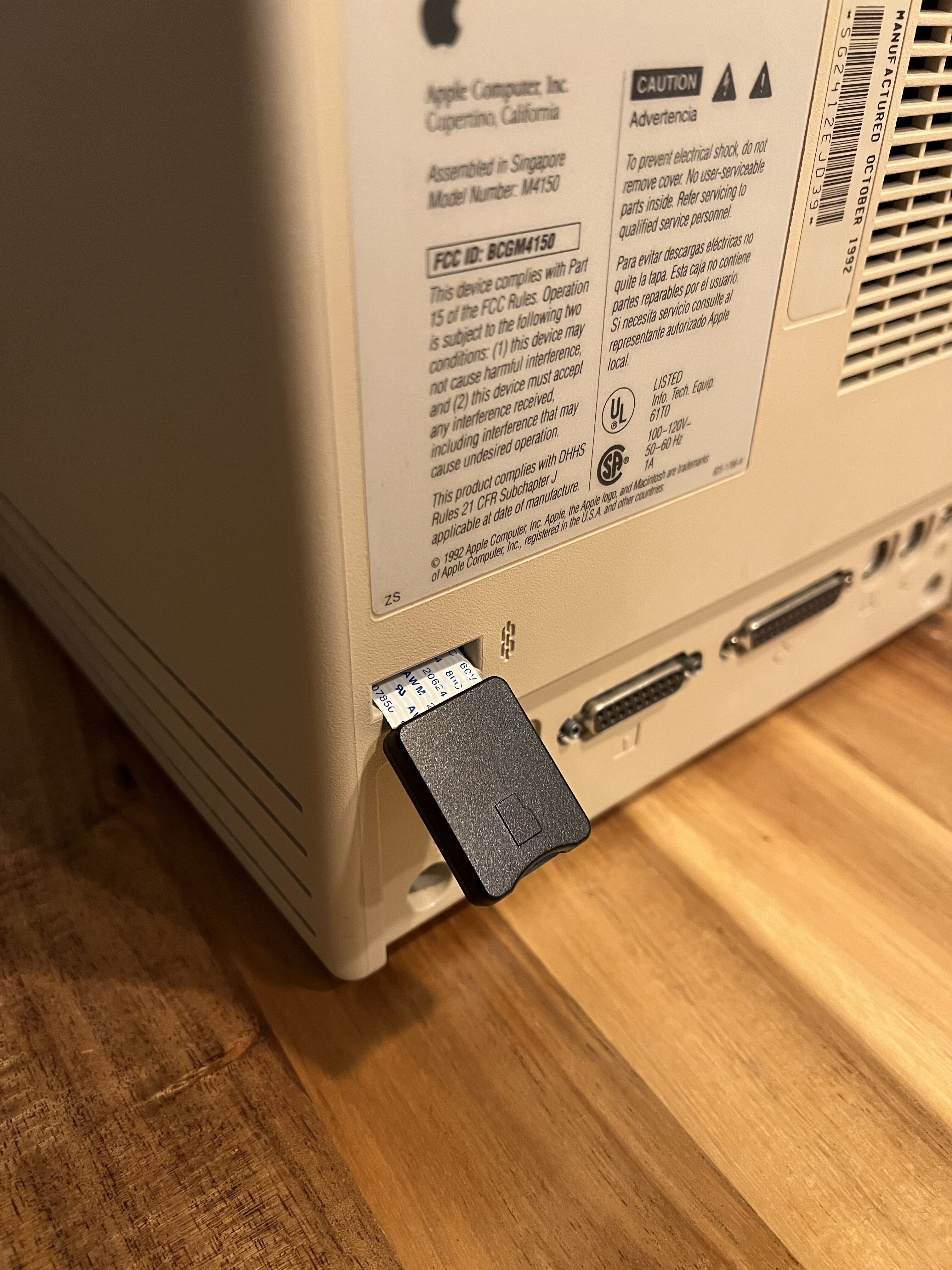

As for the security slot idea, I can confirm that a microSD card extension cable like the one @Kai Robinson linked to can be inserted through the security port. I wanted access to the SD in my Classic II, which doesn't have the expansion slot of the SE or SE/30. So rather than damage the case I went with the extender. The little plastic SD card slot hangs out the back, so it's not ideal, but I may get some double sided tape to stick it down flush so it looks a bit better.
I too prefer non-destructive mods, and this one gives me the flexibility to swap out images without having to crack open the case every time. I suppose you could somehow mount it with the slot accessible through the security port, but with the plastic inside the port, it would be significantly recessed and you'd have to use tweezers to get the card in an out, and I'm guessing I'd lose it down in the case more than once.
I too prefer non-destructive mods, and this one gives me the flexibility to swap out images without having to crack open the case every time. I suppose you could somehow mount it with the slot accessible through the security port, but with the plastic inside the port, it would be significantly recessed and you'd have to use tweezers to get the card in an out, and I'm guessing I'd lose it down in the case more than once.View attachment 3192
You can't do that! is says right there "chain only".
I've also been doing this with some of my units, little piece of double sided tape to keep the sd mount flush and secure. I am finding however my latest batch of bluepills HATE sd card extenders :(
