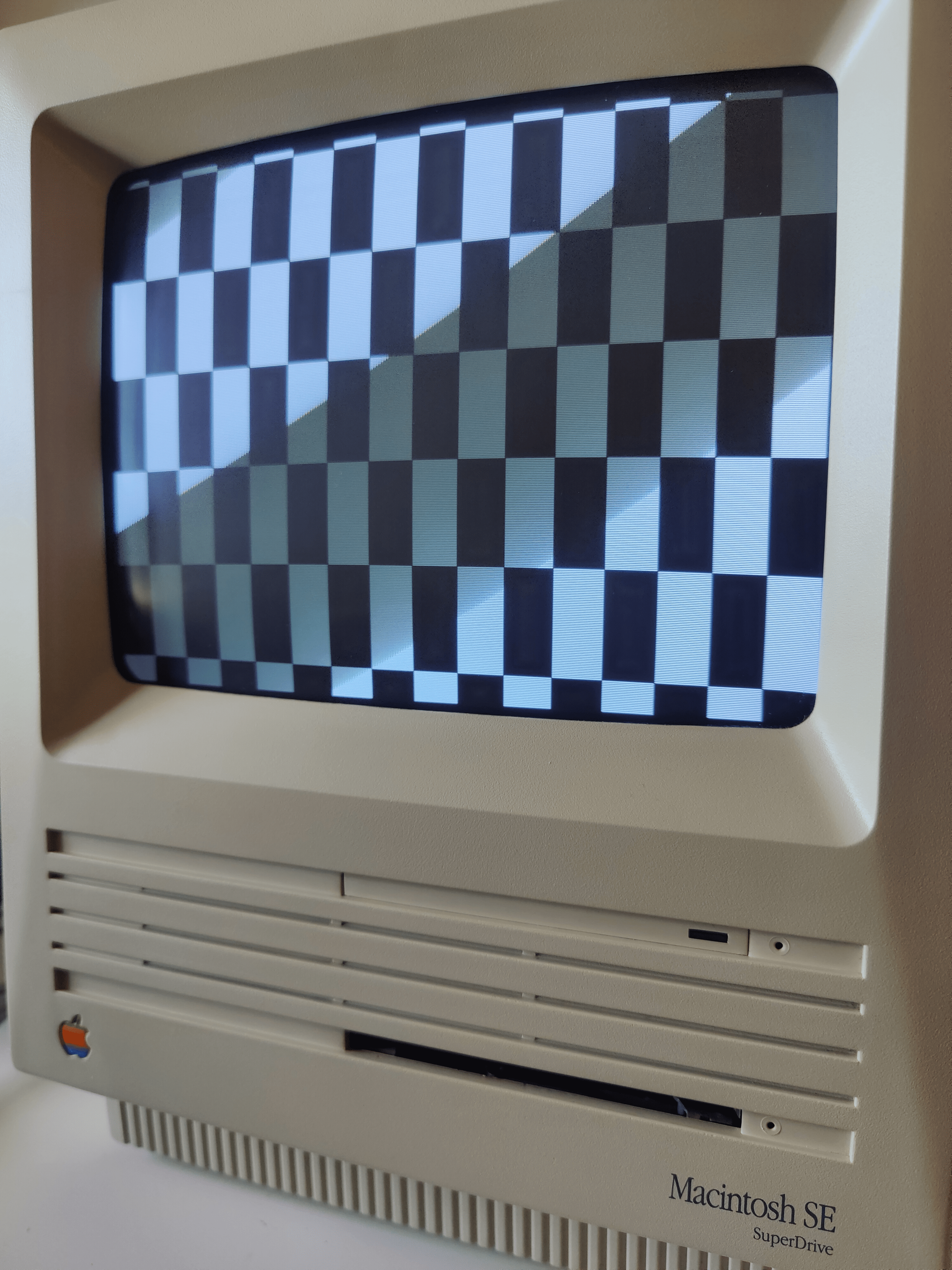

Now after putting everything back together, it greets me with a checkerboard pattern:
Thought it might be a ram issue, i replaced all 4 ram sticks with known good ones (1Mx8, 8 chip, 80ns), but it still boots to checkerboard. However, after about 10 seconds it chimes and booted up as usual, and sees all 4MB ram. Power cycled it several times, it will always get stuck at the checkerboard screen for ~10s before chiming and booting up
Is this normal for an SE FDHD/SuperDrive? All SEs I have chime instantly when power is switched on. Reset is slow too, after pressing reset button it takes about 10s to chime. Otherwise this SE FDHD is fully functional.

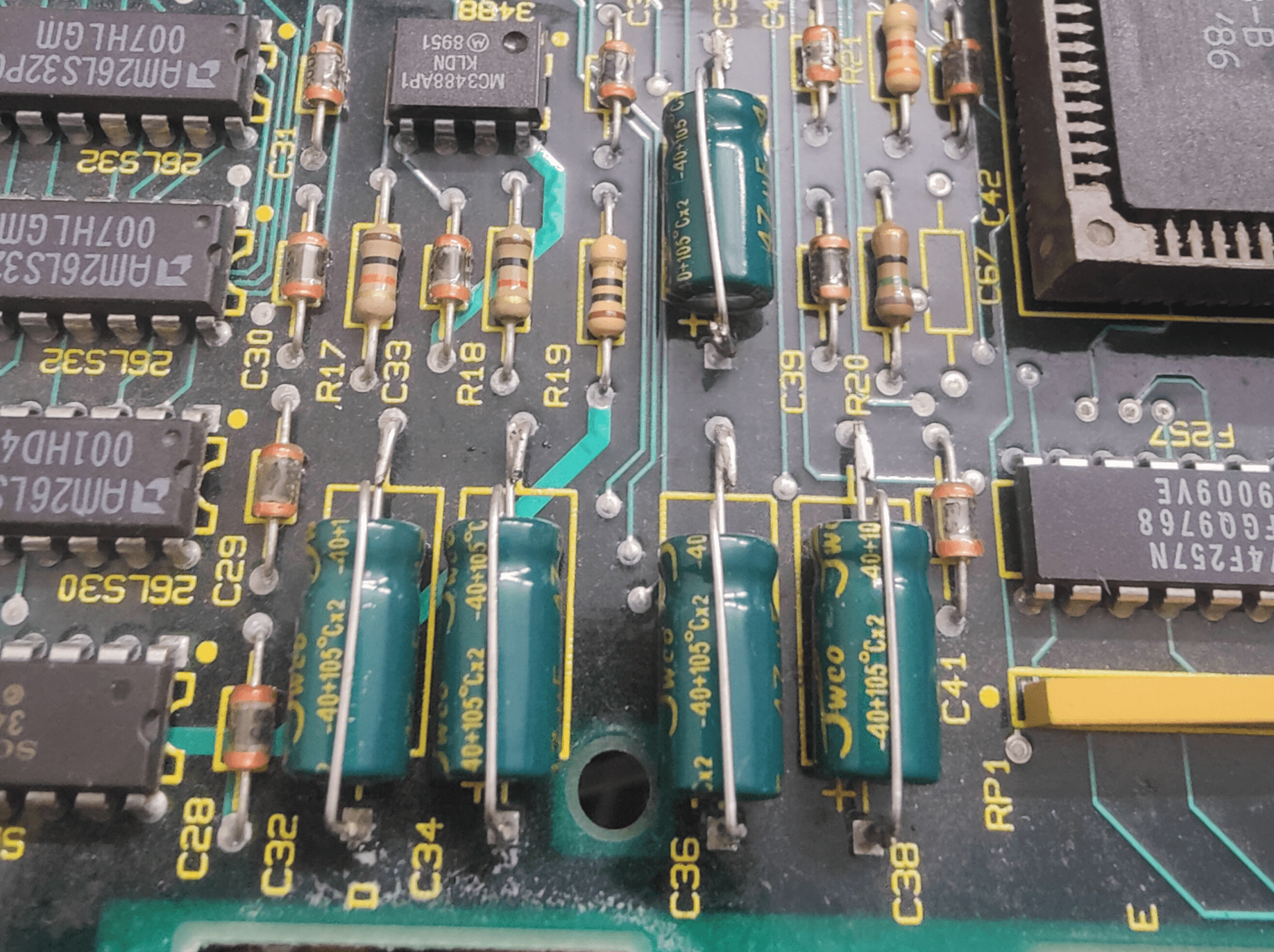

Hi all, thanks so much for your input. I double checked the voltage, reseated both rom chips as well as the swim chip, problem persisted. Swapped the motherboard into an SE chassis, same issue. Then I noticed something, I put a 47uf capacitor on C36 by mistake:
Which should have been a 1uf 50V cap. After replacing this cap with a 4.7uf one this mac chimes instantly on powering on.

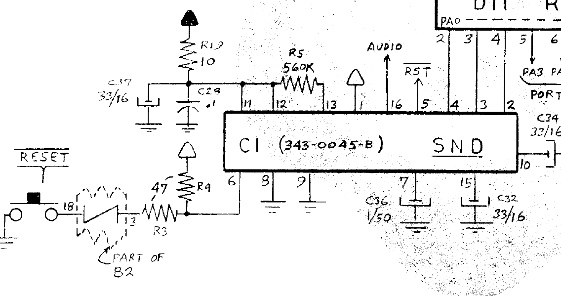

Digging things a bit further, schematic shows this cap is connected to the sony sound chip directly:
So maybe replacing it with a larger capacitor, it will pull down pin 7 of the sound chip much longer till it charges up, and this somehow prevents the sound chip from releasing RST signal, which explains the checkerboard pattern
Anyway, problem solved and thanks again for your input!

Ah nice. Makes sense. The sound chip monitors voltages before releasing the reset line, and it would take longer to charge up that cap.
