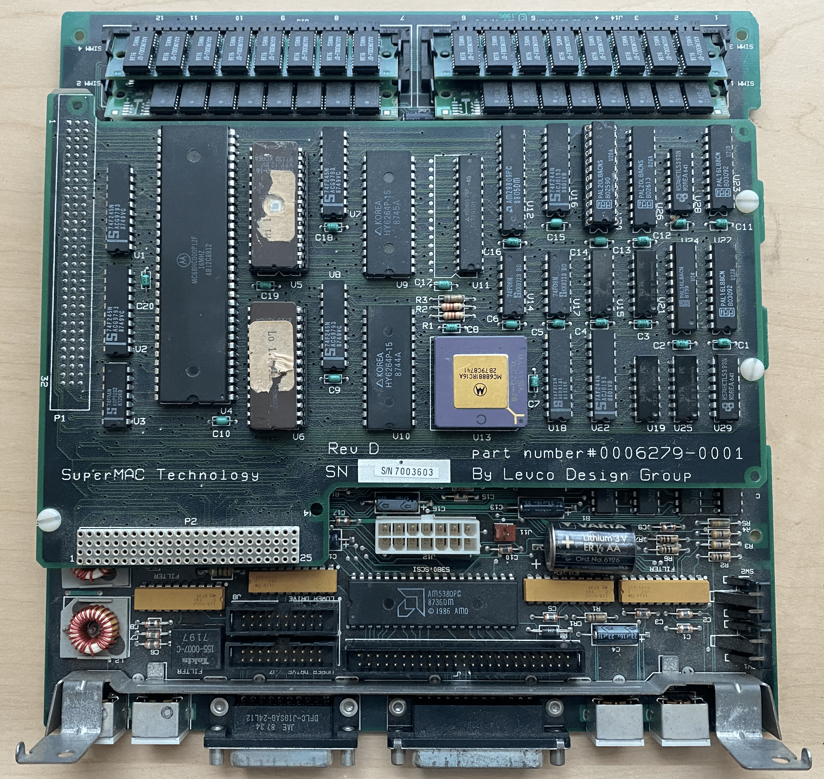

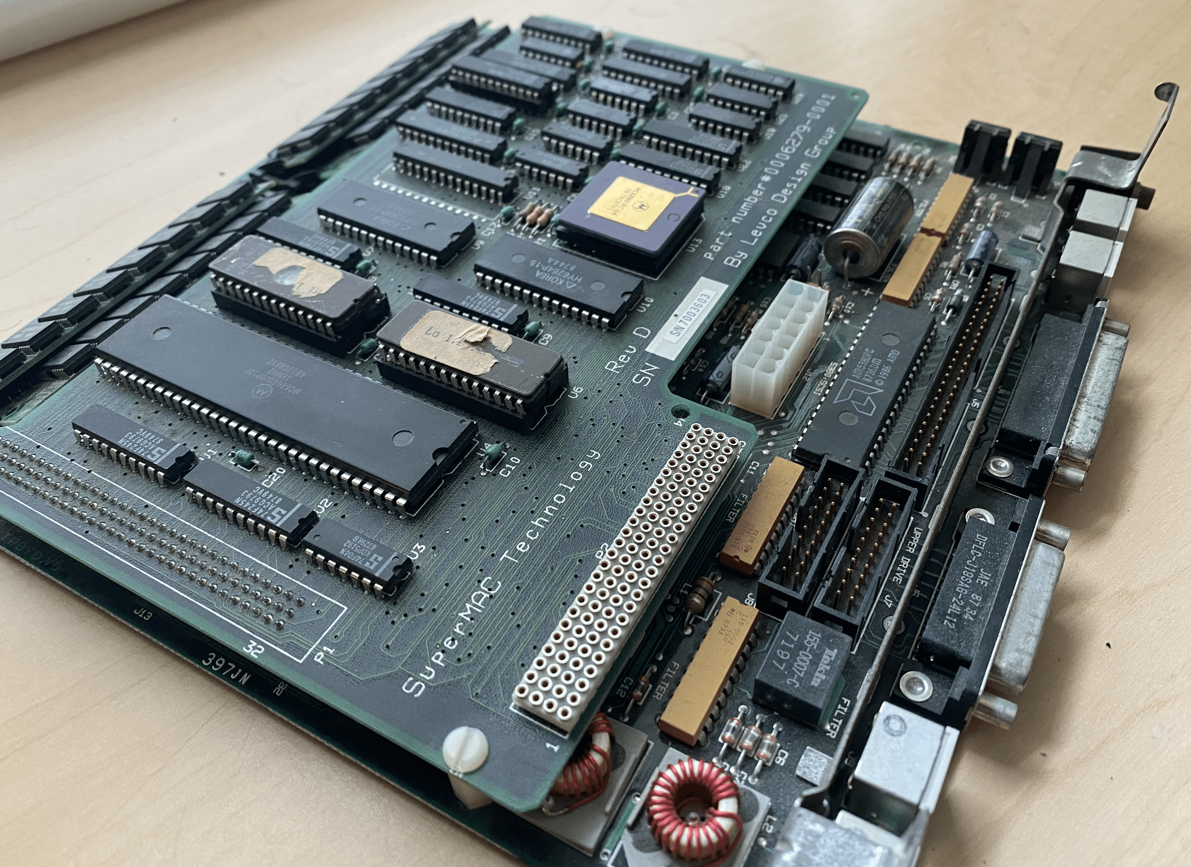

I just picked up a Macintosh SE SuperMac SpeedCard accelerator. This accelerator has a MC68000 clocked at 15.67MHz along with a MC68881 math coprocessor at the same clock speed. Finally it has 16K SRAM cache. I have been interested in getting one of these for quite some time to see just what kind of improvement over a stock SE I would get. I bought this from an eBay seller in Japan. Shipping was only $14 via DHL and was delivered in just 2 days! There were a couple of things that I like about this accelerator. The 16K SRAM Cache, a 68881 math coprocessor and the ability to boot in nomral 68000 mode for compatibility. The accelerator was in excellent condition and installed with no isue. I ran SpeedOMeter 3.23 on System 6.0.8, System 7.0.1 and System 7.1. I used the SuperCard Control Panel v1.7. Overall a 230x increase in CPU, 70% increase in graphics and 440% in SANE math performance is not too shabby. Here is a front and back picture of the accelerator.

What is the P2 connector for? Interesting that the main PDS connector is just the pins!
It's for plugging in an additional expansion card like a video card. I think you could get one specifically for this accelerator from SuperMac. The manual does not go into any detail on it.

Here's a few photos of my SpeedCard installed on my Mac SE motherboard...
(And yes, I did later cover the windowed chips with tape to prevent erasure over time by UV.)

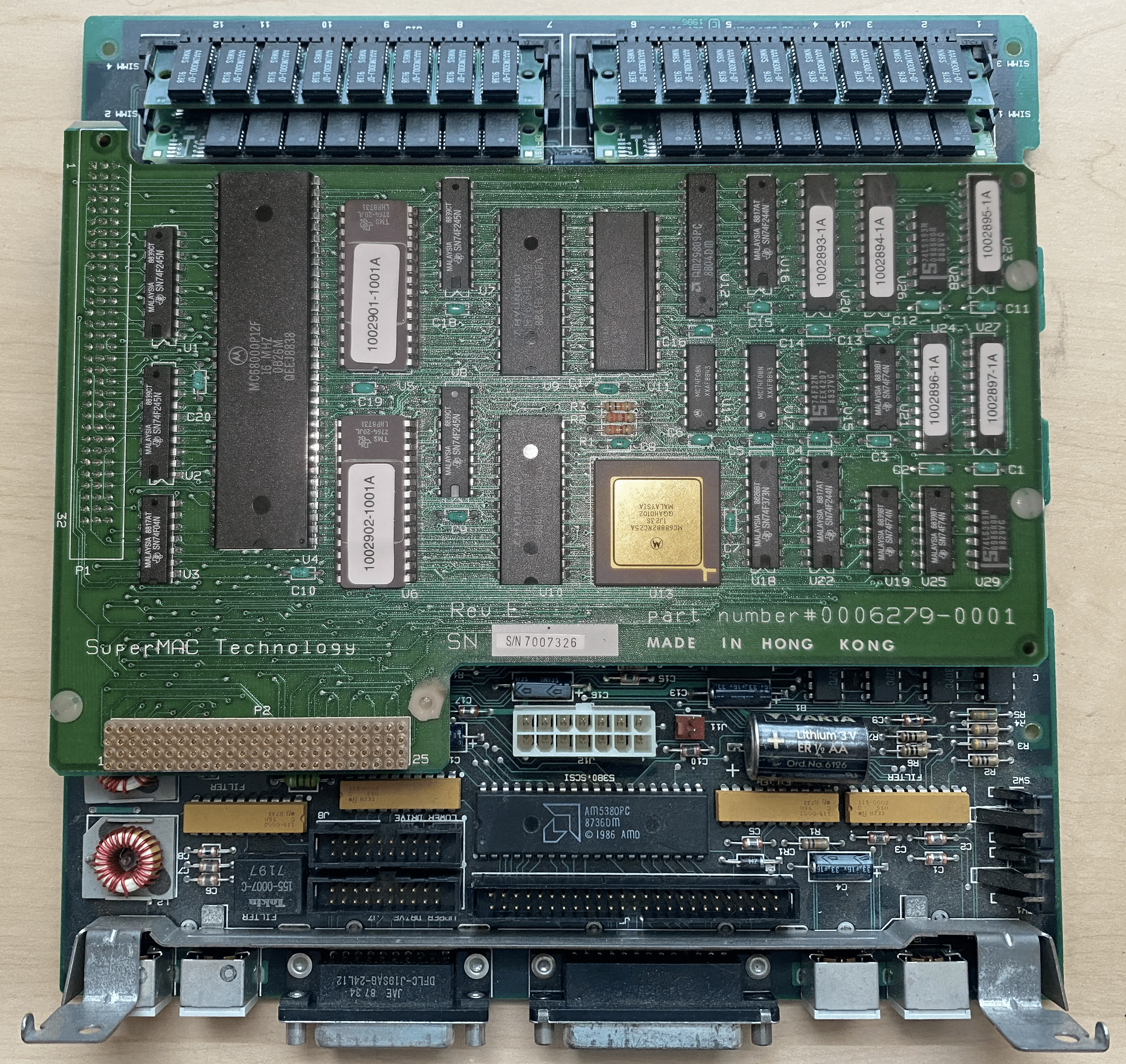

And here's a photo of the SpeedCard owned by forum member @BFEXTU , who was an engineer who once worked for SuperMac:
@BFEXTU was the gentleman who kindly provided me with the v1.7 Control Panel I put on Macintosh Garden, which was never released back in the day.

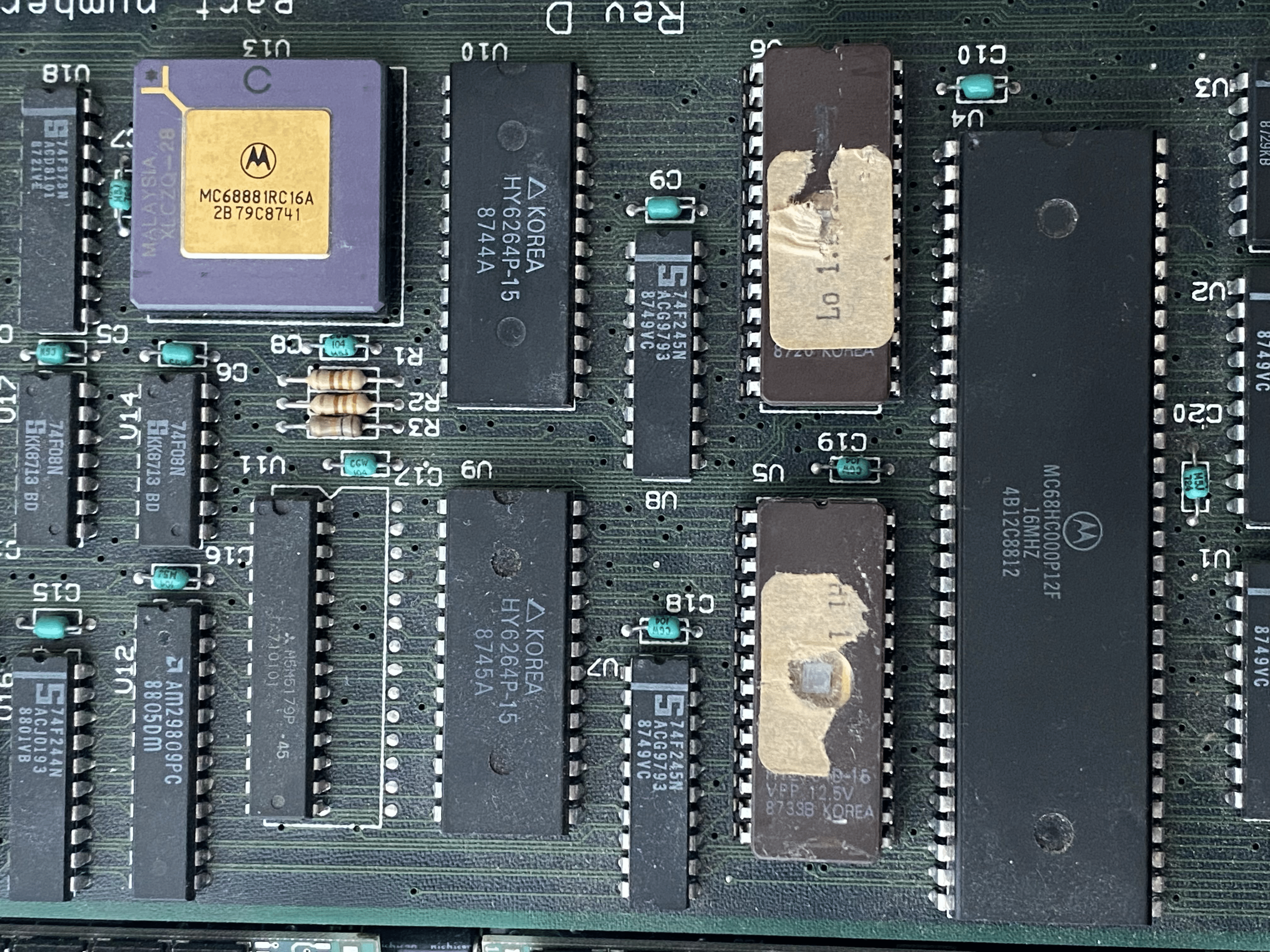

I looked through my parts inventory and found a 40MHz MC68882 math coprocessor. I swapped it out for the 16MHz MC68881 on the accelerator and ran through SpeedOMeter 3.23 under System 7.0.1 (The daily driver OS I run on this Macintosh SE). Here are the results, nothing earth shaking, but the MC68882 is a bit faster. I am also including a picture of the accelerator as installed on Macintosh SE motherboard. I took the crumbling paper off of the two EPROMs and covered them both with electrical tape.
