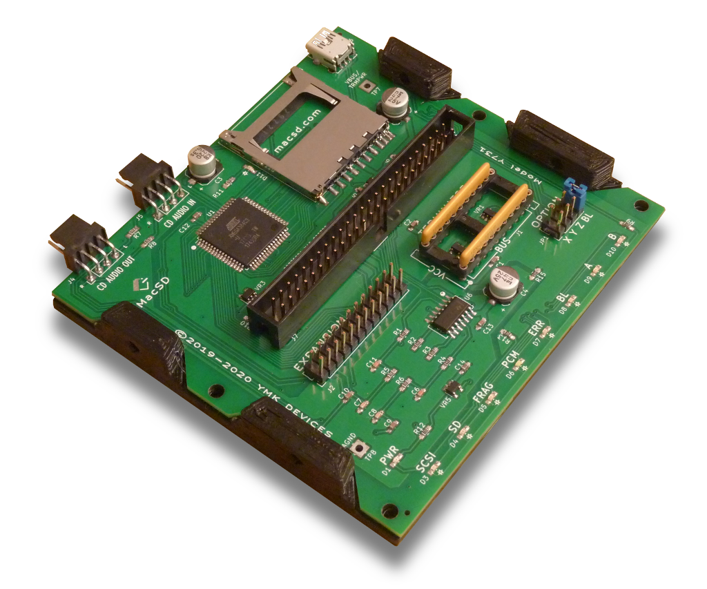

Never used macsd before, did a quick google search and found this picture on their website:
If the scsi connector is placed at the middle of the pcb then no it won't fit in the cc, cc's scsi cable is quite short and is connected to the motherboard edge connector directly so you can't replace it easily. You can get an extension cable though, or just connect it to the scsi cable and let it hang upside down near the cutout for scsi cable, instead of mounting it to the hdd bracket. Or get bluescsi, they fit perfectly fine inside cc

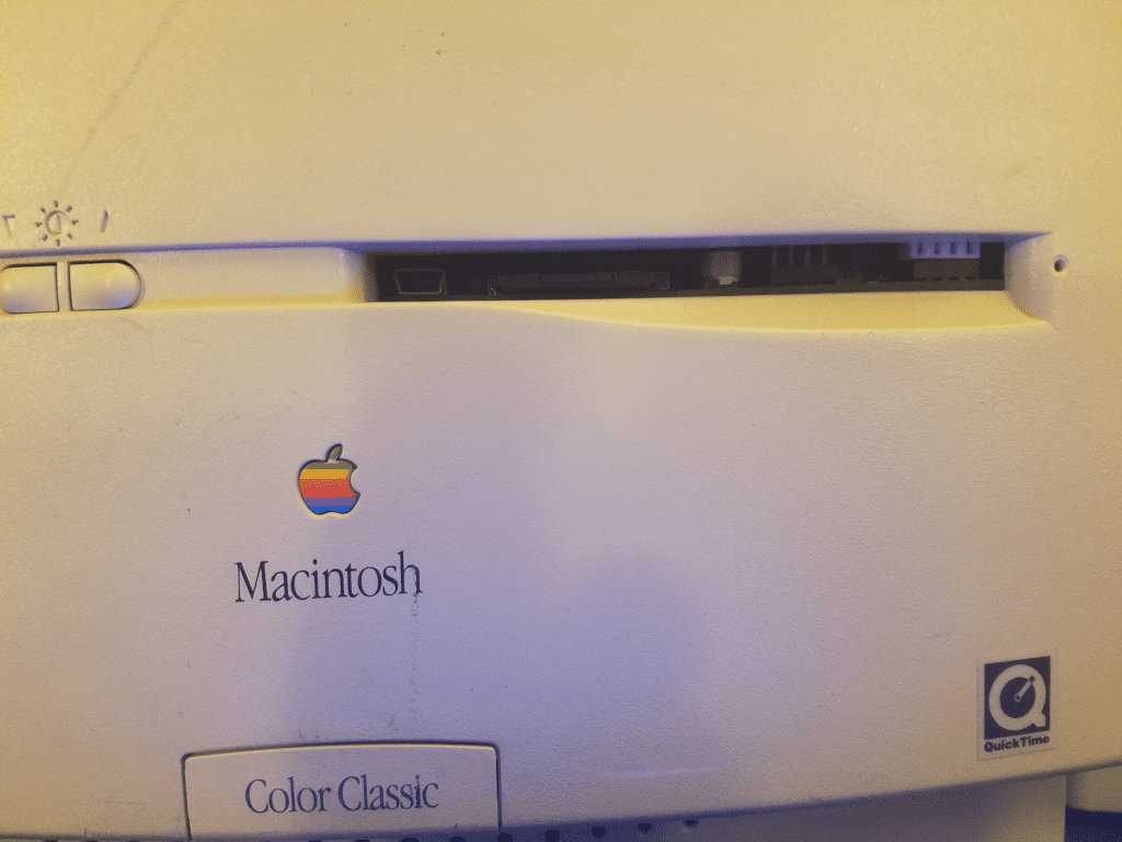

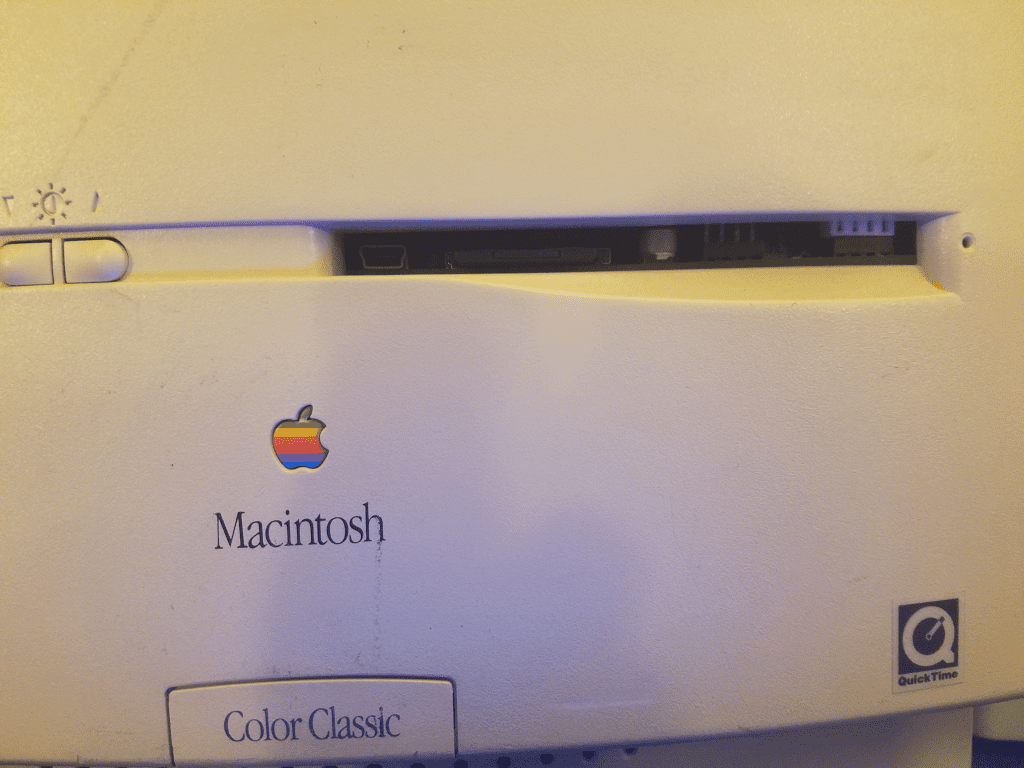

Hi YMK, I now have a MacSD inside my Color Classic Mystic and it boots and works fine. However, it seems to clash when I also add my BlueSCSI external onto the exterior SCSI port. Pretty sure all my SCSI IDs are unique so I guess it's a termination issue. What jumpers did you leave in the MacSD (if any), and do you have any external SCSI devices working along with it? Thanks for any help!
It's very possible, with a bit of work:
