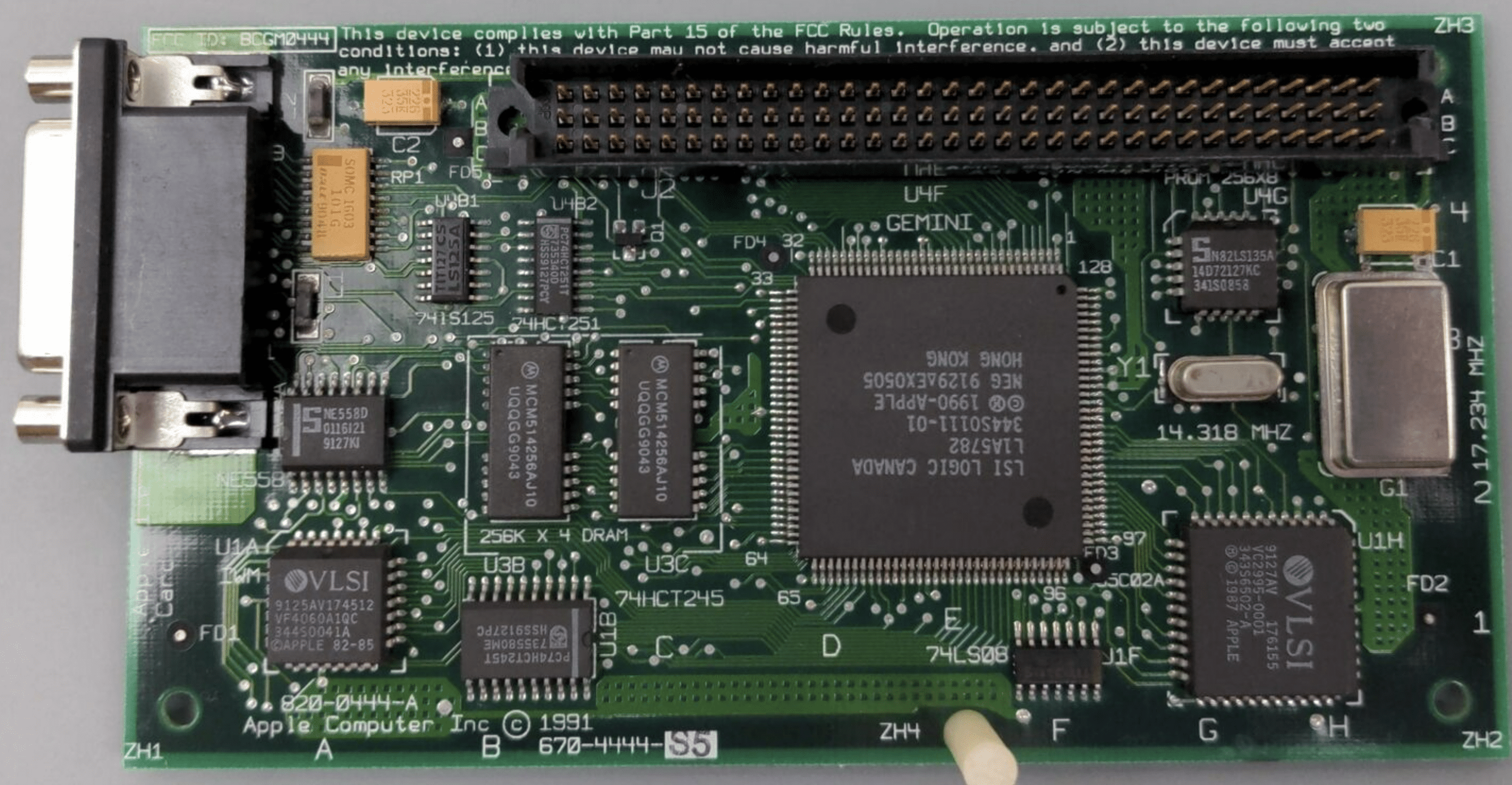

Here is the card:

Here is the card:
I think the goal might be to be able to use this card on Mac OS versions that require 32-bit addressing, and even to be able to use it on PowerPC machines that have an LC PDS slot (like the 6200 series)
