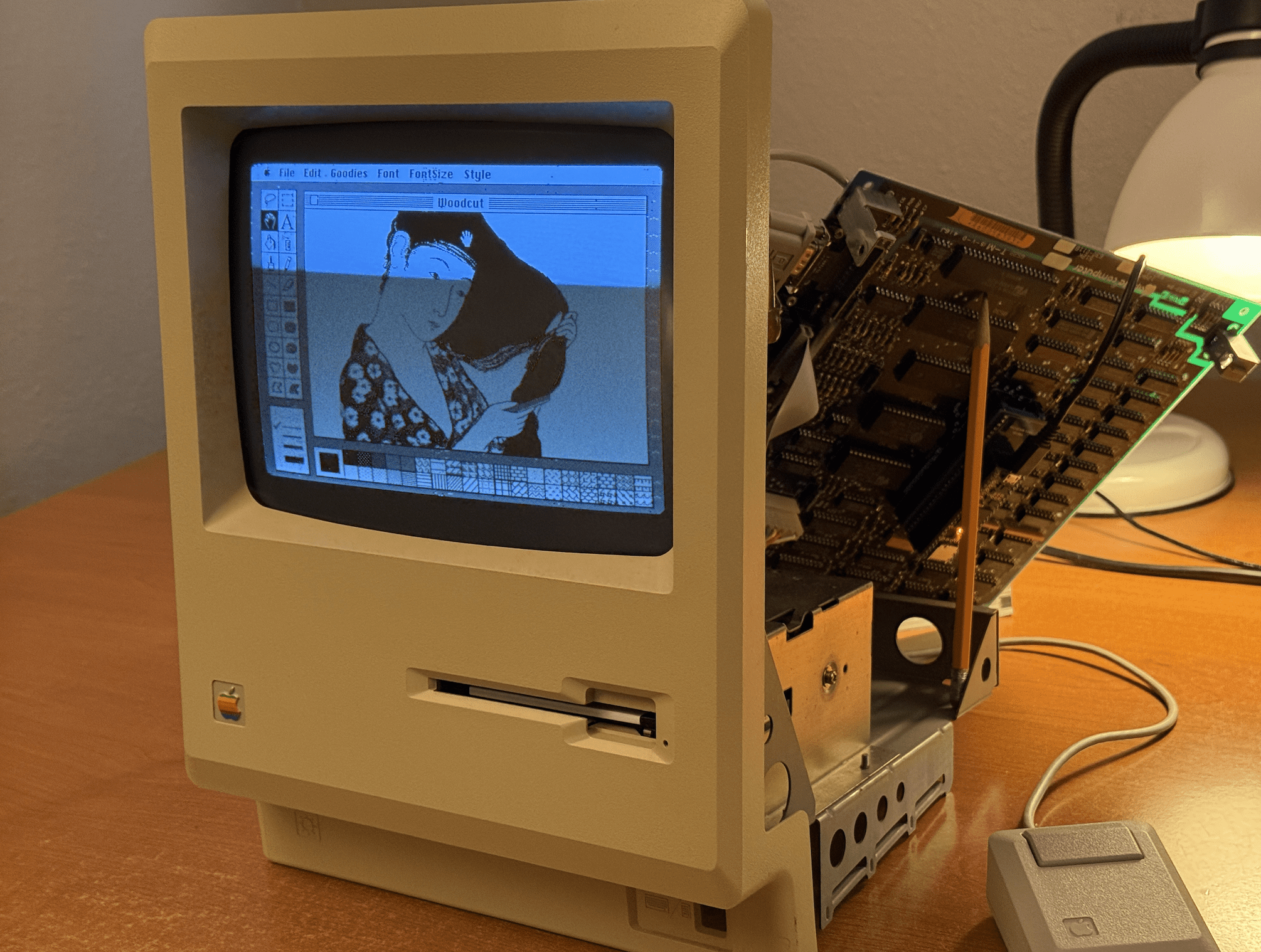

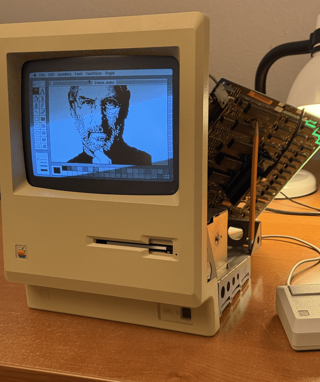

I would like to share my latest project, a Motorola 68000 drop-in emulator called the MCL68+. The CPU emulation is written in C and runs on a Teensy 4.1 micro controller board. I made a small PCB which contains a number of buffers and registers to break out and de-multiplex the Teensy's limited pins to the 68000's 64 pins.
I thought now would be a good time to share my progress in case I never get any further along! 🙂

Update on this project: I fixed the remaining issues with the 68000 opcodes using Tom Harte's test suite and got some pleasant results!
The latest code is uploaded to GitHub: MCL68+GitHub
