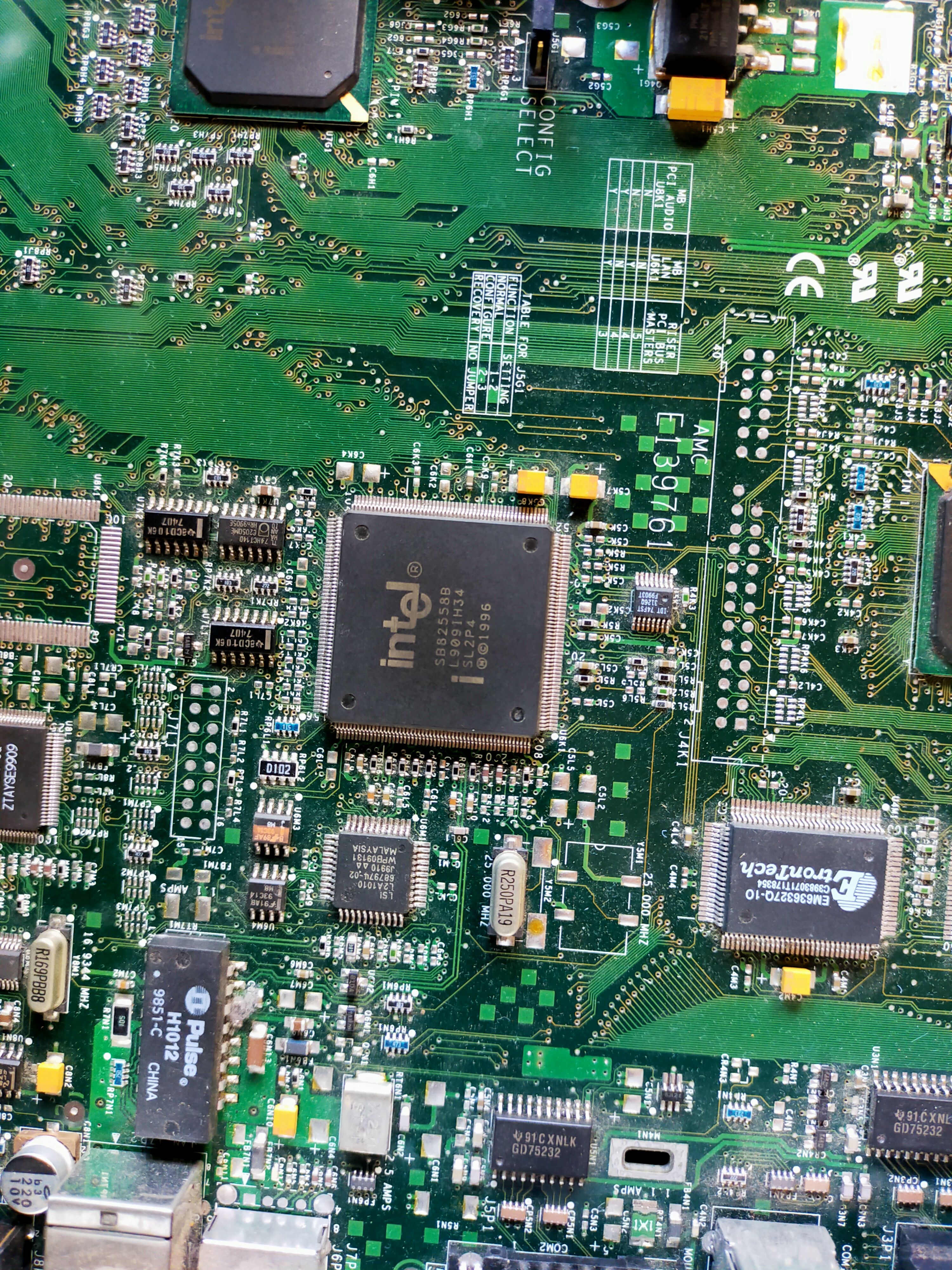

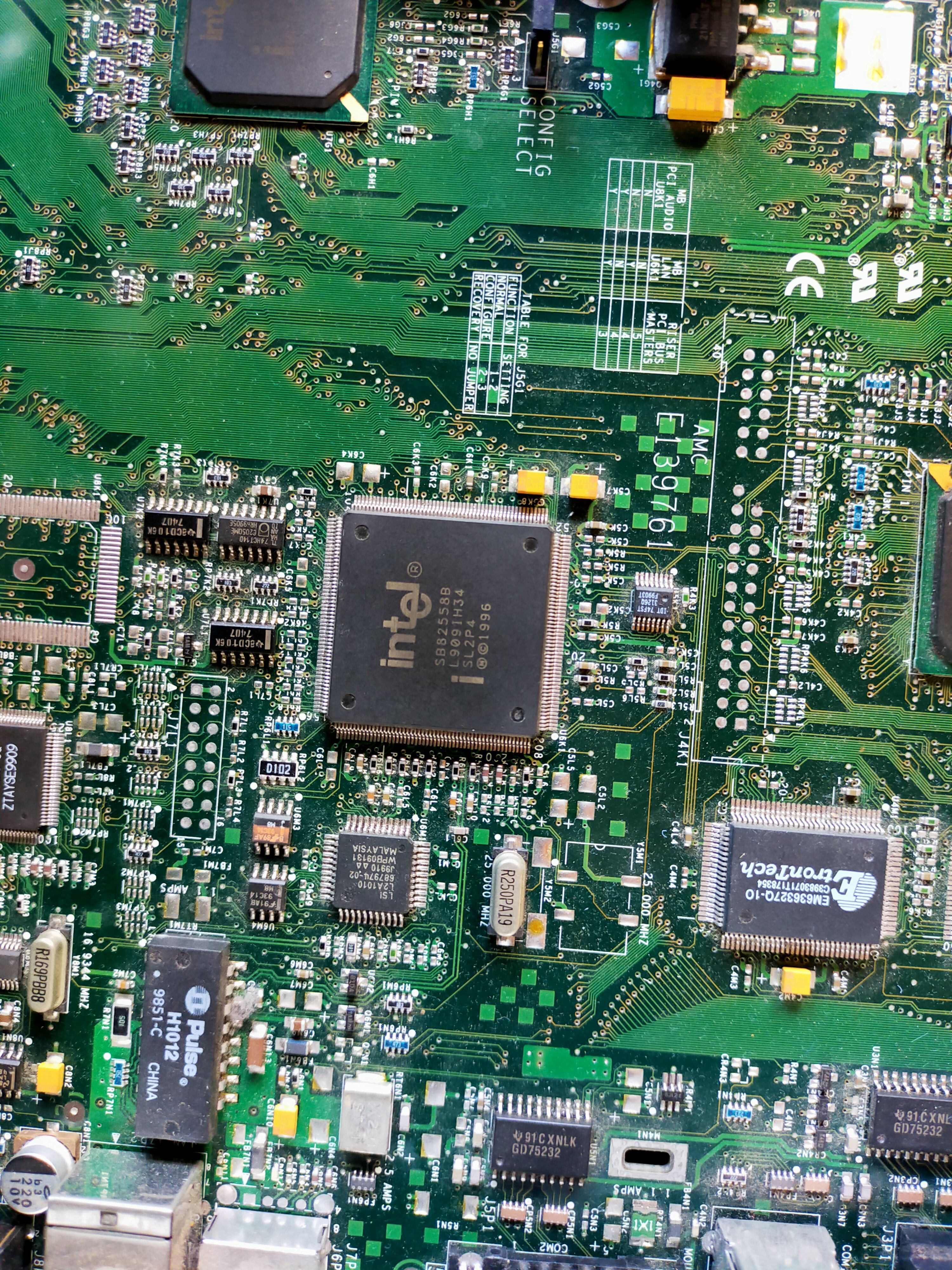

going around the board with my finger revealed the Intel NIC chip (an Intel SB82558B L9091H34 SL2P4) was getting EXTREMELY hot, no matter if the PC was turned on and running or in standby mode. it was HOT until you removed the Power completely, the Power LED also flashes for a second and goes out again after the system is turned on,
this leads me here, what can i do with this system? is it safe to completely remove the Chip? does the PC need it to POST? where can i find a replacement chip?

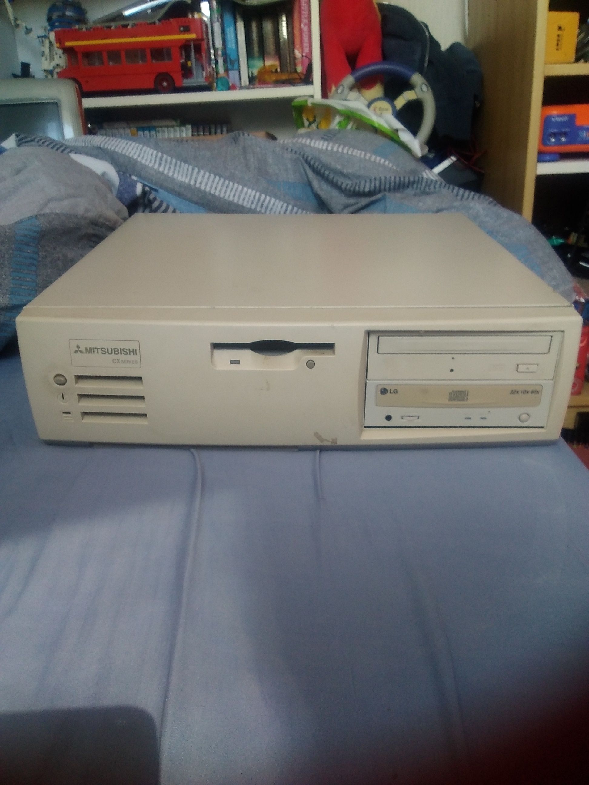

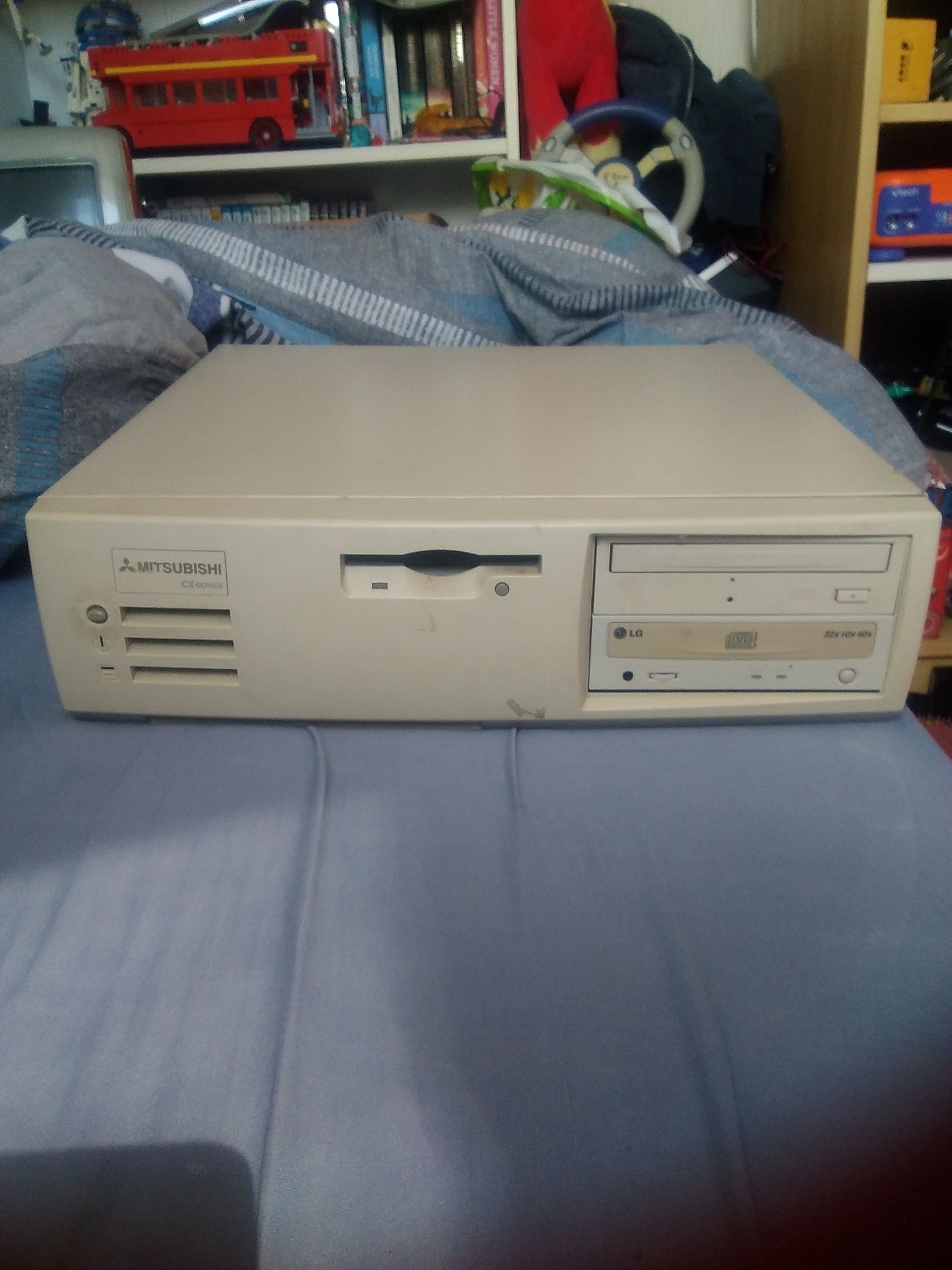

attached is photographs of the computer, the NIC chip and the shorted cap in question.
i do hope i can fix this machine as its very sentimental.View attachment 4808View attachment 4810
Hi there! If you're after a replacement chip - UTSource carry these in stock for $30 each
You can probably remove the chip and lose the LAN functionality - just needs to be removed carefully, with hot air.
