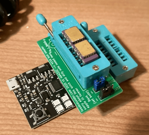

To test the memory, I used a 4116 tester from eBay and a little adapter board that I whipped up; you test the MK4332 as "one 4116," then flip the switch and test it as the "other 4116." If either fails, you know that half of the 4332 is bad.
It's terrible, and it barely fits in the socket, and switching banks is annoying, but it worked.

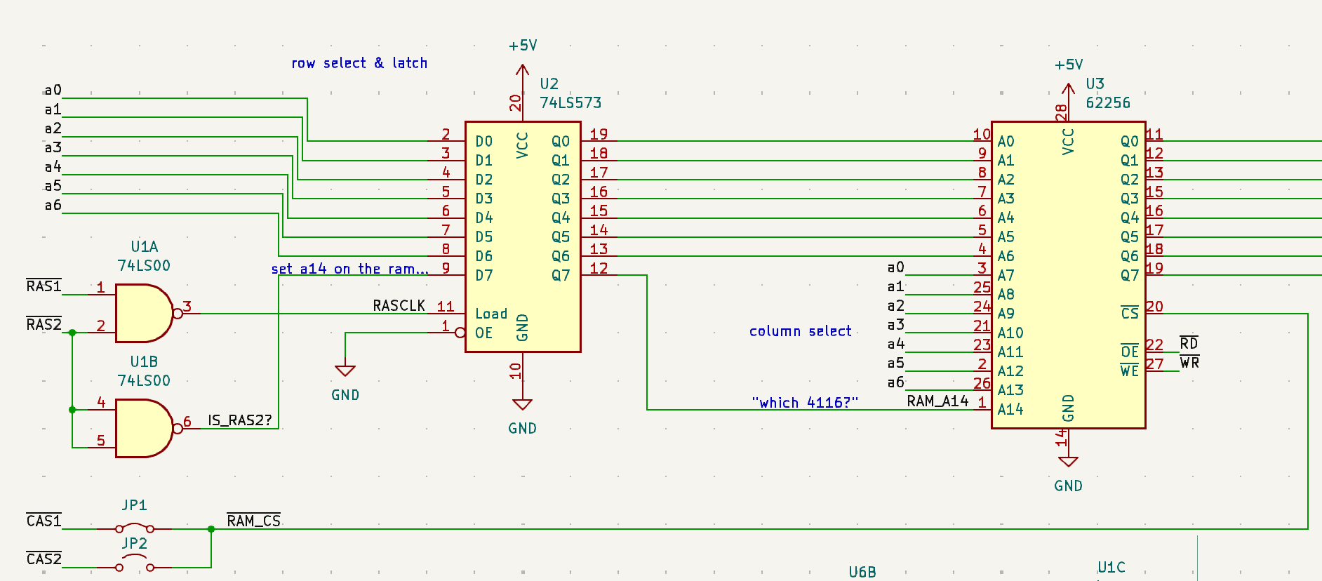

I built this module that latches in the row address using a '573 (when RAS is asserted) and then chip-selects the entire mess when CAS is asserted. To test this, I used Logisim Evolution. It seemed to work there, although I am fully willing to admit I don't know what I am doing in it.

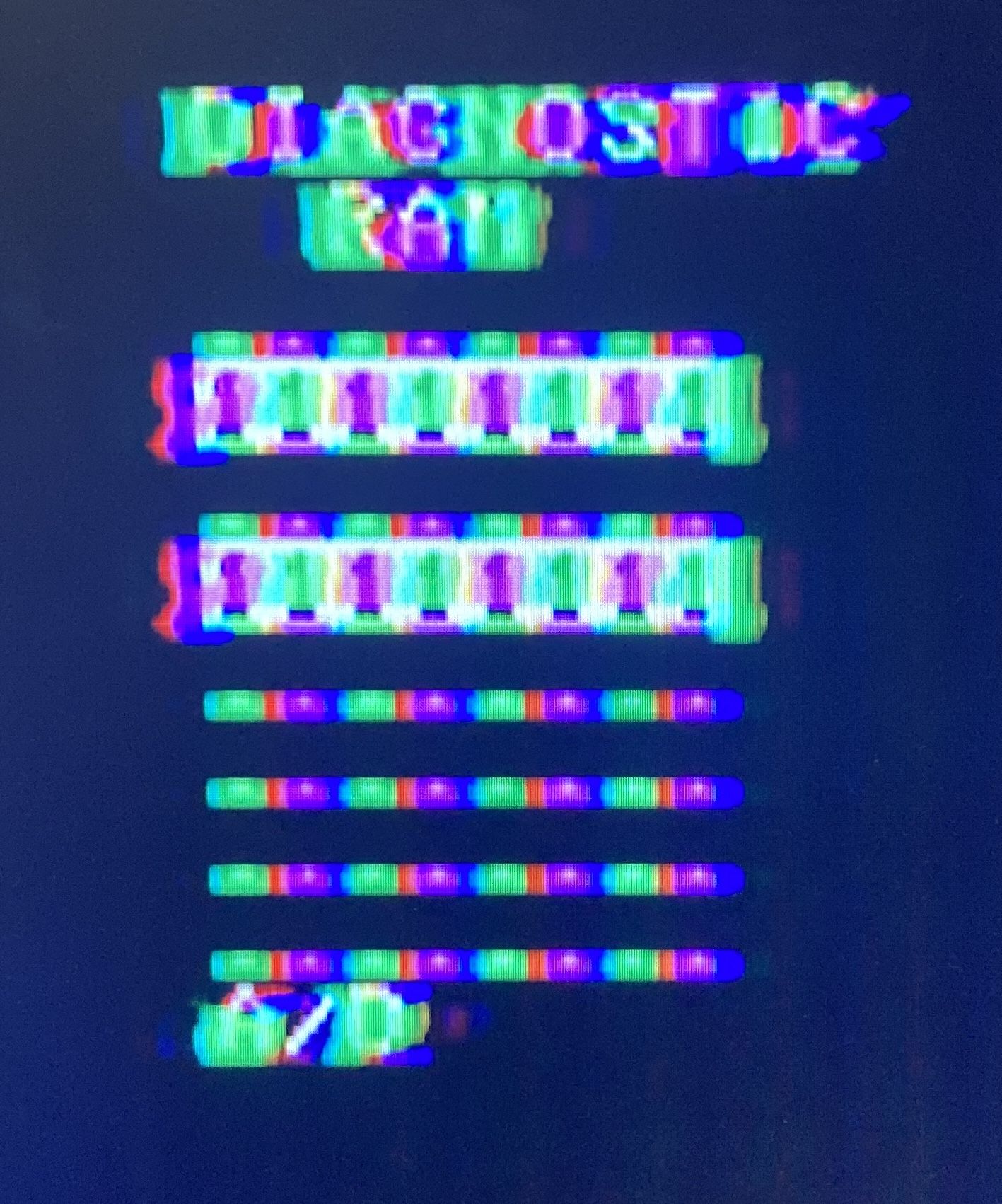

At the moment, I have just now run this sucker in my Apple III, and I've had mixed success.

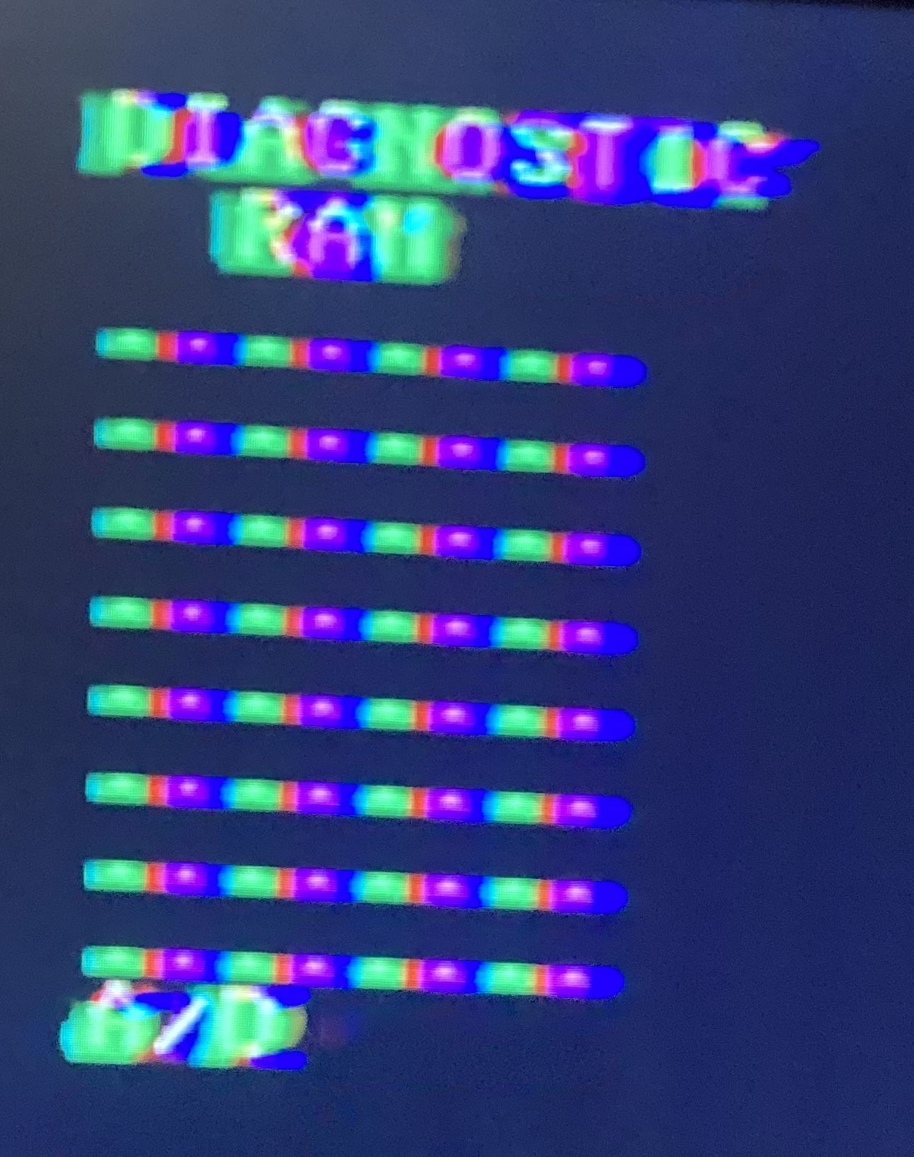

The initial "Diagnostic RAM" screen seems to be very happy about it (showing "all good,") but then the system quickly moves to a scrambled video screen and back to a "Diagnostic RAM" screen showing that all of the chips covered by this module are now "bad."
Please ignore the "A/D" complaint; that popped up at some point recently and I've not bothered to look into it because I'm not using a joystick or other analogue device yet. I suspect a socket has bonked out or something is just making bad contact. We'll cross that bridge in a future thread.

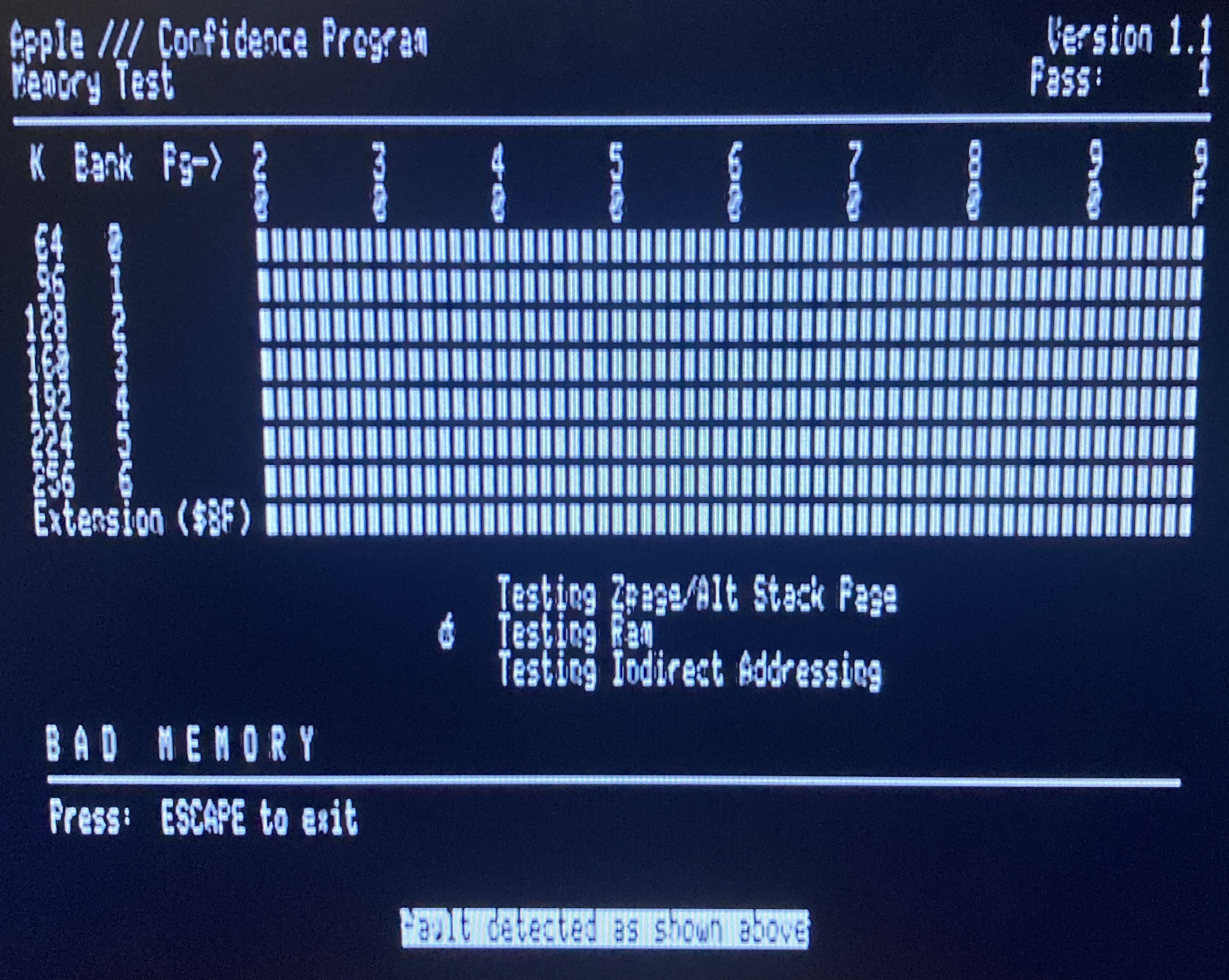

Similarly, the Confidence Program's RAM tester rejects the entire thing as "BAD MEMORY" almost immediately, without giving me any useful information.

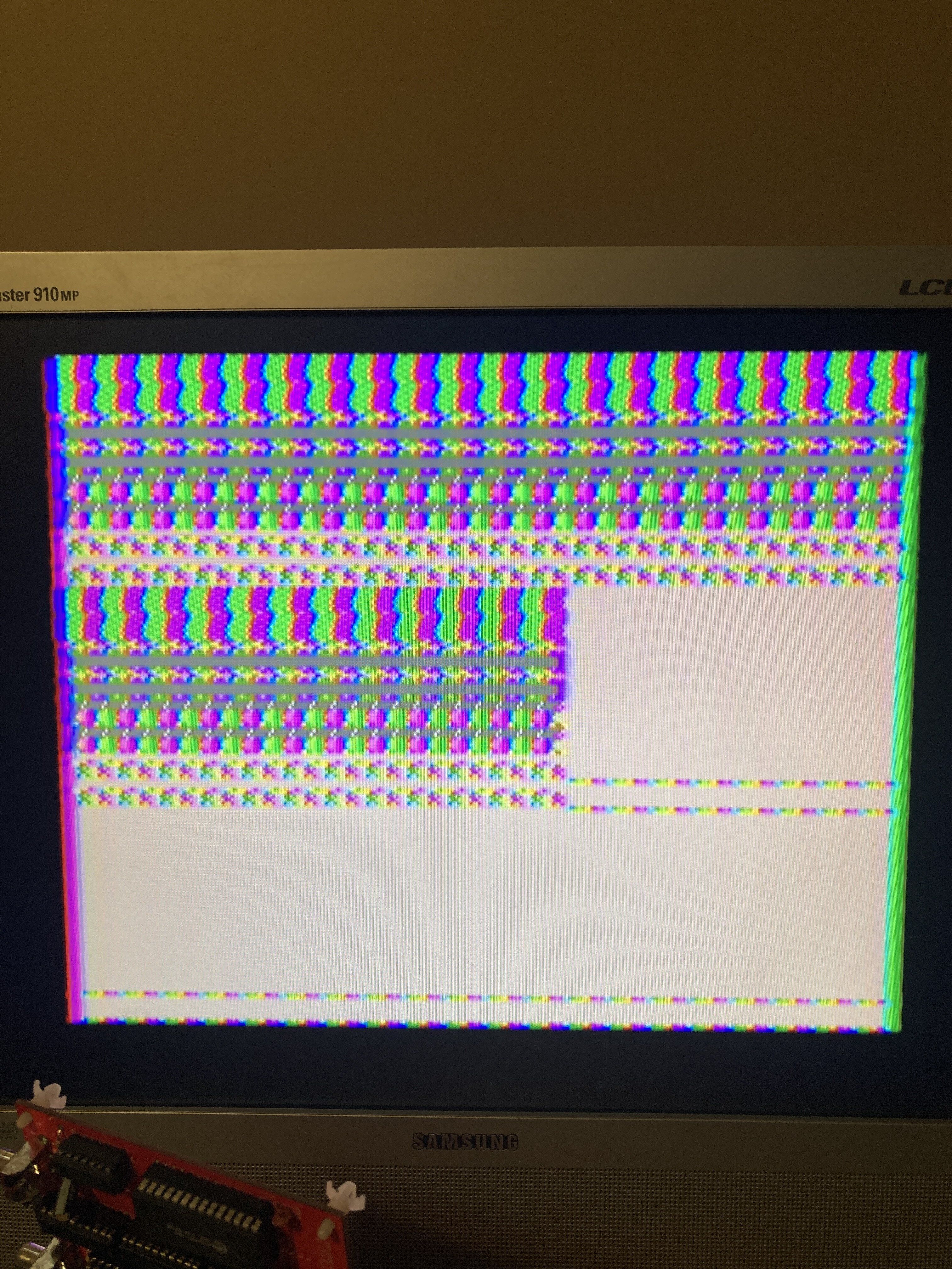

Obviously, the high-rez video modes don't display properly, whereas before they were just really ugly with missing tiles.
Based on this behaviour, I am suspecting that I've screwed up the latching somehow and things "sort of work" the first time, but don't reset properly, and subsequent tests over the same cell then fail.

I don't have a lot of time to debug this for at least the next week or so, but it would be nice if someone who understands DRAM addressing a little better would give me a schematic review (you can see the PDF attached below) and see if I simply did something stupid.

I had a couple minutes to do some more testing.
Without this block of ram installed, the Confidence Test video is just a blank picture, so clearly something is happening in this mod board.
The tiles that do get through almost seem to be a chopped up version of the Apple III it's trying to display, so I suspect this is an addressing fault on my part. I've got no answer for the giant empty rectangle part.
Unfortunately, now that I've removed and reseated it, the startup RAM diagnostic seems to always fail on 2 & 4, not just on cold starts. That's actually a bit reassuring.
Edit: A friend looked over the schematic and suspects it's because I used a 573 instead of a 574: since RAS and CAS are both asserted, a transparent latch will continue to update the "RAS address" when CAS is triggered. Oops. I've ordered a 574 and I will be getting really creative with the hot air later.
