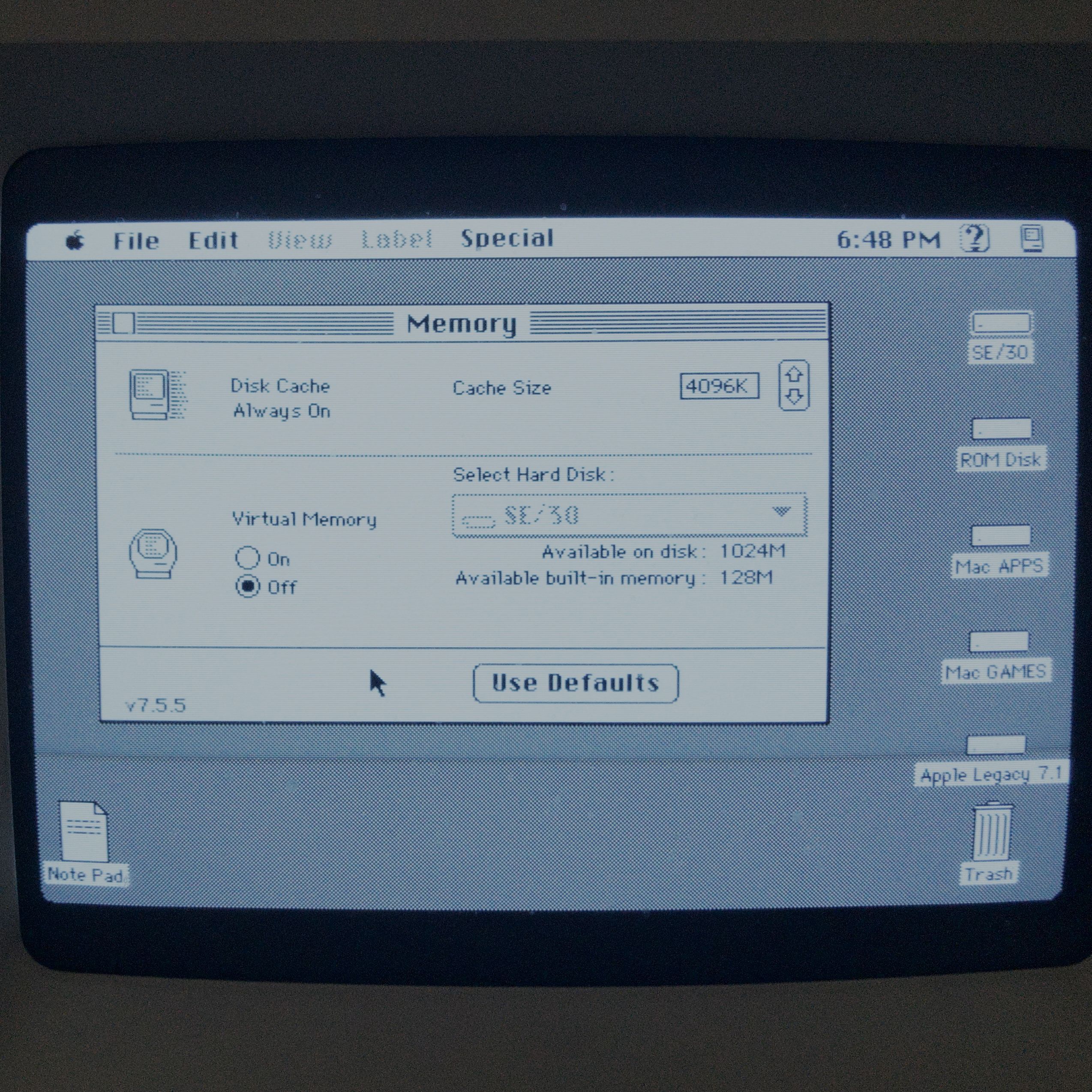

A footnote to this: System 7.5.3 and 7.5.5 have MODE32 builtin. No need to install anything .. just enable 32-bit addressing in the Memory control panel and your dirty old SE/30 will happily see more than 8MB.
I use 7.5.5 on my SE/30 with 16MB (4*4MB in bank A).
I updated to 7.5.5 on my SE/30 but do not see 32-bit addressing in the Memory control panel. Can you clarify?

Yep, my mistake. MODE32 must be installed on 7.5.3/7.5.5.
When Apple licensed it from Connectix in 1994, they announced that a future release of MacOS would have it built-in. Never happened.
Yeah, MODE32 7.5 version should be installed for System 7.5 through 7.5.5, not the earlier version of MODE32.
