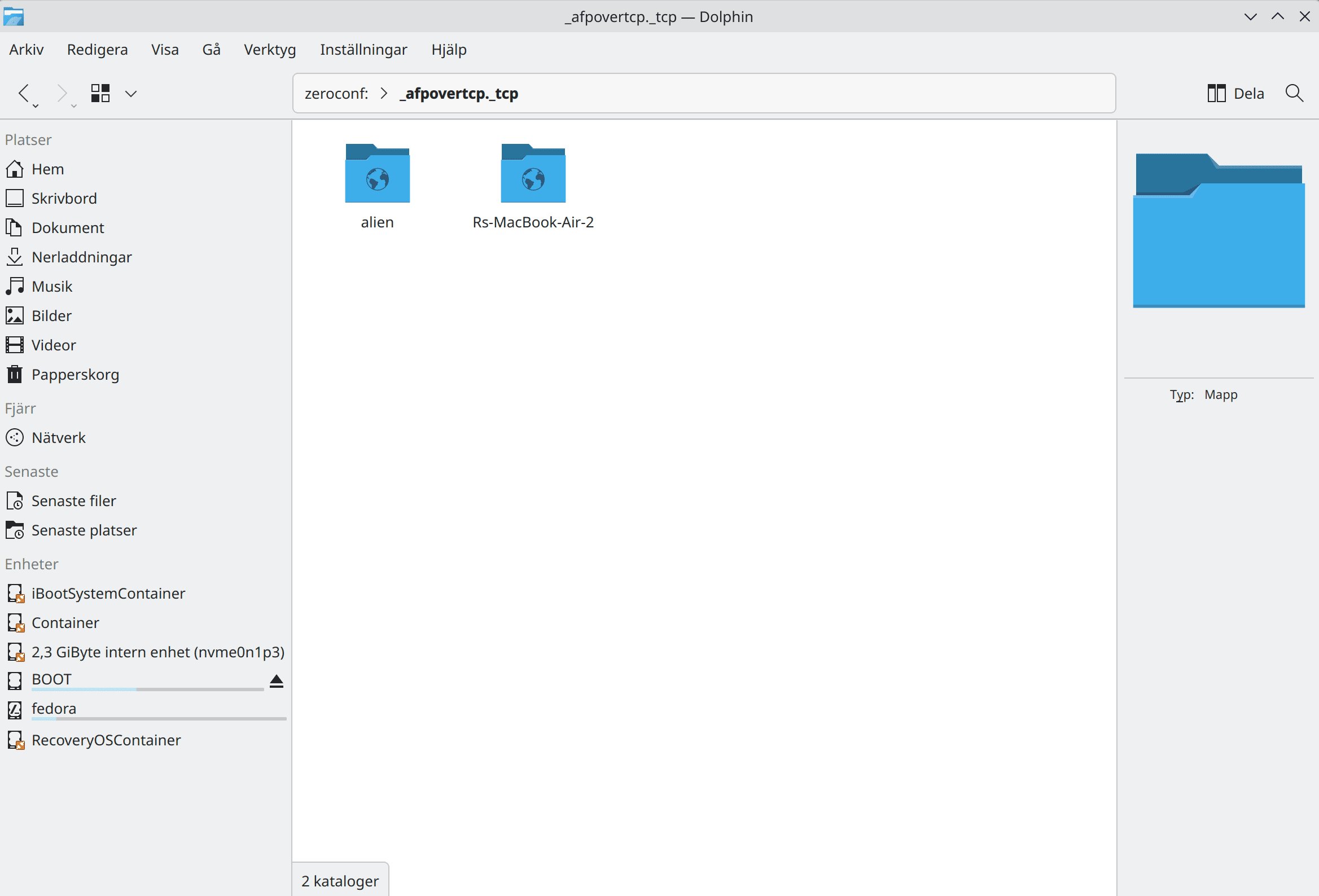

After two months of intense coding and testing, I am proud to present a much-improved afpfs-ng v0.9.4, and a brand new kio-afp KIO Worker for the AFP protocol. And to make the software suite complete, I am also proposing a modification to the kio-zeroconf component to make it sensitive to AFP-over-TCP Zeroconf services.
To demonstrate, here is AFP servers listed by Dolphin using the modified kio-zeroconf:

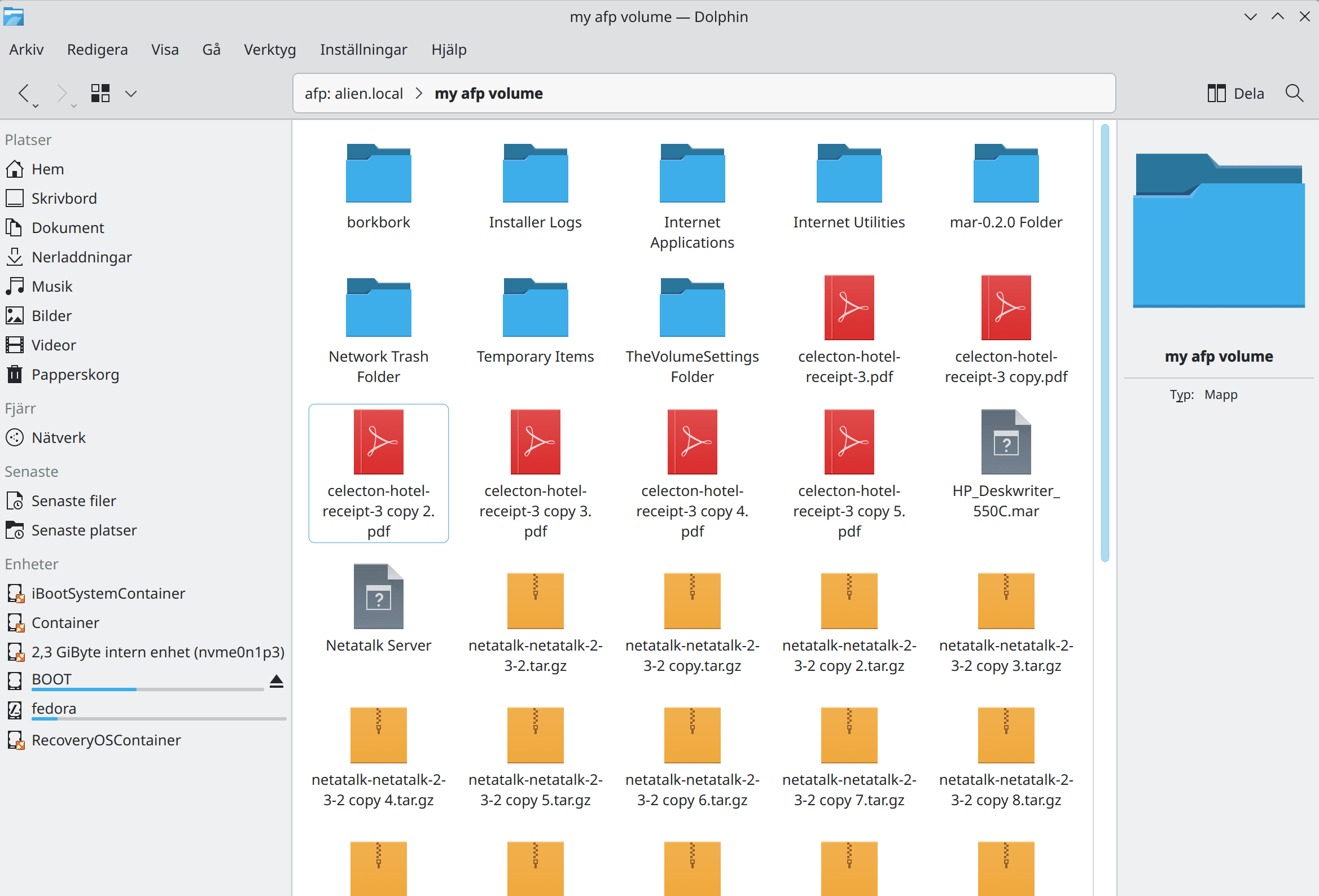

And after authenticating with a server and opening a shared volume:
