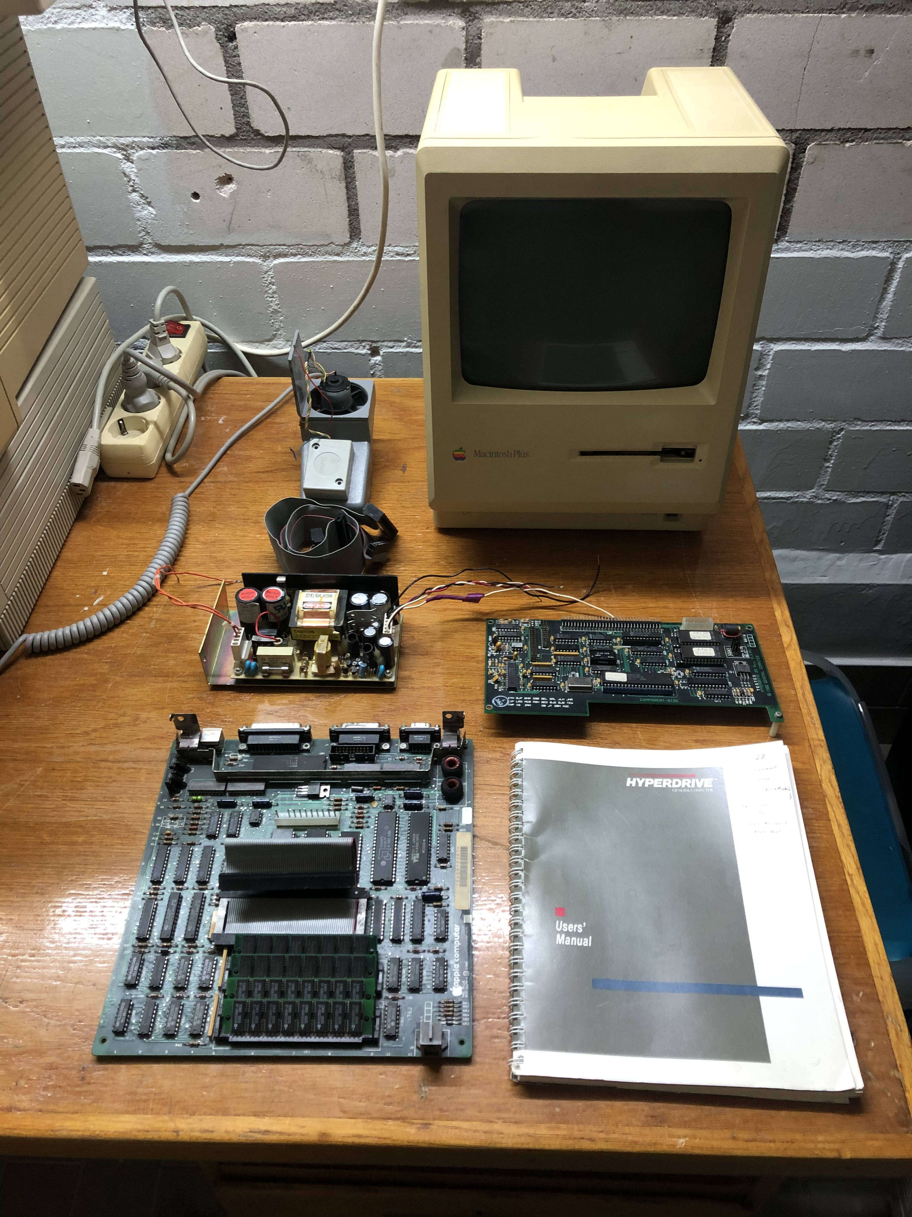

Back in the nineties, I had a Mac Plus with a Hyperdrive 20 system installed. Initially it was a Mac Plus from the printing company where I started working in 1990 after finishing the school for graphics/printing in Utrecht (The Netherlands). Around 1993 I was able to sell it from the company I still work for and it became my second Mac alongside my LC-III. I upgraded the RAM to 4Mb, bought a nice blue carrying bag and later I replaced the Miniscribe HD for a better one. The old one I still have. The last thing I did was converting a stock System 6.0.7 NL into a version that could work with the Hyperdrive internals. With ResEdit I put all the resourses that has to do with Hyperdrive into a stock System file and so I created a more stable system than the System 3.2 that came with the Hyperdrive 20.
I had it for about 2 more years untill a colleague ask me if he could borrow it for a friend who needed a computer for a while. At first I didn't want to do that, but after some insistence from my colleague I lent it, assuming that I could trust this colleague. But the story ended sad: it never came back... (but I still know the serial number of the Mac Plus).
A few months ago I found Hyperdrive 20 parts on eBay, just what I needed to recreate the Mac I ever had. On a local online marketplace I was able to find a cheap Mac Plus logic board and last week I also bought a Mac Plus without keyboard and mouse (it worked fine after some care and cleaning and the keyboard+mouse of my Mac 512Ke).
What I have so far:
- Mac Plus with 4Mb RAM
- extra Mac Plus LB, also with 4Mb RAM
- Hyperdrive 20 board: [HYPERDRIVE 20 Rev. 2.0 PII-M1 8616] from 1986
- the CPU clip/bracket
- the Hyperdrive PSU
- The fan+controller box
- Miniscribe 8425 20 Mb drive
- PDF Hyperdrive 10,20 Installation
- PDF Hyperdrive 10 manual
- PDF/Paper Hyperdrive User Manual
- The original Hyperdrive system floppies
- a System 6.0.7 NL for Hyperdrive 20 on 5 floppies (and disk images)
Still missing:
- EMI filter for the fan
- hard drive bracket
- different line filters
- 3 spacers for the Hyperdrive 20 board
- the Hyperdrive 20 badge
What I did so far:

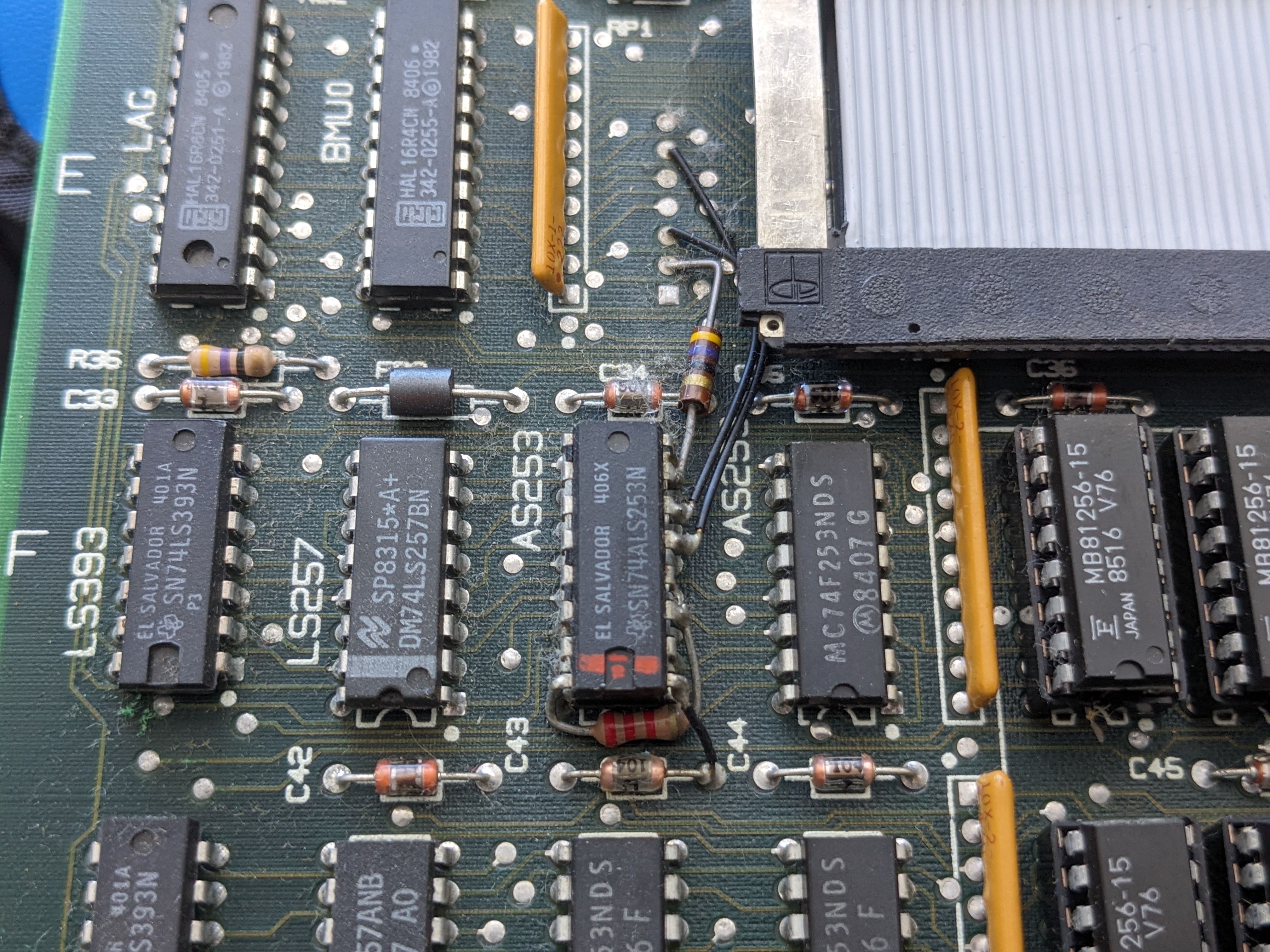

I mounted the clip/bracket over the CPU of the extra Mac Plus LB. I measured all the lines from under the LB to the end of the flatcable and every line is connected. For the PSU, I established that it is in the 220V-setting.
What I still need to do:
Testing and maybe recapping the PSU and rewire the outcomming cables because the are all cut off. Also finding out where I can tap the 220V-power on the analog board of the plus.

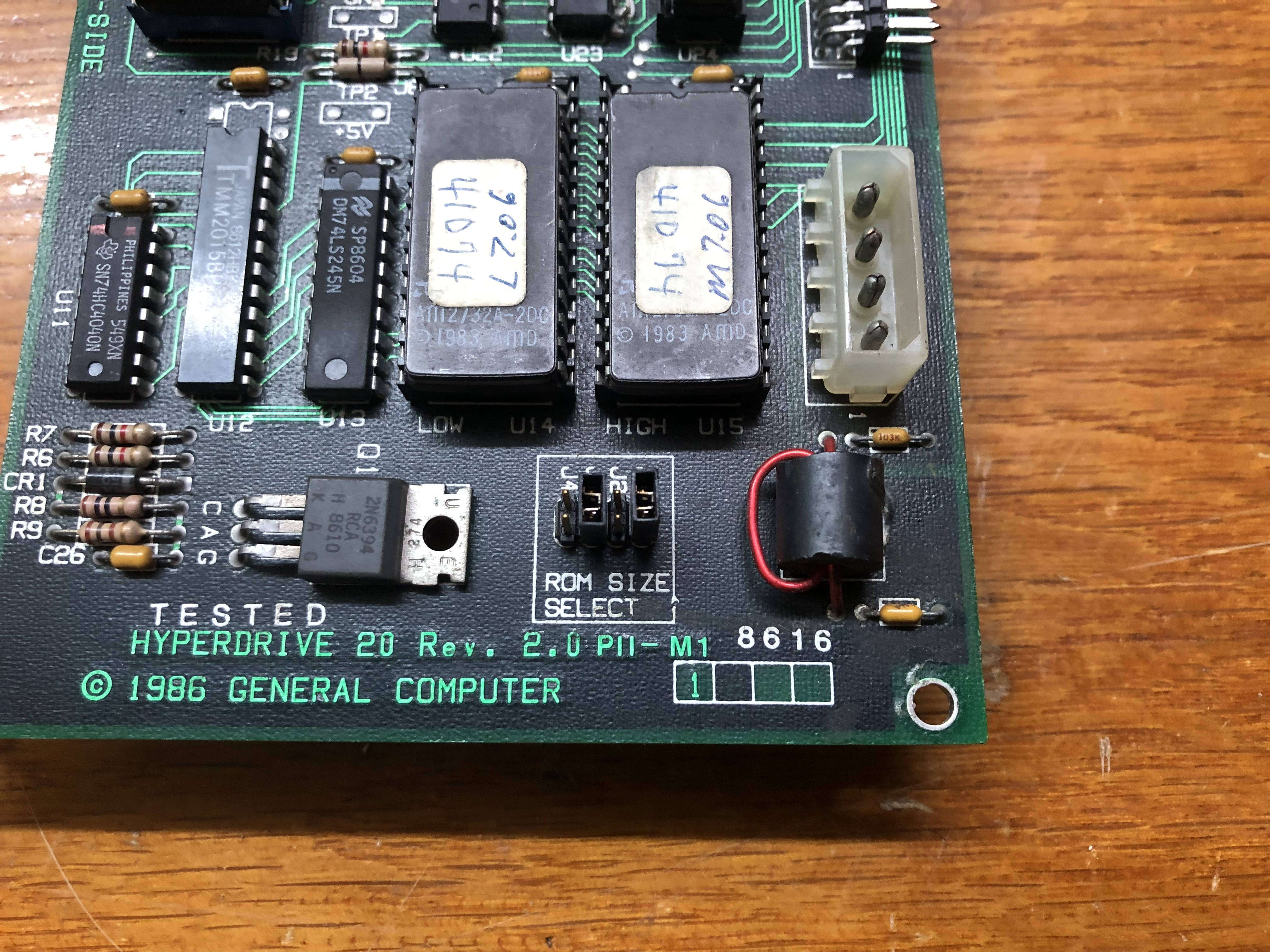

Finding out the jumper setting of the [Rom Size Select] on the Hyperdrive 20 board. The seller told me these parts came with a Mac 512K when he bought it and I don't know if the current settings are right. Non of the manuals I have seen so far mentioned these jumper settings. If I couldn't find info, it will be just a matter of trail-and-error.
Finding spacers, the EMI filter and line filters would not be problem, although I am not an electronics guy.
A big challenge will be finding or making a hard drive bracket.
And for the finishing touch I need to find a Hyperdrive 20 badge, but I assume they are just as rare as other Hyperdrive parts.
If anybody has info about the Hyperdrive 20, the parts or has something for sale, let me know. This is a project that takes some time (I am not in a hurry), also due to other ongoing mac projects I work on.

Of course, you and I have been talking about those mysterious jumpers privately for a while, and I am truly and utterly bummed that "olepigeon" over at the 68kMLA hasn't responded to my PM about it. I sent that PM to him on June 5th, and today is the 13th. He has the documentation for that model, and it would only take seconds to have a peek. @dougg3 , would you happen to know of another way to get in touch with OlePigeon?
UPDATE: I found OlePigeon has accounts on AppleFritter, Reddit and the VCF Forum. So I contacted him there too. Sometimes persistence pays off. We shall see. I do hope I can get him to scan his manual because that version (which covers jumpers) is no where to be found on the internet!

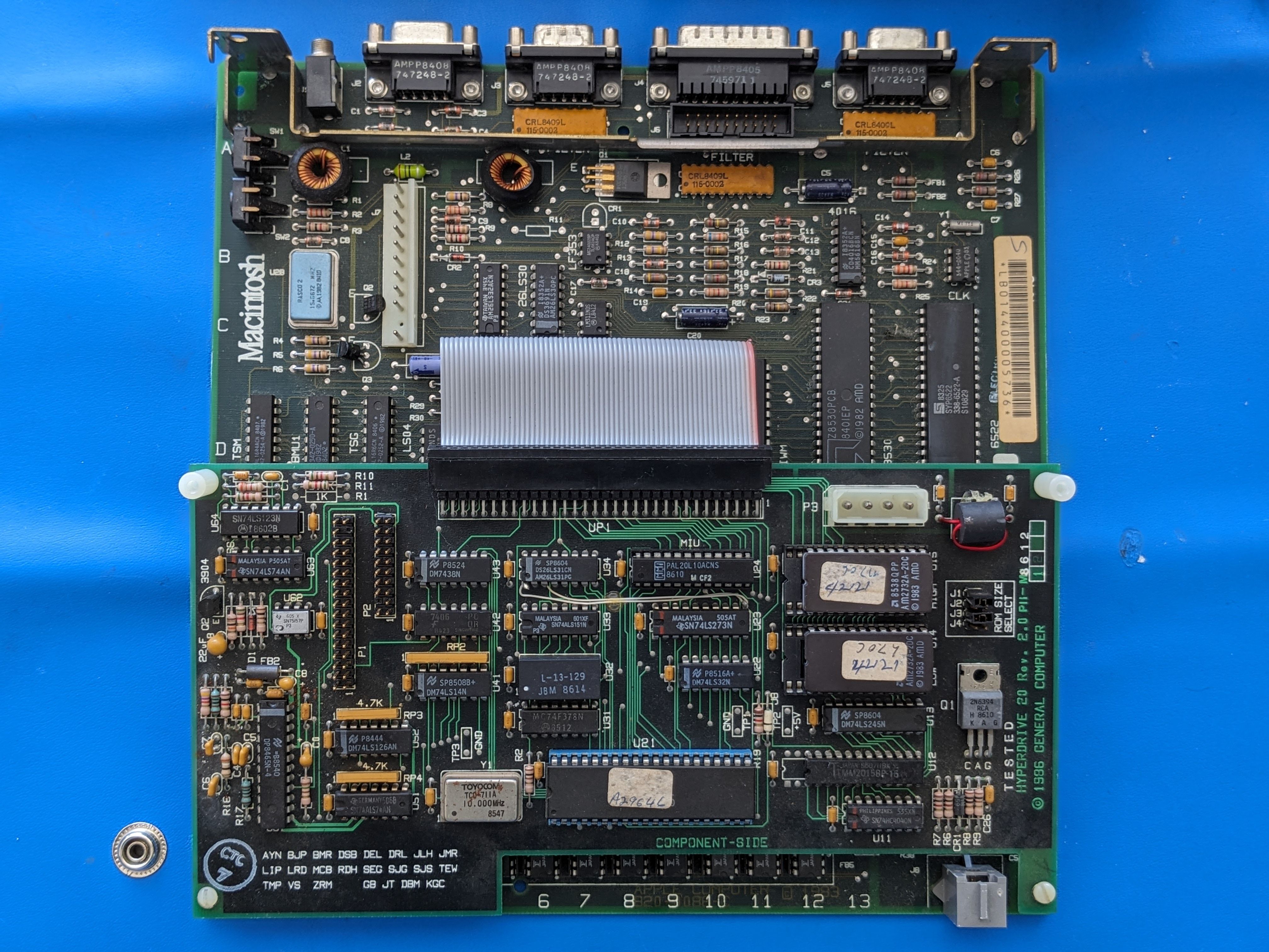

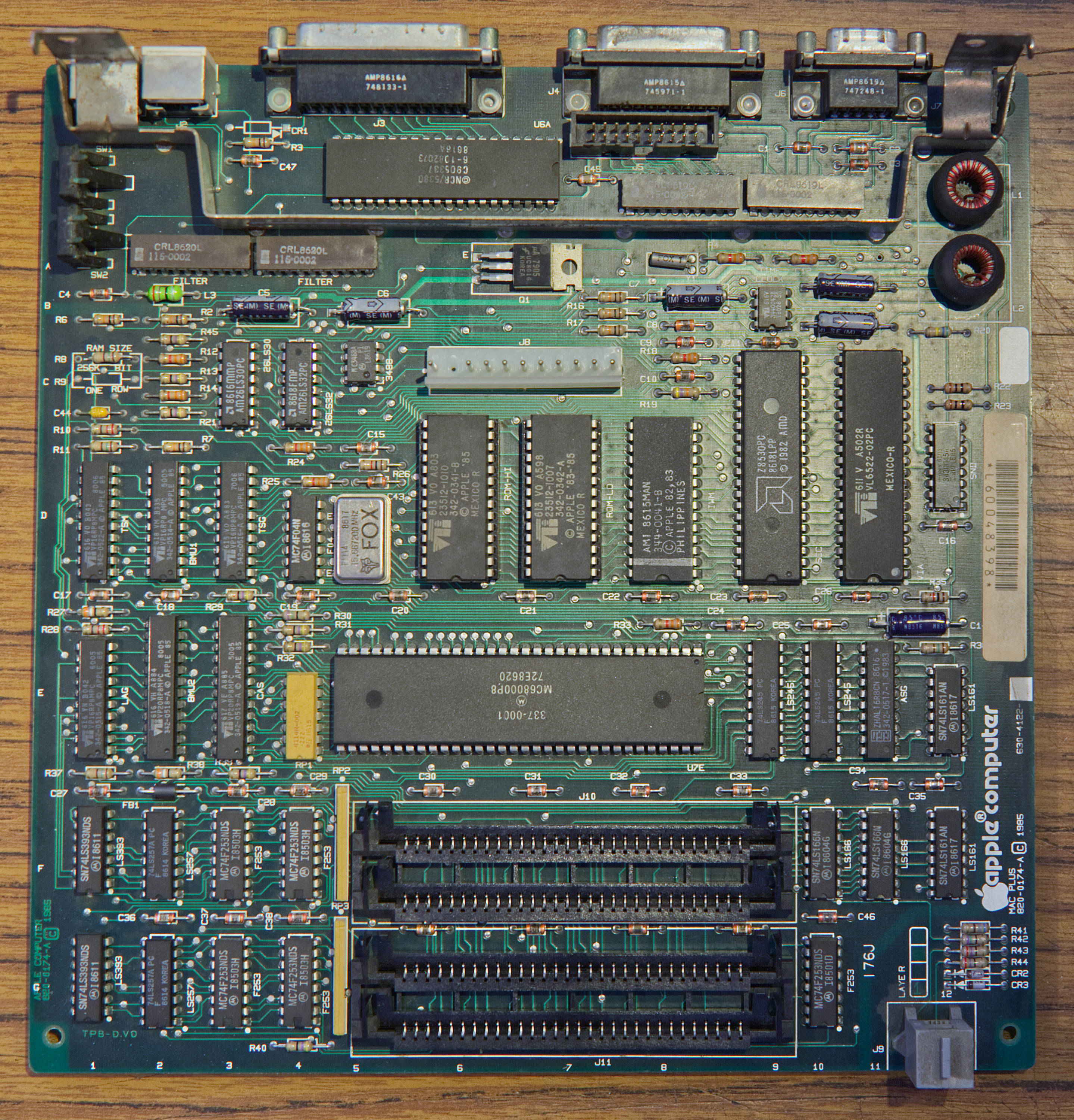

What is the question with the jumpers? I have a 512ke with a HyperDrive. The controller board was damaged so I bought a replacement controller board off eBay. It was from a Mac Plus kit, and came attached to a Plus logic board. It is nearly the same part number as your controller board, and may actually be the same if the trailing "1" on mine is hidden behind the silk screened numbers next to it. I put the Plus HyperDrive board onto my 512ke logic board and it works. I am not sure if that info helps with your specific situation. I have attached a photo of my board, you can see my jumpers are in the same position as yours in the photo you posted above.
Unfortunately neither my machine or controller board came with any documentation.
Edit: looking at photos, I see the Plus board that came with my replacement HyperDrive controller board has some interesting bodge/resistor mods. I added a photo, this was the only one I took previously, however I can dig out the logic board tomorrow and take some better photos if it would help.

My persistence in sending OlePigeon multiple messages across various platforms worked. He sent me a PM to say he will pull his HyperDrive kit soon and examine the documentation. Naturally, I will report back when he does that. (And yes, I will also extend him an invitation to join TinkerDifferent too.)

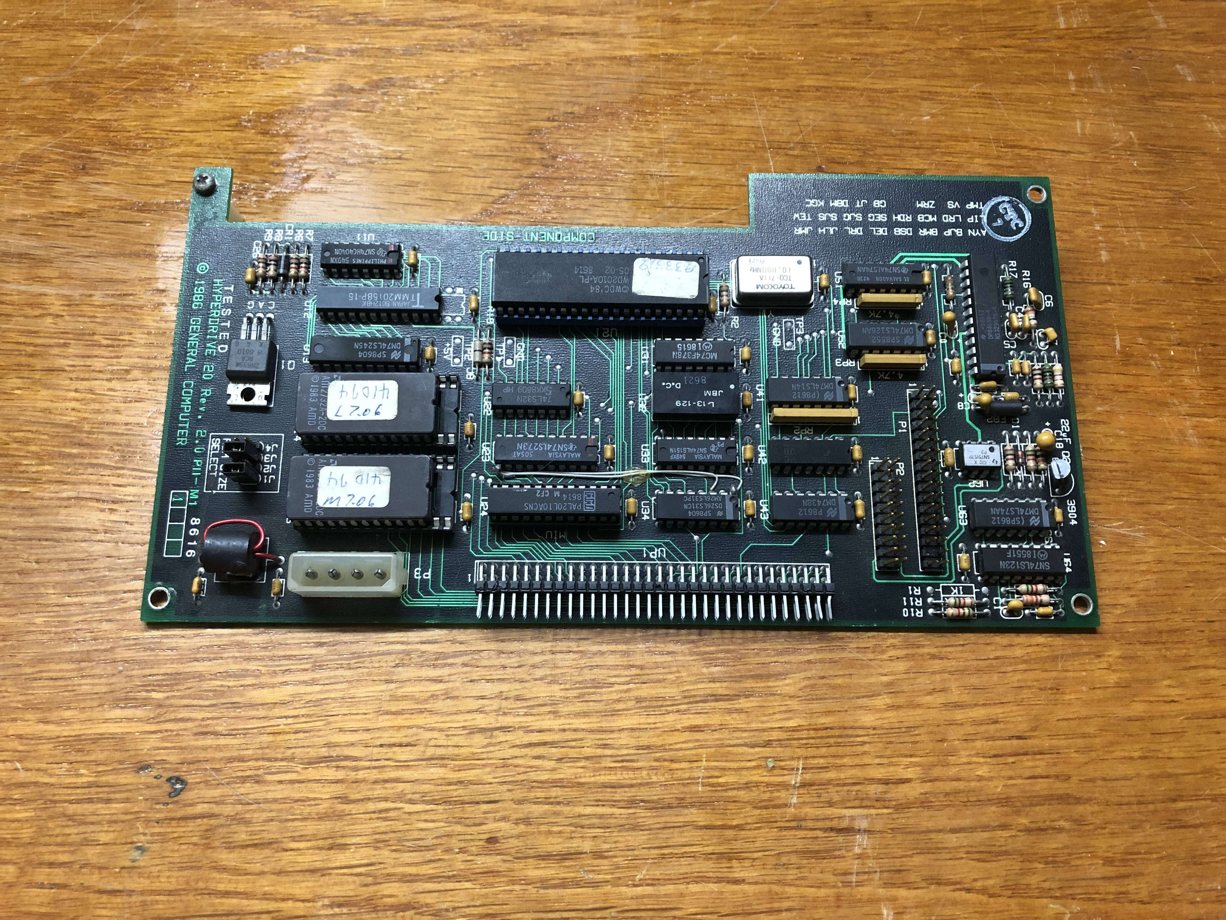

Thanks for this info. It is indeed helpfull. If this works on your 512Ke board, than the jumper setting on my board should be good to go on my Plus board as well. It could be that the 512K where this system comes from was in fact a 512Ke, with the same ROMs as a Plus (I only bought the Hyperdrive stuff, not that 512K).

OlePigeon replied back to say that his printed documentation doesn't mention the jumpers at all. :(
He told me he speculated they might pertain to the Mac's ROM, but I pointed out to him the jumper's close proximity to the two ROM chips on the HyperDrive controller board. And beyond that, there are 4 different jumper pairs! So it doesn't make much sense why you would need so my jumper setting variations to choose either the Mac's 64K or 128K ROMs. I think they pertain to the ROM chips on the HyperDrive board, but knowing WHAT SIZE is the real mystery. And since you have 4 pairs of jumpers pins and because I see 2 jumpers in the photos, that leaves the door open to many combinations possible.

Well, looking at it from a binary perspective, that gives you 16 options. The board ROMs are 24pin and the sockets look like they could take up to 28pin. Maybe there were other ROM chips available at the time that would fit those sockets as alternates? I would pull the chips and read/backup the data before you attempt any other jumper configurations, in case one configuration is erase/write.
For now, I let the jumbers in the position they are. I don't have the tools or the knowledge to read of backup the ROMs on the Hyperdrive board.

OlePigeon kindly replied back to me saying he has the ability to dump the ROMs on his controller. But I hesitate to ask that of him because I don’t believe that would be particularly helpful to what’s being described in this thread.

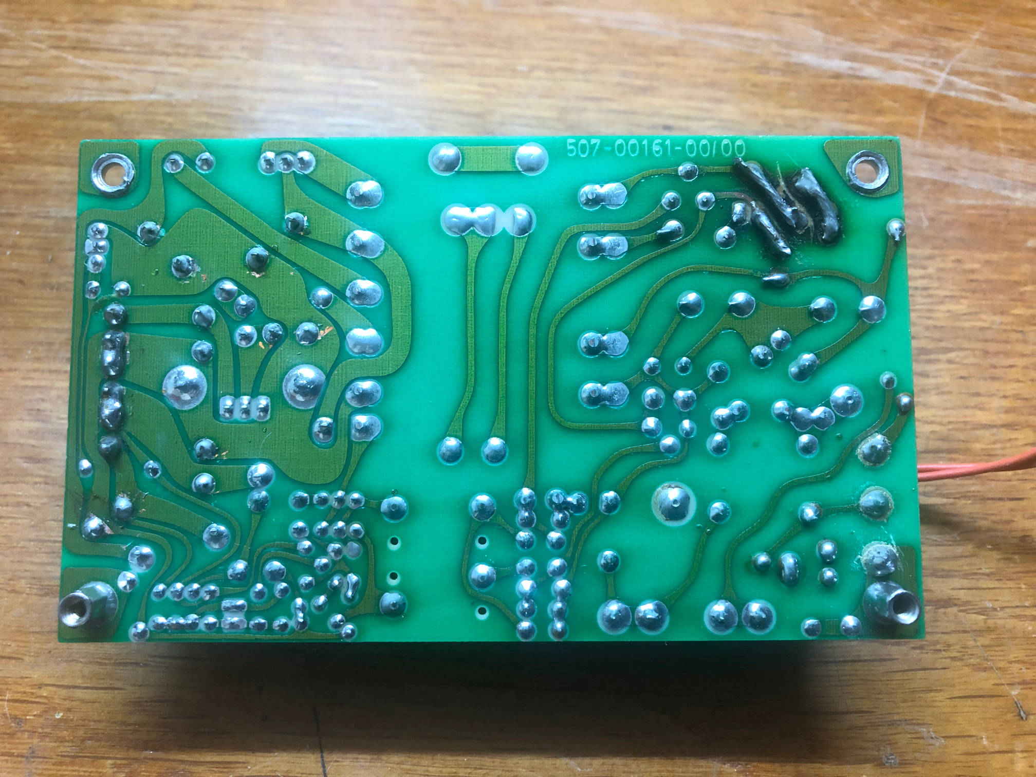

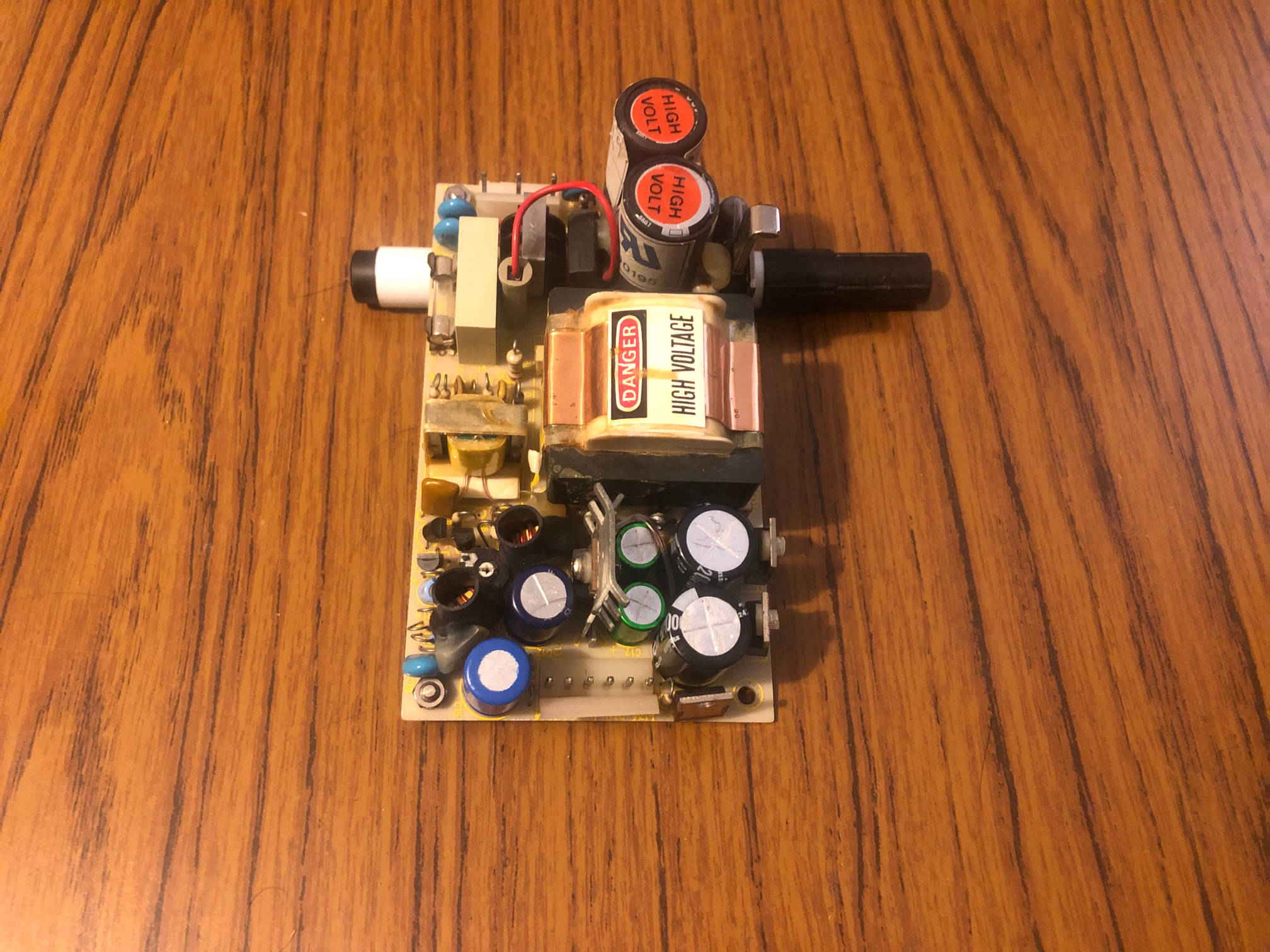

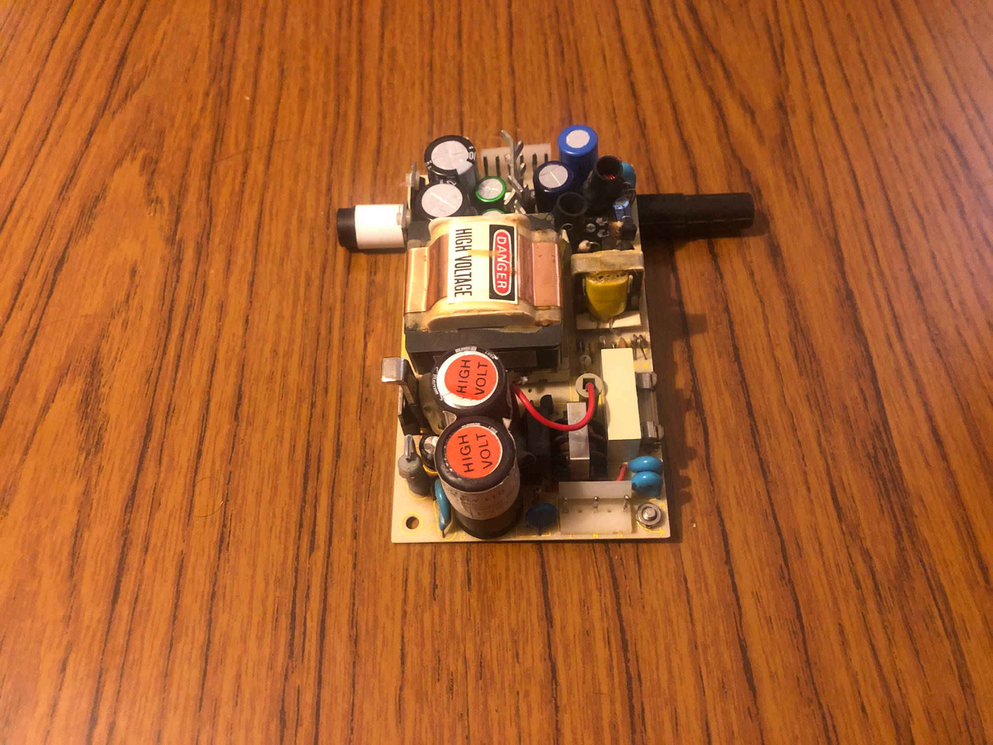

The project continues slowly. I did some testing and measurements on the PSU. There is clearly activity, but not on the DC side for the 5 and 12 volt lines for powering the board, HD and fan. I ordered some new caps (6) and ferriet core line filters.
The Hyperdrive LB is already build in. I ordered a spacer set on Amazon. The only spacer that was still on the Hyperdrive LB was 17,5mm in length. The set I bought has a few sizes and can be combined. I was able to make spacers of 18mm. But that was to high. One of the ROMs was against the frame, but when I made 16mm spacers, it just fits well. That ROM chip is free from the frame and the RAM-SIMMs are just free from the Hyperdrive LB.
I figured out how the wiring should be and I prepared some molex cables to solder together when the line filters arrives. The point where I can tap the 220V power still need to be found. I have not looking for that yet.

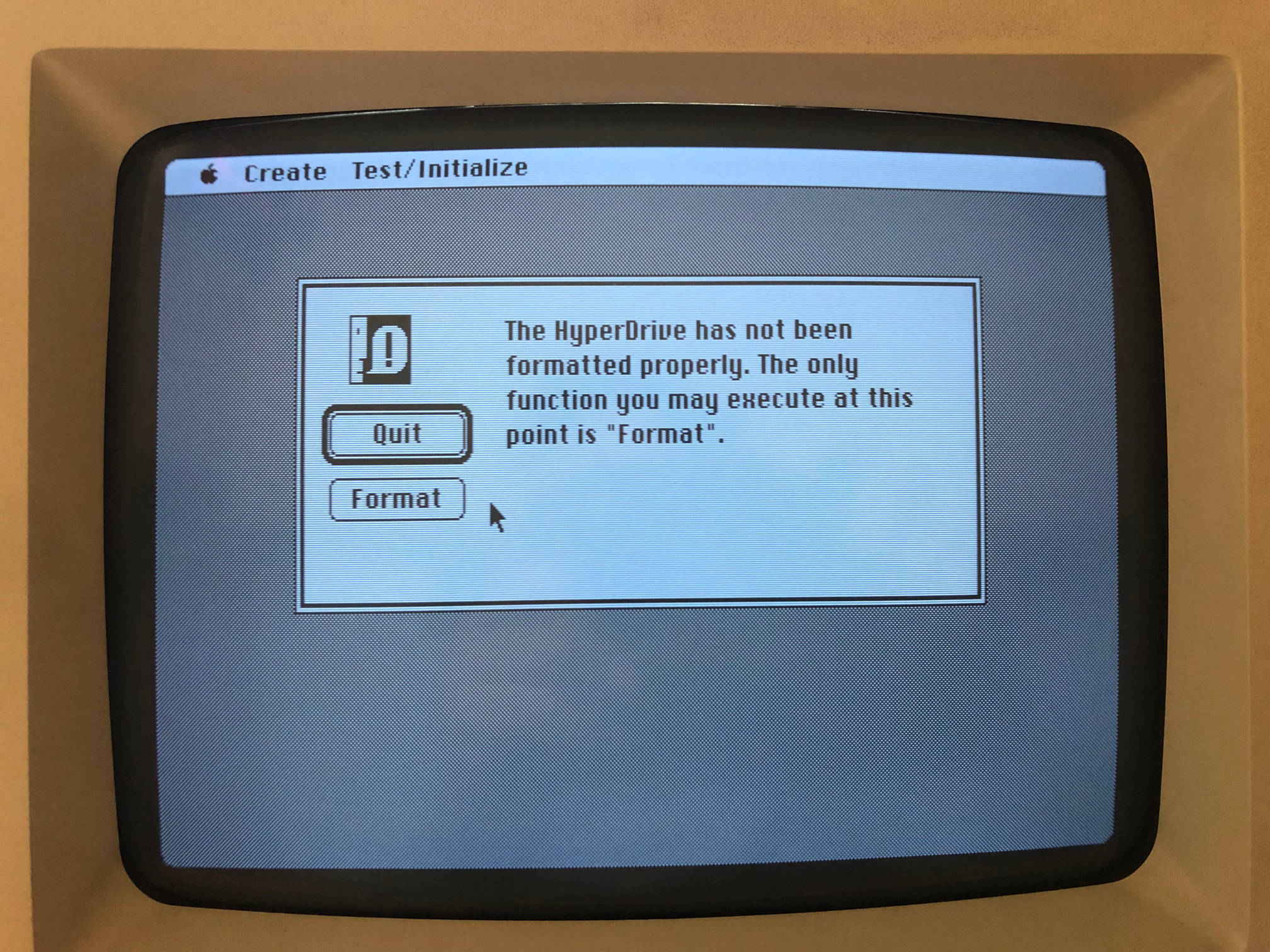

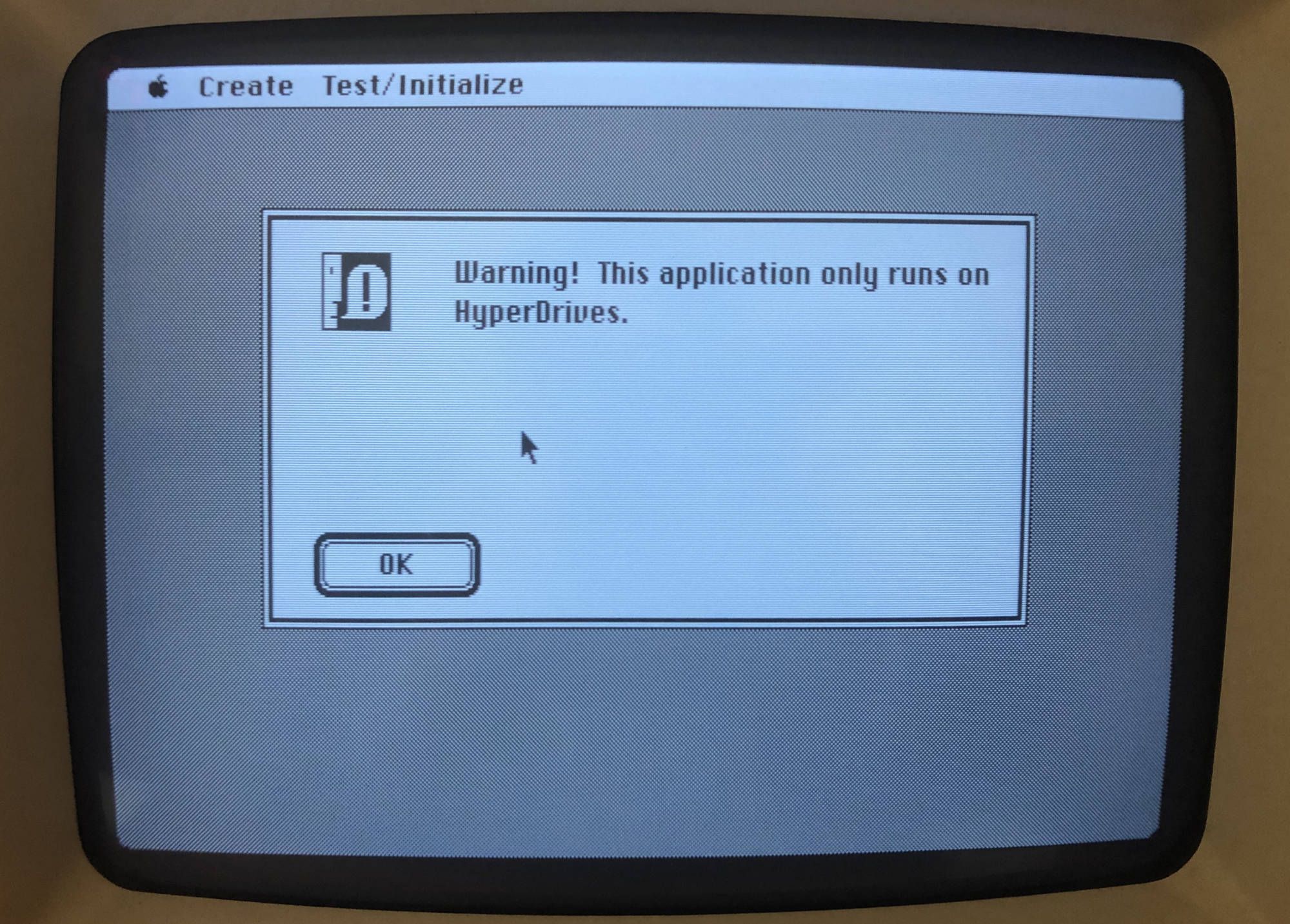

Last thing I did was starting up the Mac Plus, just to see if it still works. I used the initialization disk and started up the Hyperdrive Manager. It gives the warning "This application only runs on Hyperdrives", what was to be expected. The Hyperdrive LB is still not powered.

Well, this project has already to major disasters.
I got new caps for the CPU. Soldered them all in, but unfortunately that didn't help. Still no 5 and/or 12 volt, even with the potmeter in different positions. There is a lot going on the the 220V~ side of the PSU board, but on the DC side still no measurable voltages. Srange is that there is a transformer on the board and on the AC side, I messure 307 Volt DC. But a transformer can not transform DC...
Without a schematic of this PSU, I am not able to find out if this is repairable.
The other disasters is the Hyperdrive logic board a few days ago. To test the working, I took a 5 volt line out of my IIfx (the molex connector of the HD was not used by the BlueSCSI) to power the board. Normally it is also powered by another power source that the Mac PLus itself. The macine chimed, started up and I could start the Hyperdrive Manager. It directly gave the message "The Hyperdrive has not been formatted properly...". Well, good to see that. The Hyperdrive logic board seems to work, even with no disk connected. But than out of nowhere, the screen turns black and a chime follows. It started up again, but even before the startup finnished, the macine chimes again to startup again. And since then, the macine only chimes, but it remains stuck in it. Mmm... That is not good. I took out the Hyperdrive logic board and try it without. Unfortunately the result was the same. So I assume I screwed up a Mac Plus logic board. So I put in the original board and that worked fine. Even with the ROM and RAM from the screwed up board. I think the CPU is dammaged by this action, because with the CPU bracked, it is the first connection with the logic board of the Mac Plus. (I have a battery bombed SE-board that is far beyond repair, but the CPU is still good. Maybe swapping is an option to at least repair this screwed up Mac Plus logic board.)
For now, this project is on hold. Maybe when I can find another PSU or something as a replacment. But for now, I put it aside.

2,534
1,982
...There is a lot going on the the 220V~ side of the PSU board
Oh, so you're not on US 120VAC power then. I was thinking you were. 220VAC means your Mac's Analog board is an International Version. And it means your Hyperdrive's PSU would need to be made for that power level too, unless it can accommodate 120VAC or 220VAC. But I would assume the PSU silkscreen should have input voltage written somewhere.
Regarding your bad Mac Plus motherboard, you said you powered it with the power supply of your IIfx. I assume you had not only +5V connected, but also the GROUND of the IIfx connected to your motherboard too, right? It shouldn't have worked without that. There's a detailed write-up about the power connections here:
To diagnose your bad Mac Plus board, I would start by taking a magnifying glass and slowing check for burned components. Time consuming to be sure, but worth it. Because if something was zapped due to the power source, I would expect to see something fried, somewhere, even if you didn't see any smoke.
The Hyperdrive PSU I have can be switched with a cable between 120VAC and 240VAC. It is on 220VAC. And It is still not connected to the analog board of my Plus. I powered it with a cable right out of the 220VAC outlet (right next to where the Mac Plus was connected).
No, I powered only the Hyperdrive board on the 5V volt+ground line of the IIfx. I messured where the 5V was on the outcomming cable to know where it have to go in on the Hyperdrive board (It needs only the 5V+ground line). And it worked, but later it turned out the Mac logic board didn't agree with it. The Mac Plus itself just powered on his own regular power from the analog board. The only thing I don't really know yet is how the state of the Hyperdrive board is. When I have the possibility, I take some photos on how I connected it all.

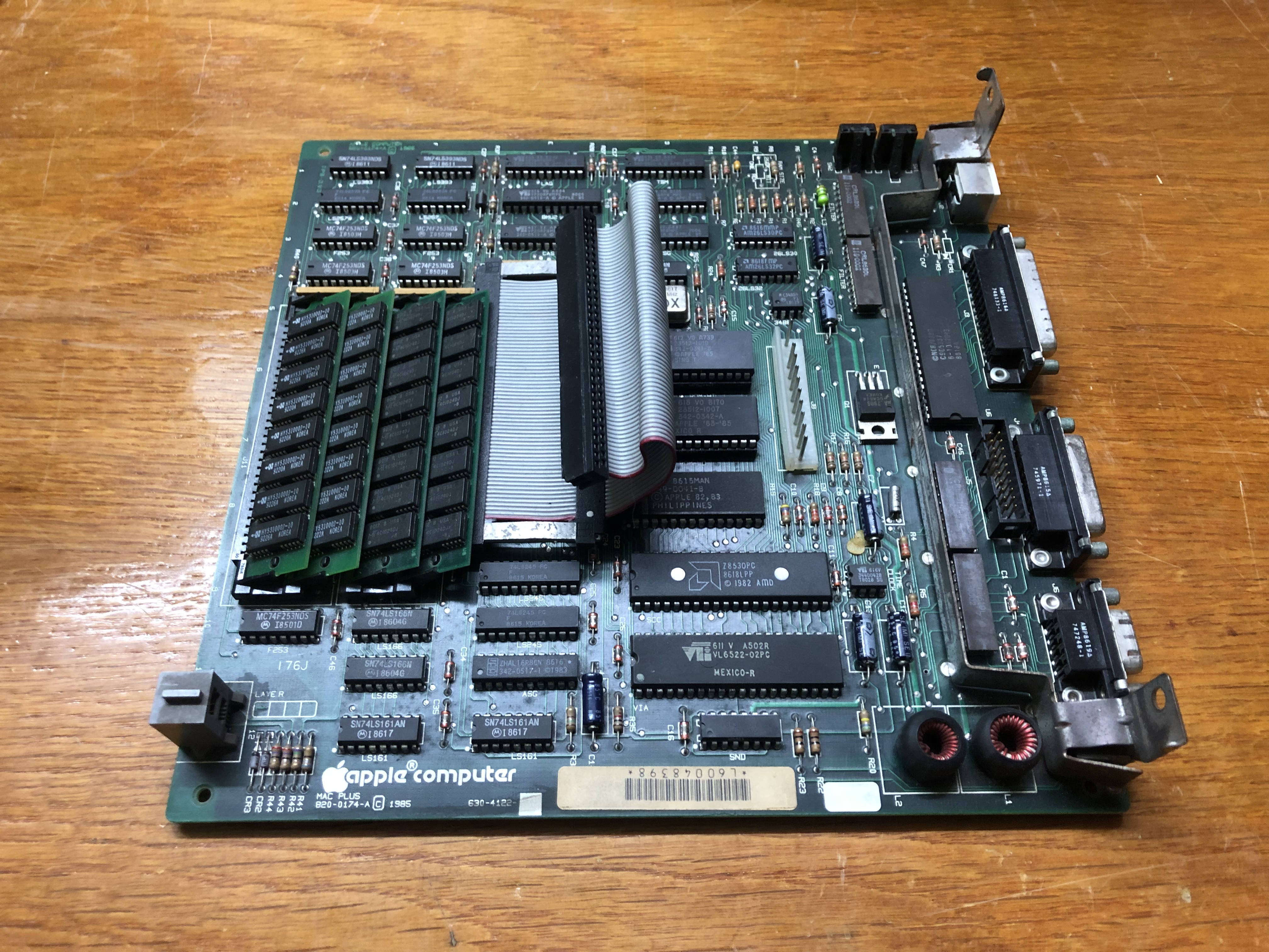

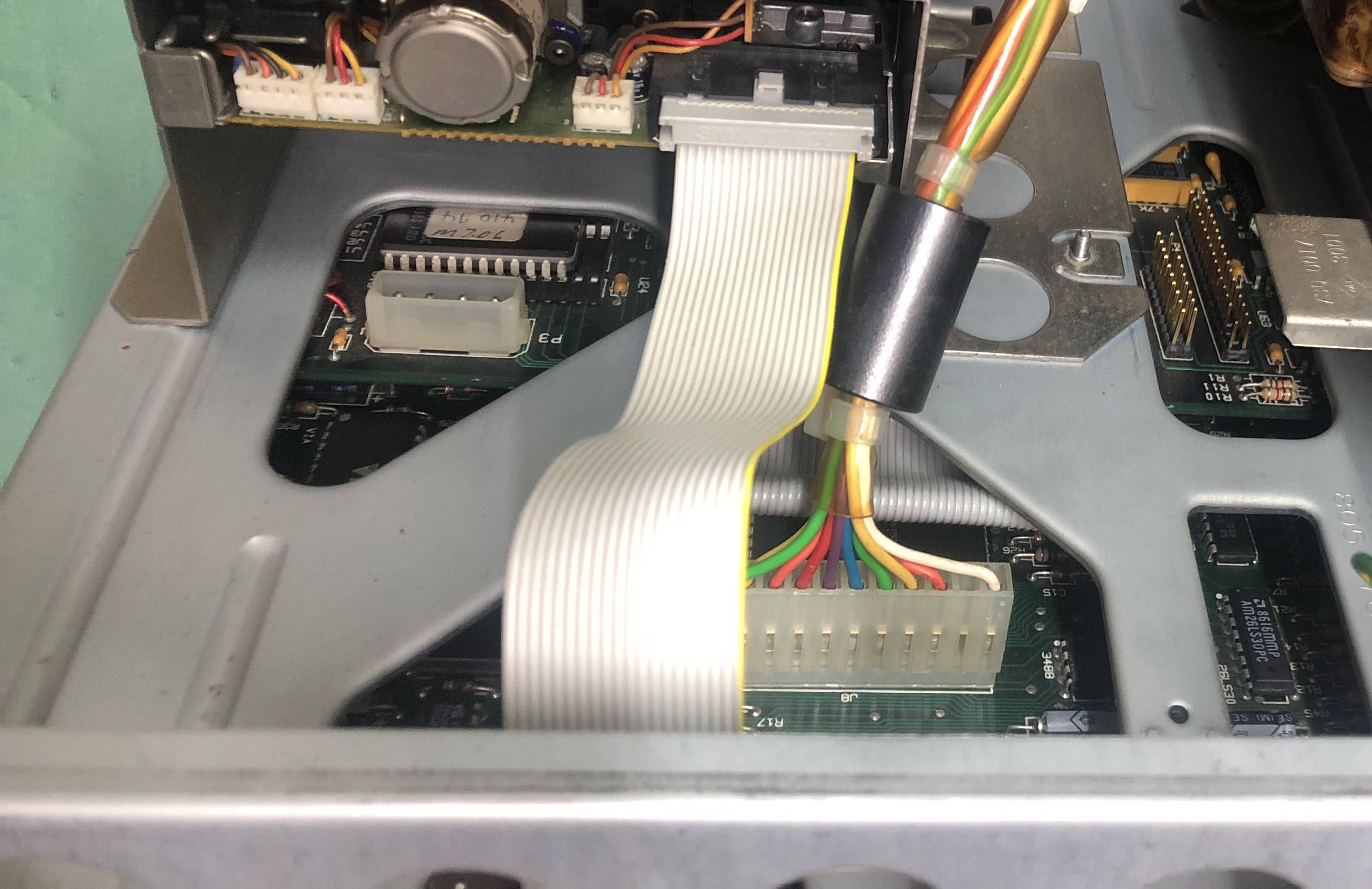

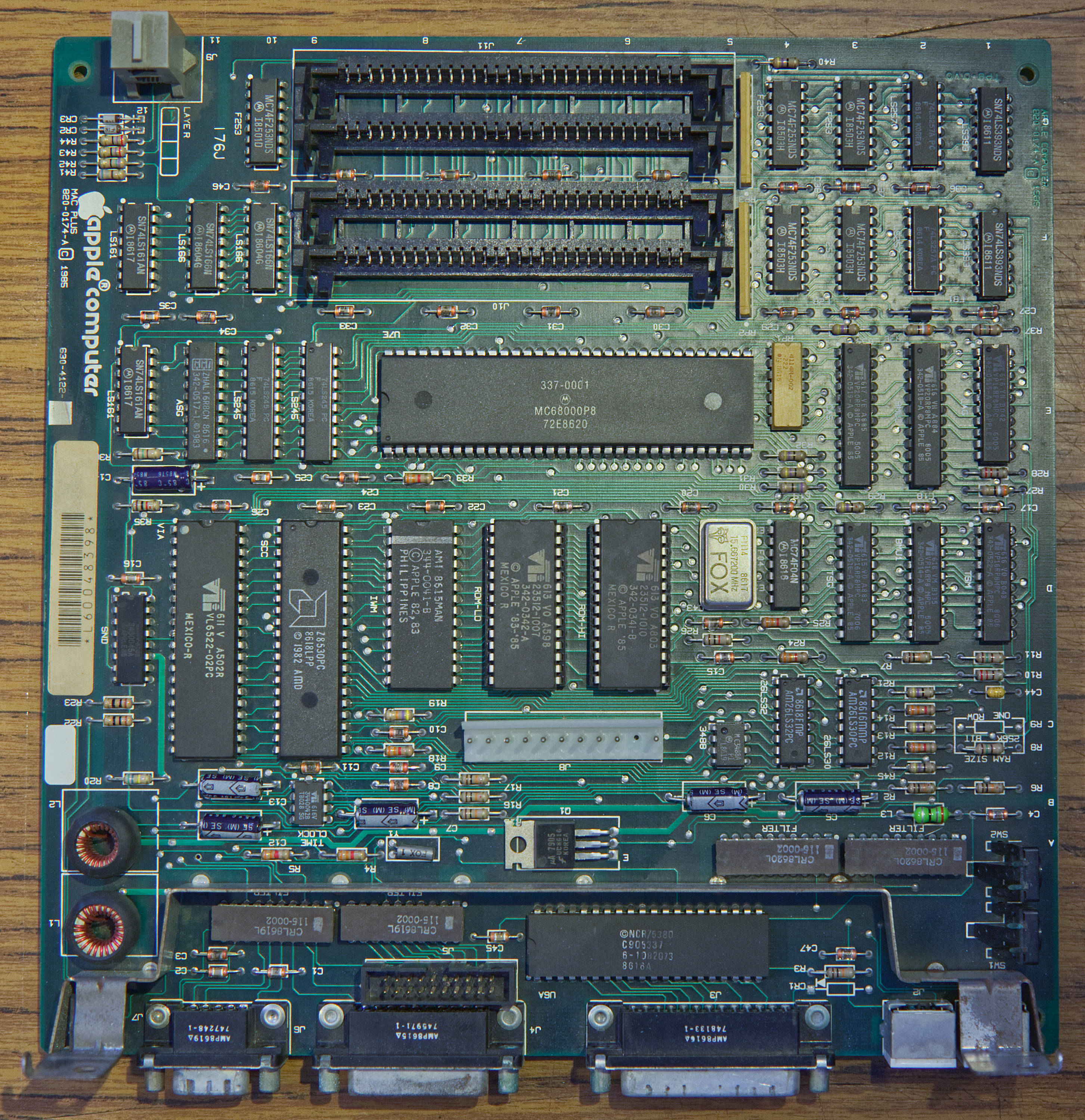

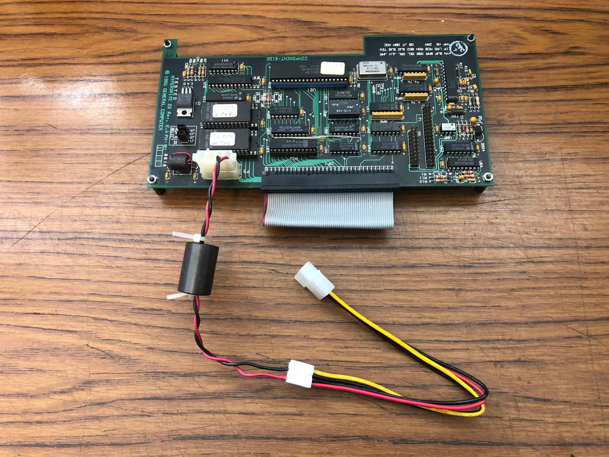

I made some photos, one of the way how I connected te Hyperdrive LB and two of the Plus LB I screwed up.
Based on where the 5V and ground were, I fabricated a temporary cable with the help of a standard molex<->mini molex. On the mini-molex side I plugged in the cables that goes to the molex that plugs in into the Hyperdrive LB. On the other side I plugged in the molex cable that came from the Mac IIfx that normally powers the HD (in this IIfx not in use, the BlueSCSI got power over the SCSI cable). When connected I powered up the IIfx and the Plus at the same time. Practically, it is not different from powering it from the Hyperdrive PSU. So I do not see how it can cause harm to the Mac Plus LB.
The other two photos are from the Mac Plus LB. Due to the bad light, I took one, flipped it 180˚ and took the other. Even with a magnifying glass, I can not find any damage.

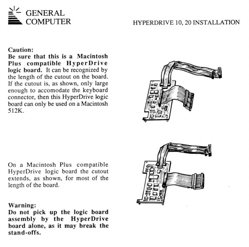

I saw it on eBay, too. But accoording to the installation manual (page 23, see picture), there is a specific difference between a 512K board and a Plus board. The one on eBay is a 512K board. Althought the seller who I got my parts from claims that it all came from a 512K. So maybe a Plus board in a 512K seems to be possible, the installation manual tells specifically that the board with a small cutout can only be used in a 512K.

Well, I did some testing on the Mac Plus board that seems not to boot and only bongs. It turned out to be a volage problem. I messured on pin 6 about +4 volts. So I adjested the voltages that I have about +5 volts on pin 6. The Mac Plus board now boots and started up as if nothing happend. Still a little strange. My other Mac Plus board does boots and startup with these lower voltage on the 5 volt rail, even with an HD20 HD as a startup disk.
But there is another thing with the voltages that I don't know if that is a problem. I messure on pin 5 -14 volt and on pin 8 +12.8 volt. That seems a little high to me. Could that be a problem?
