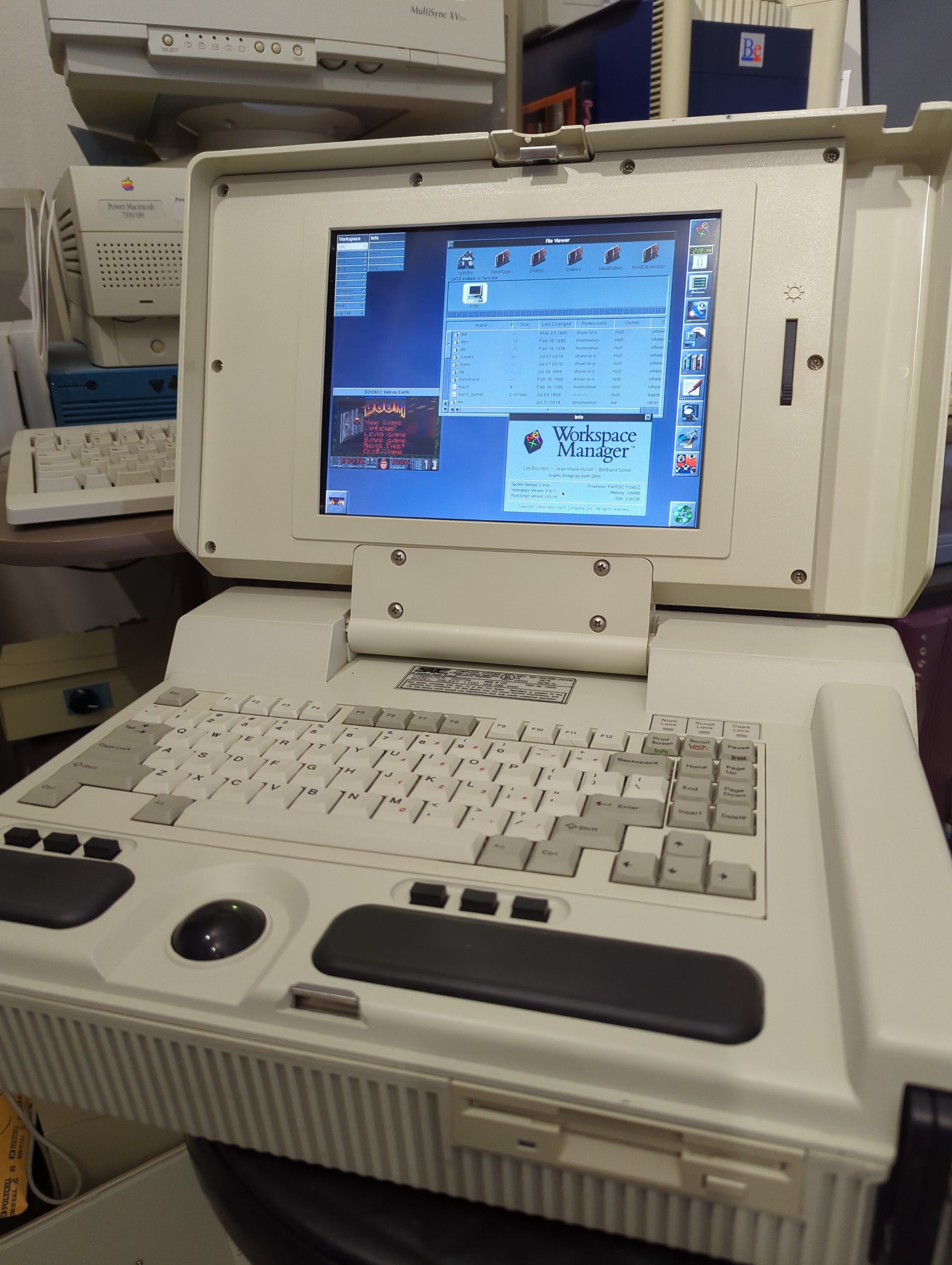

Actually, my favourite NeXTSTEP system is my SAIC Galaxy 1100, which is a PA-RISC HP 9000/712 in a MIL-SPEC portable workstation shell. It is very fast and runs 3.3 beautifully.
I googled it and that looks like a pretty sick retro laptop. That said, I think it's hard to beat the original Black hardware.... it beautiful inside and out... I wish I still had mine.
And I never said a big congrats to @eric on getting his first black hardware set up and working! Big accomplishment. I hope you enjoy the machine!

Had a friend working at SAIC for awhile, but he was the only one I knew from there, and I don't think he was ever on the hardware side. I got my two Galaxys second-hand as chance finds. They're just so much fun to use.
